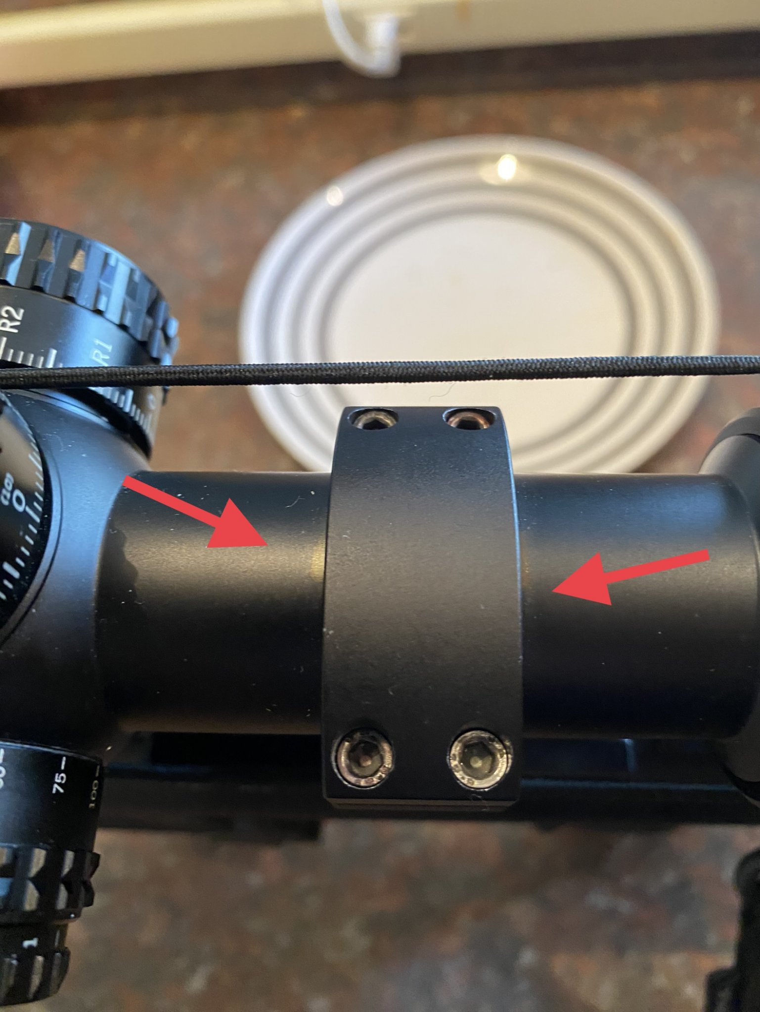

Mounted on a semi .308. Marked the rings after mounting. No movement. Not a safe queen, has seen a couple thousand rounds.
