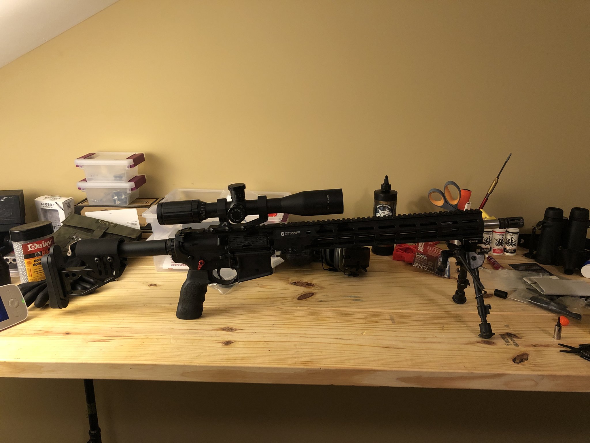

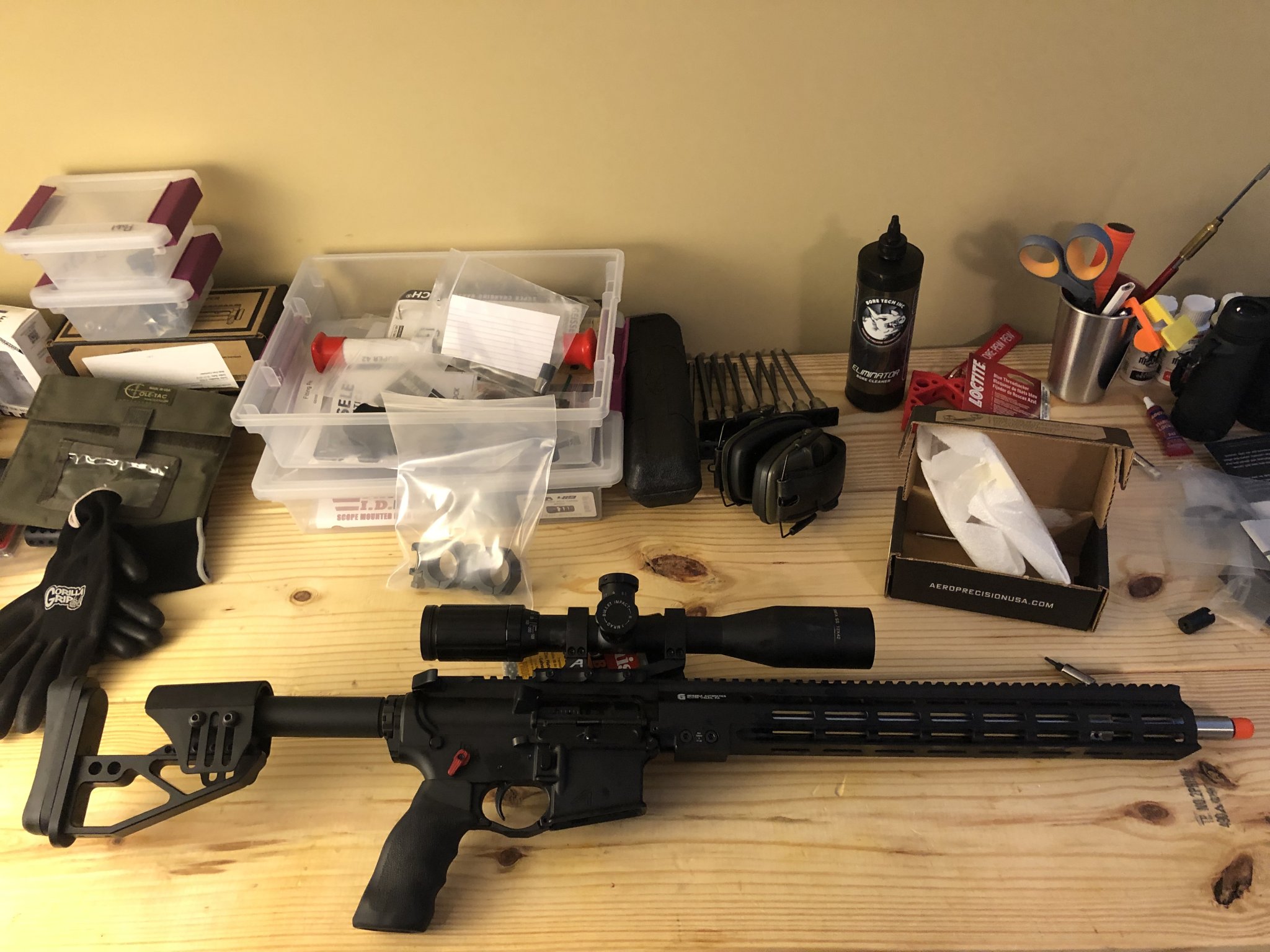

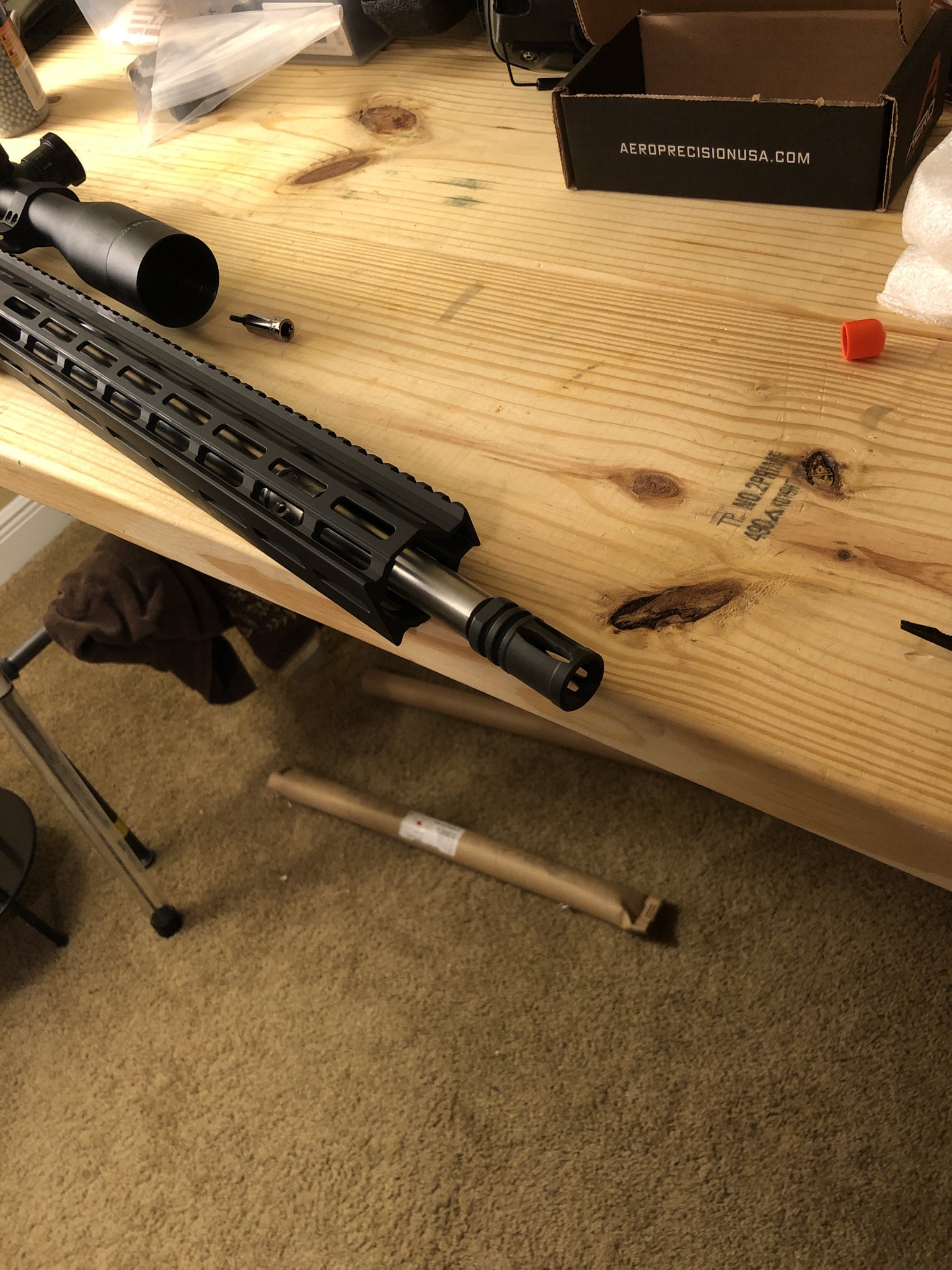

Here’s some pics on my DMR built. I started with the Seekins but didn’t like the idea of a separate rail just to get ARCA and it didn’t feel right in the hand. Plus MK18 is 16’ long. Makes my 18’ barrel look small should cover a rifle +2 system(mine is rifle length. I can get you different photos if you want.

I will try and dig up some pics. My teammate and I worked with Geissele to make the Mk18 to fill the roll in PRS Gas Gun. We use RRS dovetail on our bolt guns and wanted a streamlined solution for a precision gas gun. We also run 18-20" barrels and decided 15-16" was where we wanted the length. Overall I carry 18 plus pound AI AX rifles with RRS dovetail on the bottom and love the feel. I would say for run and gun with a 16-18" 3 gun rig, this may not be for you. For a precision platform it is outstanding but the PRS Gas Gun series fell apart and we have not been shooting as much gas gun stuff as we used to.
-Matt

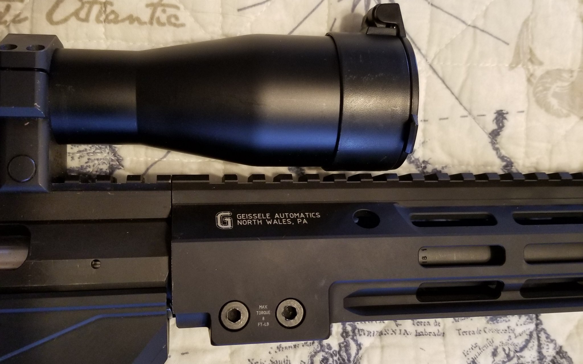

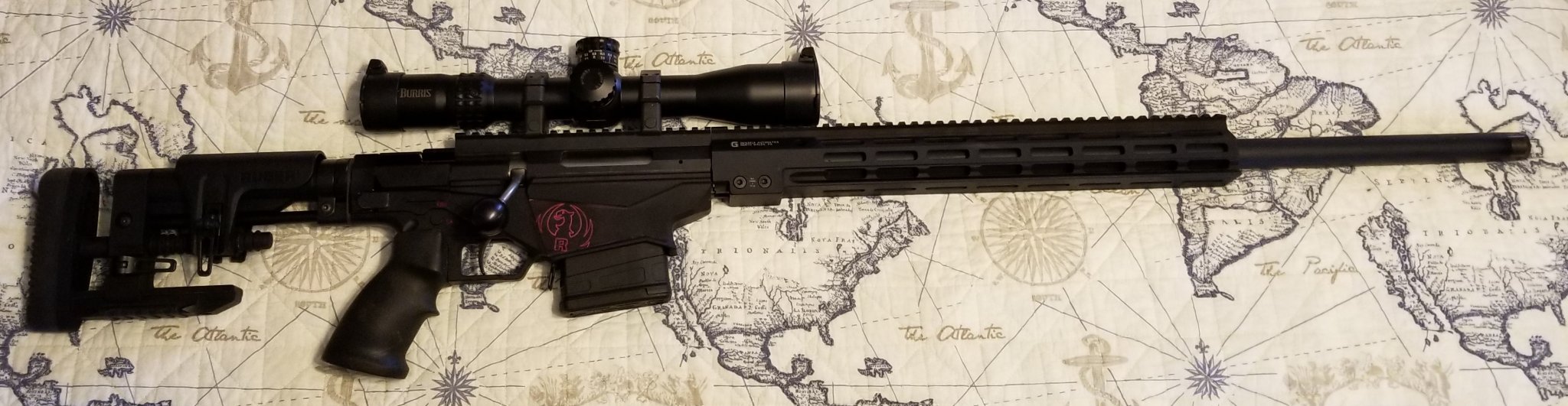

#1 - This is not an easy DIY project. You'll need access to a lathe and the skill sets to use it.
#2 - No permanent modification to the receiver is necessary, just the handguard. The Ruger barrel locking system is effectively removed.

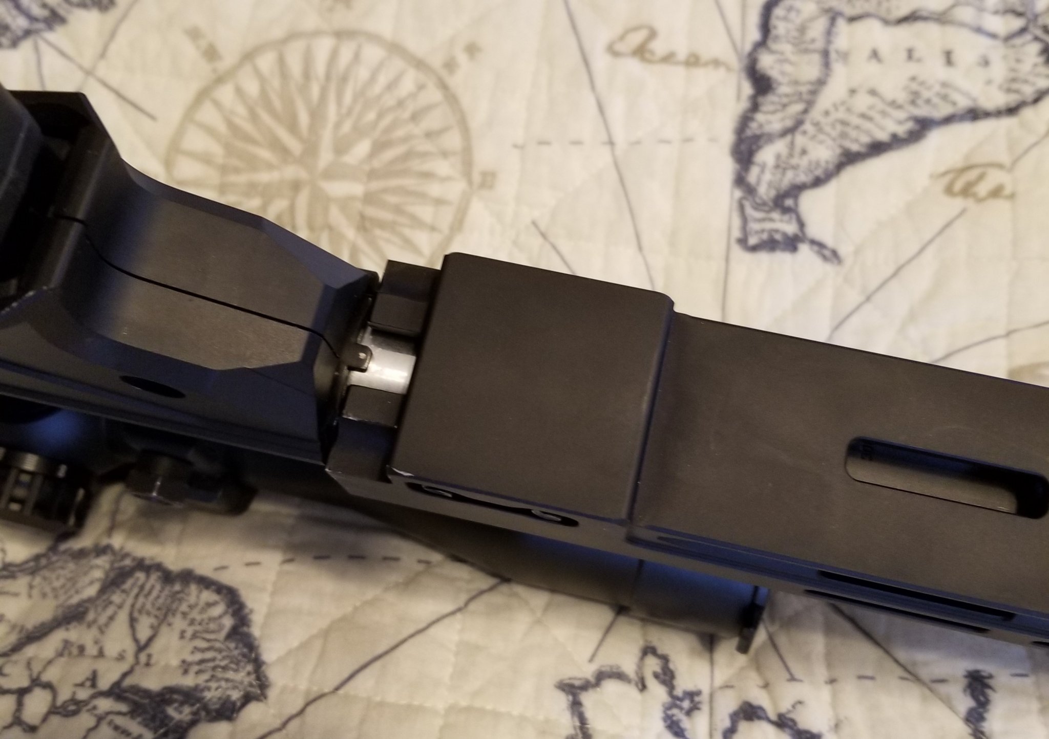

#3 - The Handguard will be permanently modified. Gotta cut the centering... ears off at the lower rear of the handguard.
#4 - This process will effectively work for any AR-15 based Geissele Handguard/Rail
#5 - If using a RPR designed barrel, it will be permanently modified. The shoulder must be removed.

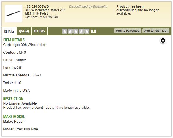

  1. I used a Criterion 26" .308 barrel with the AMU profile and salt bath nitride finish; I filed the shoulder off to prevent heating/warping vs grinding; I don't doubt a lathe would have been a cleaner better option. It took a while but was ultimately worth it. You could just get a normal barrel with the right receiver threads to bypass this process.
  2. I had to cut the ears off the rear of the Mk18 Handguard/Rail as the RPR receiver is wider than the AR-15 receiver it is designed to work with.
  3. I initially used the supplied Geissele Barrel Nut that came with the handguard and a Patriot Valley Arms thread reducer from Patriot Valley Arms. However, the barrel was VERY not straight and could easily be seen canting to the right against the handguard by 3/8"+. To resolve this I had a local Gun Smith create a new barrel nut out of some aluminum stock and it straightened right up.
  4. While everything was apart I lapped the lugs. Why not, right?
  5. Gun shoots 1/2" MOA pretty easily with my version of M118LR (175gr SMK, 43.5gr RL-15, CCI-BR2, Federal brass... because I had a bunch of once fired GMM).
  6. While I have not done it yet, I STRONGLY advise to get some M1913 Picatinny accessory to place over the handguard to receiver break to act as an additional locking mechanism. I haven't been tough on the rifle by any means, just to the range a couple times to test. However, I could pretty easily see how it wouldn't take much torque to hurt headspace.
    I think that pretty much covers it.​
