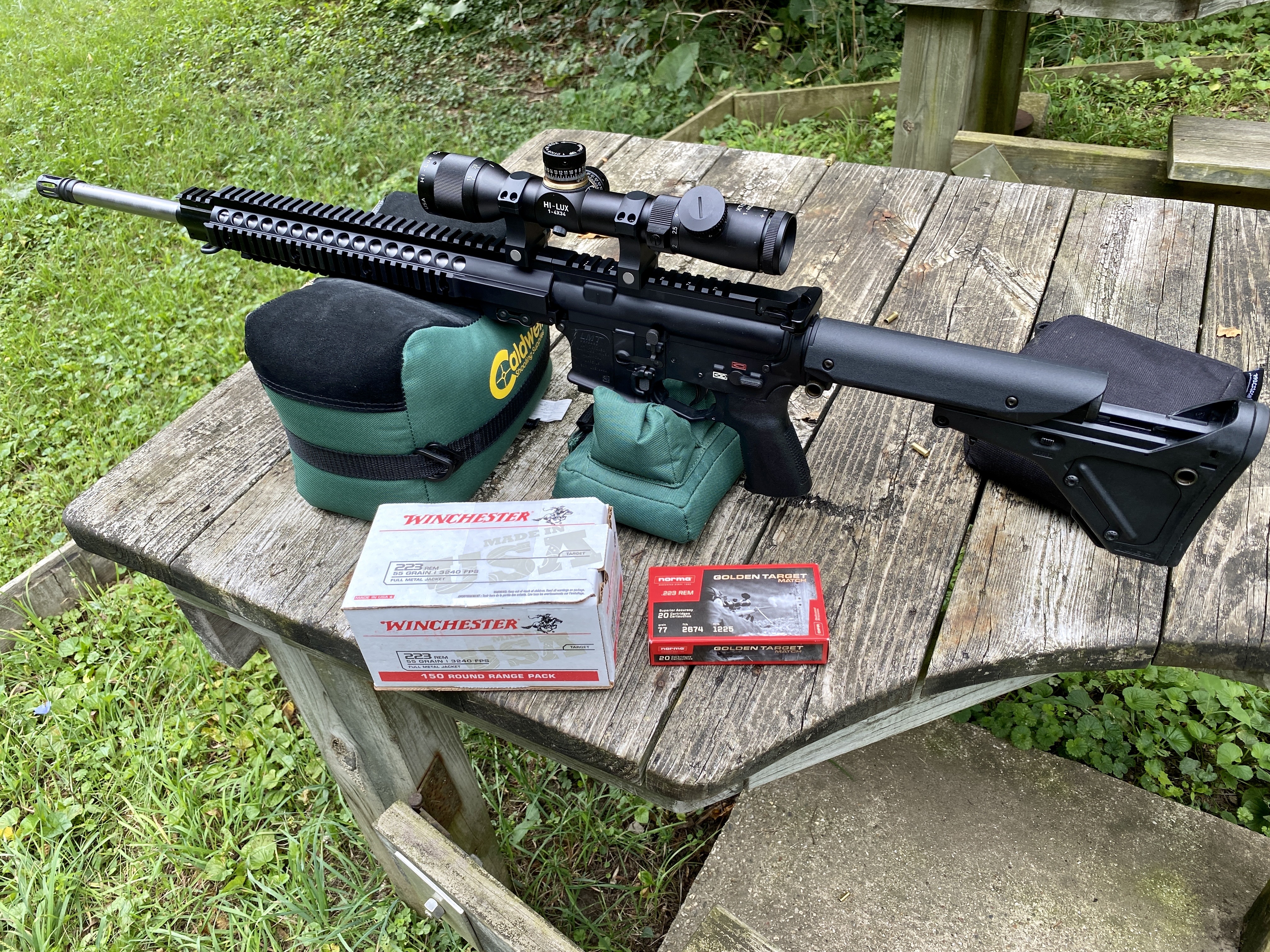

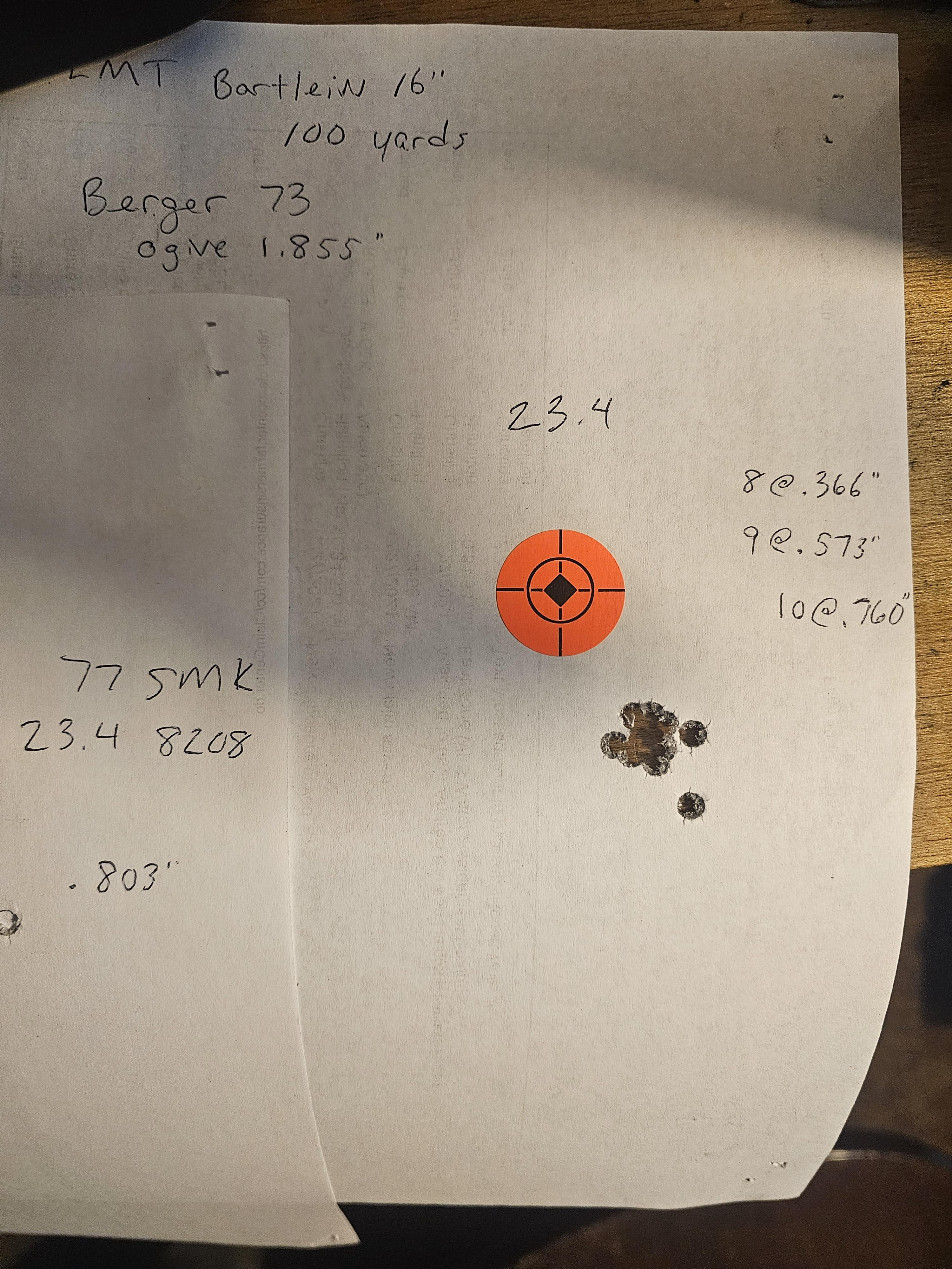

If precision beyond 100 yards is critical to you, Geissele factory rifle will probably be more accurate. However, you can have gunsmith D Wilson convert any barrel to work with lmt. That's what I did with a Bartlein barrel from Craddock Precision, and now it's the most accurate AR I've ever shot.

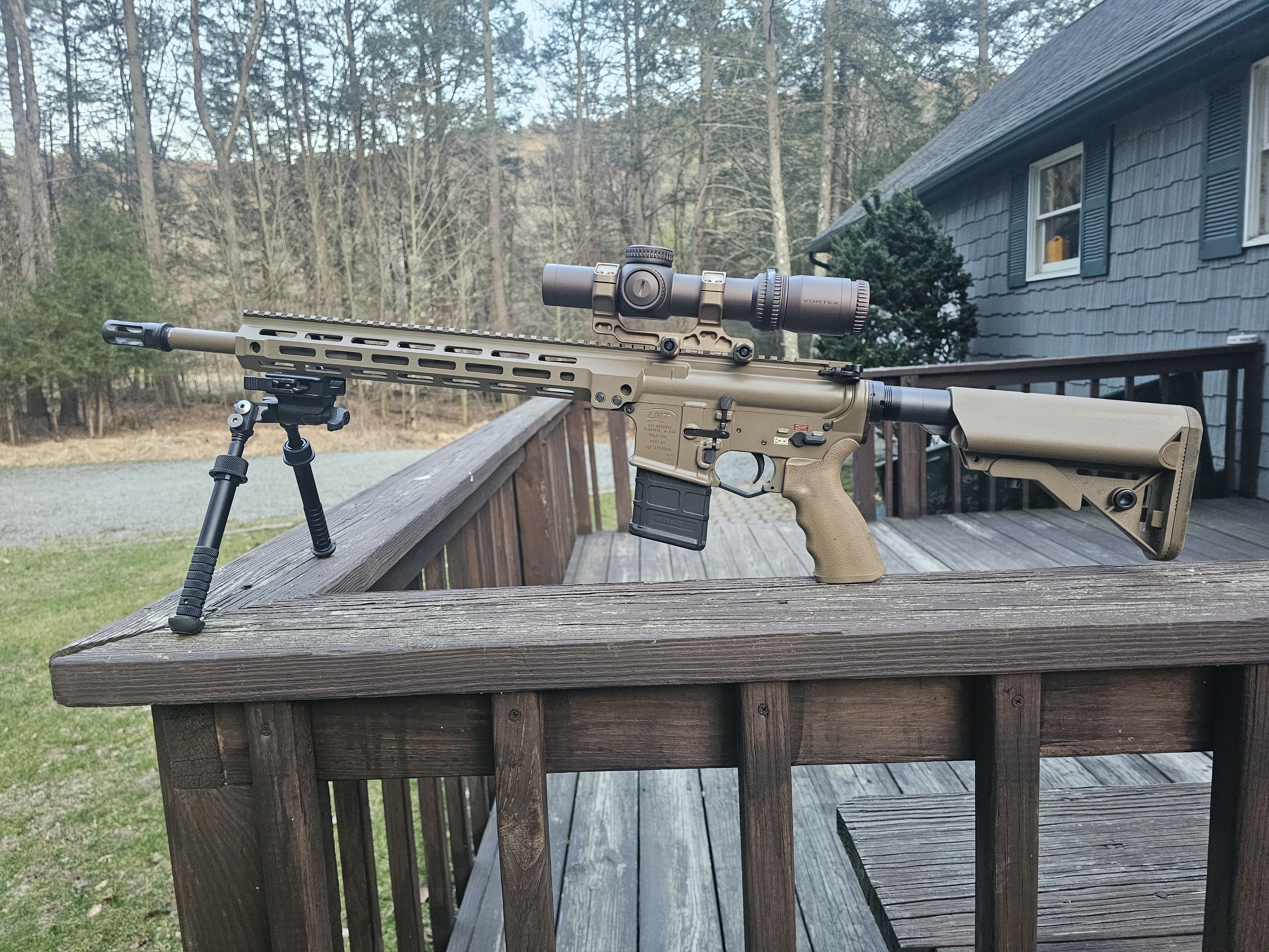

I have both. My Super Duty 14.5 is my favorite
Light super reliable and stupid accurate

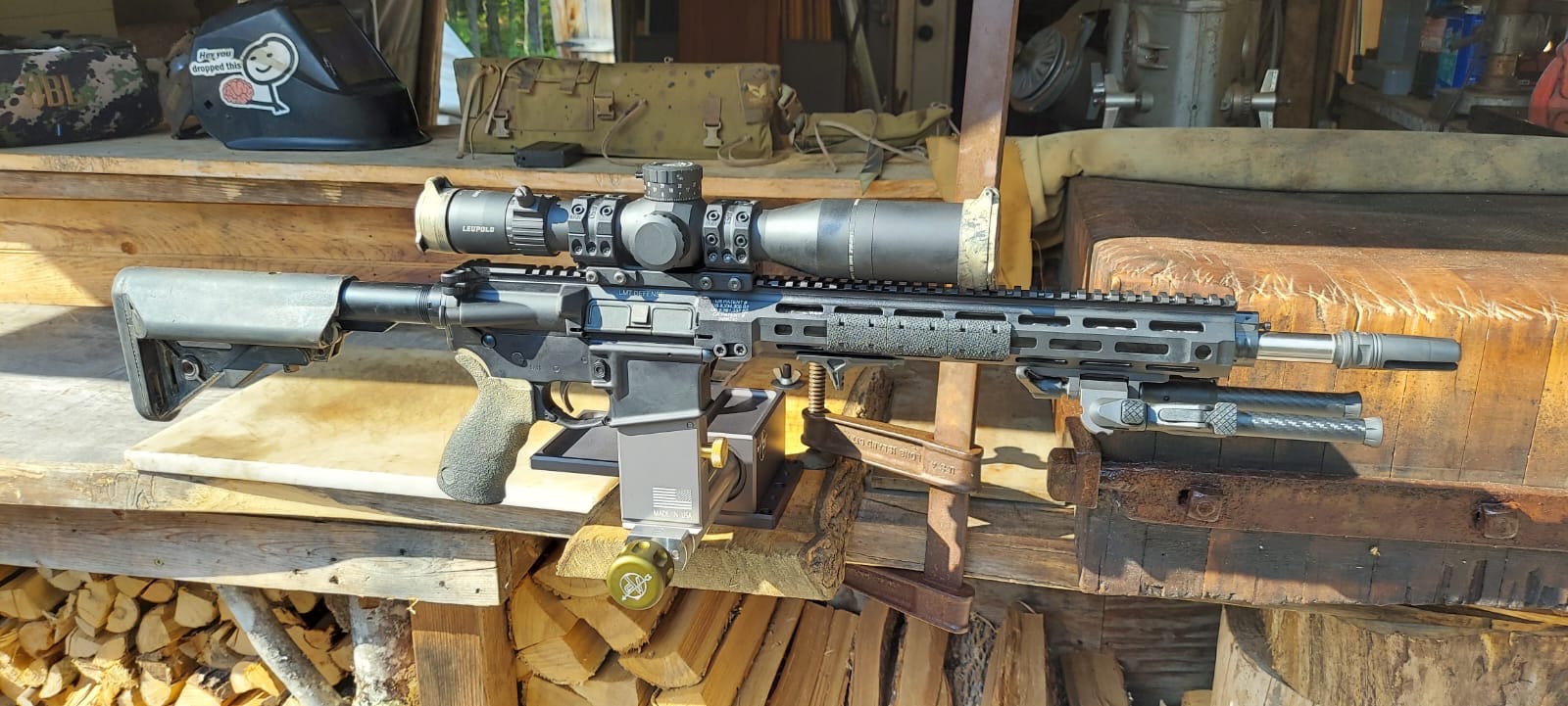

Lmt with d.Wilson proof barrel.
Solid build @Bambamoda
