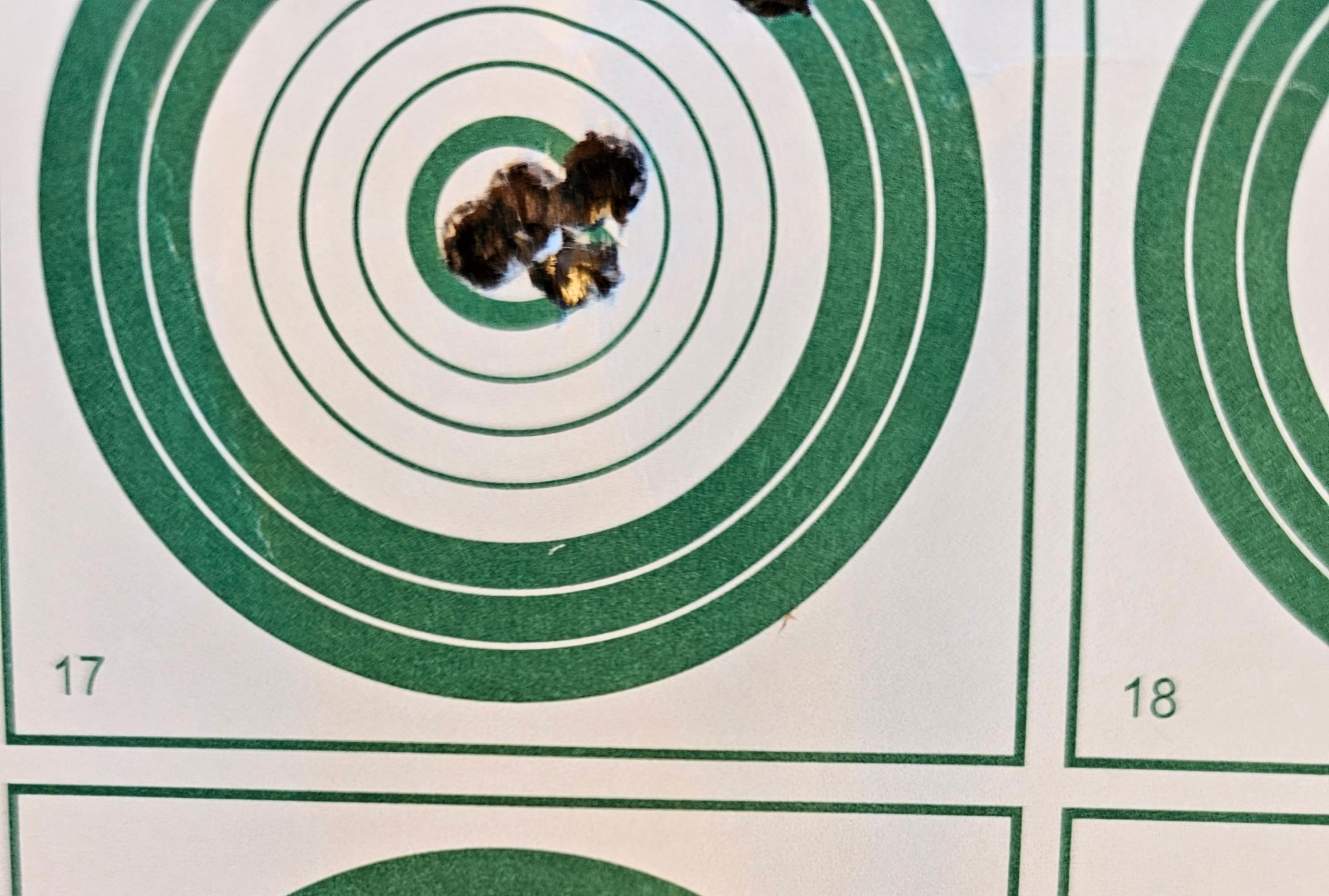

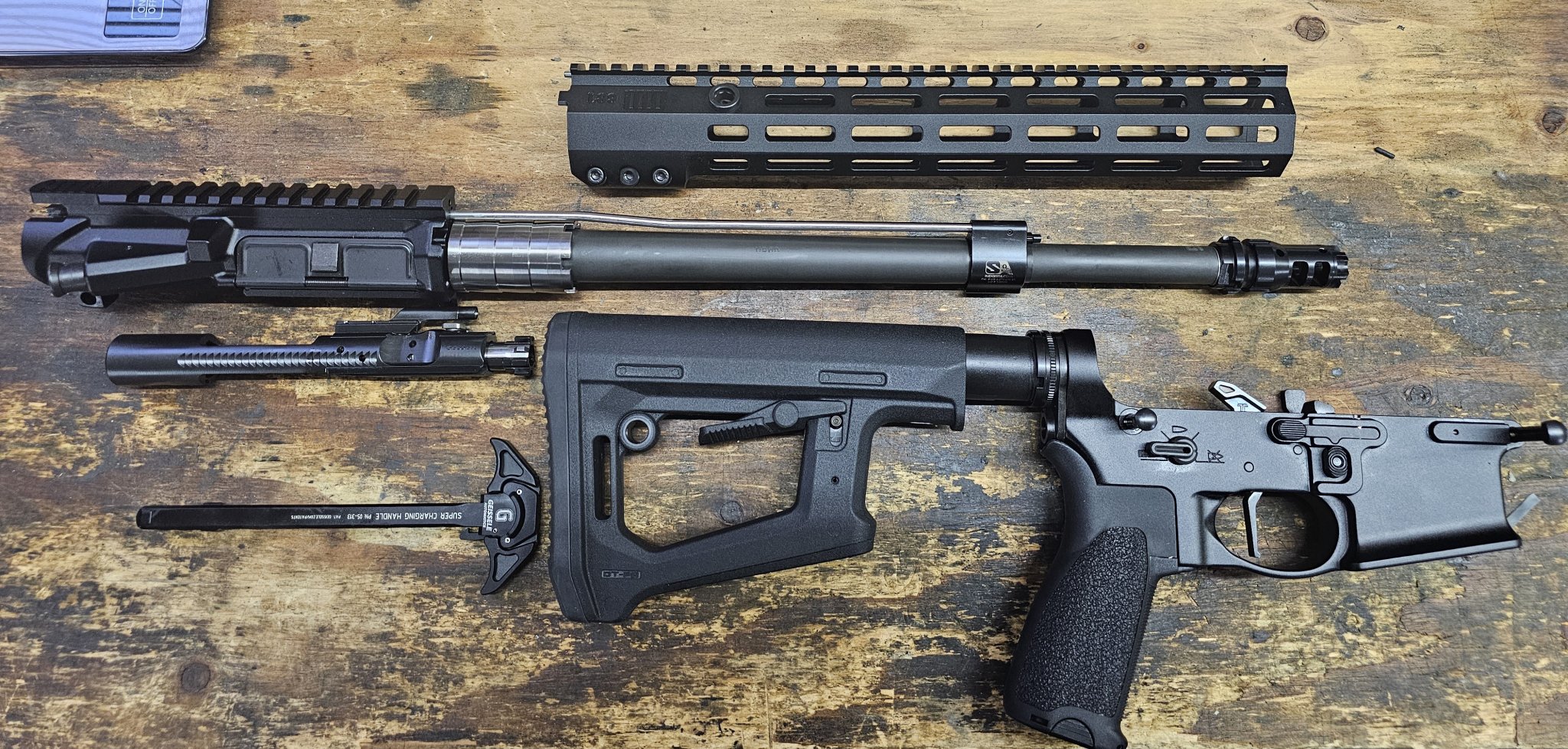

Geissele's New Heavy Barrel and SOLGW Broadsword project. (First Range session)
bigjake83
Golden Shellback
  • May 19, 2013
    4,933
    3,808
    Southern Idaho

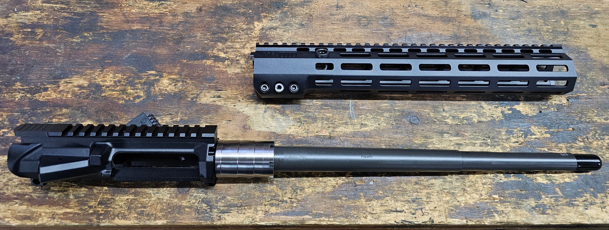

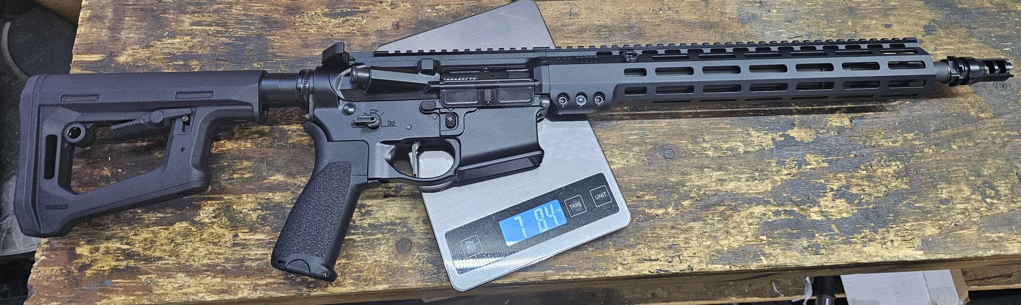

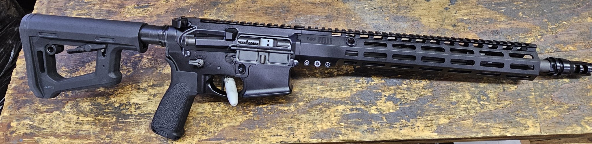

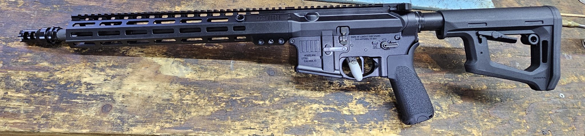

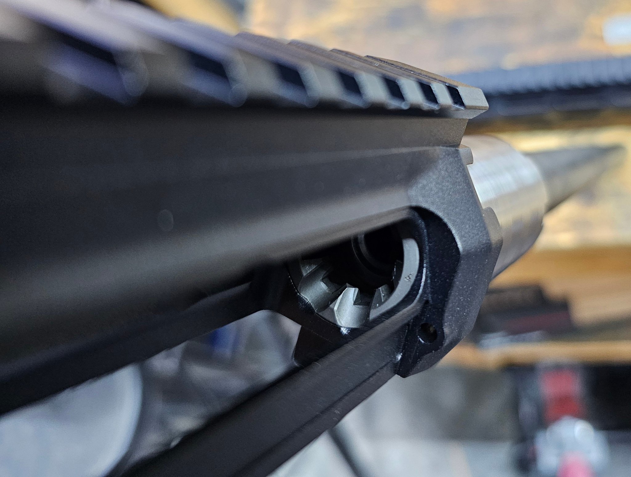

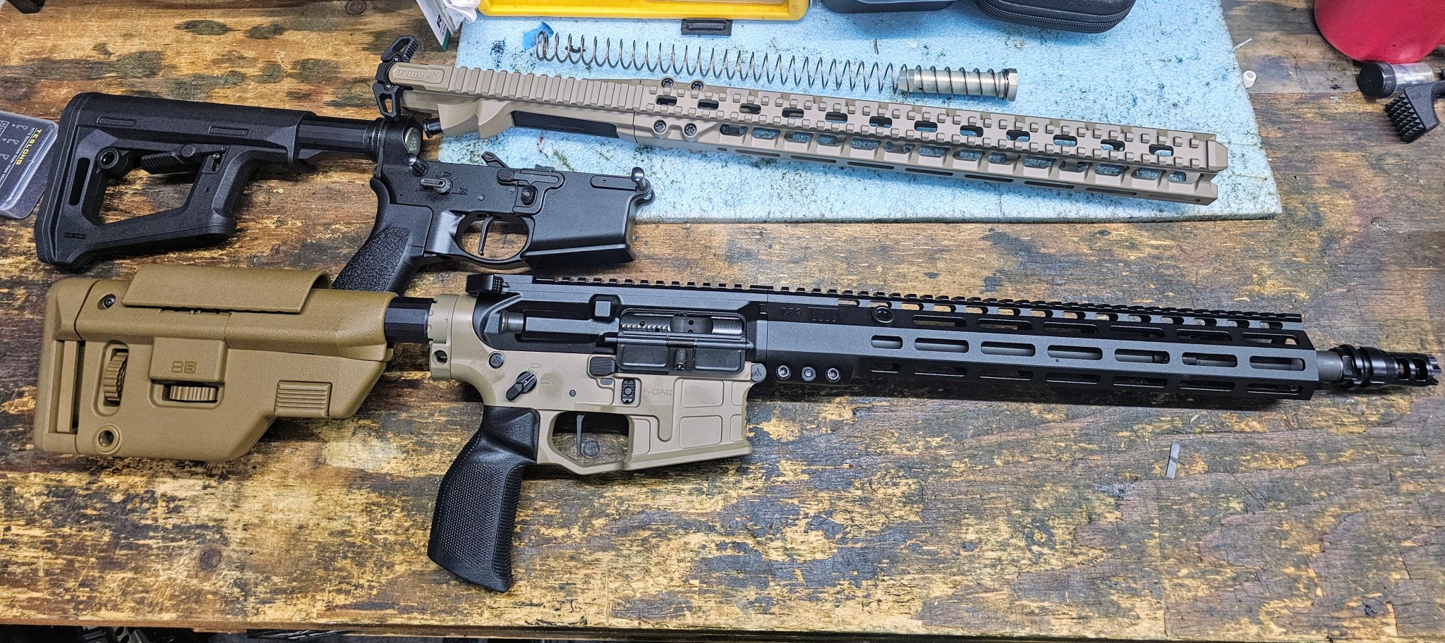

    Just finished this build today, looking forward to running it through it's paces.

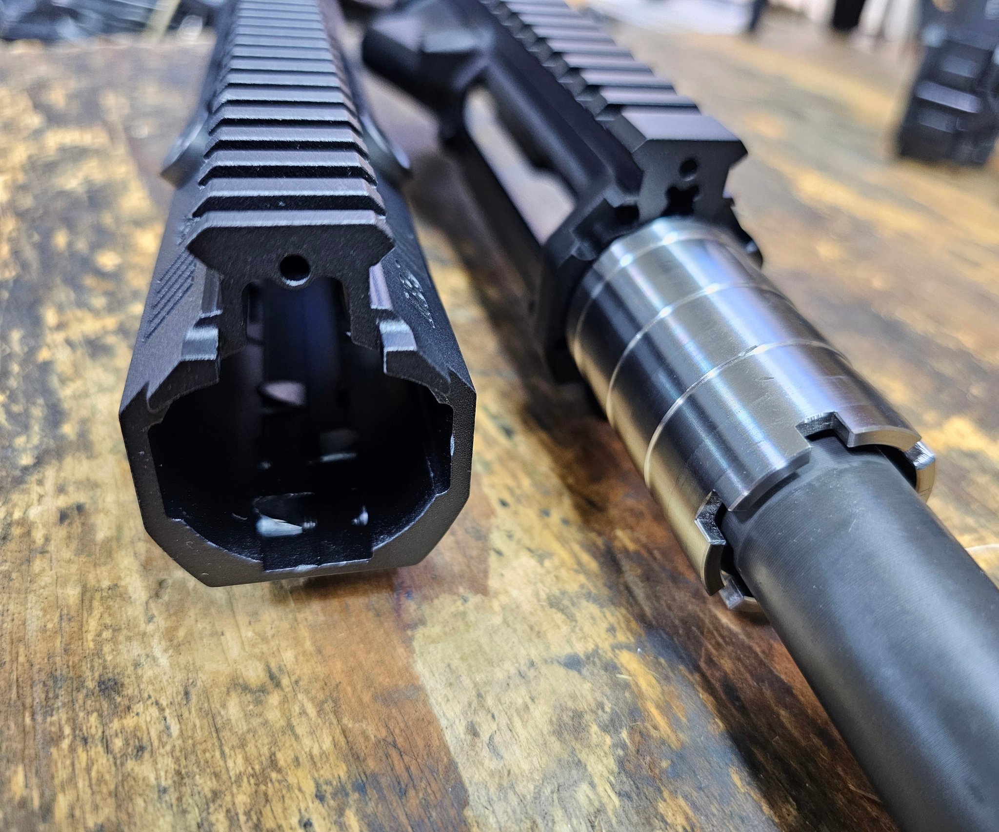

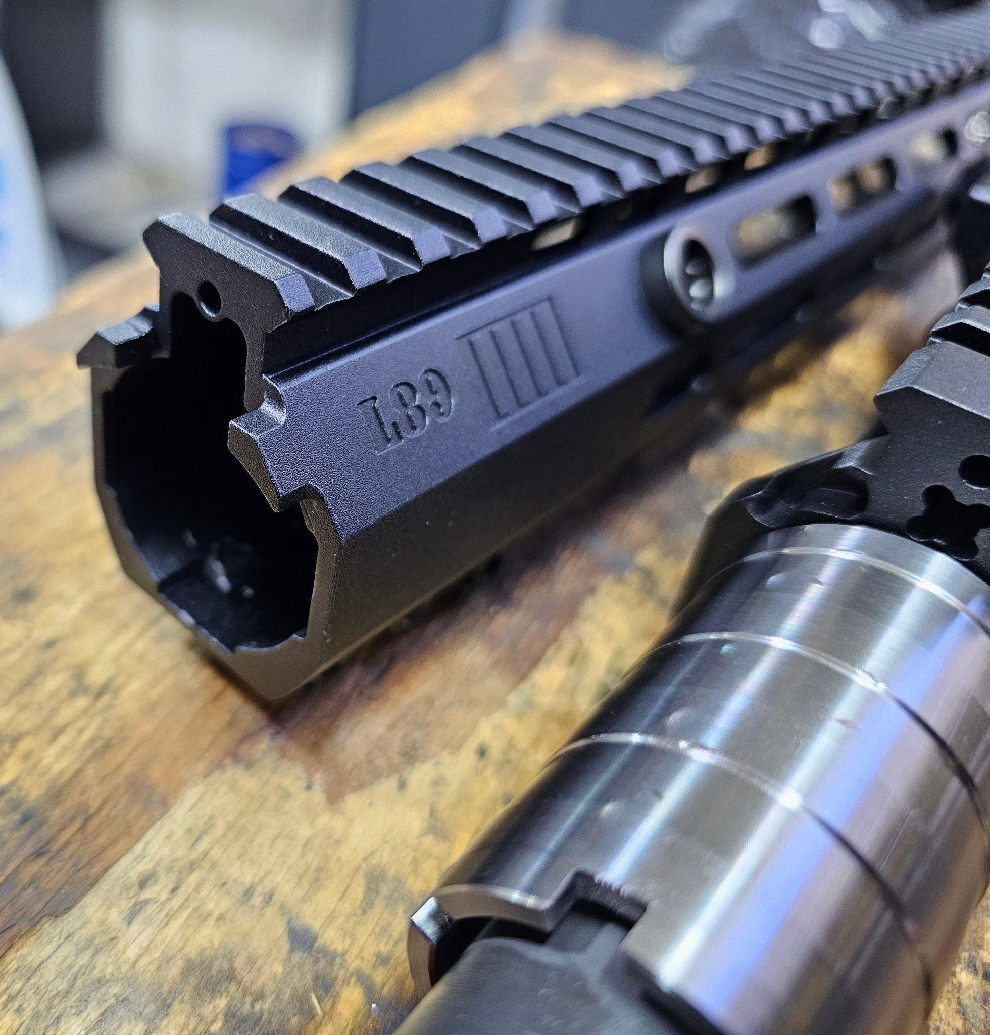

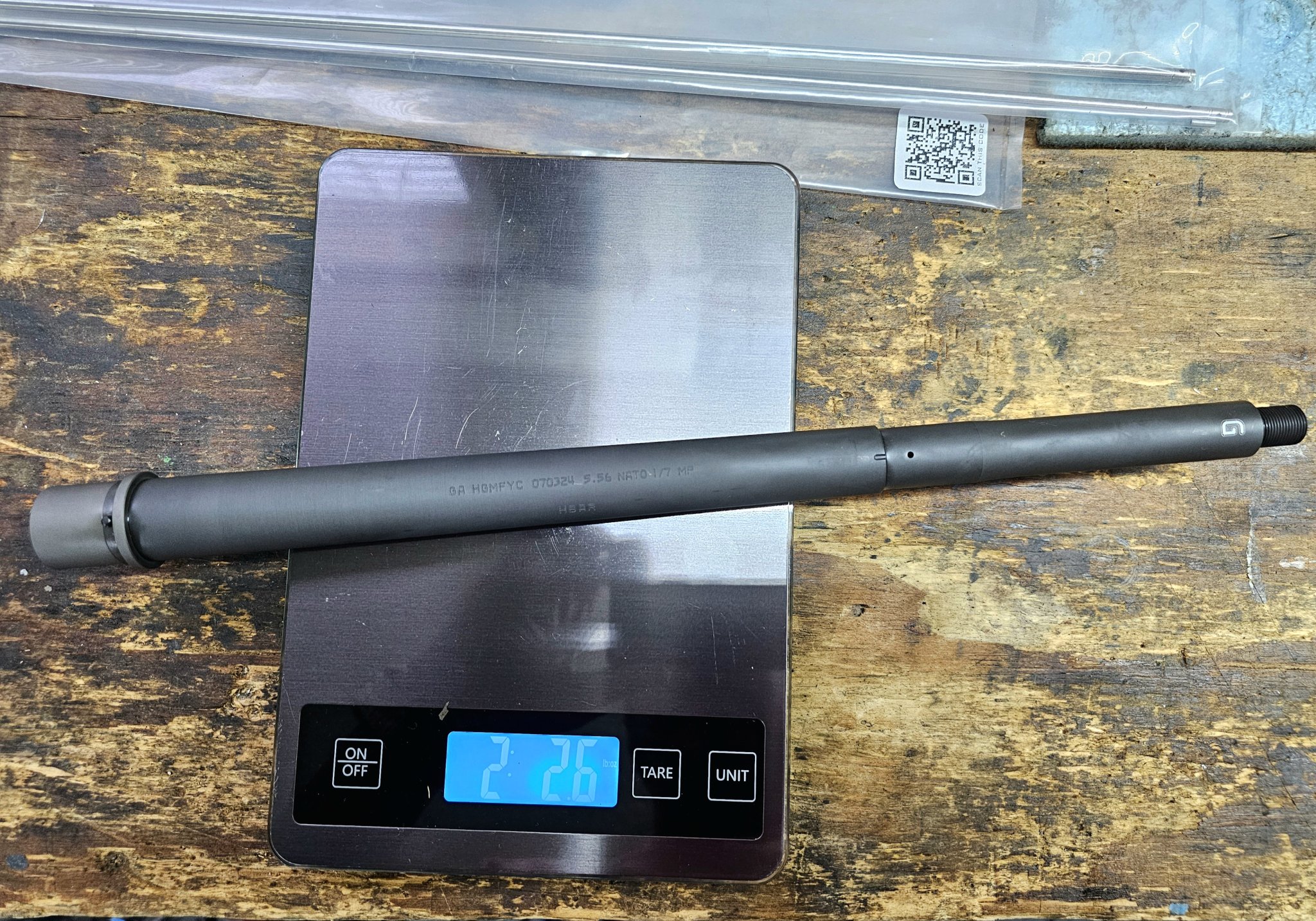

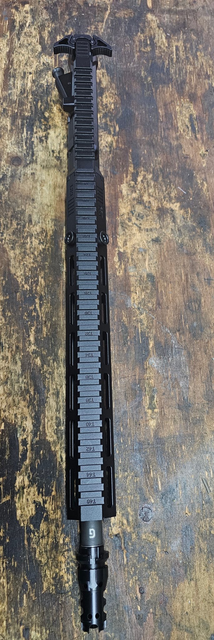

    The Broadsword Builder kit is extremely rigid and well built with clean machining work. The face of the Upper Receiver is true and showed virtually no Runout
    The Upper with it's heavy construction and increased flared forward surface area would be well suited for the heaviest profile barrels. Barrel installation requires a mandatory thermofit, no shims or Loctite required.

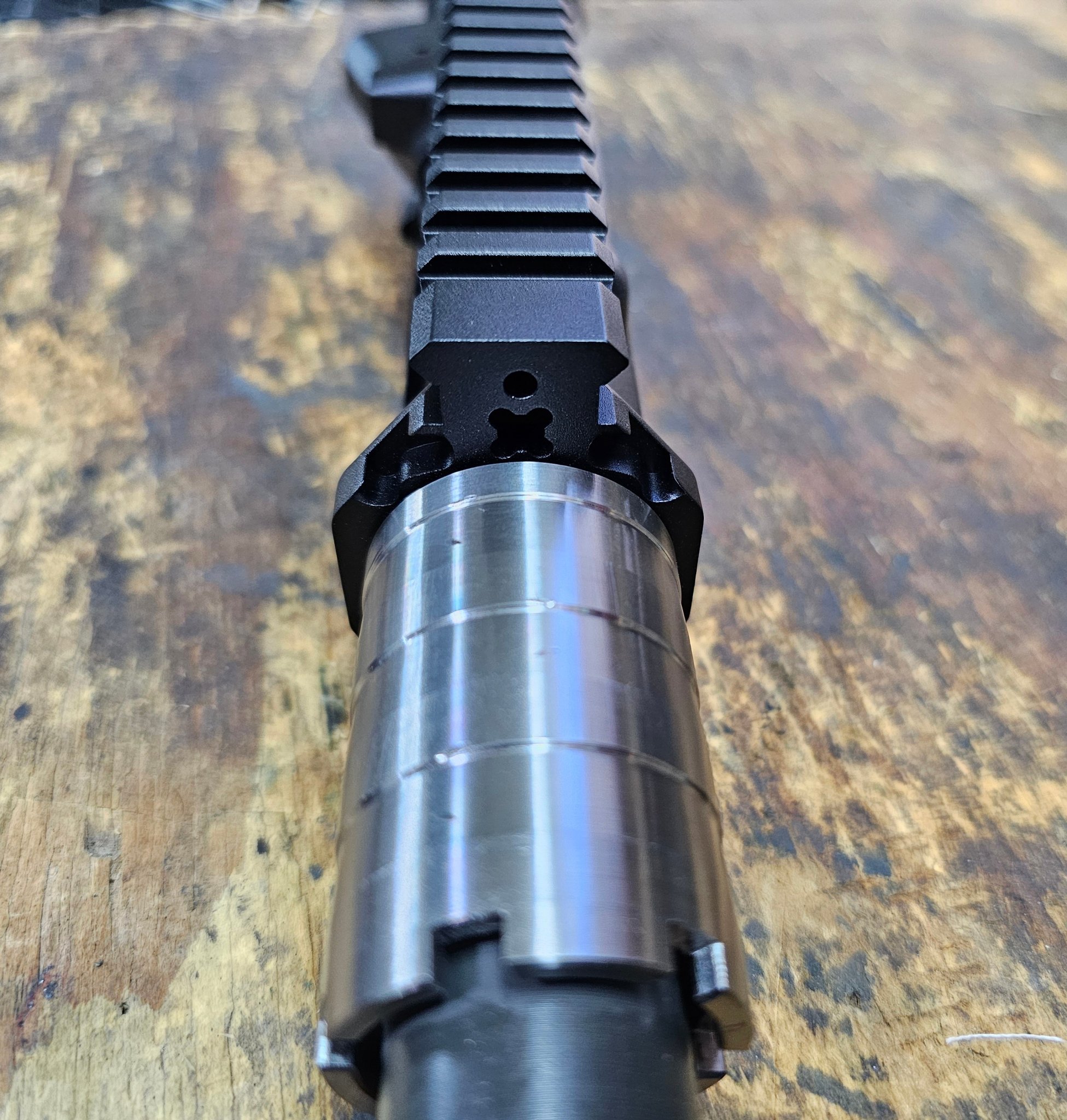

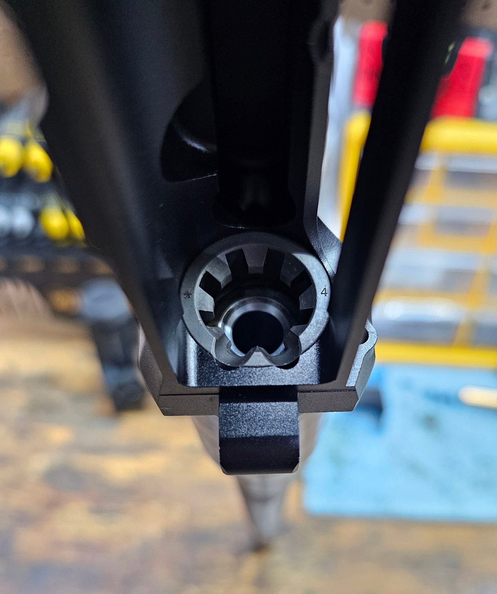

    Handguard to Upper Receiver fit is exceptional with its integrated anti-rotation tabs and pin create a Rrock solid lockup.

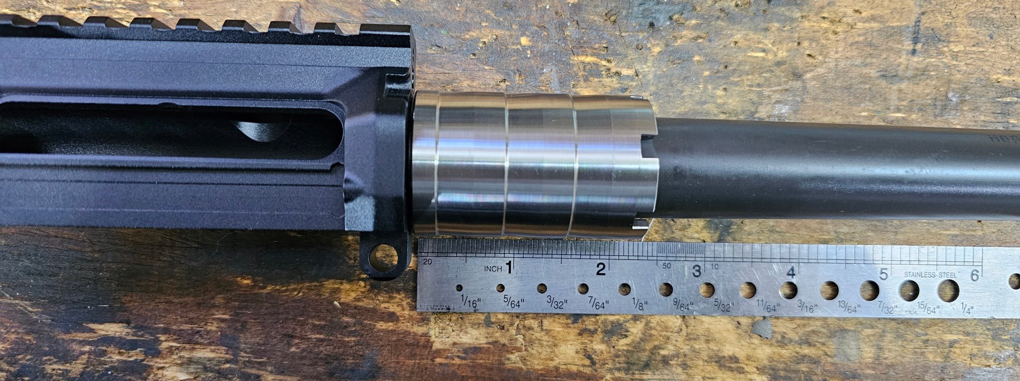

    The fit between the 2.5" Titanium Barrel Nut and Handguard are very tight, without even tightening the handguard screws there is no felt Handguard flex. Once the opposing hand guards screws are torqued down with it's wedged Barrel Nut/Handguard design there is absolutely zero flex.

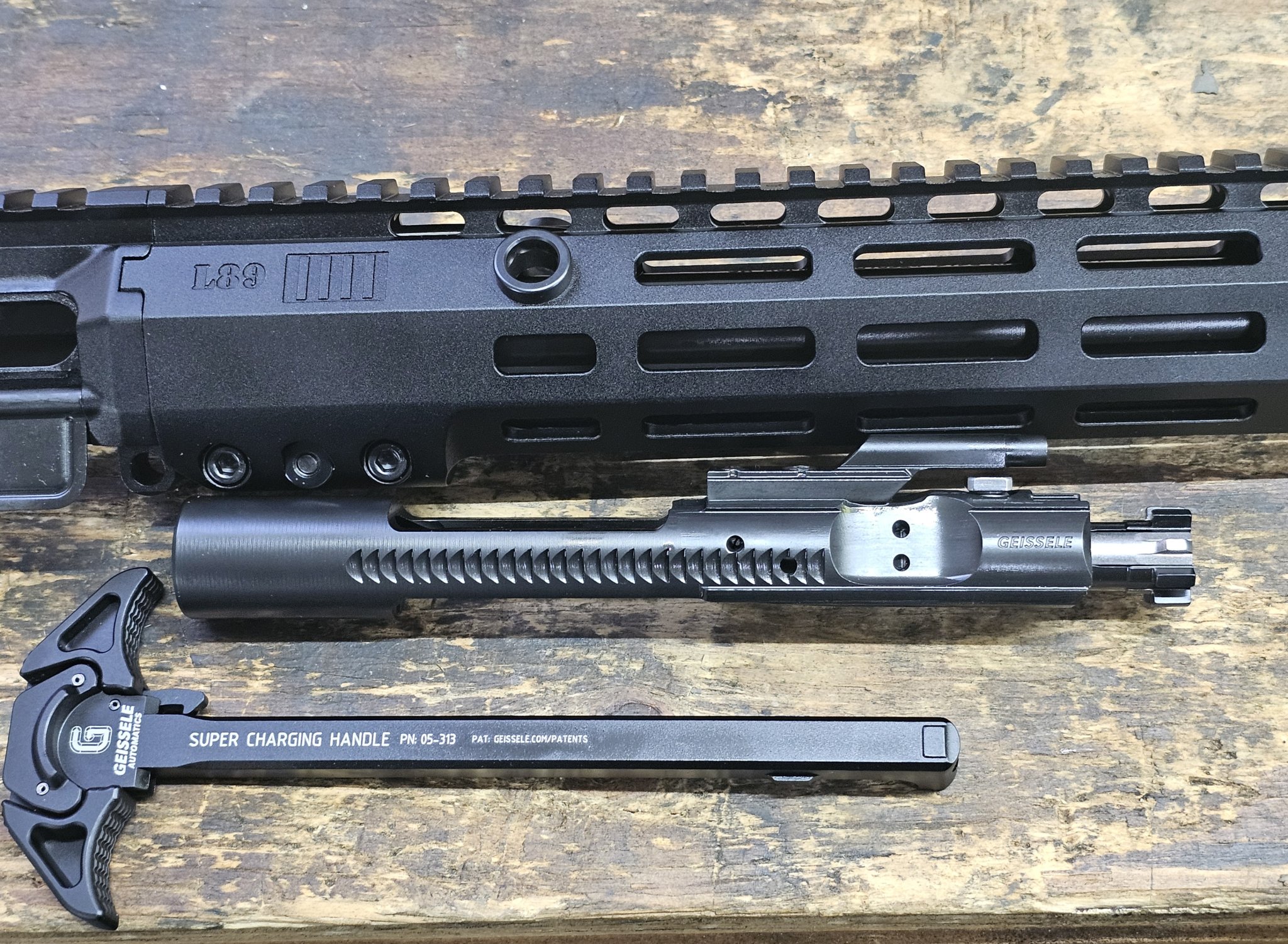

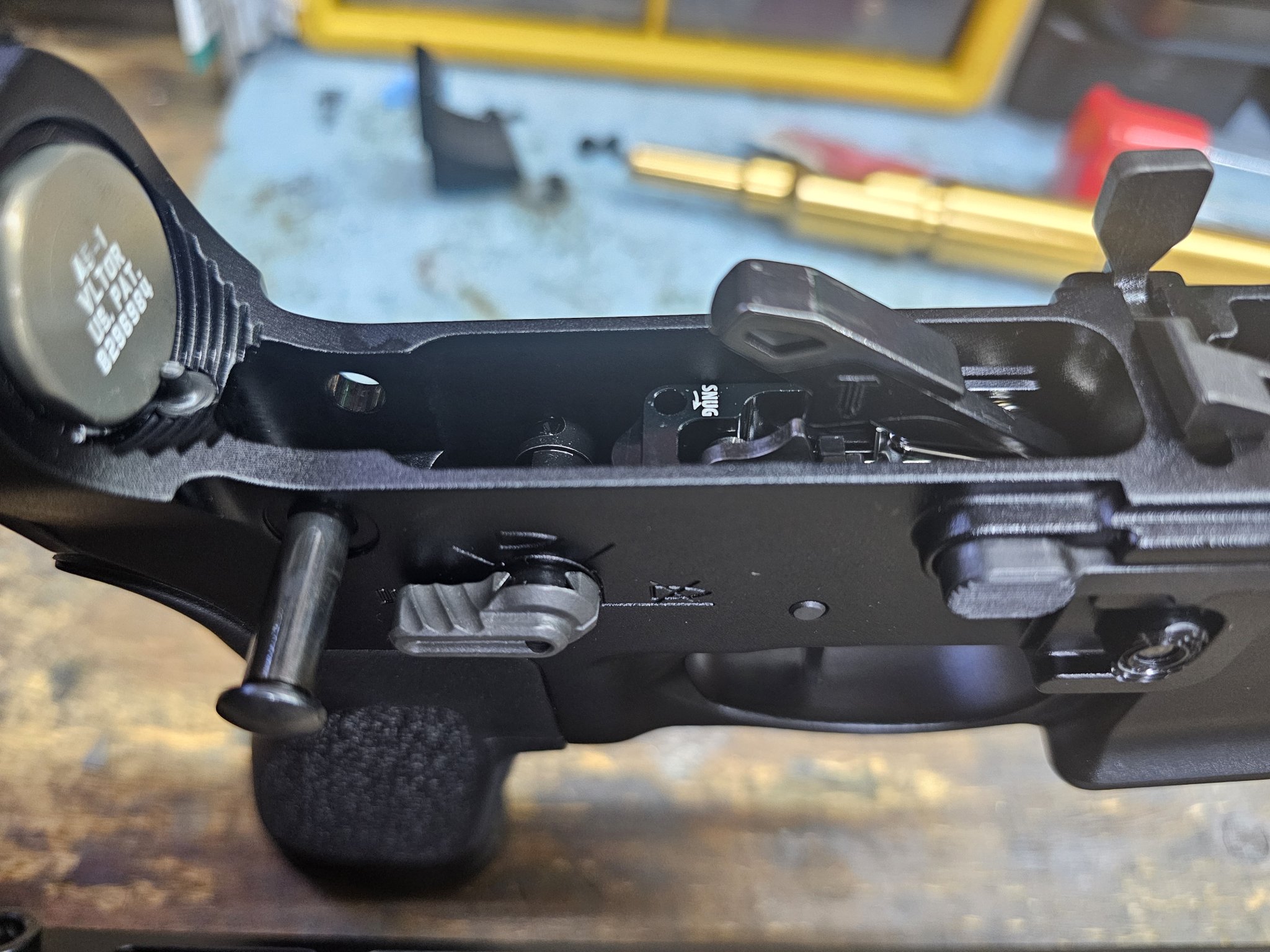

    The only down side I would say is thier Broadsword Lower Receiver doesn't have the Full Ambidextrous controls that most quality manufacturers have today.
    One of the notable enhancements I do enjoy with the SOLGW lower is they have elongated the grip position so if you have large hands it puts your Trigger Finger in perfect placement.

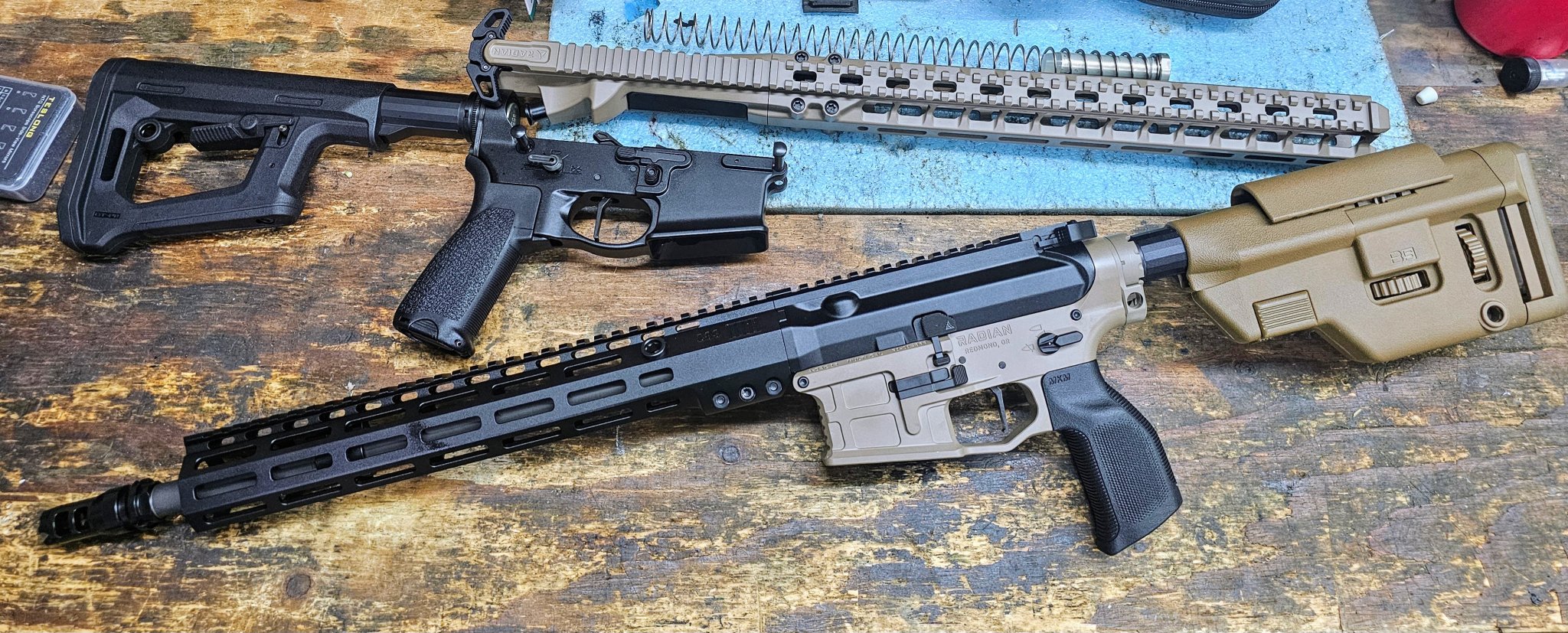

    The Complete Build list is as follows:
    SOLGW Broadsword Build Kit with 13" L89 Handguard.

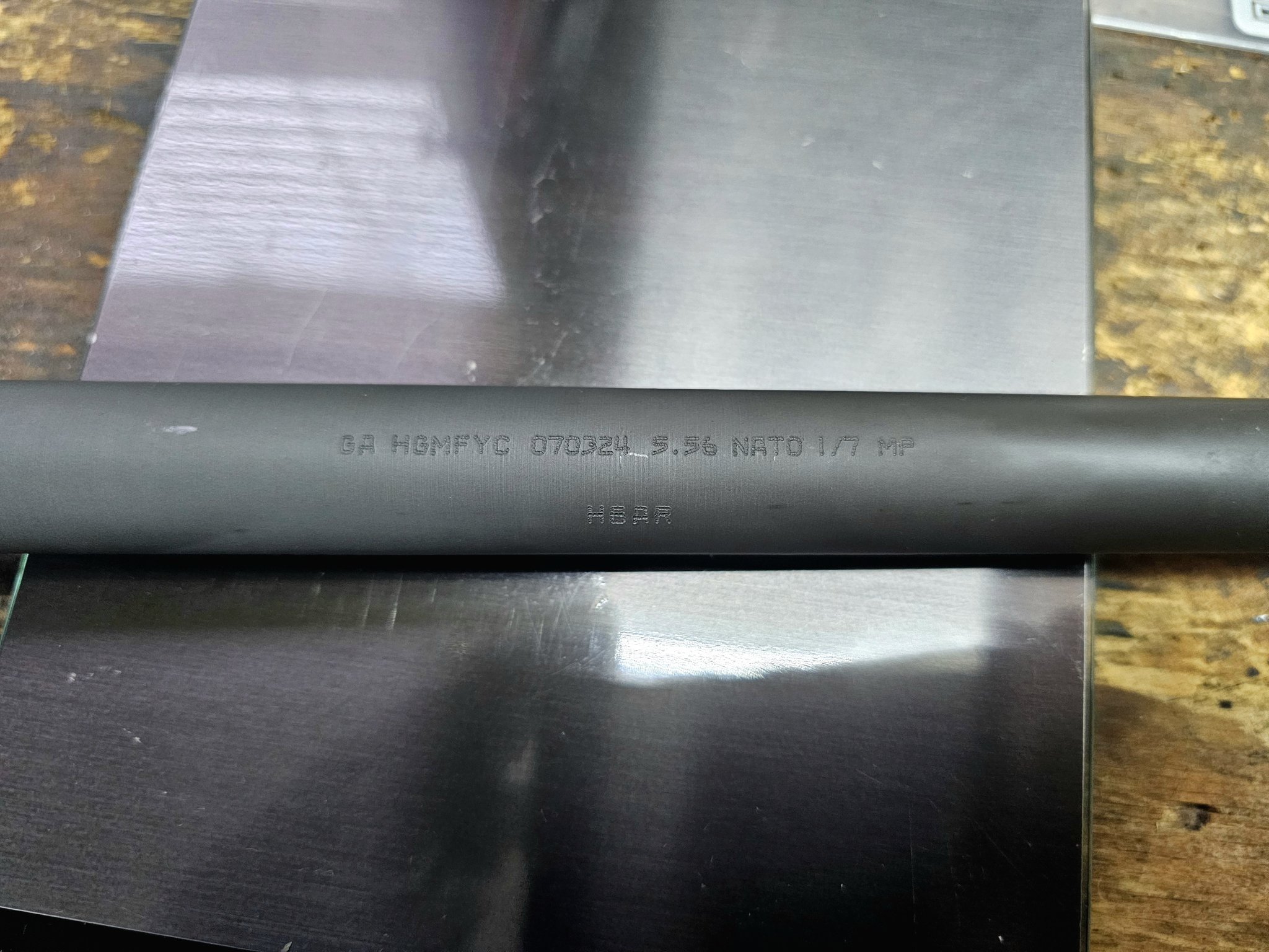

    Geissele's new release Heavy Contour Barrel.
    SPECS
    LENGTH: 14.5"
    WEIGHT: 2lbs 2.6oz
    RIFLING: Cold Hammer Forged
    PROFILE: Geissele Heavy Profile
    GAS LENGTH: Mid-Length
    GAS BLOCK DIAMETER: .750
    GAS PORT SIZE: .076
    MUZZLE THREAD: 1/2 x 28
    CHAMBER: 5.56
    TWIST: 1-7
    BARREL EXTENSION:M4
    MATERIAL: Chromolly Steel
    FINISH: Manganese Phosphate

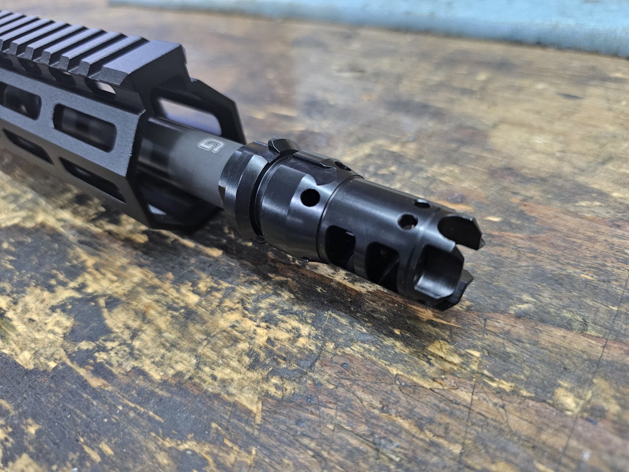

    Lantac Dragon Dead Air KEYMO Wolfman 5.56 Muzzle Brake.
    Surprilitive Arms .750 AGB.
    Geissele Ambi Charging Handle.
    Geissele 5.56 Enhanced AR-15 Bolt Carrier Group - Nanoweapon.
    TriggerTech AR-15 Single-Stage Competitive Trigger with flat trigger shoe 3lbs Fixed. (Breaks Clean at 2lbs 10oz)
    JP Hand Fitted Takedown Pins.
    PWS QD End Plate and Castle Nut.
    BAD 60/90 Ambi Safety.
    Vltor A5 Buffer system with JP polished Rifle Length spring.
    MagPul DT-PR Carbine Stock.
    Range Report to come.
    Jake.

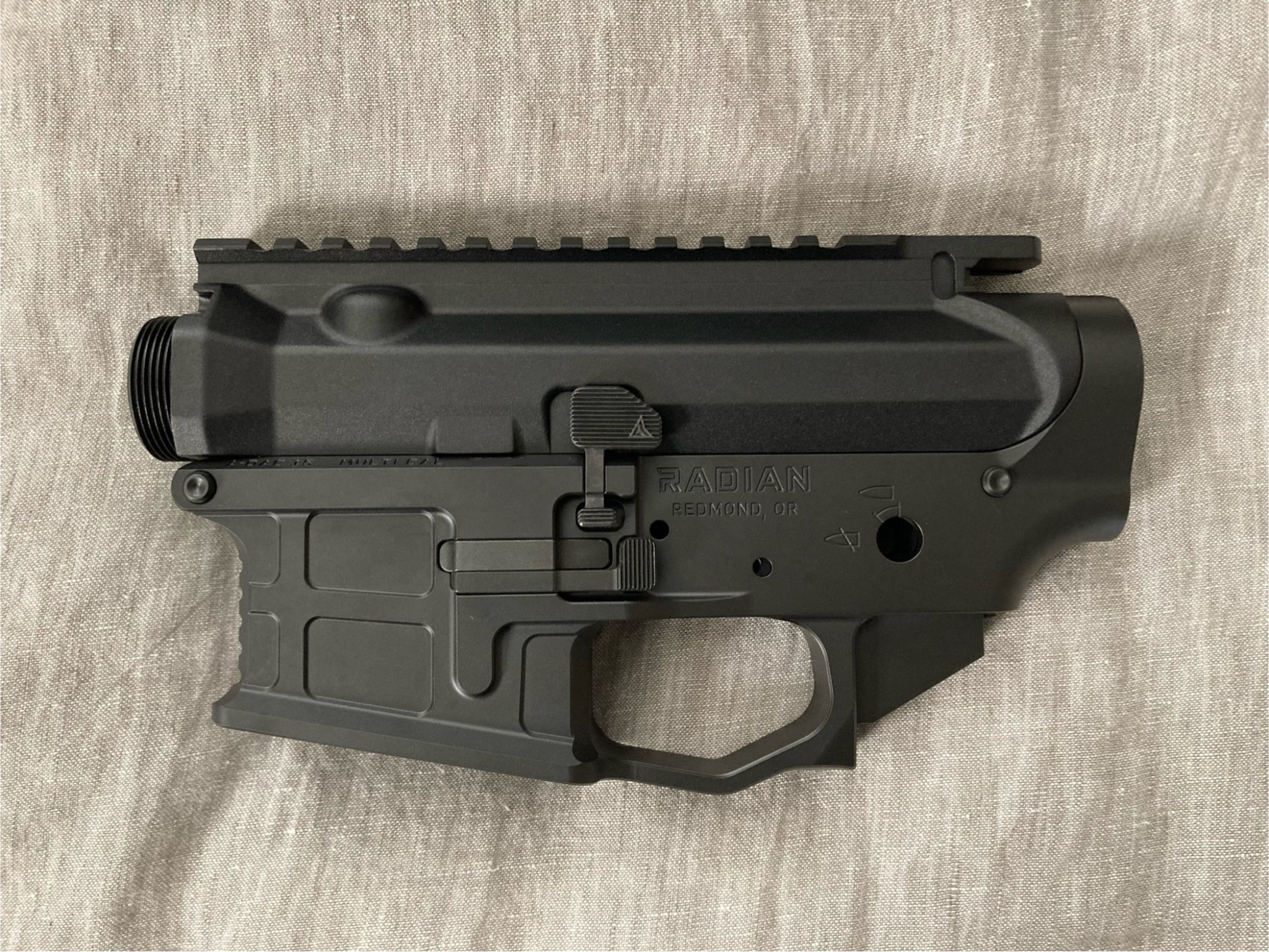

    Did you ever get a chance to check the fit with the SOLGW 89 upper on the Radian lower?
    Reactions: NHPiper
    @bigjake83 - Awesome stuff. SOLGW has really been putting out good stuff lately. Although I think Mike Miller at Icon Defense is the guy behind the Drivelock rail and these receiver sets. I'm pretty sure he's the OEM for SOLGW. Not surprised at the quality since Mike is the original founder of Mega Arms.
    Not yet, I'll play with them tomorrow.
    SPECS
    LENGTH: 14.5"
    WEIGHT: 2lbs 2.6oz
    GAS PORT SIZE: .076
    CHAMBER: 5.56
    TWIST: 1-7
    BARREL EXTENSION:M4
    View attachment 8542260View attachment 8542261
    View attachment 8542268View attachment 8542269View attachment 8542270View attachment 8542271View attachment 8542272View attachment 8542273View attachment 8542274View attachment 8542275View attachment 8542276View attachment 8542277View attachment 8542278View attachment 8542280View attachment 8542281View attachment 8542282View attachment 8542283
    Jake.

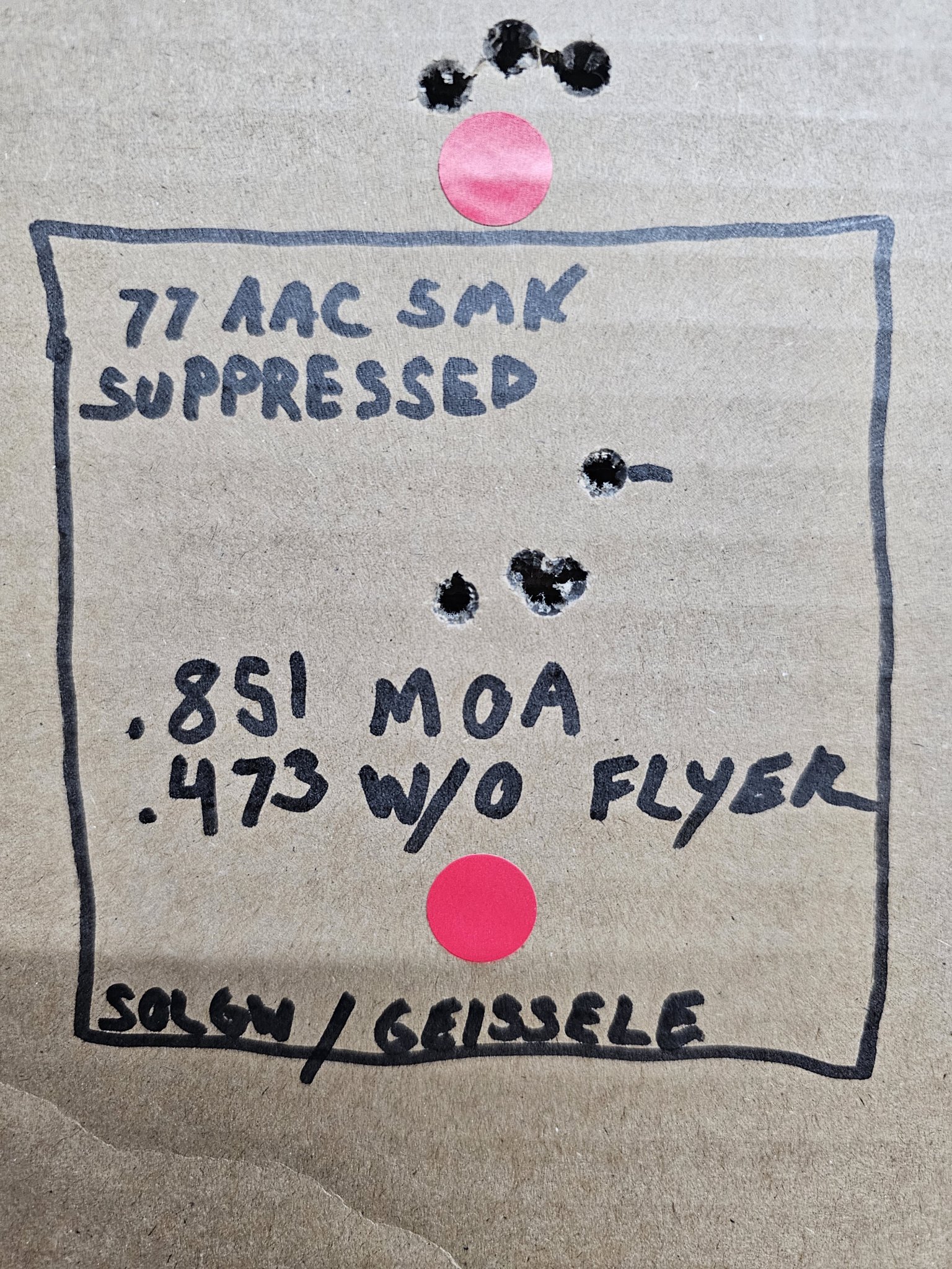

    As promised, it matched up pretty well.
    But not at tight as the Complete Radian MOD 1 Upper and lower.

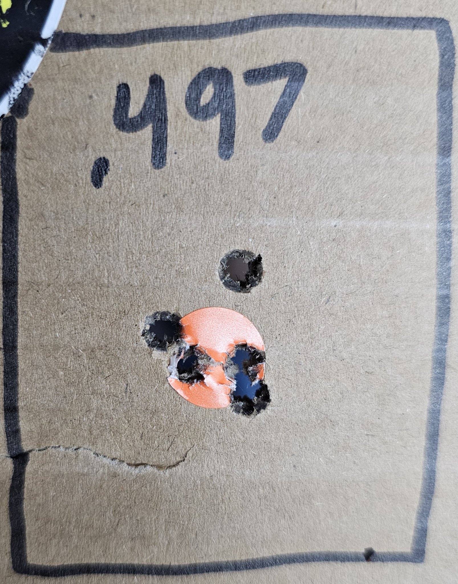

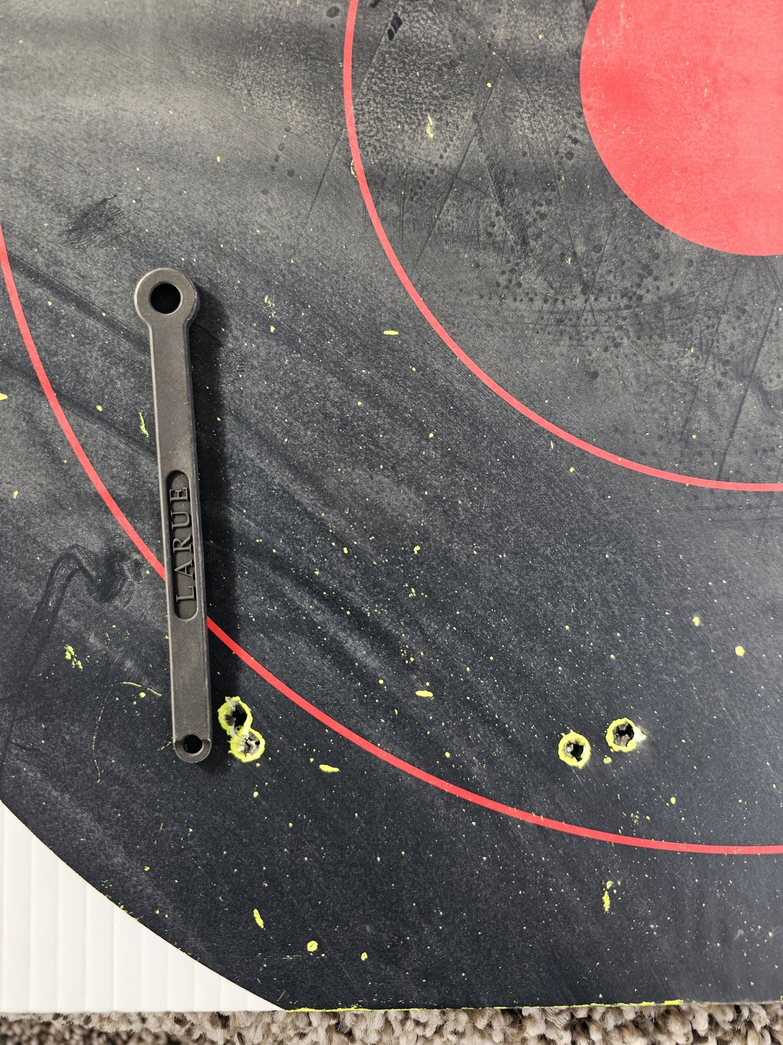

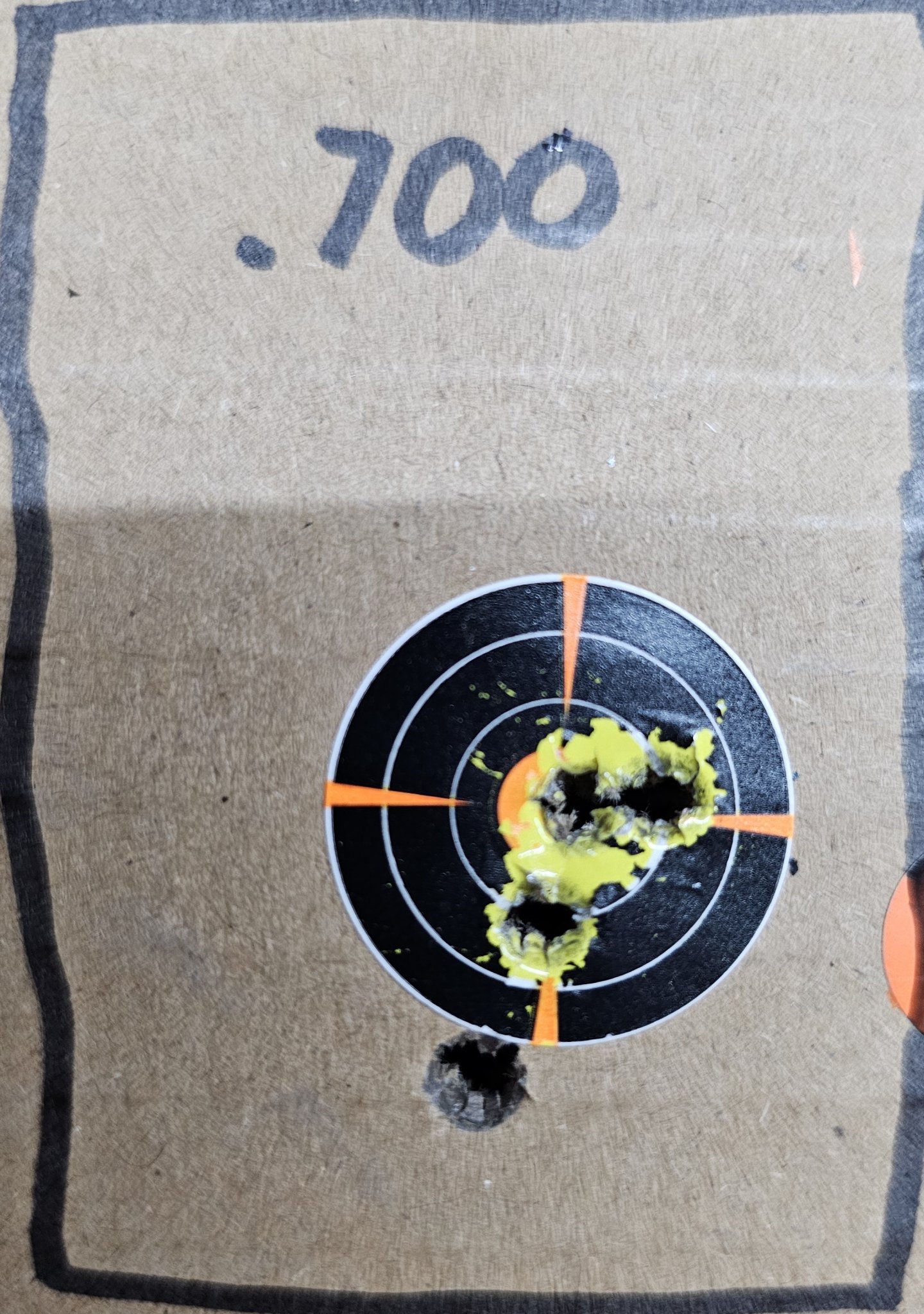

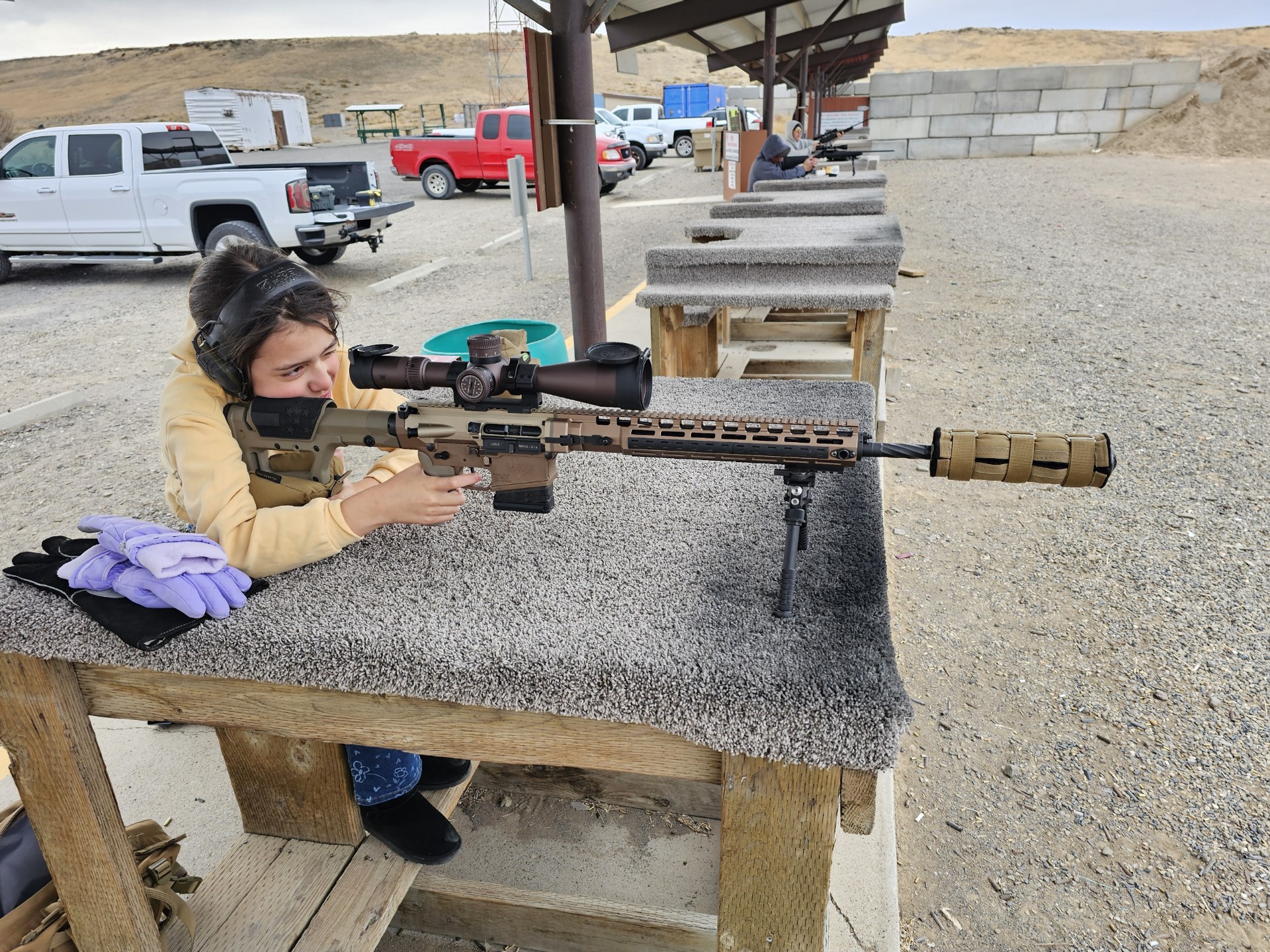

    The Geissele Barrel is an absolute Hammer!!!!

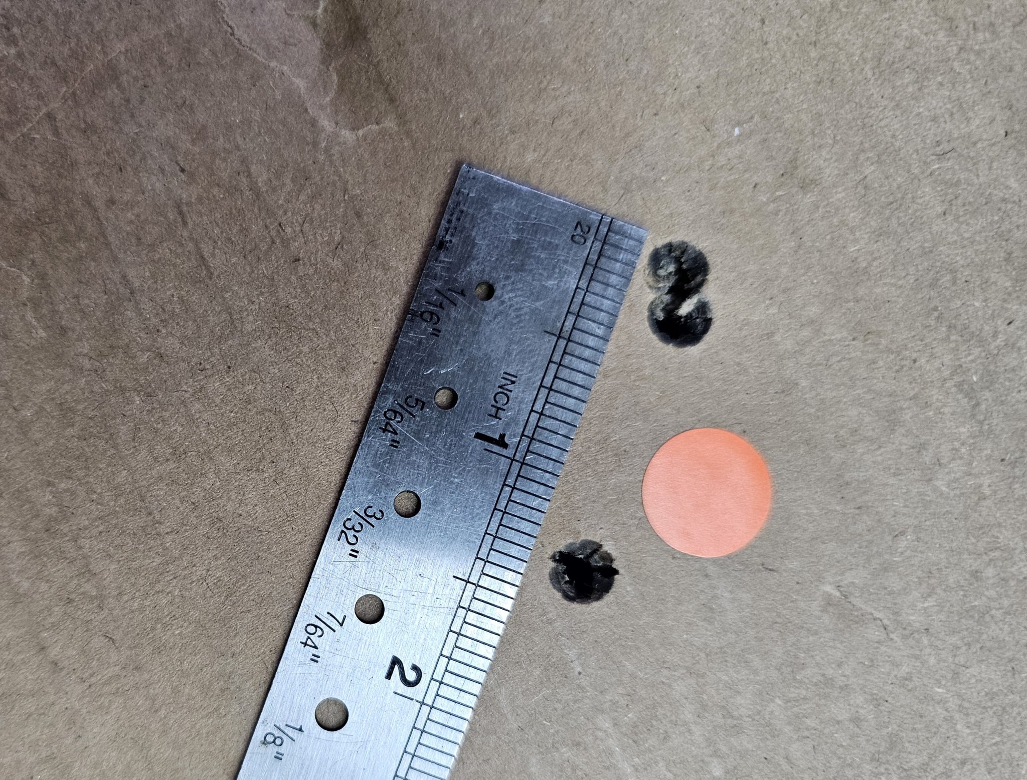

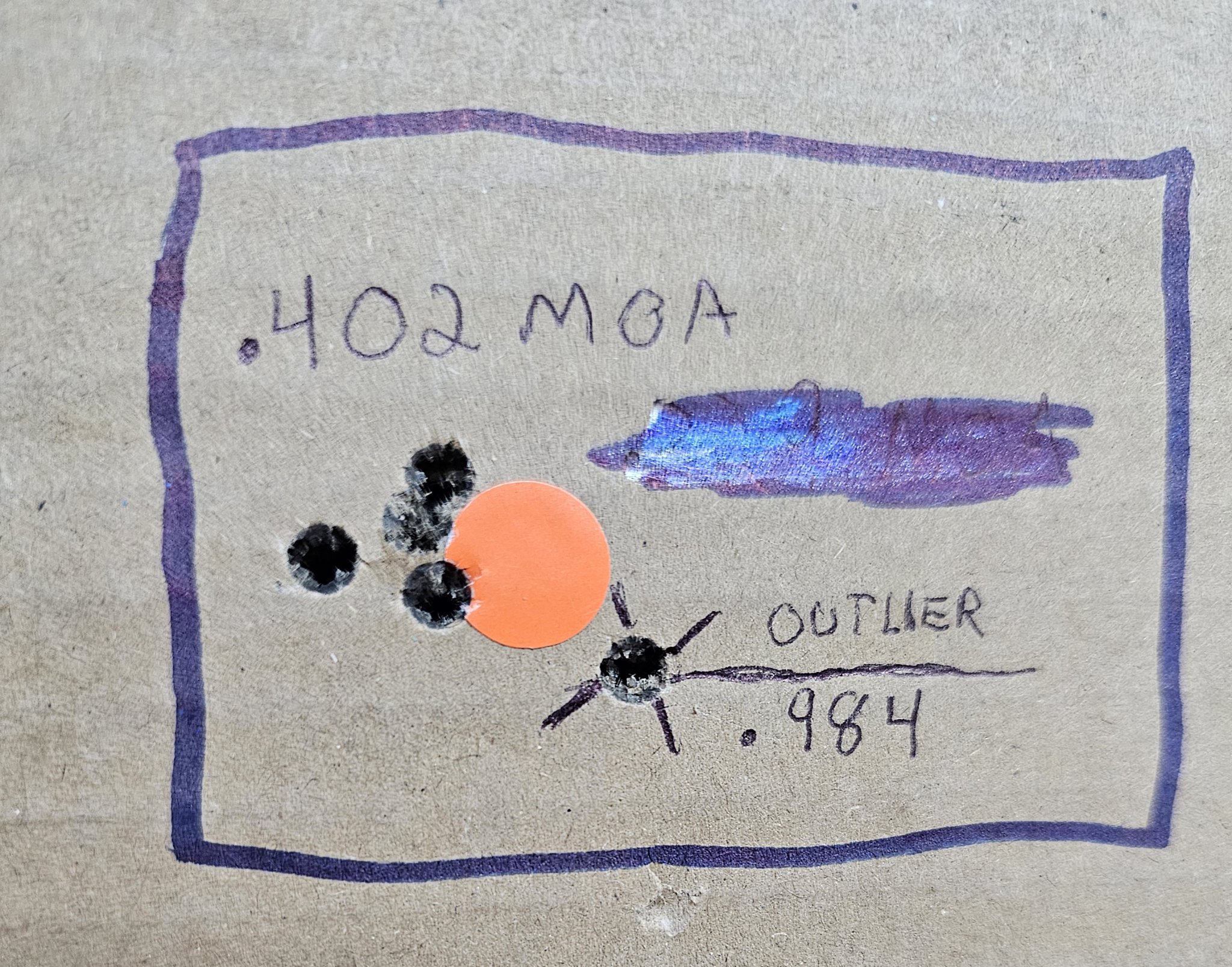

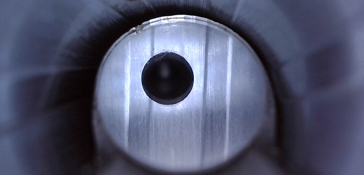

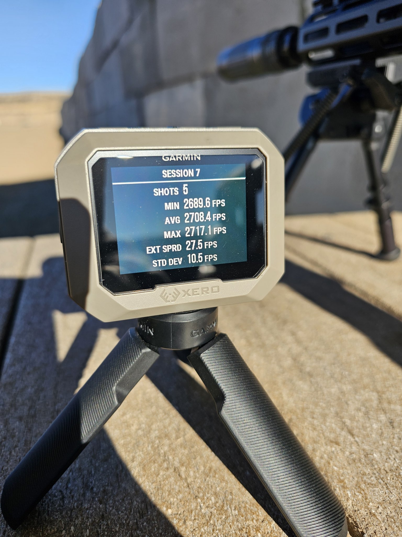

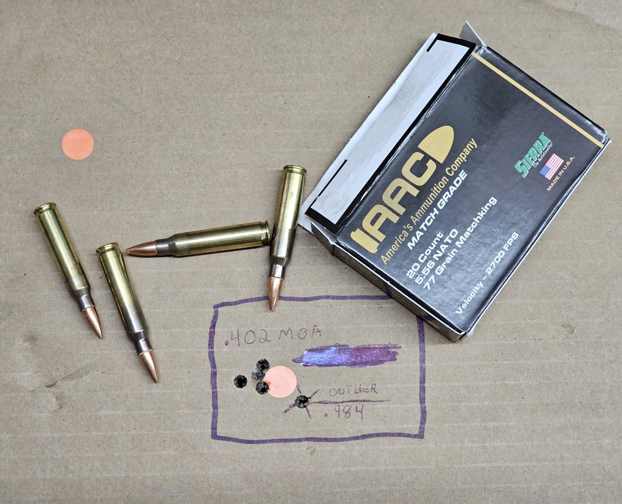

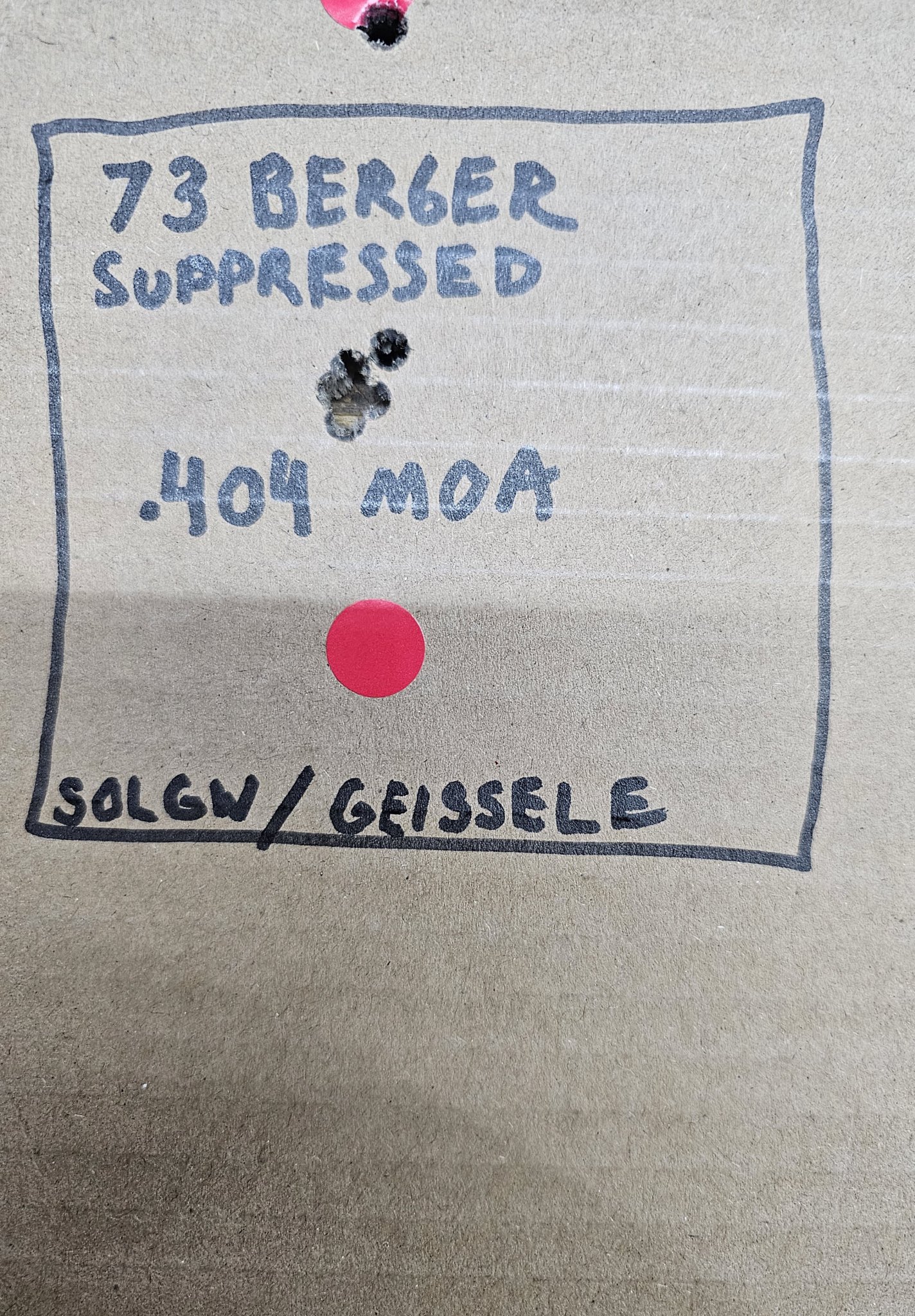

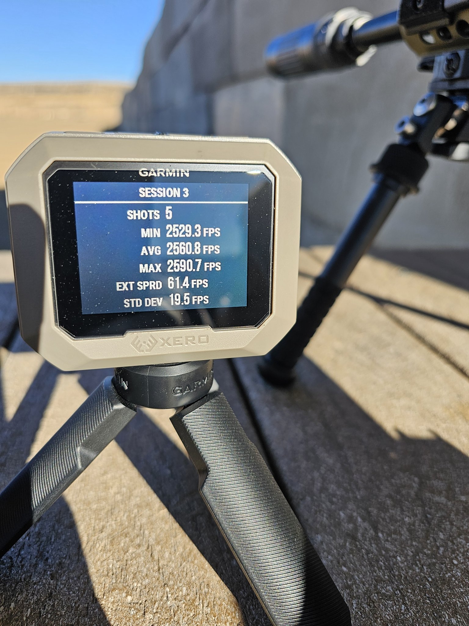

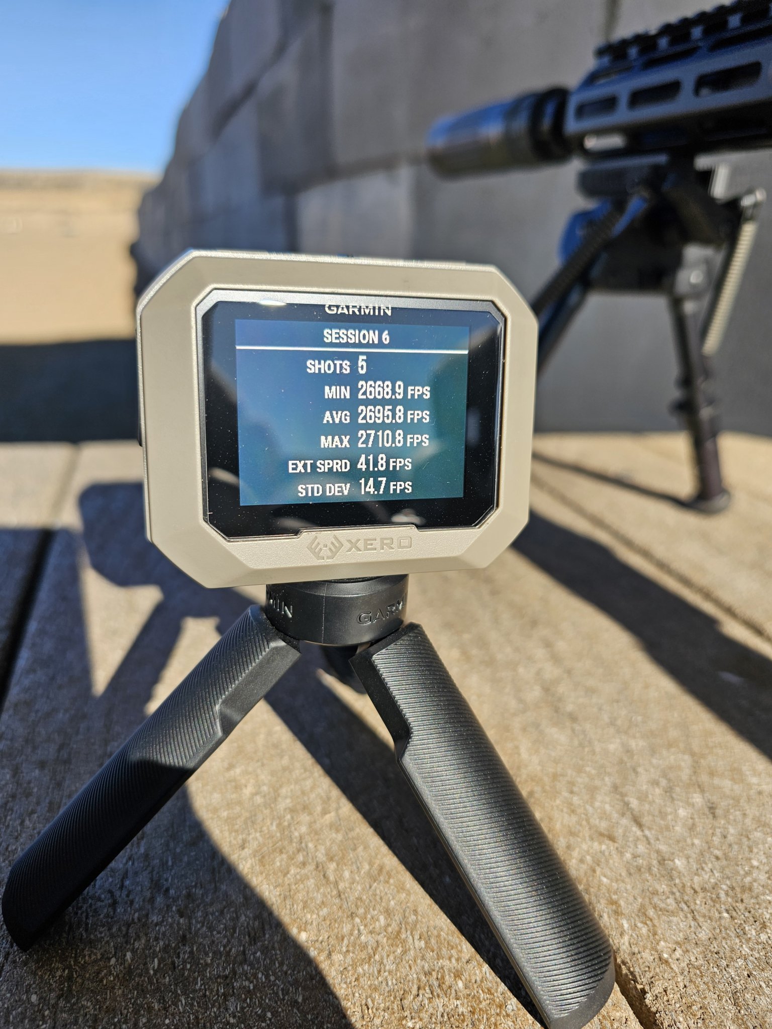

    I performed Barrel Break-in by shooting one, clean and bore scope X5. Aftet that I only had time for one 5 shot group and to sight the scope in and tune the gas block.

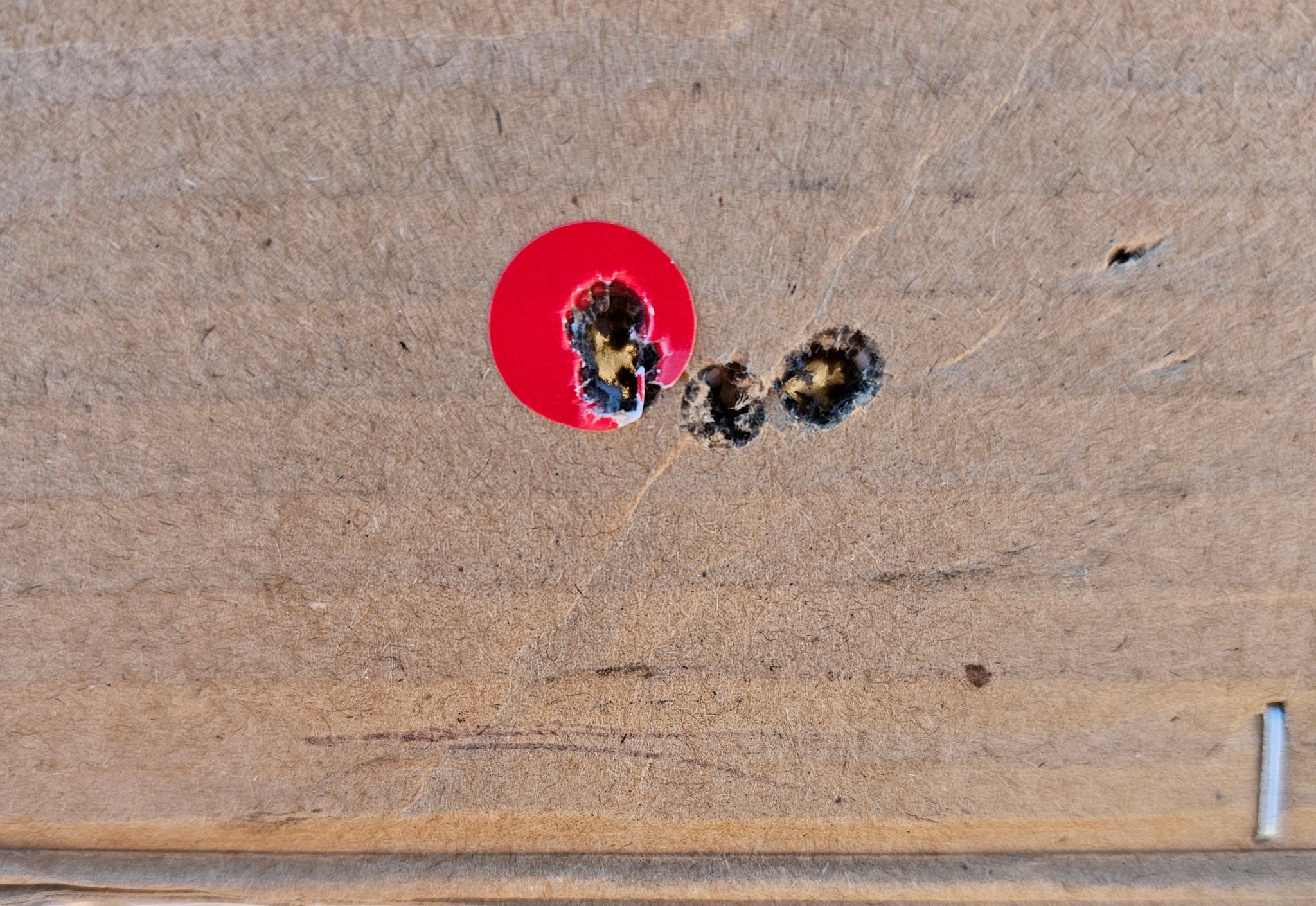

    Here's one 3rd group and one 2rd during brake-in and cleaning.

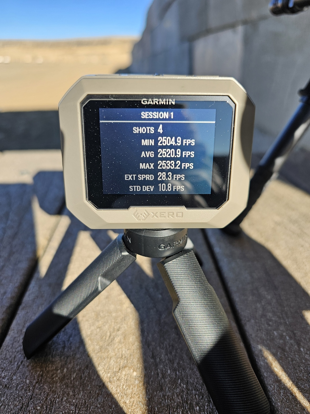

    The 5rd group was a pleasure to shoot, the A5 Buffer system is as smooth as any of my JP rifles. I have not idea what happened on the 3rd shot, it's was a clean shot/break so I'll chalk it up as a outlier with the cheap AAC ammo.
    When I have time I'll take it out again with some 77, 73's FGMM.
    Reactions: bigjake83
    Great first range session and definitely good to see one of your kids out enjoying it with you. We may be learning from her one day 😉.
    Looking forward to some good time behind it with multiple 5 rds or 10 rds groups to see how it fairs with consistency.
    Thank you,
    I have no doubt it will only get better, I'm so confident I bought two more barrels.
    Reactions: B Man
    We just had our first, a boy, last week. I'm already excited for him to start reloading with me and shooting. There is a local 4H shooting club which lets the kids run different steel challenge and IDPA matches. I'm hoping we can add in some 22 or center fire PRS.
    Great to see your daughter enjoying the sport.
