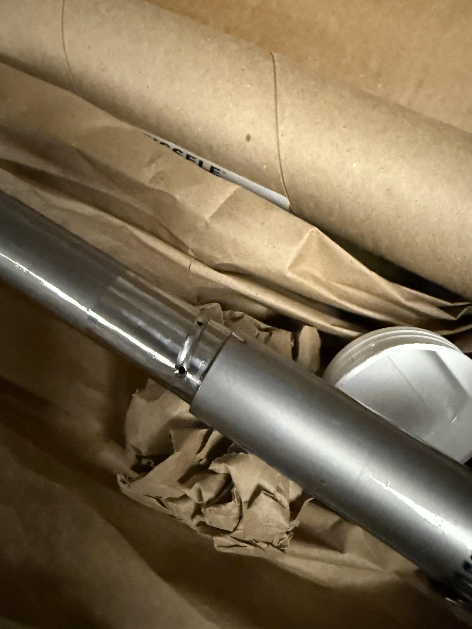

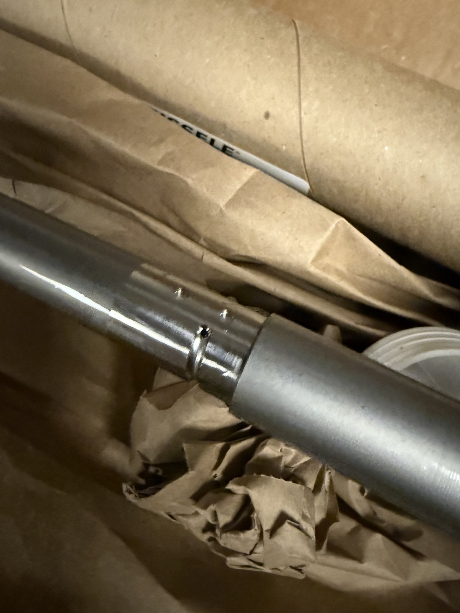

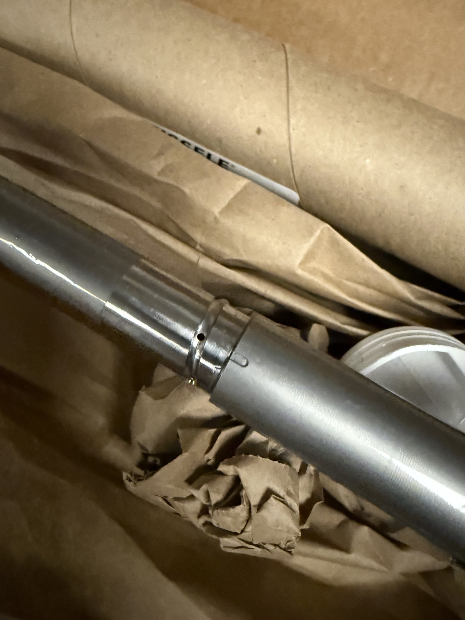

    My tracking information has the barrels arriving on the 6th, I'll post pics with full details when they arrive.
    I have everything needed to assemble them into complete Uppers.
    I went with the following parts.
    Vltor Mur FDE upper receiver for increased rigidity over the standard Geissele upper receivers.
    Geissele FDE 15" MK16 Handguards.
    Standard low profile Plain Jane Gas blocks, I would normally go with SA Set screw AGB but I'm sure as their standard Barrels are gassesd perfectly it won't be needed.
    I'll try the Geissele Gas Blocks but the pre drilled pinning hole gives me pause for potential gas leaks, I won't know my options until I have the barrels but I'll demonstrate on here what will be best suited for this application in full detail.
    ( When I do a finally assembly I always seal my Gas Systems with Loctite 620, the gas tube is sealed in the Gas block and the Gas block is fully sealed around the gas block journal.)
    Geissele Ambi FDE Charging Handle.
    For BCGs I pick up to different types.
    (1) BCM in FDE
    (2) Superlative Arms FDE Carrier and JP bolt kit with Springco Gas rings.
    Let me know if you have any specific questions or concerns and I'll do my best to address them.
    Also one of these complete Uppers will go to the PX.
    Jake
