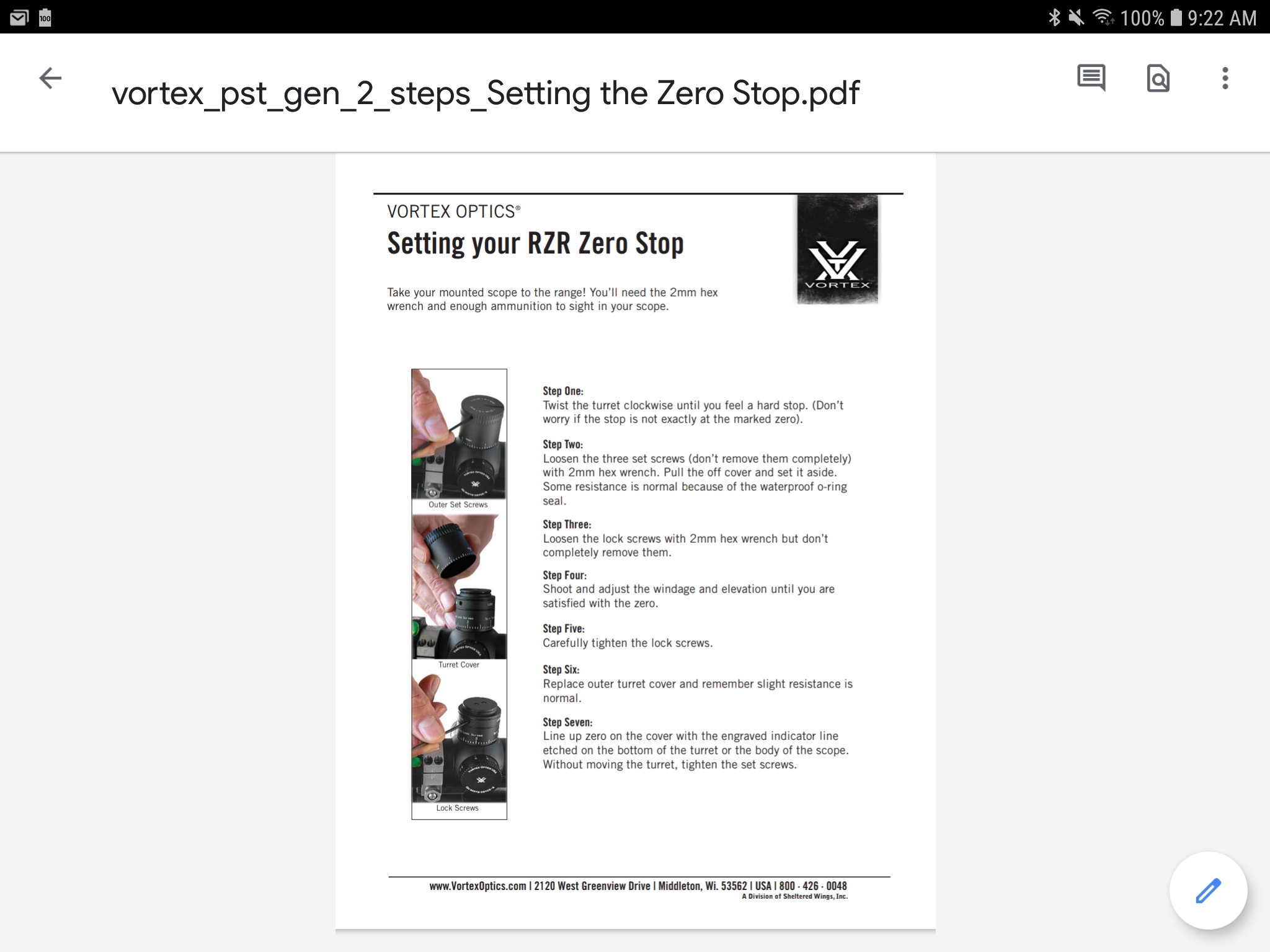

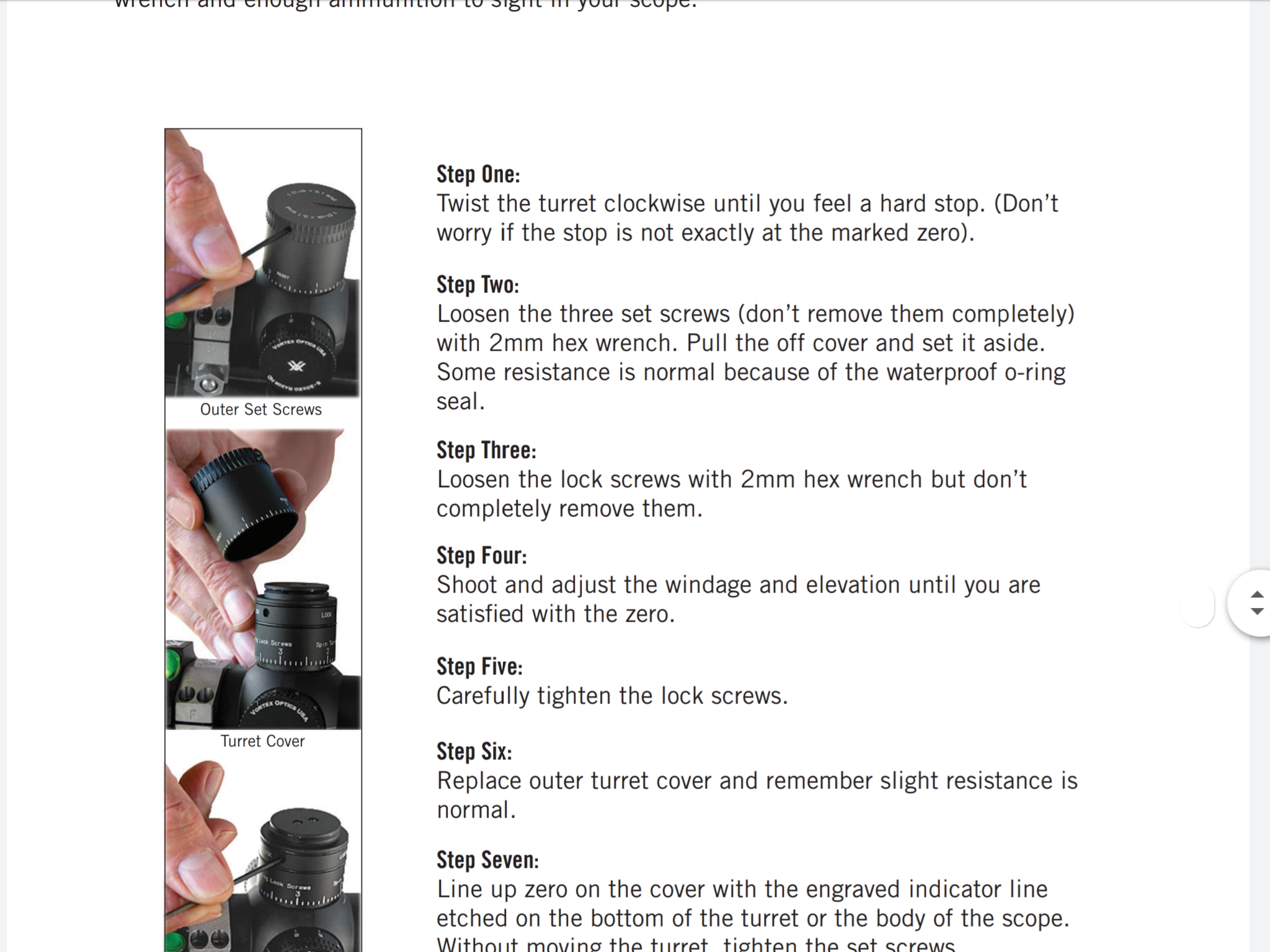

If you want the turret to stop on zero then run the turret down until it hits the zero stop. Loosen set screws. Pop of the turret cap. Loosen the set screws. Zero the rifle. Tighten set screws. Replace turret cap and index to zero. Tighten set screws and you are done.
All adjustments must be made AFTER you bottom out against the zero stop.

@Simple10- It sounds like your zero stop has slipped timing. If you email Vortex, they will send you a video on how to fix it, it is quite simple once you see it.
I don’t know what you mean. When these are zeroed, the turret must be run down to the zero stop. Done. All adjustment is done from inside the turret after the three internal set screw are loosened.
I'm not certified on the technicalities, so here goes. There is a widget in your scope that aint working right. Email Vortex and a nice man will explain it far better than I can. Then you will take the scope apart one step further than setting your zero stop, unfuck it, and put it back together. Then it will work right again.
I had a problem where I zero'd my rifle incorrectly, not in the factory specified order, and the tracking was way off. Vortex said I caused the timing to get out of sync and gave me instructions on how to reset to the turret to the factory settting. I did it exactly as the video shows, and boom....zero'd in no time. Here ya go:
Below is a step-by-step to ensure your optic’s zero-stop is reset, and functioning properly.
  1. Rotate your external turret clockwise, or in the “down” direction, until it stops or you encounter resistance.
  2. Remove the external turret by loosening the three set-screws on it’s perimeter.
  3. With the internal turret exposed, rotate it counter-clockwise, in the “up” direction, only about ¼ turn, and then back “down”, or clockwise, until it stops.
  4. Remove the top two screws from the inner turret.
  5. Applying slight downward pressure to the turret, again, rotate the turret counter-clockwise ¼ turn, and then back “down”, or clockwise, until it stops.
  6. Take note of the threaded receptacles, where the two top screws were removed. If they are no longer exposed, or partially obscured, carefully loosen the three set-screws on the inner turret, careful not to rotate the turret until they’re loose. Once all three are loosened, simply rotate the inner turret until those threaded receptacles are completely exposed.
  7. Reinstall the two top screws in the inner turret, leaving the perimeter set-screws loose.
From here, you optic is ready to re-zero. When you’ve achieved the satisfactory zero, simply re-engage the perimeter set-screws on the inner turret, engaging the zero stop. It will not matter where the inner turret is indexed at this point. Reinstall the exterior turret at the “0” position, and re-engage the perimeter set screws on it!
