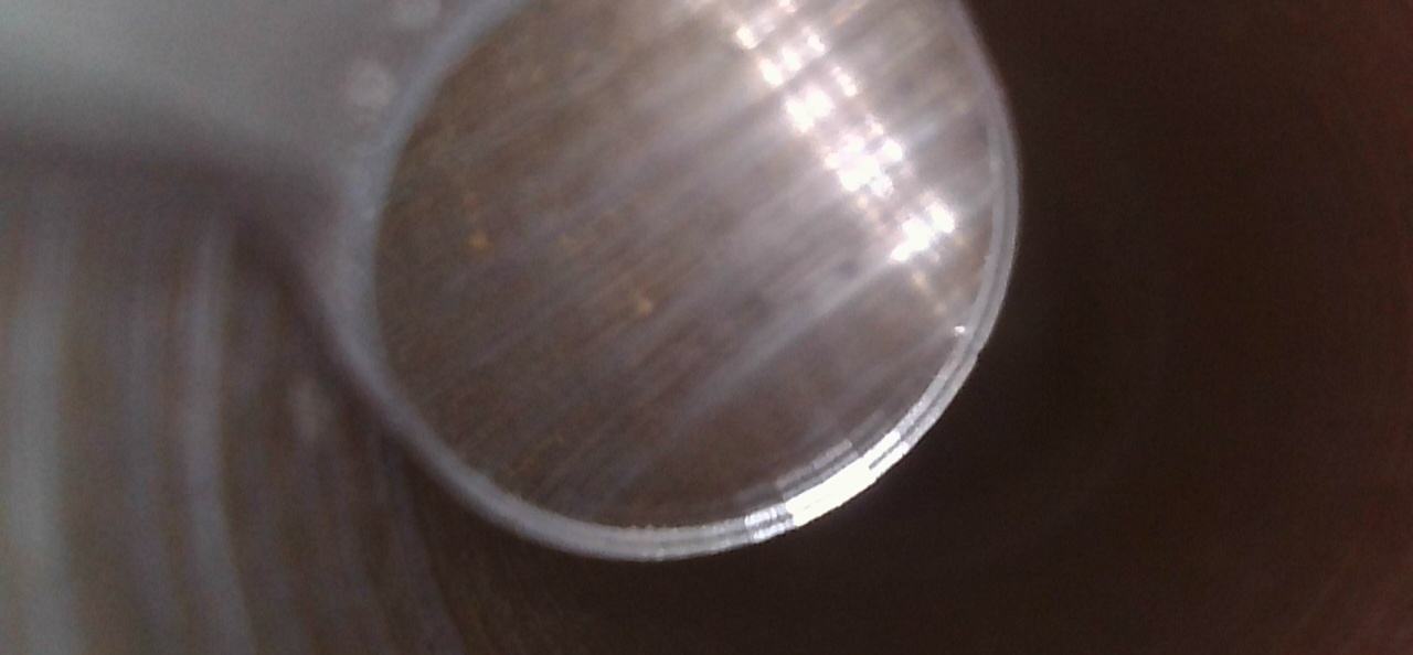

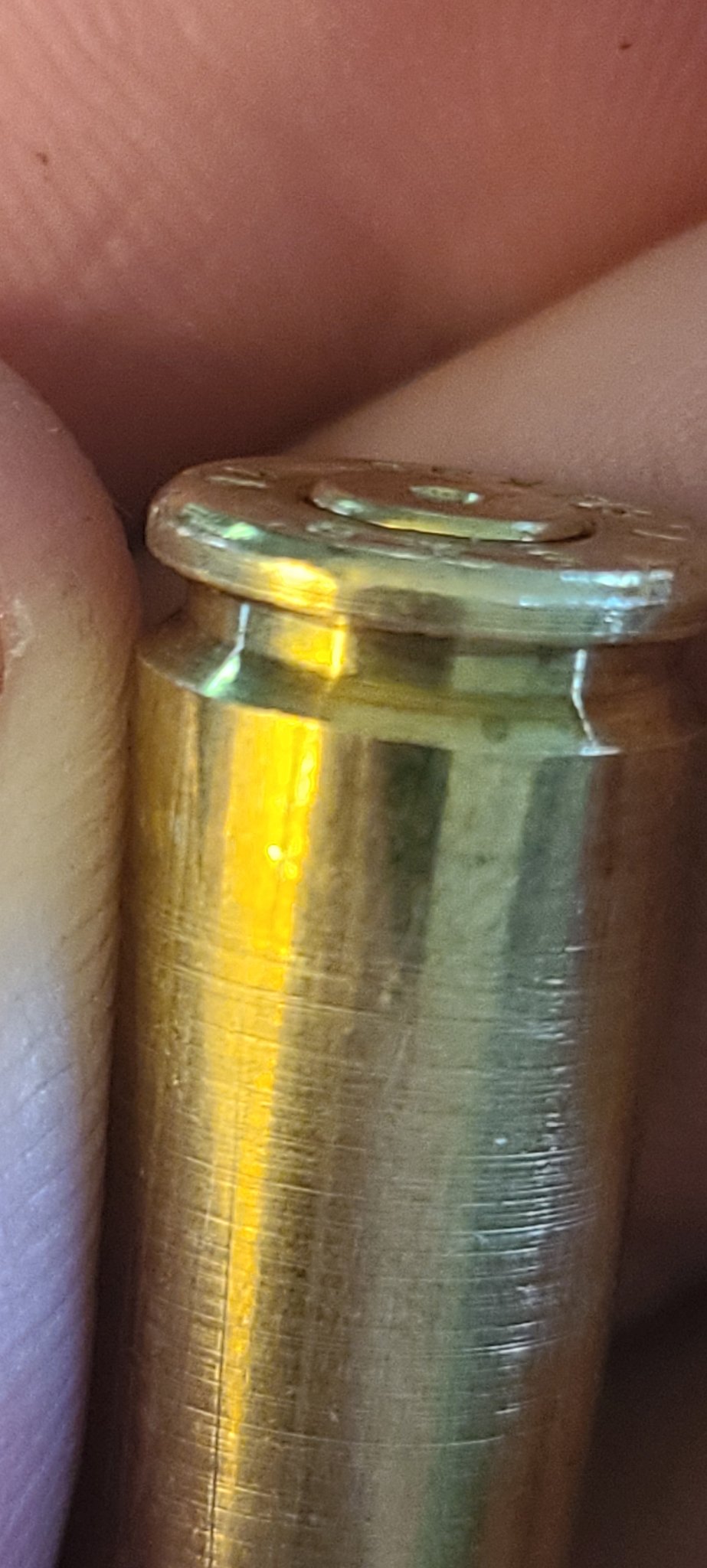

I'm in the process of trying to return this 7.62x39 Gen 2 Ruger ranch for warranty. Anybody care to speculate on the odds of this being covered under warranty? I have never had a new rifle push the primer out because of the headspacing, or a chamber mark the brass up this much... Not sure what I should expect but this ain't it.
SAME BOX of S&B ammo works flawlessly in SKS and Type 81. No pressure signs or primer ejection.
1. failure to extract live rounds - Fixed by me
2. Headspacing/chamber tolerance issues causing the primer to extrude after firing.
3. Chamber quality issues. Poor / Rough reamer job leaving concentric grooves in the fired brass.
Is the chamber on this gun excessively loose? Is the rough chamber preventing the brass from fireforming back into the bolt?
ruger should cover it under warranty , they have great customer service
i sent a ruger ranch in 300blk back not long ago for weak ejection and they replaced the barrel and bolt , they are pretty quick on their turn around time also
I have been emailing weekly. I believe they have replaced the barrel, muzzle brake, and extractor. Apparently it takes about a week to change an extractor and currently 1.5 weeks and counting to test fire the rifle...
Ended up going over Gravel agency and straight to Ruger international. I voiced some concerns with the QC, and the speed at which the repair was being completed.
Outcome: I have been approved for a replacement Rifle. I just have to wait for it to come in now.

I received my replacement rifle. and it's garbage again. below is my response.
The TLDR: The new gun has stripped threads in the receiver. I emailed Ruger international in a less professional manner than before because I'm frustrated.
""Hello,
I have received my replacement firearm.
Unfortunately, this rifle came with more issues. The threaded holes in the top of the action or very poorly tapped. I am referring to the fasteners that secure the scope rail to the action. 1 of them will not tighten beyond 2-inch pounds. The others I set to 12 inch pounds and they did not feel good. I believe the issue is that the machine which drills the holes and the subsequent machining action that taps the holes is not correct. There is noticeable fore-aft directional play in the screw when it is installed finger-tight into the action.
The cerakote on the barrel also looked to have issues. there appeared to be exposed metal.
Again, I purchased the original rifle in May. Waited until October for a replacement. and now the replacement you've sent me is also junk. Can I please just get my money back? I don't want a Ruger anymore if this is the quality of service and equipment that I receive. I have, and continue to document this on forums because it's pretty incredible how long a process this is. and to receive yet another bad Ruger is almost comical if it wasn't for the ~$950+ CAD investment.
If you have someone who can actually help me, instead of the glacial speed gravel agency. and ultra generic "this is our process" emails that would be great.
I expect an expedited replacement that, unlike the previous firearms, has quality control performed on it.
