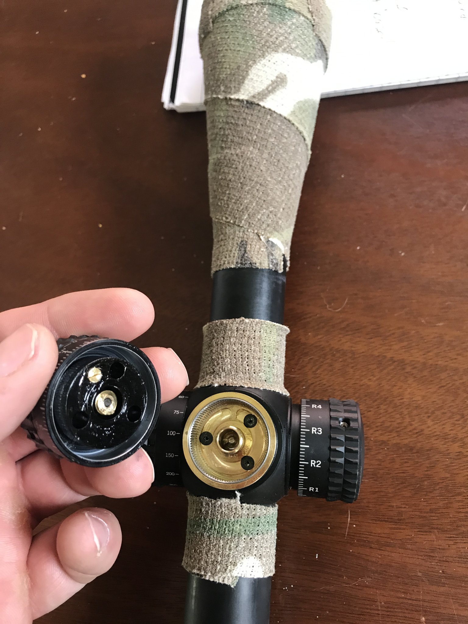

    The first week after I got my pst gen 2, I was at a match @ Q creek ranch, wyoming and the last stage after I finished, I was rewinding my turret back to zero and it broke. Called vortex monday, let them know I had another match the following weekend and they overnighted me a brand new one. You can’t beat that warranty service
    Mine broke exactly the same way.

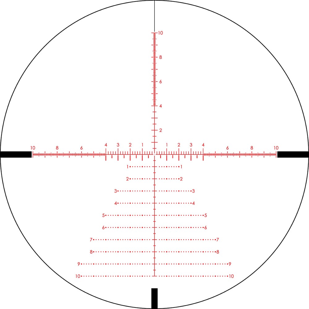

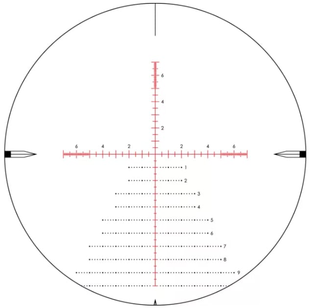

    It looks like one difference might be that the 2D the full tree does not illuminate, at least on the webpage for the 7C it appears it does illuminate the whole tree (but they may just be showing it illuminated since the Razor 2 comes with the 7C as well). The 2D absolutely does not illuminate the tree, just the main vertical/horizontals.
    2D has a solid cross, 7C has a dot at the center, dot is the new "it" thing to have.
    2D only has 1/2 mil hashes on the windage out to 4mil, 7C has 1/2 mil(bottom) and 0.2 mil hashes(top). Also looks like the 7C goes to 10 mil on the sides, the 2D only goes to 7 mil
    I do really like the dot instead of the cross, and if it does illuminate the whole tree on the PST 2 that's worth something, just not sure if it's worth the extra $200-300 compared to the 2D on sale.
    I have 7C version and the whole tree is lit. I debated the 2C or 2D...it was worth the premium for me to get the 7C.
