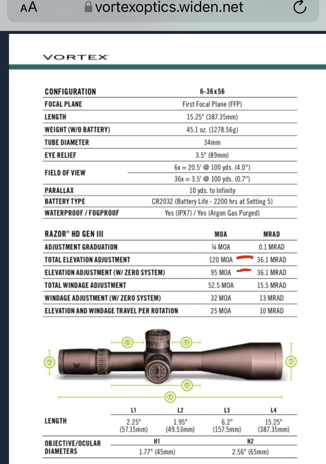

I sent my Gen3 to get all the elevation unlocked. On the moa version you only get up to 95.5 so for elr work I needed more.
I’m assuming there’s a rev limiter on the turret since it has a rev indicator. You don’t get the full travel of the scope in however many revs that is.Being mil or moa has nothing to do with the amount of internal adjustment an optic has.
Or have I missed something here![]()
You definitely missed something.Being mil or moa has nothing to do with the amount of internal adjustment an optic has.
Ok, I'll take my lashes if need be.You definitely missed something.
Is this your first time on the Hide?
Teaching moment for me then. I've never given this much thought.
95 moa is 380 clicksThats confusing - Is it limited on MOA version (and seemingly not limited on mRad version) because of keeping track of numbers past 100?
