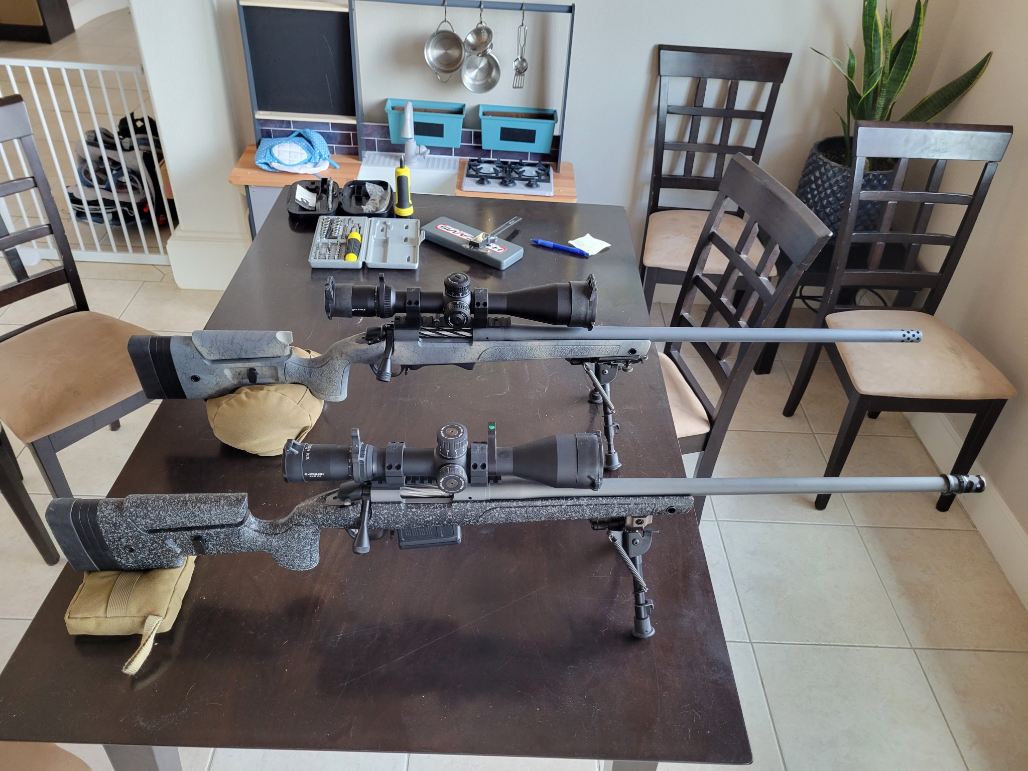

The bergara line is a great value. I have a 6.5cm premiere (now in a krg w3) that I shoot comps with and a 300wm hmr wilderness that just took an elk at 486yrs in the fog. Would buy both again in a heart beat.
