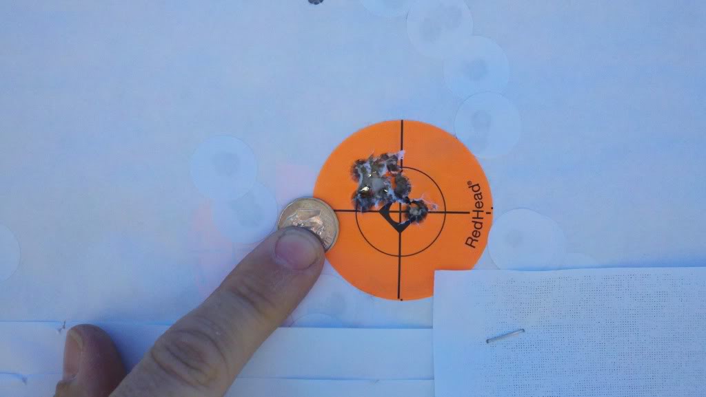

    I dropped one, Mea Culpa Mea Culpa
    Left target was FL sized Winchester cases averaging 158 grains in weight unloaded, right side was New Winchester brass averaging 162 grains in weight unloaded.
    Barrel clean and cold at beginning, sequence of firing was upper most left 1st, the upper most right, target top right second in, bottom right, bottom right second in, lft paper top right, left paper bottom right, bottom left left target.
    All loads functioned 100% today including lock back after magazine was empty. Lubricant remains SLIP 2000 EWL only.
    It would appear there is hope as yet. I still think that the barrel would prefer IMR 4895 for it's most precise attempts, but velocity remains behind with it.
