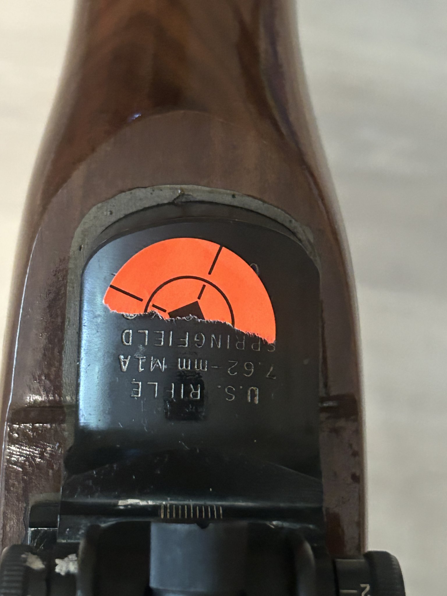

I inherited my dad’s M1A several years ago. He used to shoot service rifle with it in the late 80's-early 90's. His log books, and rifle info disappeared. A while before he had died, he said he shipped it off to be redone by a smith in Georgia. I know its an early SAI (30K range) with a lot of GI parts/NM parts. Its bedded to a heavy commercial stock. If I can get it apart I can look for info on the barrel. I am also assuming there are not a lot of smiths in Georgia that specialize in M1A's right? Any got any ideas or suggestions on where to look on the rifle?

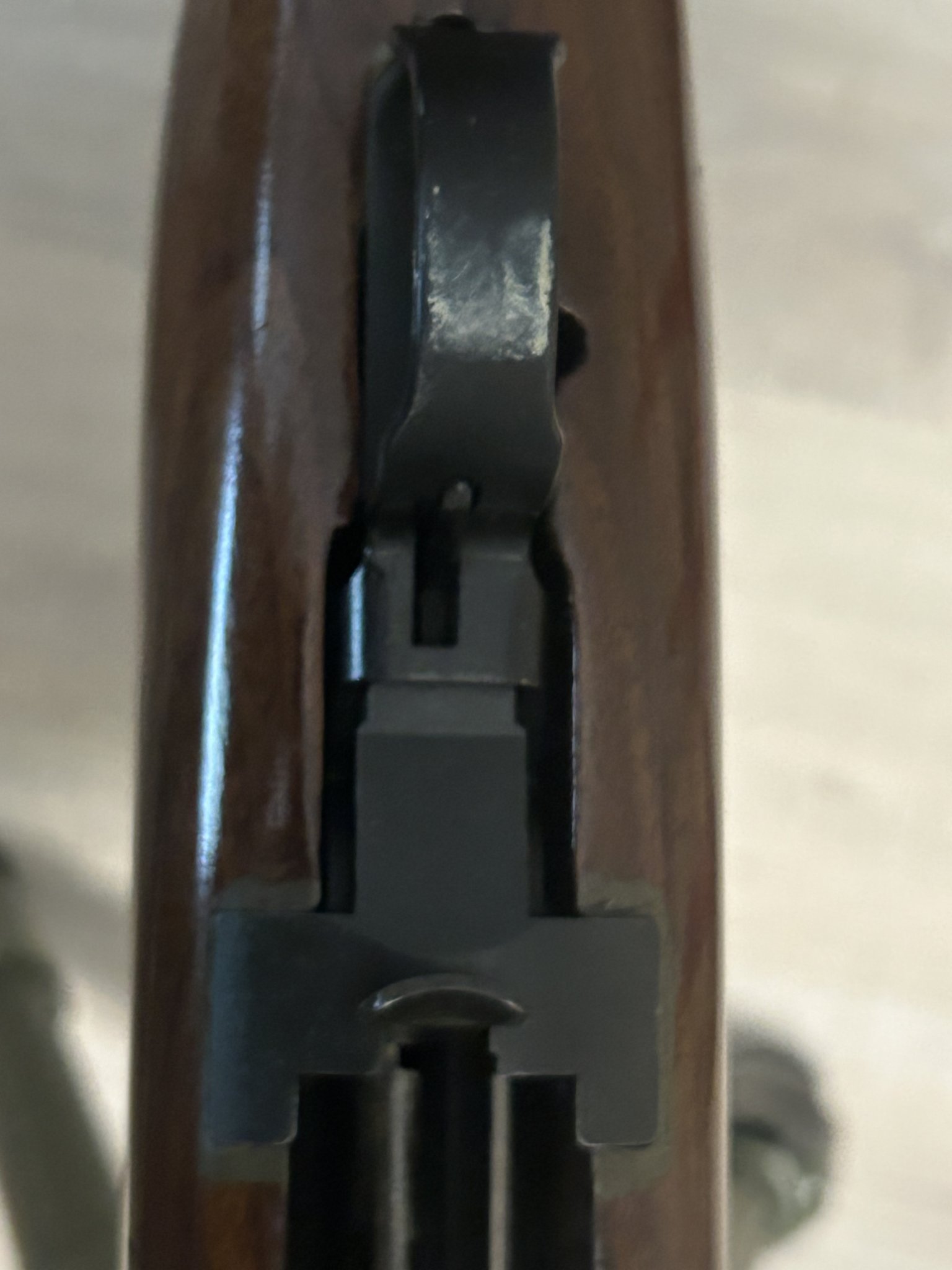

He had a unique way of bedding the action and trigger group. If you post pictures of the bedding material on both sides of the stock, I might be able to provide my thoughts of if it looks like his work. He used Devcon Plastic Steel Putty (dried gray) for bedding.

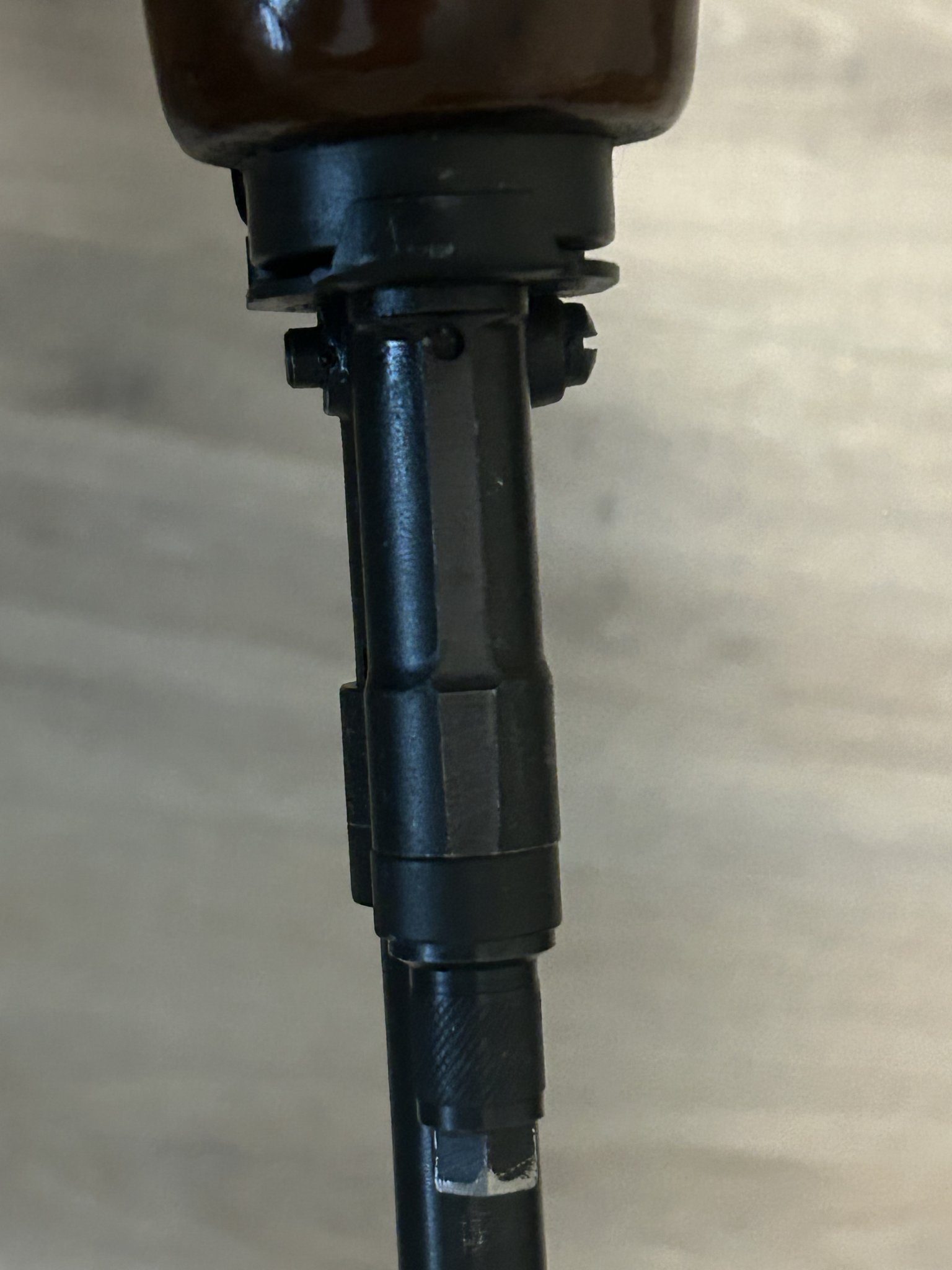

Hook also drilled a small hole in the gas cylinder at the 6 o'clock position as a pressure relief (allowing the gas piston to move freely when the bolt is locked back.

My mistake earlier, I meant to say in the GAS CYLINDER PLUG itself (on the front face--facing toward the muzzle).
From what I can see of the bedding, it looks like Hook's work--but pics without the barreled action and trigger group in place would be helpful.
From what I can see of the bedding, it looks like Hook's work....Hook also drilled a small hole in the gas plug.
Looks a lot like the work of some other smiths that used Devcon too. The drilled gas plug was a pretty common modificaction in the 80's/90's when using heavy projectiles or stiff loads for NRA Long Range.
No such luck, nothing on the plug unless its been changed at somepoint…. Sometime after I get some rebarreling quotes, ill disassemble it.
Got a few pics, of the bedding and gas cylinder
The bedding looks like the Bisonite that SAI used on their NM rifles back in the day. Glen Nelson and a small team of former AMU guys built all SAI NM rifles from the mid-197Xs until 2004. Nelson retired that year and passed away in 2007 (cancer). Just call SAI with serial number and they will tell in 10 seconds if it was a factory NM rifle. I don’t know of any M14 gunsmiths in GA, the closest one is Tony Ben in Florida.
