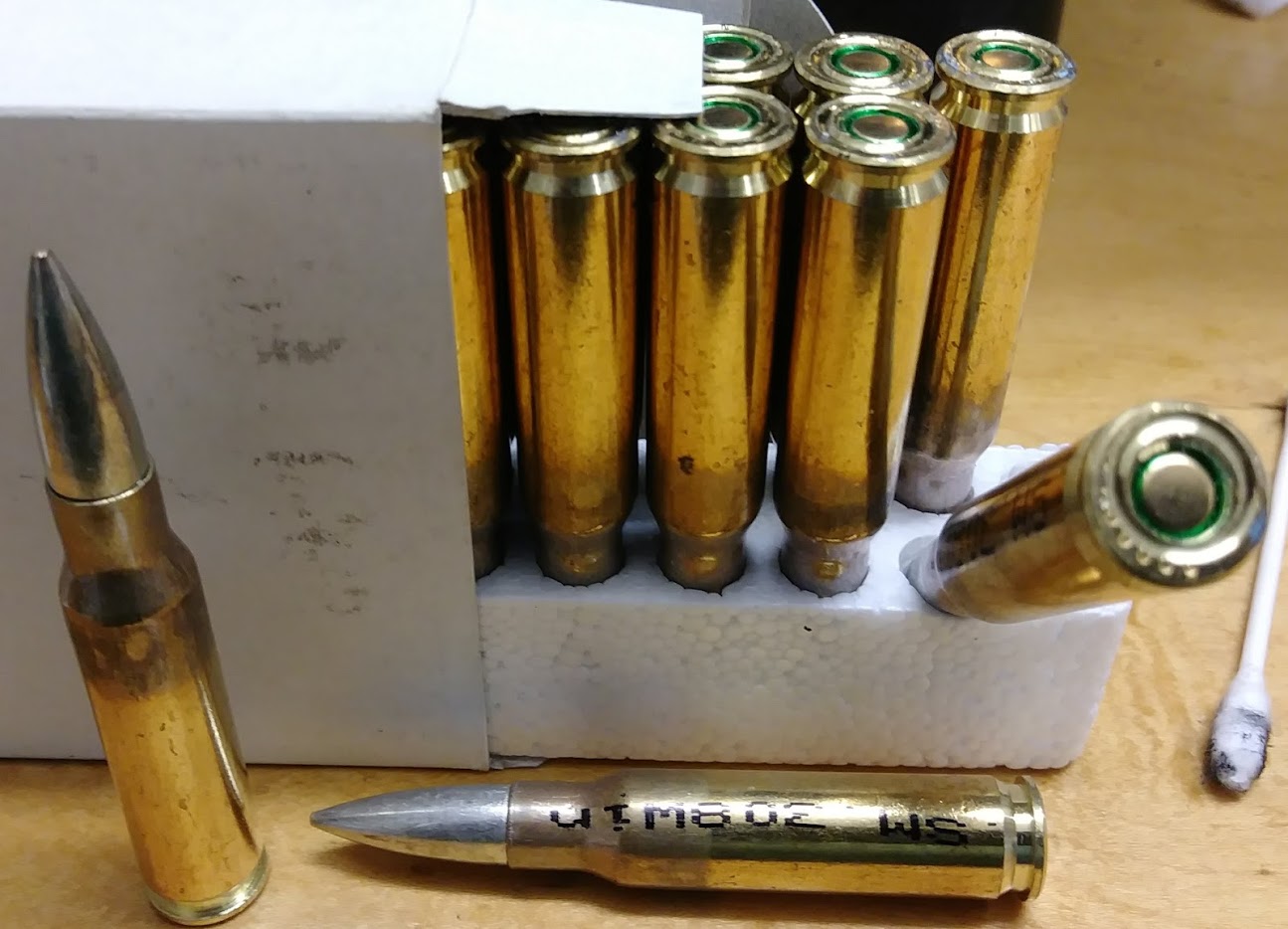

If this is the DAG or MEN with the case head demilled... be very careful with it in a "vigorous" action like a M1A.
You can just make out what I am talking about in this internet photo, see how the headstamp has been "sanitized "
!!!!!!!!!!!!!!!!!!!!!!!!!!!!!!!!!!!!0218182102.jpg.6ddc1d905c908c48d17c72ac58d42bb4.jpg
I haven't had any problem with the demilled in my Adj. GB'd Large Frame AR's... but the M1A is much rougher on cases, and you might rip case head rims off.
That said... if the case head is fully intact I would buy some for sure. And there still is some out there.

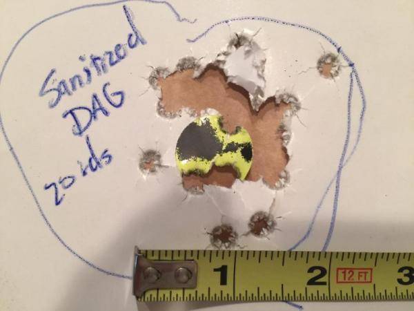

Precision out of my Large frame AR barrels is outstanding. ( headstamp removed stuff, and again... far less vigorous cyclic speed )
20rds rapidish fire.

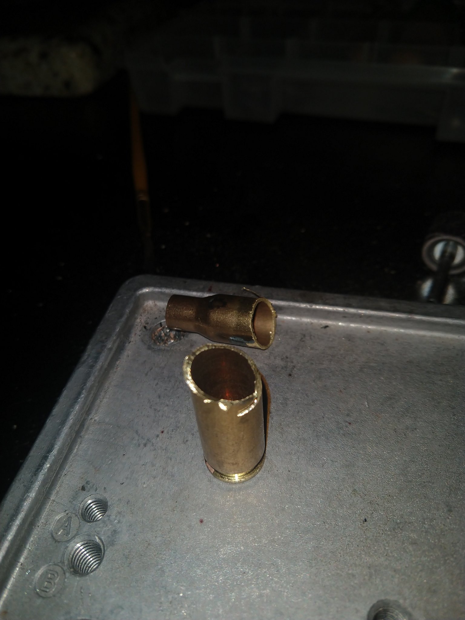

How does the brass get corroded inside? Is this an issue with ammo in sealed battle packs with intact head stamps?
I do not know. I have a few sealed battle packs with intact head stamps. the 200 round DAG packs with 20 rounds per cardboard box and no Styrofoam. Cant remember date code. I'll break a pack open, find a nice crusty round, pull it down, and take the ol hacksaw to it and find out what the inside looks like. I'll post back up here when I get around too it. May take me a couple days.

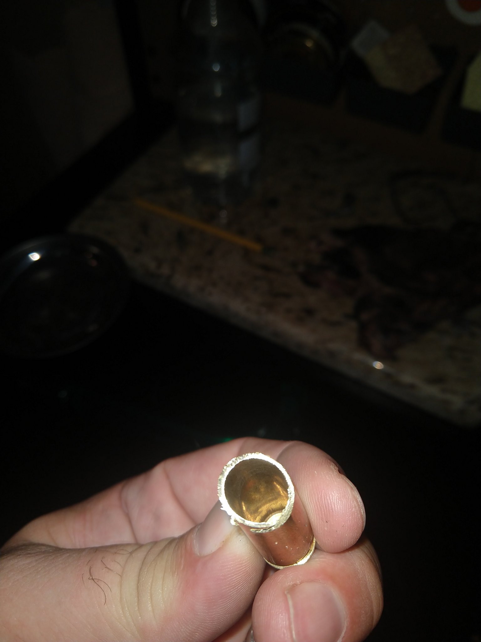

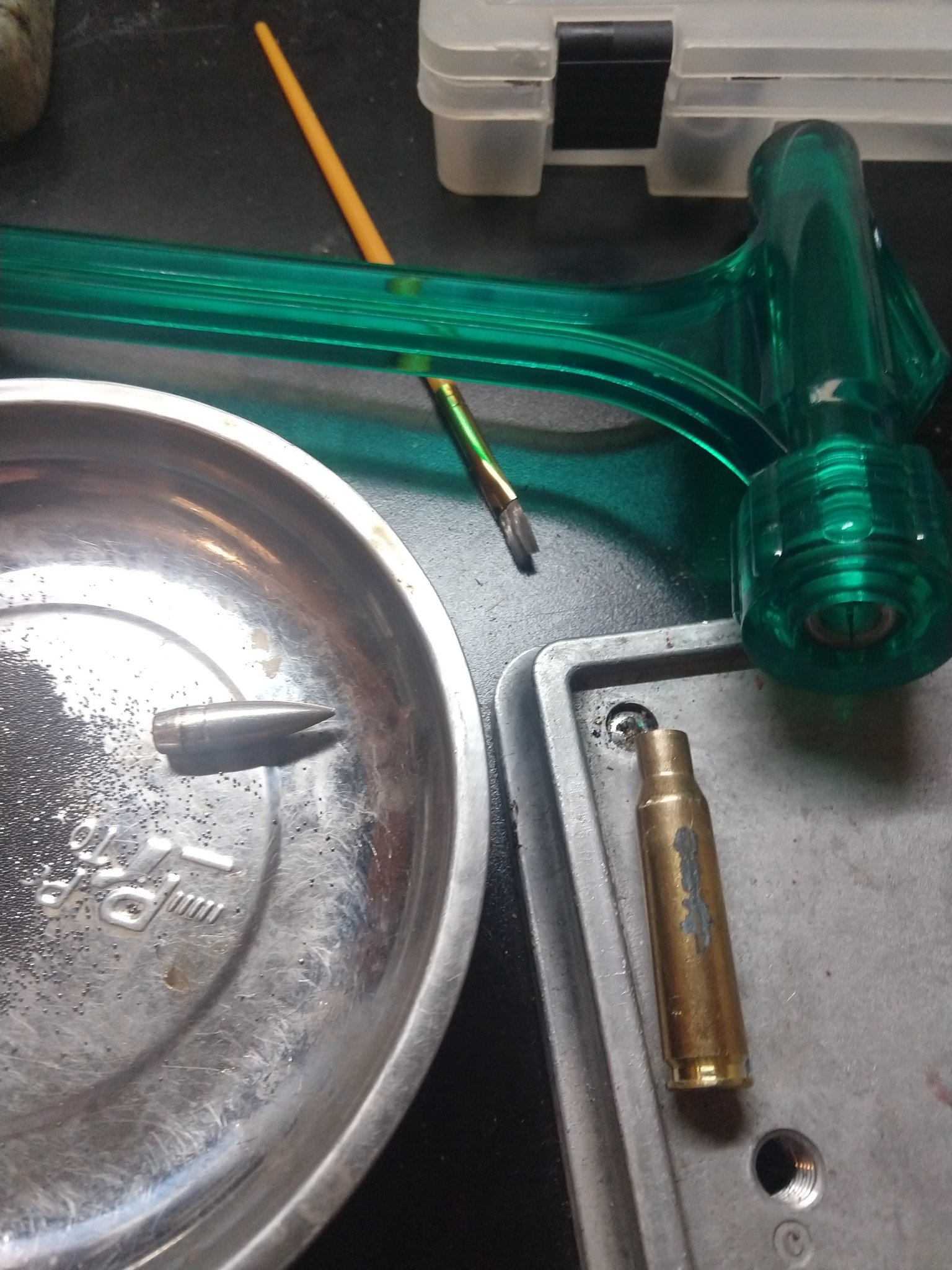

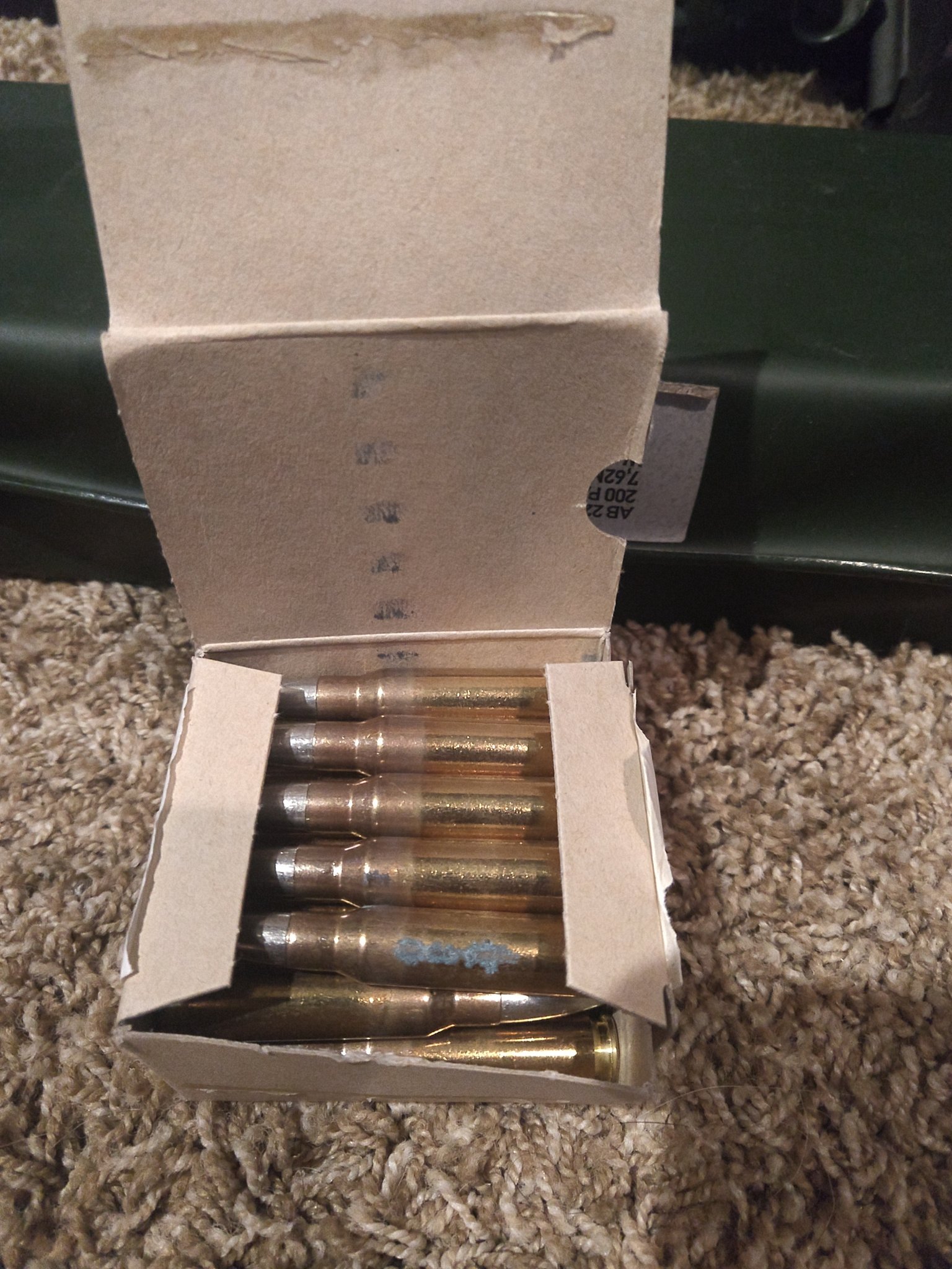

Ok gents. Got some time last night. Trying to post this from cell phone since that's what has the pics on it, and I don't know how well this will work. I'm kinda like @Foul Mike and can work a computer just enough to dick around on the hide.
I cut open a sealed pack, pulled down a round (safety first) before being a super bubba gunsmith and using a Dremel with cutoff wheel .
These are not demilled headstamps. Case wall was much thicker than I expected. The projectile is a nickle clad Steel projectile. It stuck to my magnet dish. Berdan primed case if folks were wondering.
Corrosion did not penetrate thru that thick case at all. I know pics suck, but best I could do. No discoloration or changes could be noted from inside. I will continue to wipe these rounds down and use them. I think these do not have as much contact with cardboard due to the way they are packed.
This last picture the corrosion that was on the outside is on the back of that case and you are looking at the inside wall where the corrosion was at.

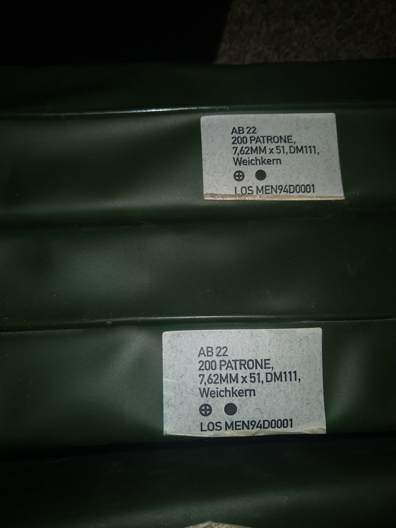

*edit. Sorry the pics are so gigantic and for some reason there are two of the lot numbers. Oh well, best I could do. You get what you pay for and since this review with small sample size was free that the best it is going to be.
