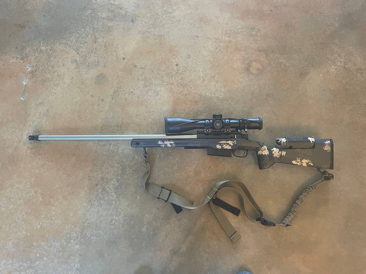

I have a bighorn SR3 in 300 WM that Greg/Bugholes/SPR barreled up for @Ankeny, and I purchased it from him.
I finally got tired of looking at a couple boxes of 215 Berger Hybrids on the shelf and worked up a load for same. Two words... extremely happy. I'll add pictures of a couple groups in a minute.
BTW this sits in a KRG Bravo stock.;) 2nd photo 5 shots...
Reactions: Jcaplinger199

No weights, standard length AI magazine, with muzzle brake (mad scientist ?). It's a hunting rifle and I'm old and fat, although it does well on targets at distance when the pilot does a decent job of steering it.
