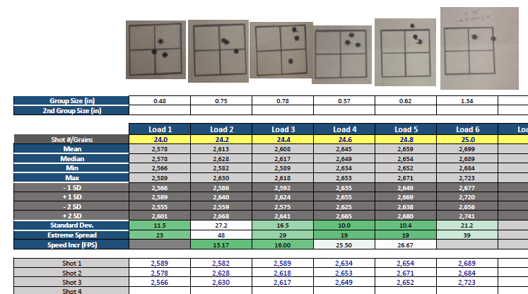

Here is a velocity workup I did with Varget for the 69 SMKs out of a 16" AR. I started to see pressure signs right above 25g loaded @ mag length with Sig brass. About 2700 f/s is what I can safely get using Varget. This is at 1,000 ft above sea level at 60 degrees F using Lee FCD.

I would just grab the 8208, if you can find it. If it doesn't shoot well, I would try some Varget. I used to use Varget as my go to, but switched to 8208 because it meters much better. I don't want to charge master 4 or 500 223s at a time. 8208 is also better with the lighter bullets. I like the prairie dog flop factor of the 50-55 class stuff.
Getting ready to load up a bunch of 556 with CFE 223 for Hornady 55gr SPs using 1x fired LC brass. You have a good load to start with that worked well for you?
Have good luck with H4895 and 73 ELD-M here. Had a BA barrel that never shot any of the above well, except the 73. Switched barrels to a WOA and it really likes the load. Pretty tolerant. Just picked up some XBR and haven't played with it yet, so curious to hear what yo come up with. I think the ELD-M may have an edge on the 69 SMK, but thats just my thought.
