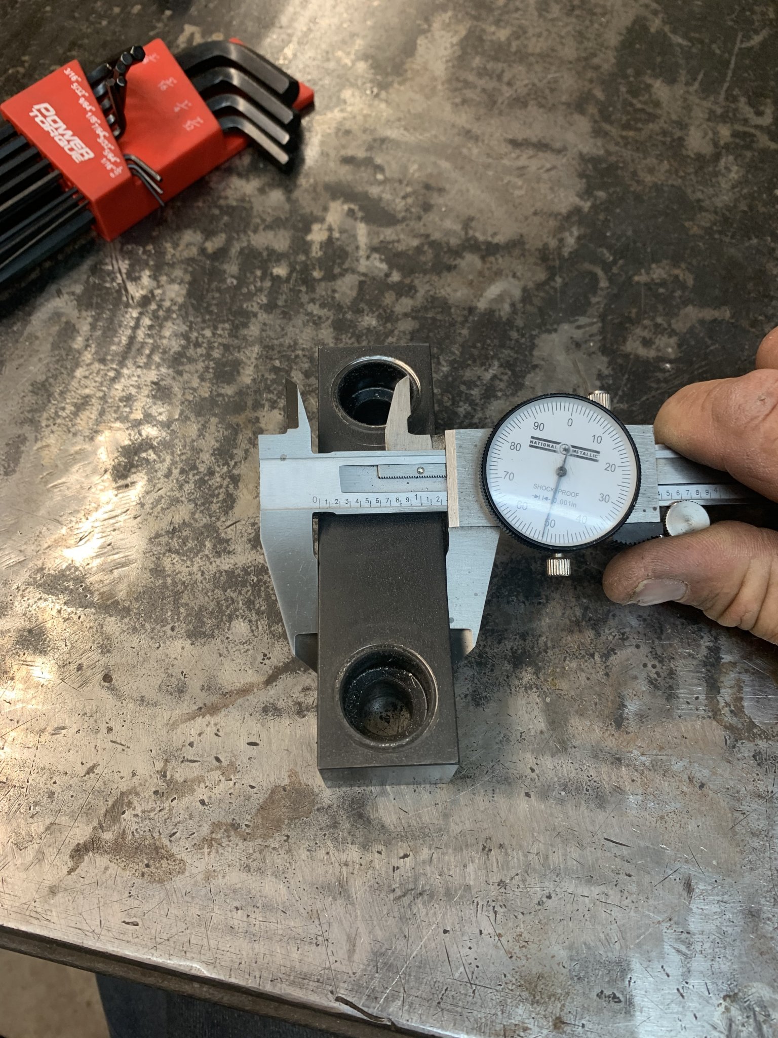

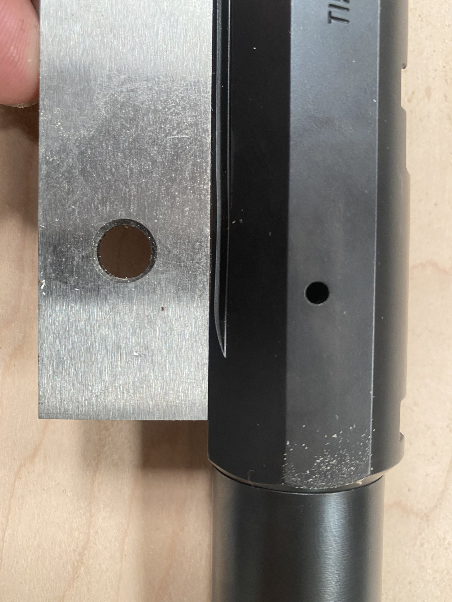

Be careful how much clamping force you apply to the action wrench, I recently worked on one and compressed the action to the point where the bolt won't fit! I've successfully removed a half dozen or so and even had to cut a couple off of earlier ones using the brownells universal action wrench with the jaw flipped upside down...... in this case the barrel came off much easier than I was expecting, broke loose on the second blow with the hammer but apparently the clamping force or something compressed the action to the point where the bolt will not fit, shit!
Yeah I think I’m going with the relief cut after seeing your pics that really sucks.
Ouch... that hurts to look at.
