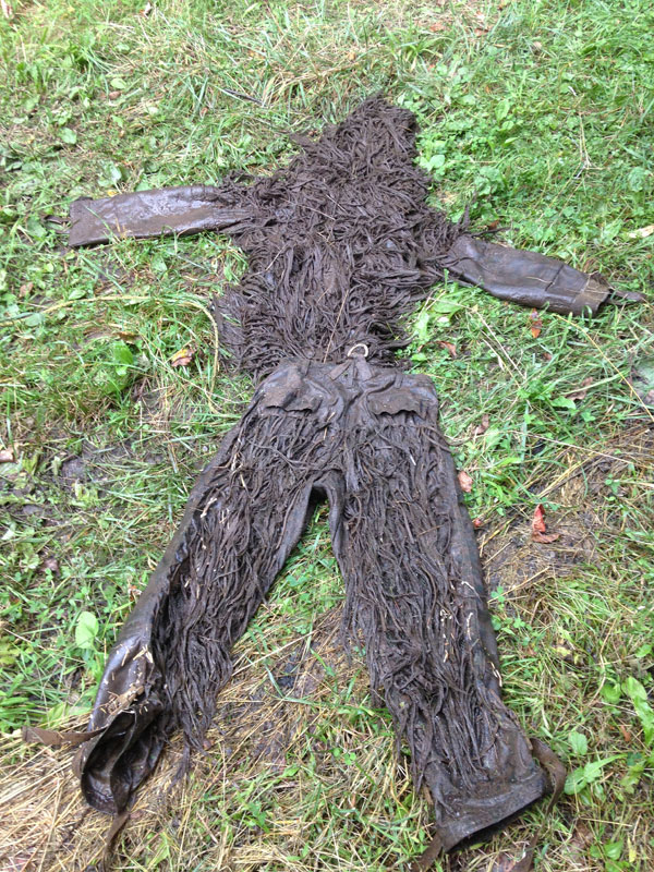

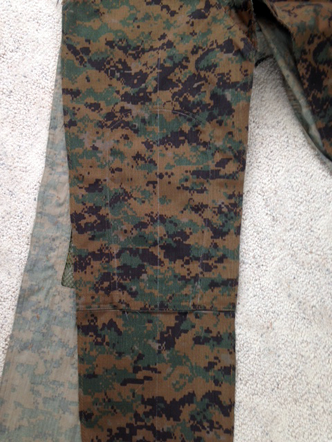

Hey guys first post. I'm getting ready to start a new ghillie suit. It's been about 10+ years since I built one. The shoe goo got brittle under the canvas on the old one. I'm going to use MCCUU's for the base. I was thinking about using the desert marpat's. My thinking is that it is easier to darken up with veg than to lightnen up. Any thoughts on using desert or woodland mccuu's?
Was also thinking of using 1000 denier cordura instead of canvas. Sewing it on with #138 or #207 bonded nylon thread via big ass sewing machine instead of using shoe goo. Anyone have any recommendations, or experiance with how well that might hold up. I'd like to find some type of glue that will stick to the cordura and base layer before sewing.
Any tips on the above would be appriciated.
I would only reinforce the sweing seems with shoe gue on the whole layer of canvas, because it will get uncomfortable under knees and elbos. Are you gunna use jute or burlap for the body of the guille monster? I perfer light jute with almost as many veg ties, gutted 550 cord to tie vegetation onto the suit with, about 6 to 9 inches long and burnt at the end.
mostly jute, with some pieces of burlap, but not overdone. Lots of ties for vegetation with 550 cord. I'm going to do side zippers on this one to keep the chest flat and more comfortable.
From my reseach, I too have determined that the E6000 won't stick to cordura. Looking into other adhesives that will work. Just don't want to rely soley on the stitching. I'll post pix as I get going. Decided to go with woodland MARPAT. I wear medium MCCUU's, and the large is way big enough to go over me in mediums. Found a top, but still searching around for large pants. took all the pockets off the blouse and shortened the sleeves to where I need them. Getting ready to sew in a rear back vent and maybe armpit vents, depending on how far up I decide to take the side zippers. Just waiting for the material to get here so I can get started on the top at least. After that I can start on the side zippers panels and netting.

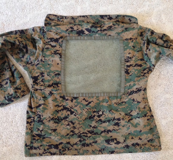

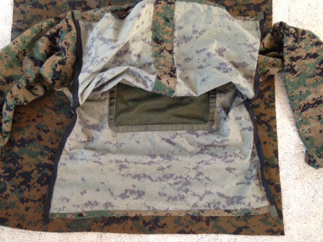

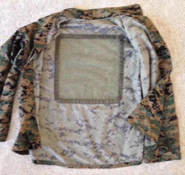

I finally got started on the blouse. I have the netting sewed in. I reinforced the edges with milspec grosgrain on both the inside and outside. I also have one of the zippers in and the front sewed up. I'll post pics of that when I get a chance to sew in the other zipper.
Any thoughts on putting zippers on bottom of pant legs? Thought it would be nice to get them on without taking off boots.

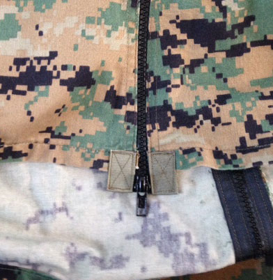

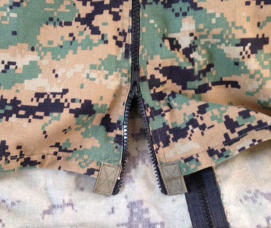

Did a little more today. Here is the blouse with the zippers in. I re-inforced the top of the zipper, by doubling up the grosgrain. I also added tabs at the bottom of each zipper for something firm to grab onto when pulling.

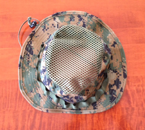

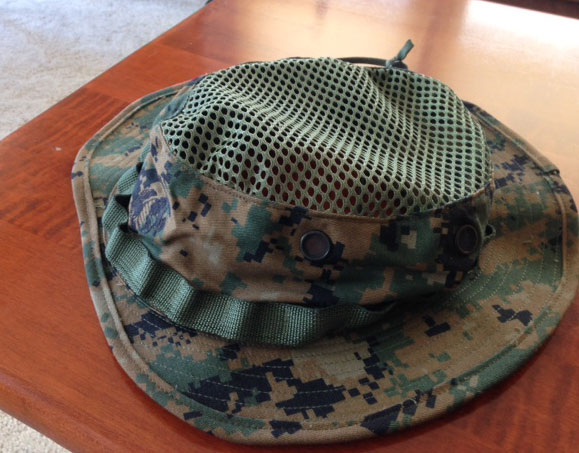

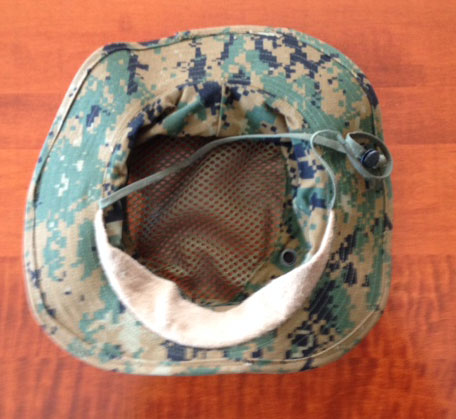

Also, got started on the boonie. Took out the top piece of fabric and sewed in mesh. I also, removed most of the brim at the front of the boonie. helps keep shadows of the face. I haven't noticed too many people doing this for some reason. I then re-sewed the band back on.

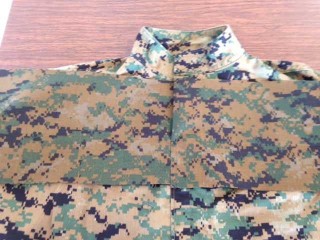

Last pics of the day. decided to go the cordura route. Started piecing together the front skid. It is made up of 3 pieces, so that I can get up past the head opening. so far only the 2 top pieces for the collar are sewn together. It is highter up the shoulder than it will be when finished.

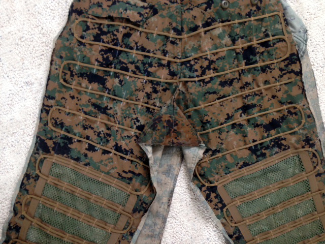

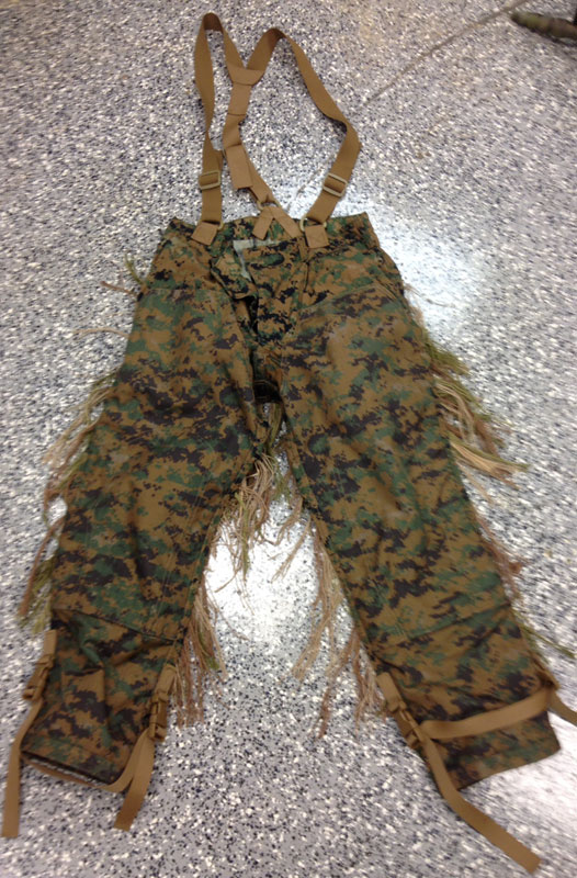

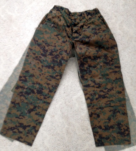

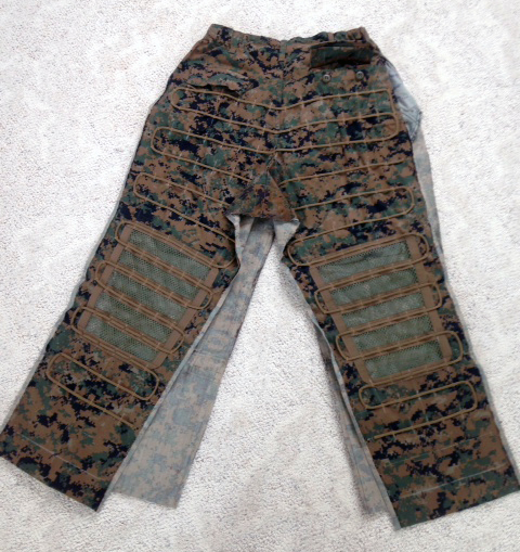

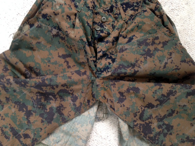

Been busy and haven't had a lot of time to work on this for a while. Finished the pant the other day. I'll post some pics of the finished pants when I get time. In the meanwhile here are some pics of them almost finished. I decided to make them so that they have removable padding. Also, vented the back of the knees. Wish I would have waited a few days, as I got a heavier mesh in the mail, but I'm not ripping these apart now!! It's hard to tell in the pics, but I also reinforced the crotch area. Both front and back across the side seams. Then, front to back on the inside. All with cordura. Also added loops for suspenders, and made a pair of them as well.
I decided the other day I wanted a few things a little different on the top. So, I am in the process of making a new one.:eek:

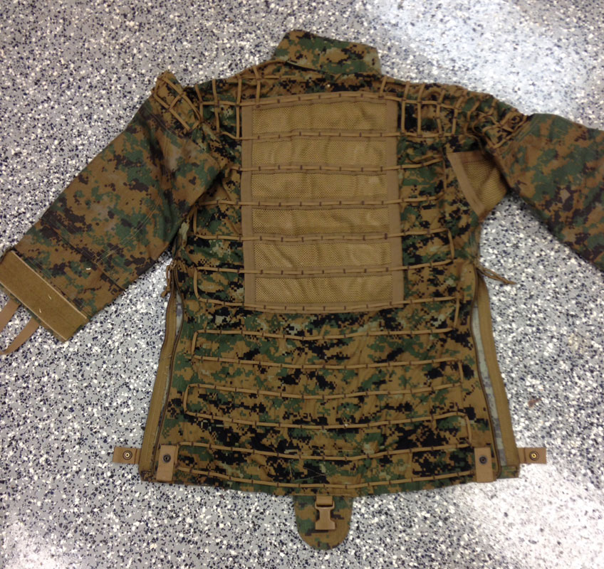

The paracord is all bartacked to the pants. (white you see is marking pencil lines). After all the bartacking was done, I put a drop of superglue on both the front and back of each bartack so that it won't fray. Makes the thread kind of like plastic.

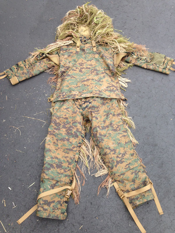

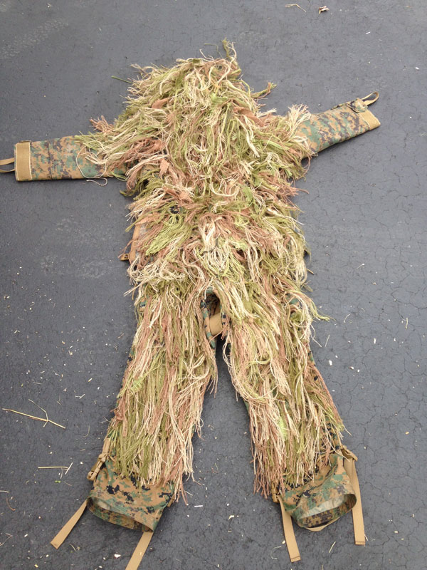

Finally finished this thing a few weeks ago. I have since, thinned out the jute to about half of what is pictured and trimmed the length of the strands. Decided to do a hood instead of the boonie.
