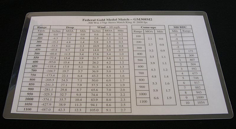

Here is a picture of a drop chart for Fed Gold Medal 175........
7108155
The middle column of information would get you "close".
Think in "Minutes of Angle" not clicks.
So when moving from 100 to 200 yards you add 2.1 Minutes of Angle.
When moving from 200 to 300 you will add another 2.7 Minutes of Angle to your 200 yard DOPE to create a total elevation of 4.8 Minutes of Angle from your 100 yard zero.
Etc.
Example when moving from your set 100 yard zero to 200 yard shooting....
If your scope is manufactured with 1/4 minute ADJUSTMENTS (not clicks) add 2.1 Minutes of Angle or ADJUST the elevation knob 9 times in the up direction. You have added 2.1 MOA elevation.
