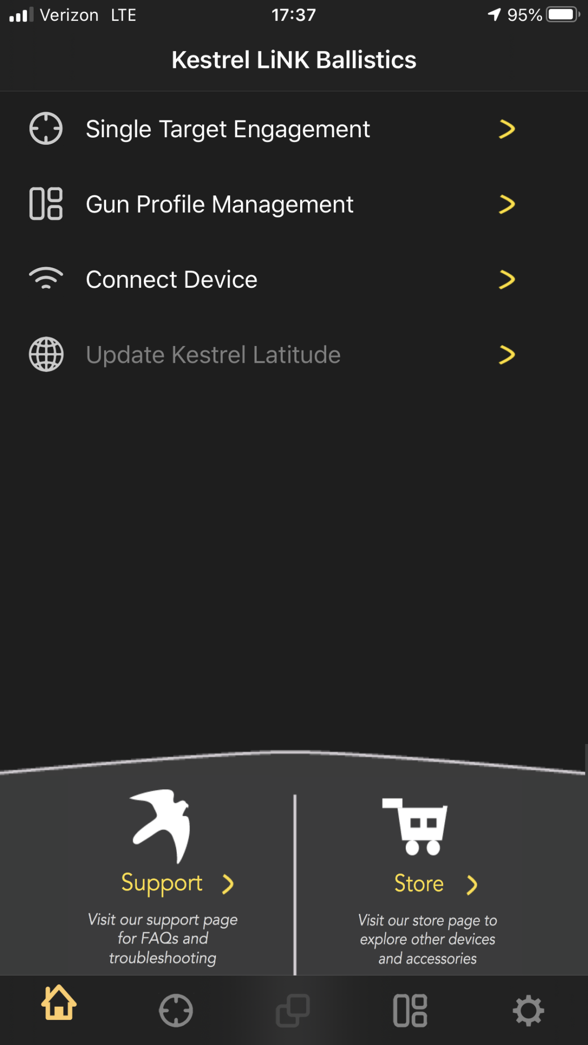

I downloaded Link onto my computer and it won't pair.

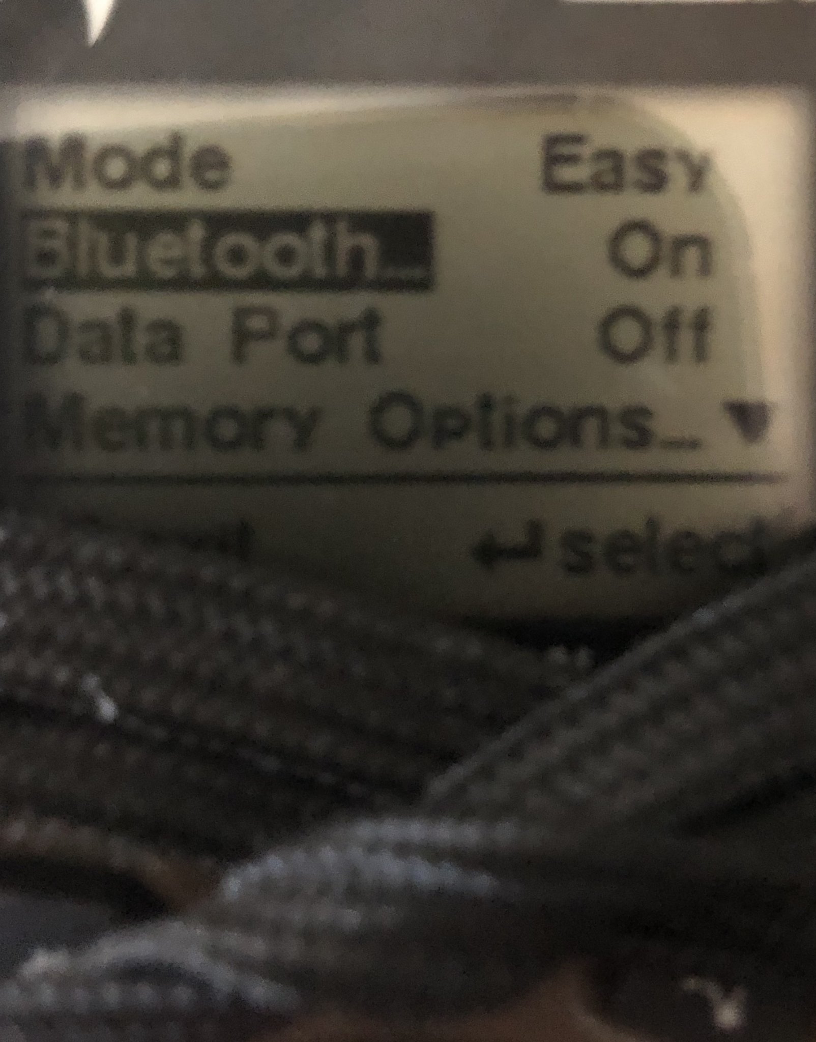

Could't get Kestrel to pair with Ipad.
Go into the Link app and pair it in there, it won’t pair from the actual phone Bluetooth screen. Just make sure Bluetooth on the kestrel is on.
If you haven’t already tried that.
all you need. This simple usually. If it won’t pair, kestrel is on here. Hit them up.
