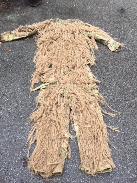

also, since you are building a suit......one thing EVERYONE gets wrong is how much burlap to use.
this is how much burlap i have on my suit.......and honestly im contemplating on pulling some out.....you need just enough for a base layer.....90% of your camo is going to come from natural vegetation.......plus its very light weight...even with all that shit, it weighs about as much as a good heavy weight coat........if i wanted to, i could easily fit LBE or a plate carrier over the ghillie.
if your suit looks something like this, not only are you going to roast in the thing......but if you ever get wet, you are going to weigh 4000lbs......no to mention you are going to impede movement and have a harder time blending in

oh i SSSOOOO agree,if u look like photo 2,u r screwed an roasted alive.i am a tad smarter than them masses produced BUSH ghillies.i am taking my ghillie out of the ACTUAL snipers playbook..world wide,an ya,the too much burlap is OFTEN mentioned as a BIG ASS NO NO,30/70 is the % i keep hearing about so i will make it as i can,trim it down,add an subtract as needed till i have it as perfect as i think i can make it,go across the road after the next rain storm an play in the mud for a few hrs til its beaten the hell up,let it dry,reapply retardent,an then try it out. have many vet buddys who will have cameras to record me an i can learn from that. i REALLY HATE doing shit half assed,in real or in fun,must be the best i can be.they have been talking about bringging out the BB Guns on the second try out,(ya i have some demented friends) but if i do it right an it all comes together,i get to shoot them,not the other way,and correct me if i am wrong,but thats the goal,them b4 u. and lets be honest i am a 50 year old man,in mehe shape,been out for 25 years,watching me TRY an low crawl should be pretty damn funny to watch,especially if they shoot my ass.

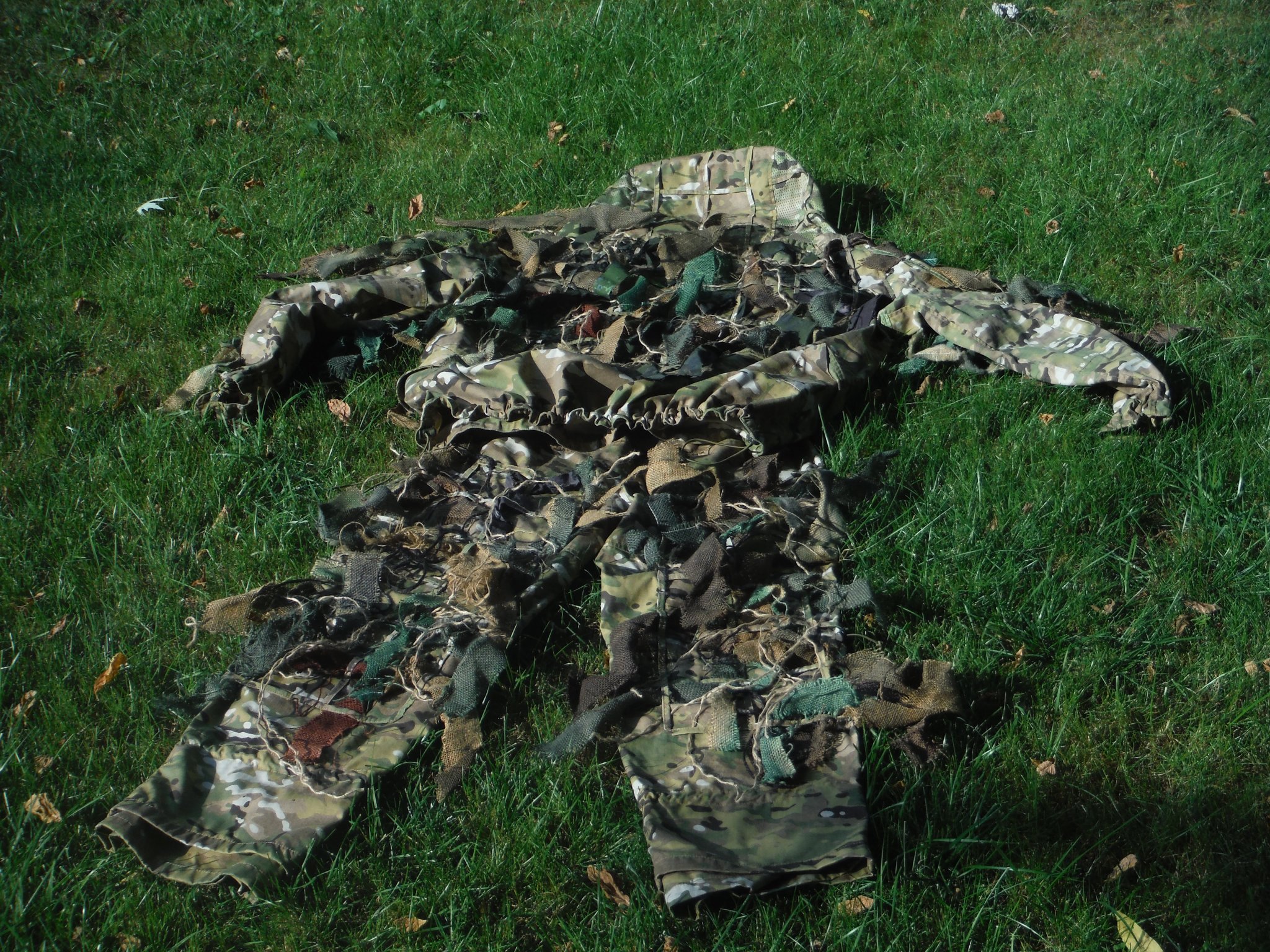

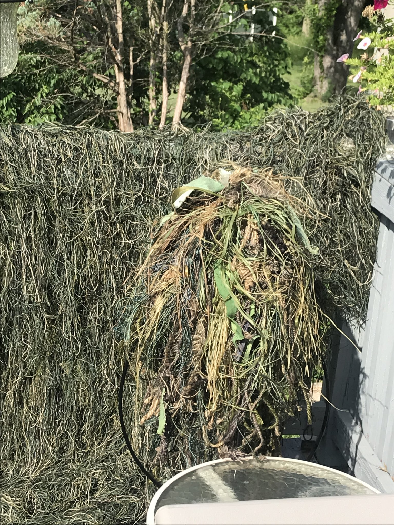

I use this. A little burlap and such and a lot of room for veg . Though I do have a hat that has more burlaps and grass on it when I am using a smal blind just break up the outline of my head and shoulders.
For field use I have one of those Tactical Concealment hood things. Basically a hood and 3/4 sleeves. Lighty juted. Plus I have a roughly 3x5 net lightly juted to use as a rifle/tripod wrap. So the chest rig fits under the hood thing. Plus I picked up a lumbar pack type thing from REI and spray painted it. The lumbar pack holds pruning shears, extra hair ties, 550 cord, dope cards and other stalking equipment. Plus the net wrapped up in the compression straps. So ruck and any extra equipment I don't need gets cached, Grab the lumbar pack and it's off to the races.
Look at the Velocity Systems mesh 'Basha'.
Remove the hood and thats basically what I wore over everything in Afghanistan when we were tasked with remote insertion/overwatch. Running convoys or site security, I just wore a carrier and generally didn't have a precision gun on me.
