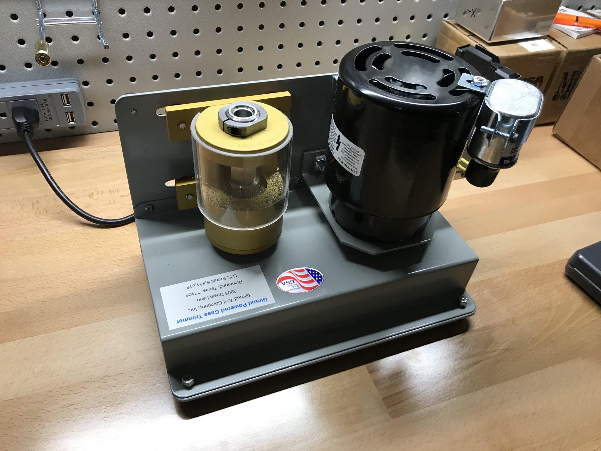

Looks like the Giraud unit is the go to one for most of the members here. A case trimmer is the last thing I need to complete my reloading set up and was wondering if anyone here has tried any of the Henderson Precision trimmers.
I know the powered HP trimmer is $740, compared to Girauds $525 that's no brainer but my plan was to get the $400 set up and adapt my own power drive, simply because I can and it would be fun.
Looking for any reasons to ditch that idea and just get the Giraud.
Thank you all

So this showed up today!
Thank you all for the help.

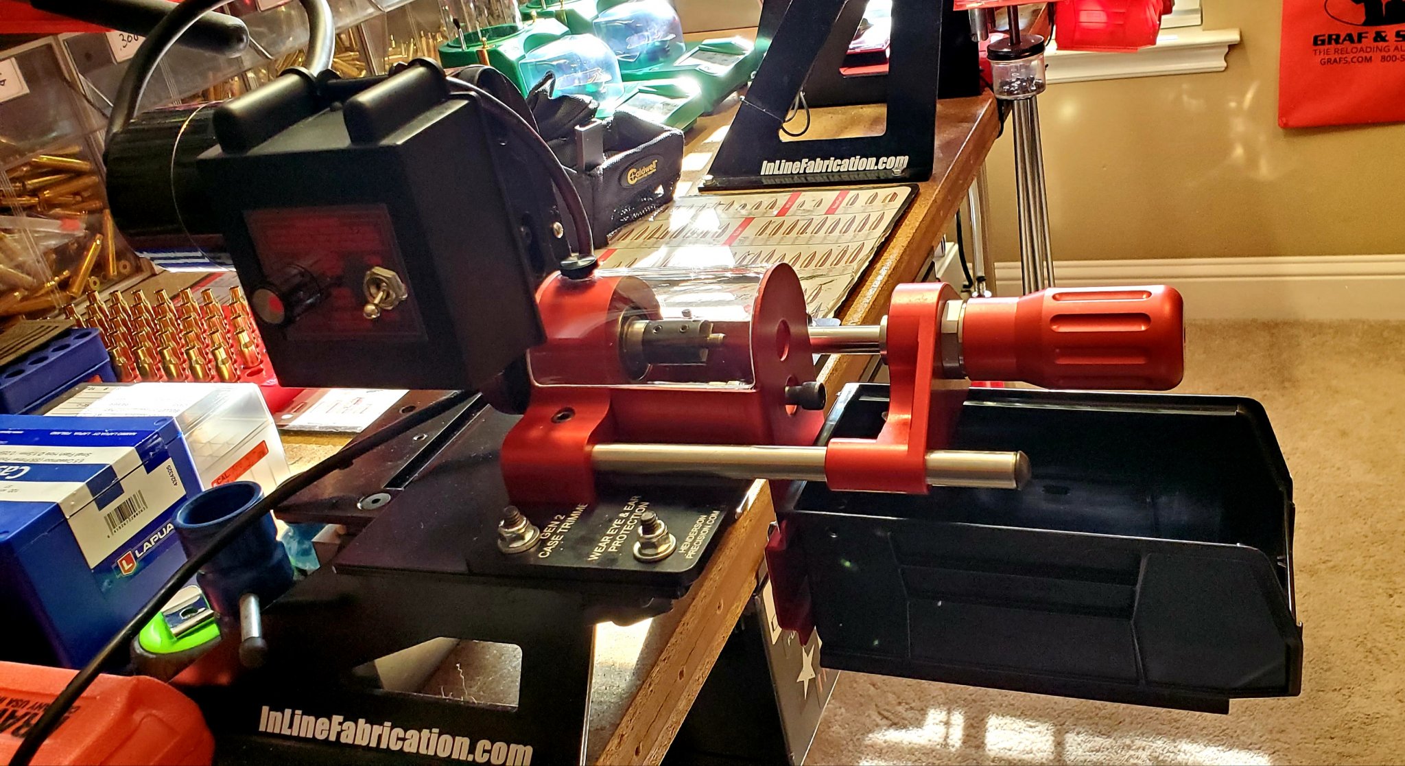

I own both. I prefer the Henderson. User experience is better than Giraud for me. Both seem to be equal to consistency.
If you only do one or two different chamberings, Giraud is cheaper. If you do a lot and buy separate cutter heads for Giraud, then the price evens out a bit.
Cant go wrong with either. But for me, henderson is more comfortable and I’m a high volume brass processor. Few hundred rounds a week.

It works exactly as advertised, its reliable and well built I'm happy with it and will be keeping it.
I do think however the Henderson is a better trimmer with the only down side being its more expensive.
Here's a couple of pet peeves I have with the Giraud that make me wish I would've gotten the Henderson.
1.0 Power; It's got enough to get the job done but if you have trim 0.005 or more from your brass you gotta gradually apply pressure as you trim, otherwise you can feel it bogging down I believe the Henderson has double the power.
2.0 Case holder play; The spring loaded case holders have just enough play to where you gotta develop a technique to trim otherwise you get uneven chamfers and it takes a while to get the hang of it. I've been told this goes away with a solid case holder but I haven't tried.
3.0 Multiple case holders; You gotta buy a case holder for every shoulder angle you trim, even if they're the same caliber and as you start to trim more calibers your initial savings of going with the Giraud go out the window.
Those are the main observations and it doesn't mean the Giraud is a bad trimmer, it works great and it's popular for good reason however I do think the Henderson is better no questions, maybe not by much but better.

Got mine in, and love it. Makes life Much easier.
Thanks for the help!

I never used to trim, I simply scrapped my brass when it either got long or got loose pockets, usually the latter was first.
But I finally dove in and got the Little Crow Gunworks "World's Greatest Trimmer - 2"
I like it. Fast, simple, uses my battery drill, and does what I need it to do. I'm guessing there are differences from the two above, but to me, it's not a big issue.
