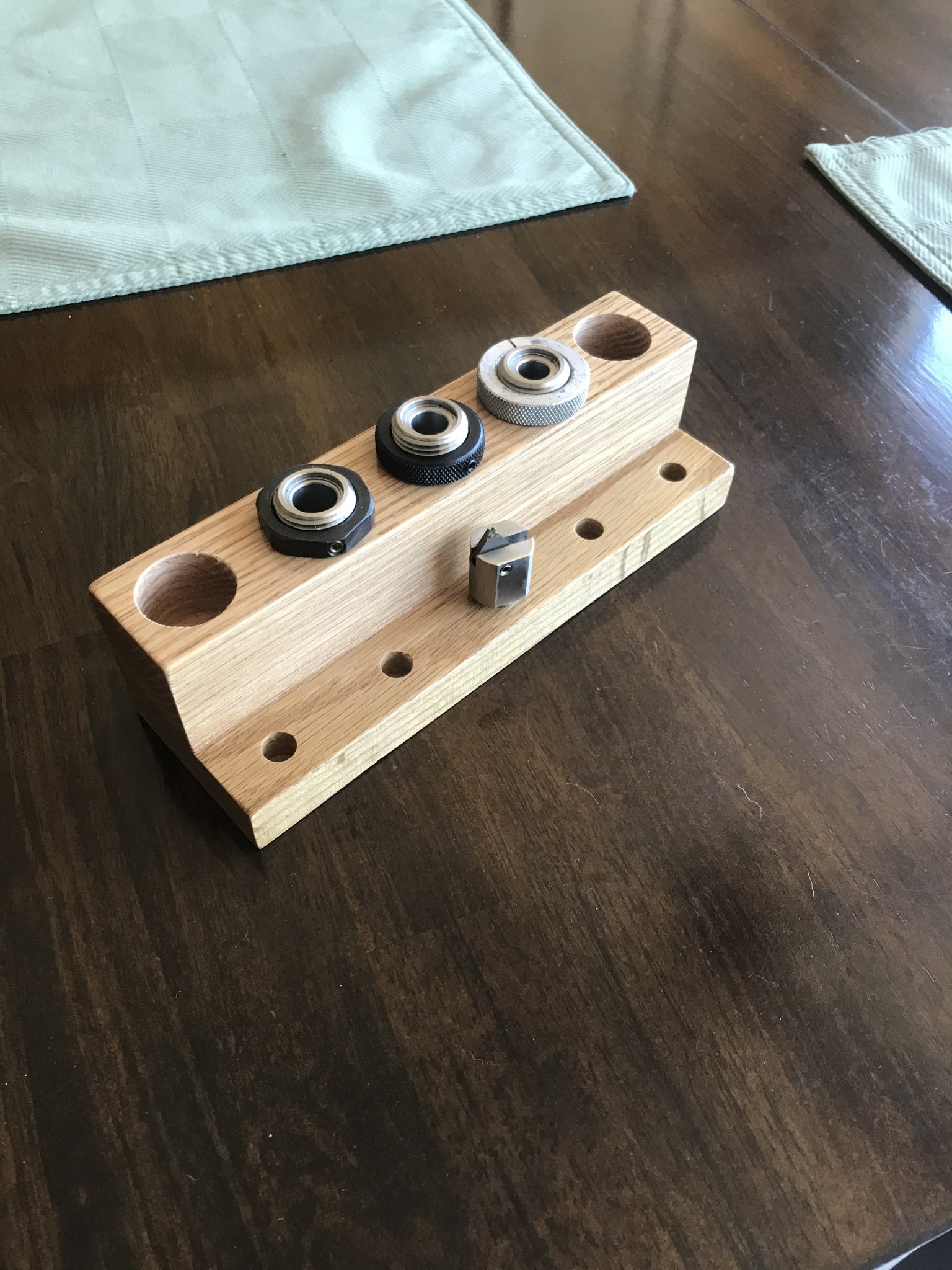

One of the most used reloading tools in my shop. If you are going to trim multiple calibers buy lock rings for each shell holder. The Hornady rings work well.
And buy multiple cutters. I found I can lightly stamp them (across the flat) with the caliber without any harm. It makes it easy to know which cutter goes with which die(s). Even made a little tool stand to hold them all....

My next venture is going to be multiple cutter heads for each caliber. I only shoot 1 cartridge per dia. except for .30 so hopefully it works out painlessly.
I wanted to clarify something: I don't have a blade for each 6mm cartridge I shoot. I have one blade set up for each diameter. I have one 6mm, 25 cal, 6.5, and 30 cal. That covers 6 Creedmoor, 6 Dasher, 6 XC, 25 Creedmoor, 6.5 Creedmoor, 308, 300WM, and 300 Norma

Lock rings and dedicated cutter heads for each caliber are must-haves.
My Ah-ha moment was using a case to adjust the cutter head.
No more trial and error.
Insert a case and use the case mouth to align the cutter head.
You will want to do some fine-tuning, but the case mouth gets you very close.
