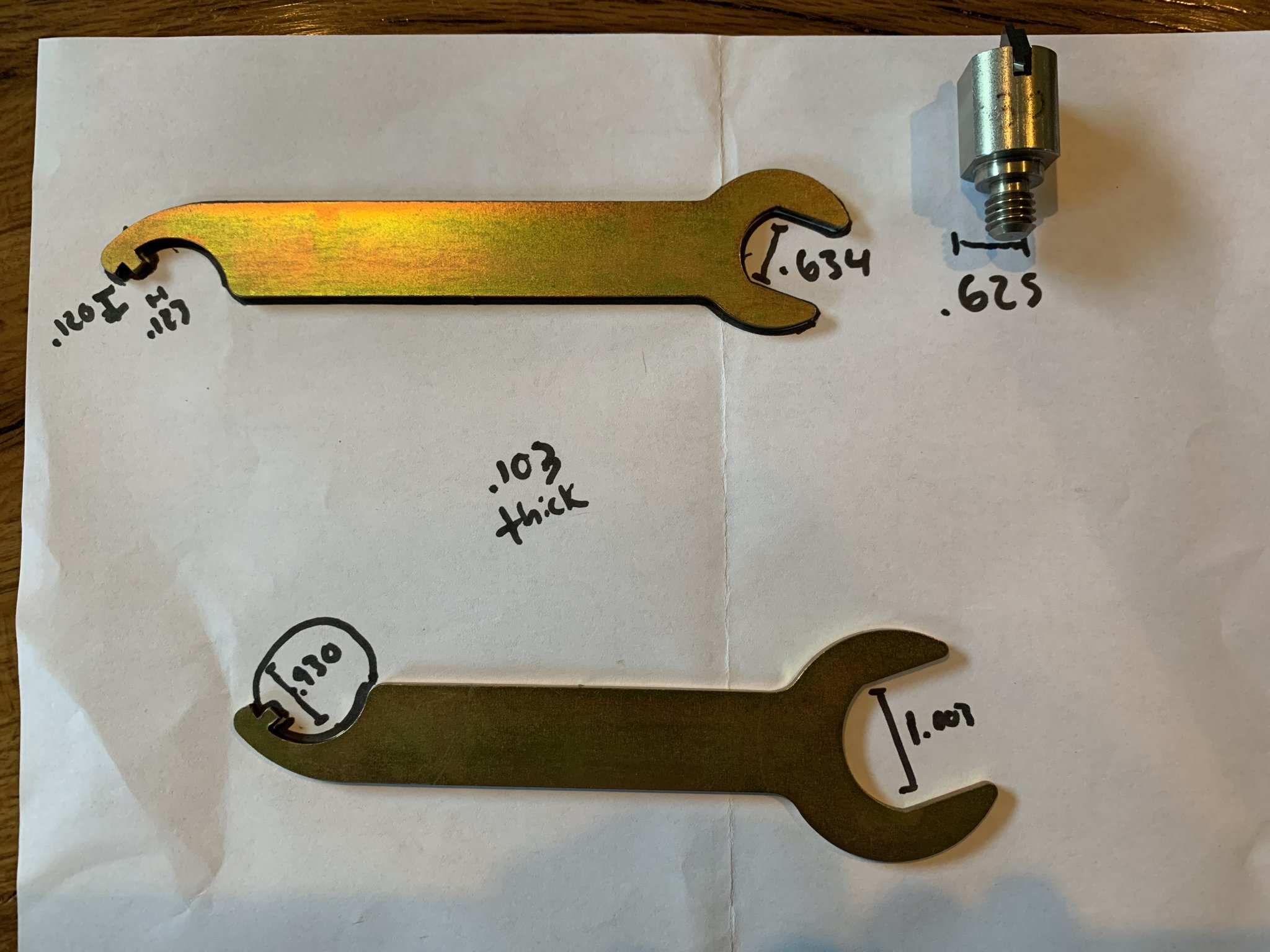

So I bought a Giraud Trimmer a year or so ago, and when it arrived it didnt include the two small spanners. Ive made due with using a nail and a wrench, but would like to get some of the propper tools for the job. I have contacted Giraud, and they’re $7 each….however, since covid, he has been worried about items getting lost in the mail, and now just the shipping alone is over $100 USD to Canada. I refuse to pay that. So, I was curious if anyone knows the dimensions, or even if these things can be found elsewhere. Even if someone with a Giraud can send me the specs for it, I can probably get something similar to work.
Any help would be appreciated
Thanks
The little wrench mouth is 5/8th" wide, big one is 1" wide. Both are 0.1" thick. I'm sure some supplier has wrenches like these.
The open end of the small wrench goes on the cutter body. It’s 5/8 plus gap for the wrench.
The dimension on the large wrench of .930 is the diameter of the actual drive in the machine, I don’t have a way to measure the semi circle gap and math it. You’ll obviously add a couple thou on the wrench to clear. The tooth I have written on the small wrench but it applies to the large as well.
