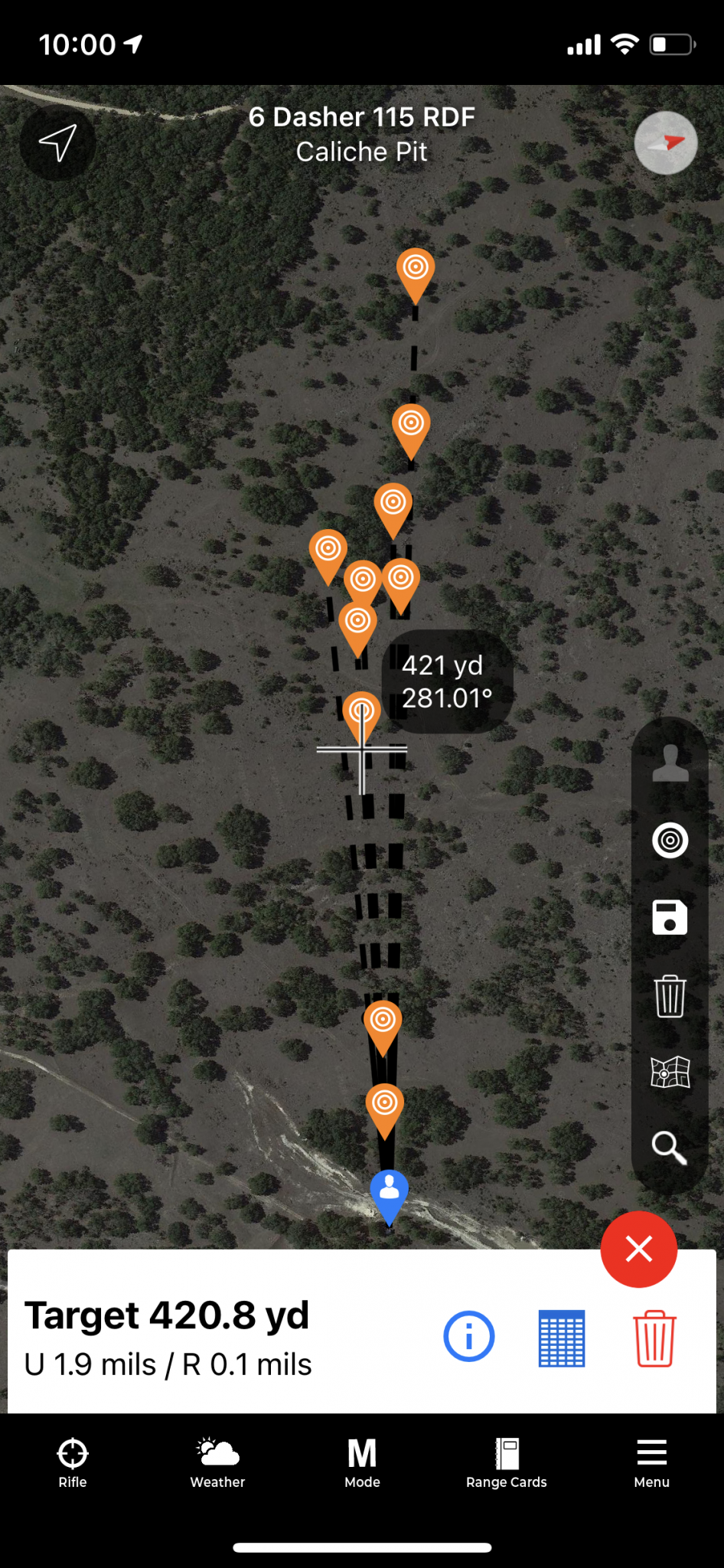

Calculator and gps mapping combined for 15 bucks. It’ll integrate with your kestrel and it uses the jbm engine. It’s pretty great.
For placing my targets with poor cell location I can still see the tree I put it next to or the rock it’s in front of etc.
And the competition cards are pretty cool for plugging in each stages targets and so on.
Well worth the money.
