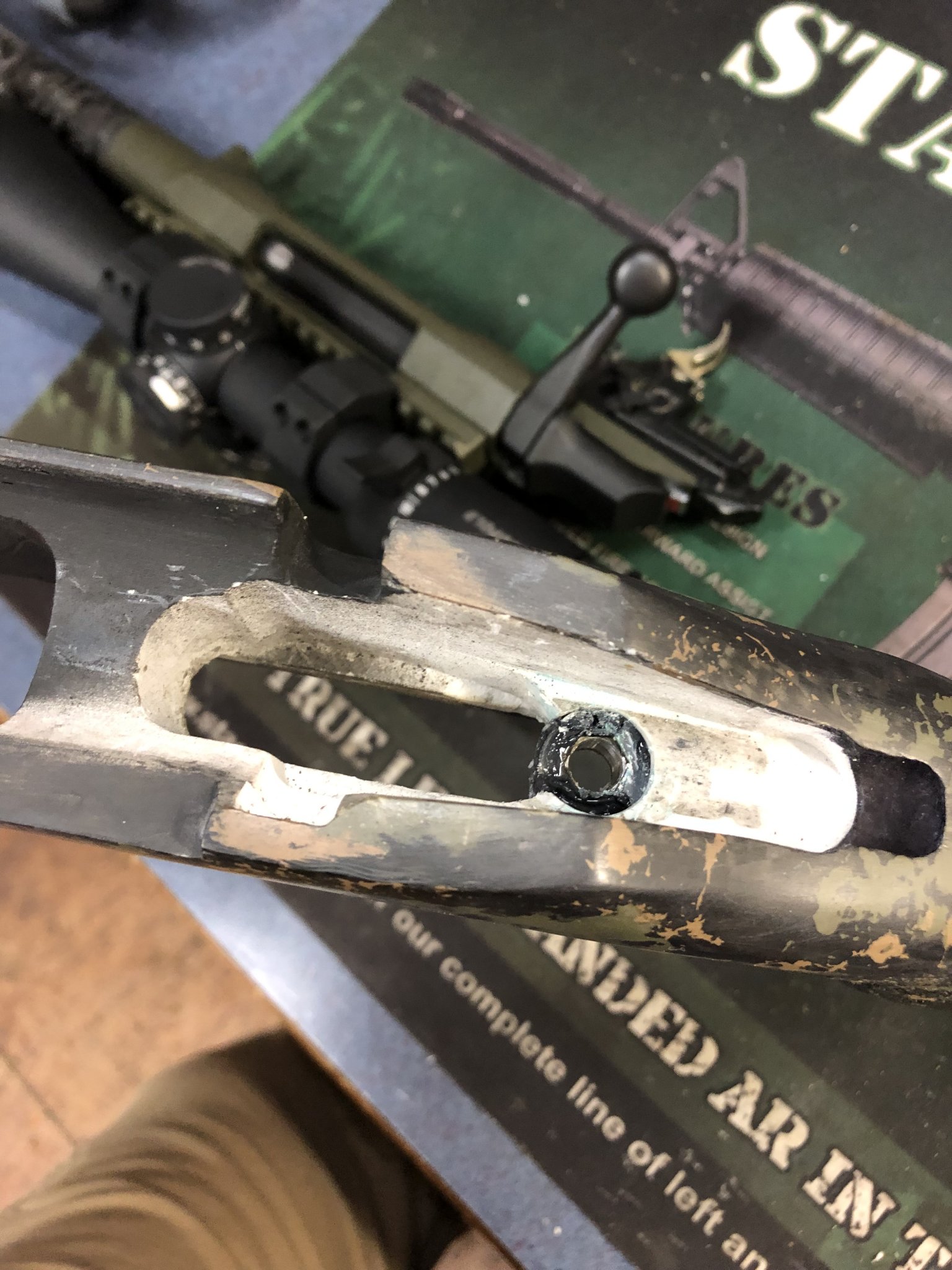

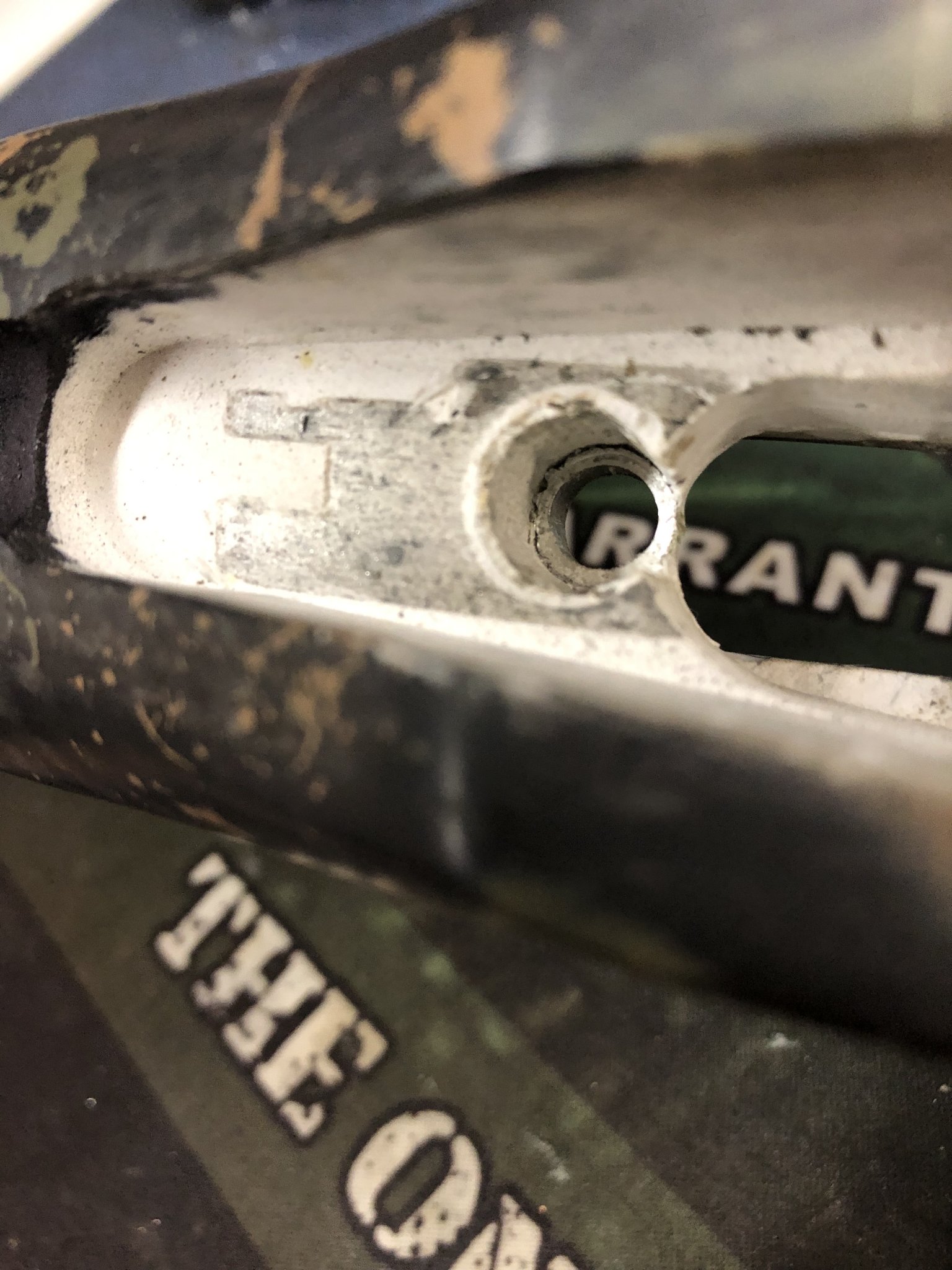

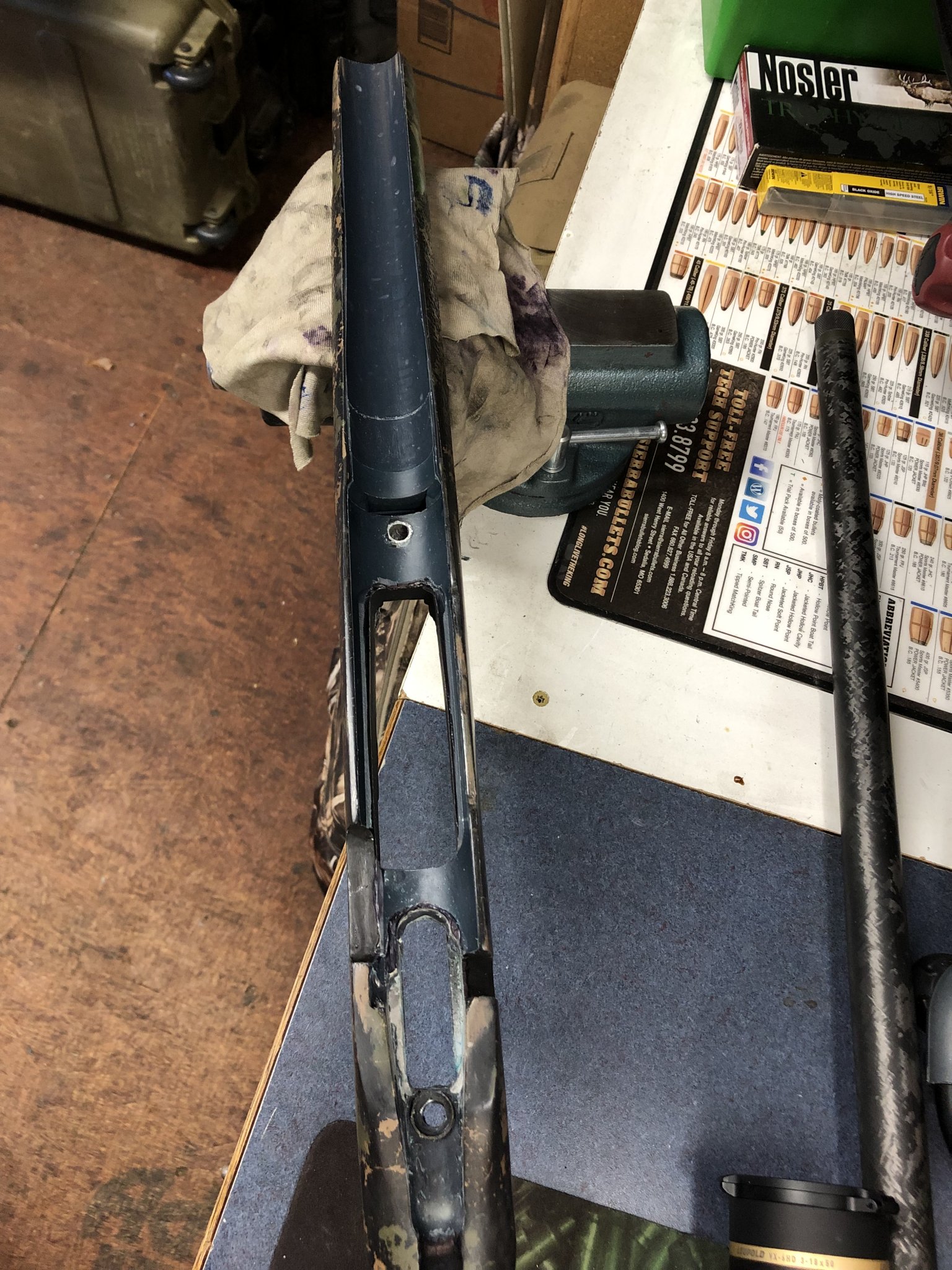

The rear pillar is approx .30 too short from what I can tell. I guess it may need a new rear pillar. I would think McMillan would have a better inlet template than that! That's why I may just get someone to do it.

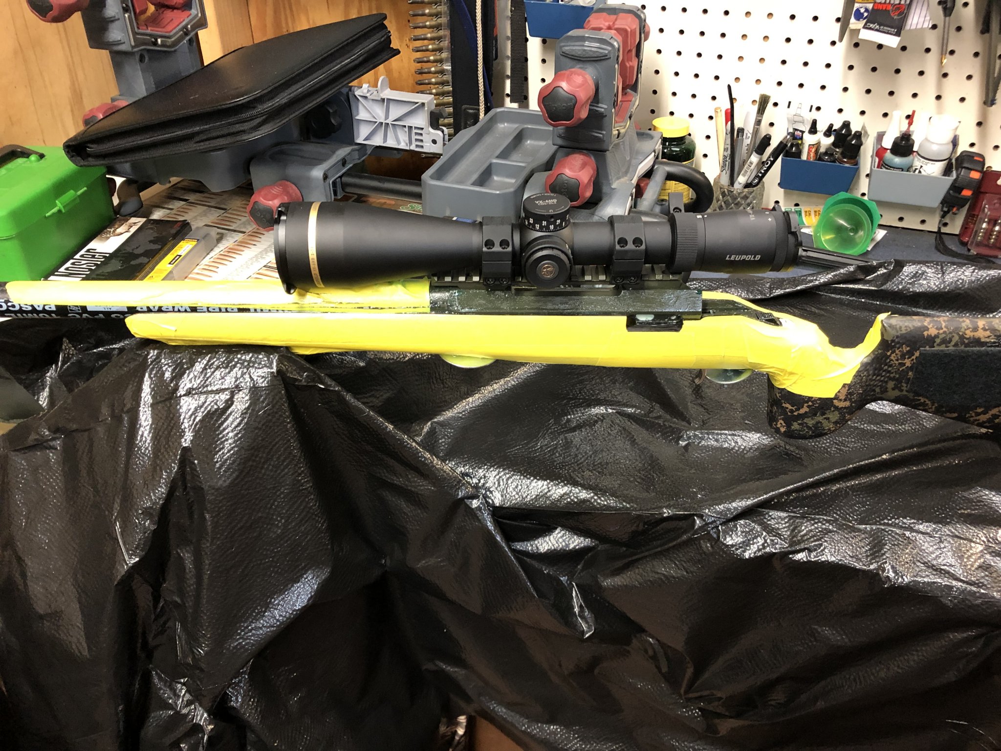

It's a Browning A-bolt and I ordered a McMillan carbon fiber stock. I'll shoot some pictures in a few.
After more precise measuring, the rear pillar is at least .20” too short.

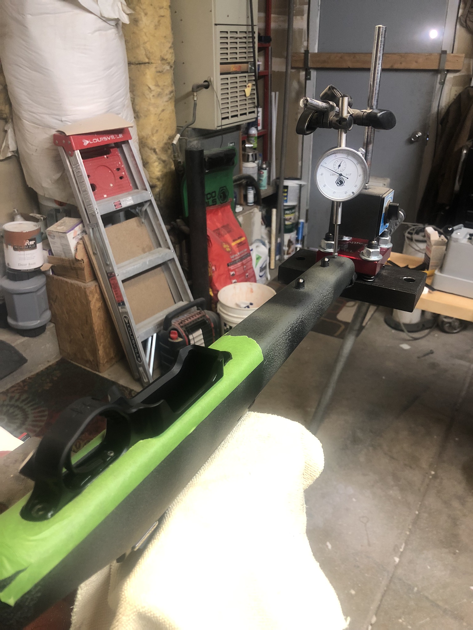

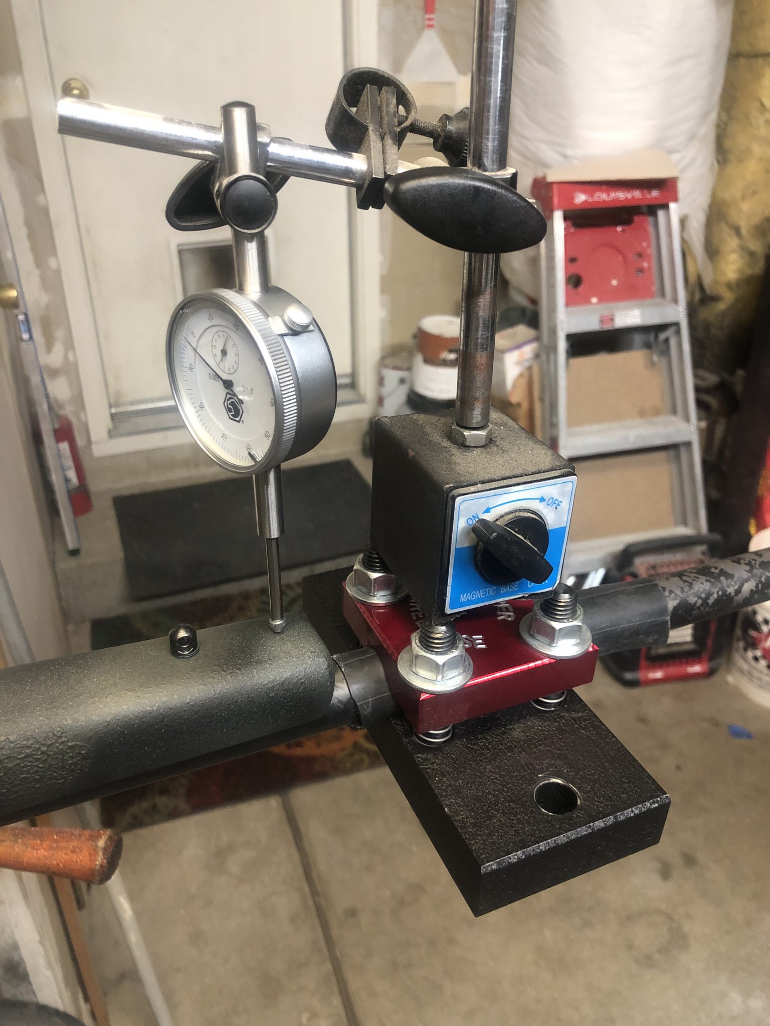

The real way to tell is to measure the deflection from barrel to stock while tightening the action screws. This was my setup on a carbon barrel. Your looking for < .001 .
