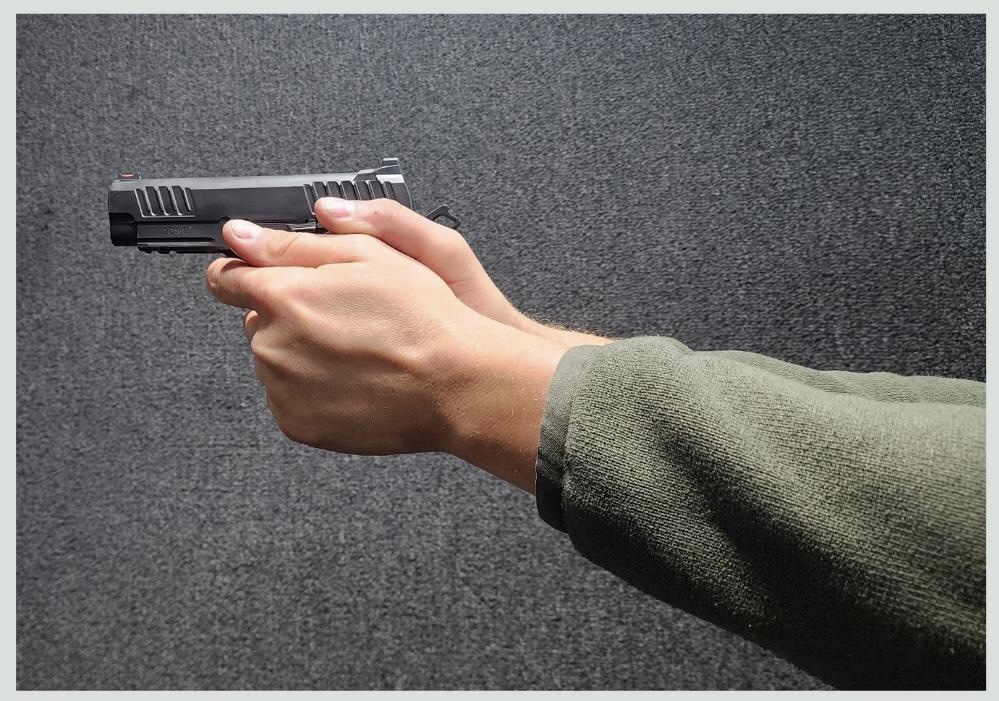

This doesn’t let you off the hook for proper technique but I prefer this.

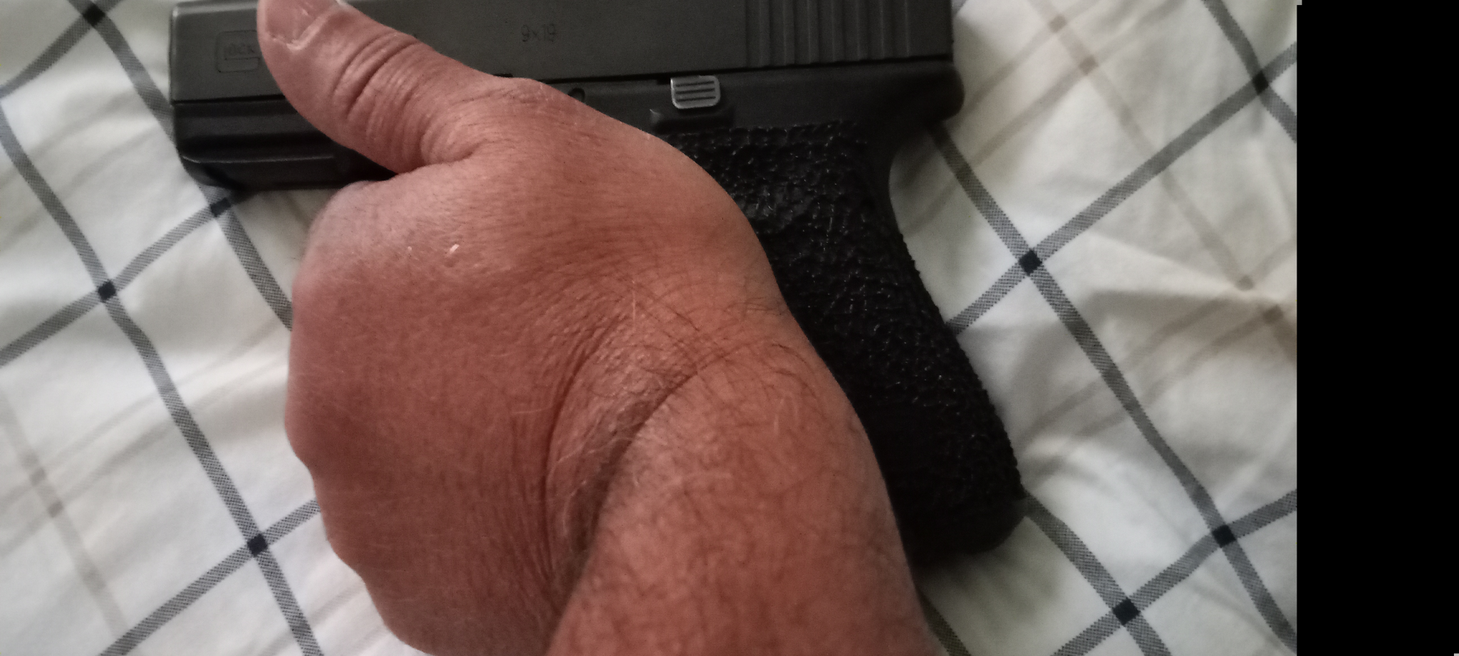

my grip is high. I use a wedge, forefinger around the trigger guard. The base of my thumb "non-trigger" hand, sits right on top of the mag release. A little pressure seems to be causing the mag to start to (not fully) release. I don't think I'm over thinking this.
I am no pistol-wizard. Not advocating for the above pic.

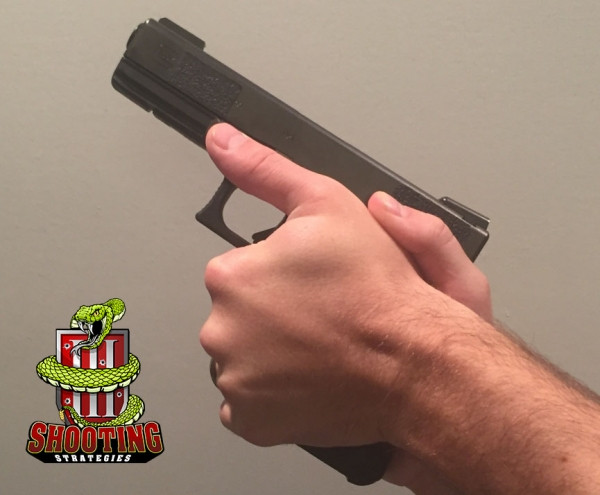

I found this pic of a fellow doing what I think you do with your off-hand index finger.
I struggle to imagine how on earth you are getting the base of your left-hand’s thumb on the mag release??

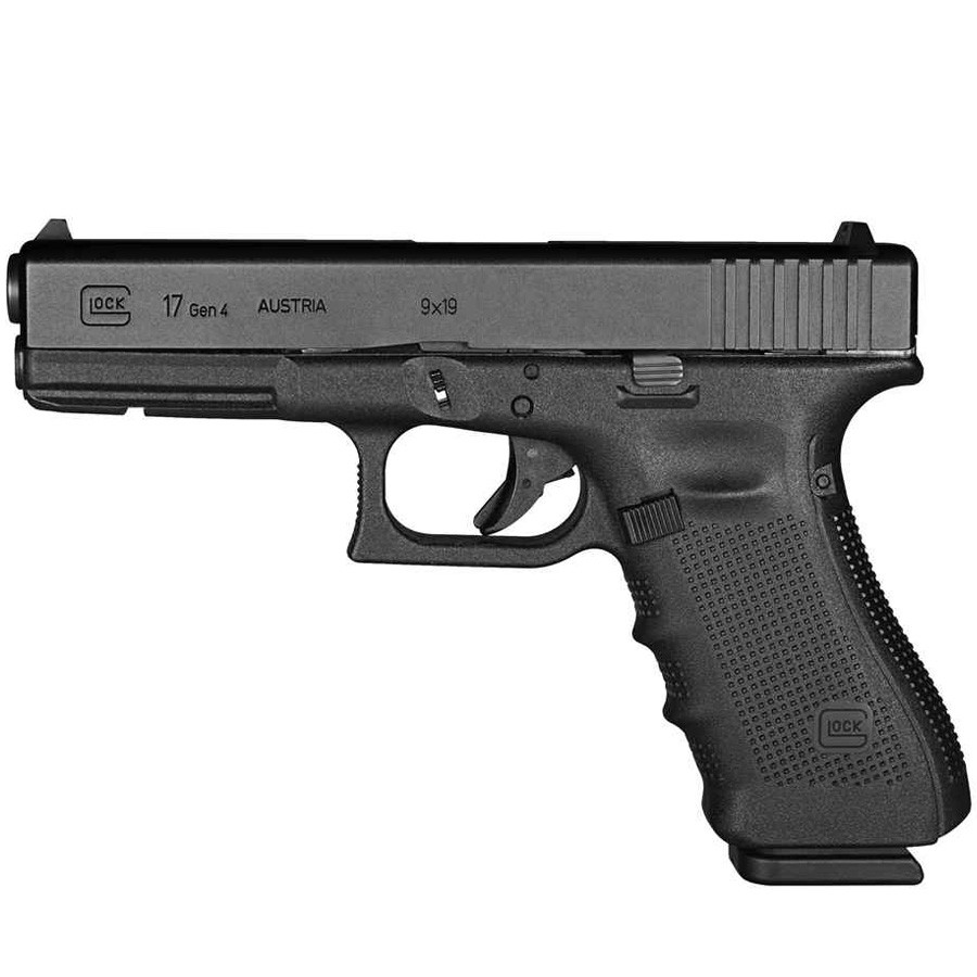

Here’s a gen4 g17
You’re going to have to post a pic of how you hold the gun, methinks.
as for the grip:
My thumb, per se, isn't on the mag release, it is the meaty part at the lower end of my thumb.

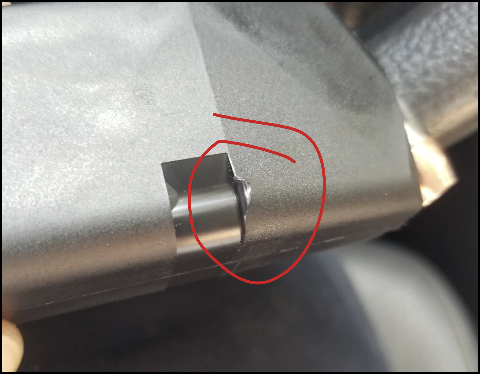

Maybe it's the mag? There's a notch in the mag that engages with the "mag catch" (the inside extension of the mag release). Is that boogered up?

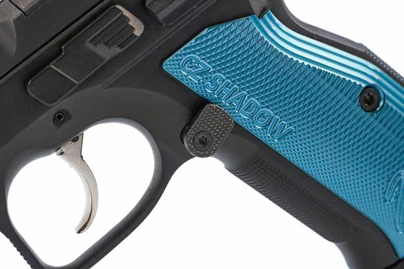

ETA this is me shooting a pistol (CZ Shadow 2) that has a mag release way more obnoxious than any Glock. I've never had a mag drop when I didn't want it to

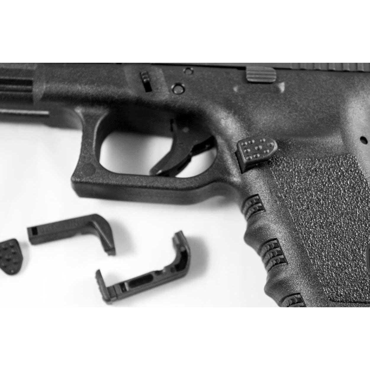

I also have this Ghost extended magazine release on my G17 and I grip that gun like the pic above. Guess what magazines don't move until I want them to.

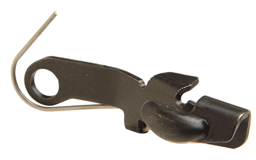

The Ghost forward slide release can be helpful if you shoot a Glock with your thumb up where God intended. ;)
It's not a lot, but it can be enough.

It's his grip. My G17 has a huge mag release button from Ghost and a reduced weight mag release spring from RYG.
Magazines still don't drop unless I hit the button with my thumb.
