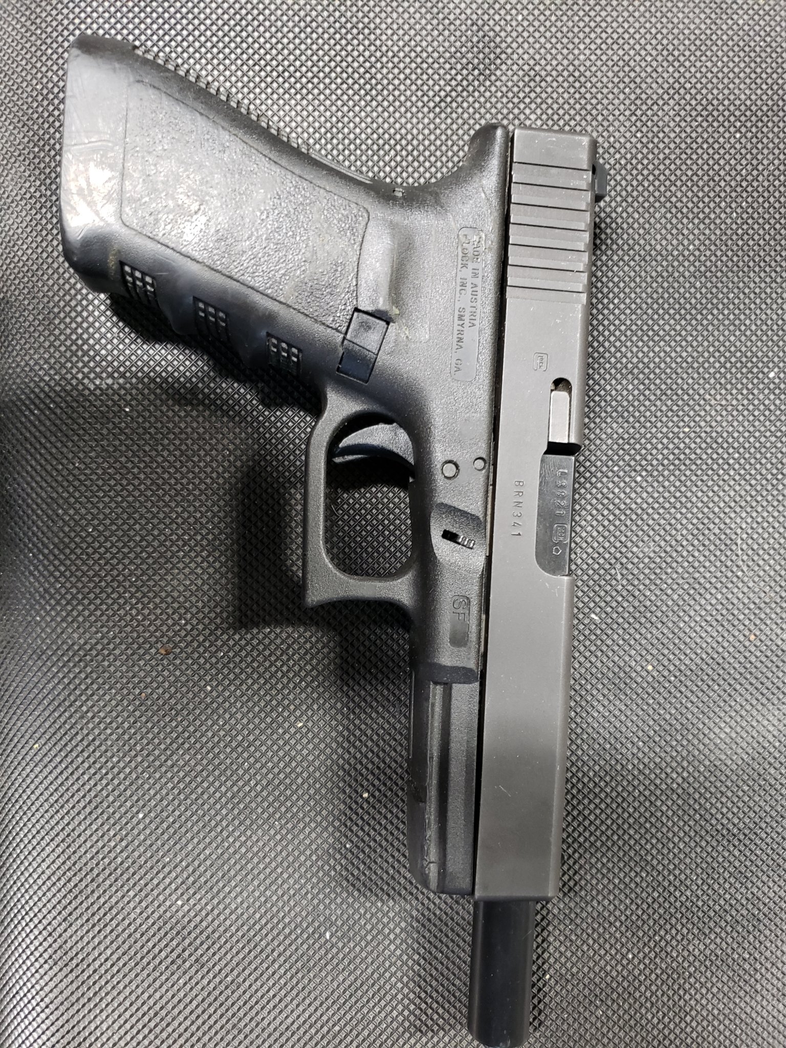

Pic of a Gen 2 on a SF, gen 3 should fit the same. Order from LW and wait. They get them made from an outside company and do final milling work. They are sold out before they get online, so placing an order is the best bet since you can cancel it if you find something.
