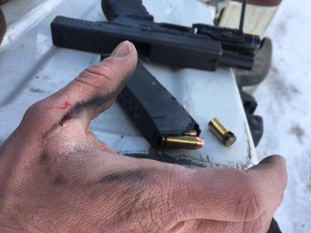

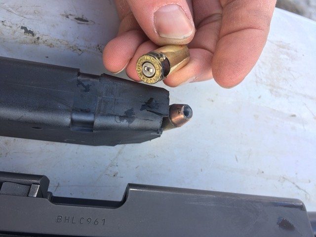

Ive been trying to get a glock 29 to run smoothly for about 7 years now. I started with a gen 3 couldn't get it to work, sold it and got a gen 4. Only change is the KKM Barrel because I just can't get glock 10mm barrels to be at all accurate and the brass bulges badly. I have tried all kinds of different guide rods and recoil springs. I have sent the gun and barrel into KKM to see if they can make it work, no dice. I sent the stock pistol back to Glock, they told me its fine.
I get the most malfunctions with heavy WFN 220 hard casts. Every time it jams, the nose slams into the back of the chamber at about 11 o'clock. It will also do this with hollow points.
I have noticed it is way more reliable without the pinky extensions on the magazines, but still jams every now and then. I have noticed I get significantly more malfunctions with the pearce pinky extensions. I have also notices it doesn't usually jam when I take well aimed shots, but tends to jam when I go to shoot a couple fast shots. When shooting fast, I grip the hell out of the pistol to help with the recoil and stay on target. I'm thinking it has something to do with the mag being torqued when squeezed hard, causing the tip of the bullet to point to the side.
Any Ideas? Any advise? I love the 29, but I just can't get one to run reliably like every other glock. (There is no limp wristing taking place)

Like mentioned, has anyone else fired it and had the ssme problems? Have you tried any other ammo? I saw you mentioned hollow points. Typically problems with Glocks are ammo or magazine related. If we can eliminate those as problems we can look at other things. Have you frequently fired any other Glocks without issue? Regardless of accuracy, do the malfunctions occur with the factory barrel?
Some pistols just won't work the same as similar ones....
At my department two officers carried Glock 21's bought from the same shop on the same day. Serial numbers were very close to each other indicating that production probably occurred at about the same time. One pistol would eat Fiochi 230 grain JHP ammo just fine, the other pistol would jam by failing to feed, or fail to eject properly almost every second round of the same ammo. Neither pistol had any difficulty with the Federal 230 grain hydra shok ammo.
My point is that some times a certain pistol just won't work right with some ammo. The only solution is to use different ammo. Otherwise, frustration is assured.
Yes I have owned about 15 glocks or more in 9mm, 40, 45, and 10mm. Have had any problems with the 9, 40, and 45 but both the 29 and 20 have always had failure to feed issues with aftermarket barrels and heavy 10mm ammo. They seam to work just fine with lighter target ammo, but I have 9mm's to target shoot with. I have the 10mm for grizzly protection here in Montana because I love the fact you can put night sights and a flashlight on them for when camping at night. I also have a smith .44 and a ruger .480 but have really gotten away from them due to the lack of nightsights and weapon light. I am just really having a hard time feeling comfortable with these 10mm with heavy ammo. Right when I think I'm comfortable with them, I go to shoot a mag to practice and I get a jam. Loose all confidence all over again.
Like I said, Ive been playing with this combo for years. I have narrowed down the old problem I was having to factory mags and heavy ammo. 15 round of 220 in a glock 20 was moving too sluggish for the fast moving slide. The slide was slipping over the rim and catching on the groove causing failures to feed. I have since them replaced all 10mm glock mags to wolf extra power springs and that has solved that problem. Now the problem I am having is the rounds are feeding off center (to the left) and slamming into the back of the chamber at about 11 oclock. I really think this problem is caused by the pearce extension causing torque on the mag. The harder I grip the pistol, the more likely it is to jam.
I'm sure if I put the factory barrel back in the reliability would come back, but I just don't trust the factory barrels in 10mm with heavy bear loads. Not to mention they shoot like shit. I actually blew up my factory glock 20 with factory underwood 220 hardcast. So I'm really trying to make 220 factory or handloads work with the KKM Barrels. I also have KKM barrels in my 19 and 21 and have zero problems.
Do you get the same problems without your light attached? I've read many threads about people having malfunctions with lights and or laser attached to the rail. From what I've read it changes the harmonics of the frame and causes issues
What kind of accuracy are you not happy with comparing the factory barrel with the aftermarket? How many rounds do you have on your recoil spring assembly? When you say "hardcast" is that lead? Hopefully you're aware you can't shoot those through a factory barrel.
My suggestion would be put the factory barrel back in and stick to more conventional rounds. Its sounds to me if you're trying to push the Glock far beyond what it's designed for by modifying the gun and hot ammo. Did you have the aftermarket barrel in when you sent it back to Glock?
Recoil springs are fairly new, both this 20 and 29 are new gen 4's. I sold my gen 3's a while ago. Yes I know about lead in a glock barrel, Underwood assured me it was fine. hahaha. Another reason I want to shoot the KKM is for the lead bullets. When it went to glock it was with factory barrel. I don't feel like I'm pushing the glock very hard or asking too much out of it. I'm just trying to shoot ammo that is designed for deep penetration to bust through a grizzly skull if need be. That being said I want to be able to shoot these 220 hardcast from underwood or buffalo bore and am happy to use an aftermarket barrel if that makes it work. They shoot great, just not reliable. As far as more conventional ammo, I went with 10mm for a reason. Most of the "Conventional" 10mm ammo is barely more than a .40 sw and a FMJ or JHP are not designed for deep penetration. I have done all sorts of hand loading over the years with 220 hard cast trying to get something to run 100% and just can't. I'm tempted to buy a bunch of buffalo bore 220 hardcast and run it to see how it does, but at $1.50 a round thats hard to do. I have a feeling there's a lot of guys out there packing around a 10mm with 220 hard casts that ran a few rounds through it and said good enough. I would bet if they ran some mags of the stuff through it, they would encounter some failure to feeds.
"Fairly new" recoil spring assemblies still may be too weak for what you're asking. If you're still not wanting to ditch the ammo that sounds as if its the problem, I'd replace the RSAs and try it.
But I still think the ammo you are trying to use is over what the Glock can run. What is the velocity? Your last sentence even shows you feel its an ammo iss and not a Glock issue.
Fairly new meaning less than 300 rounds through them. If they can't last 300 rounds, we have some other problems. I tried heavier recoil springs in the past and it made things worse. Yeah I'm with you on the hot ammo causing issues. Its pretty frustrating, if I wanted to shoot target ammo I'd be shooting 9mm pistols. The point of these 10mm is to be able to run powerful ammo for hunting and big game defense.
I have been using the Pearce Glock Gen 4 PG-1045 + extensions on my G29 with the stock barrel. I have had no problems with factory Hornady 200 XTP or my own handloads using the 200 XTP and 12.9 grs of AA#9. The only problems I've had was with SWC style bullets failing to feed in the G29. My G40 also functions fine with the 200 gr loads. I haven't had any experience with the WFN hardcast bullets.
