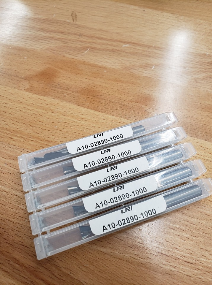

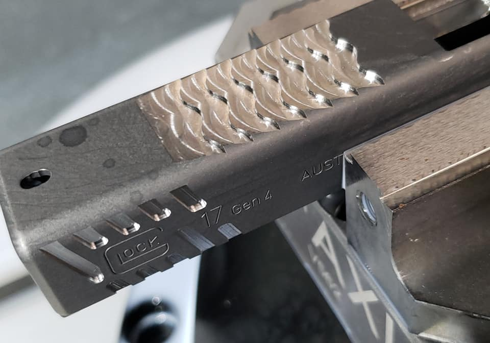

    Necessity is the mother of invention. So it is said....

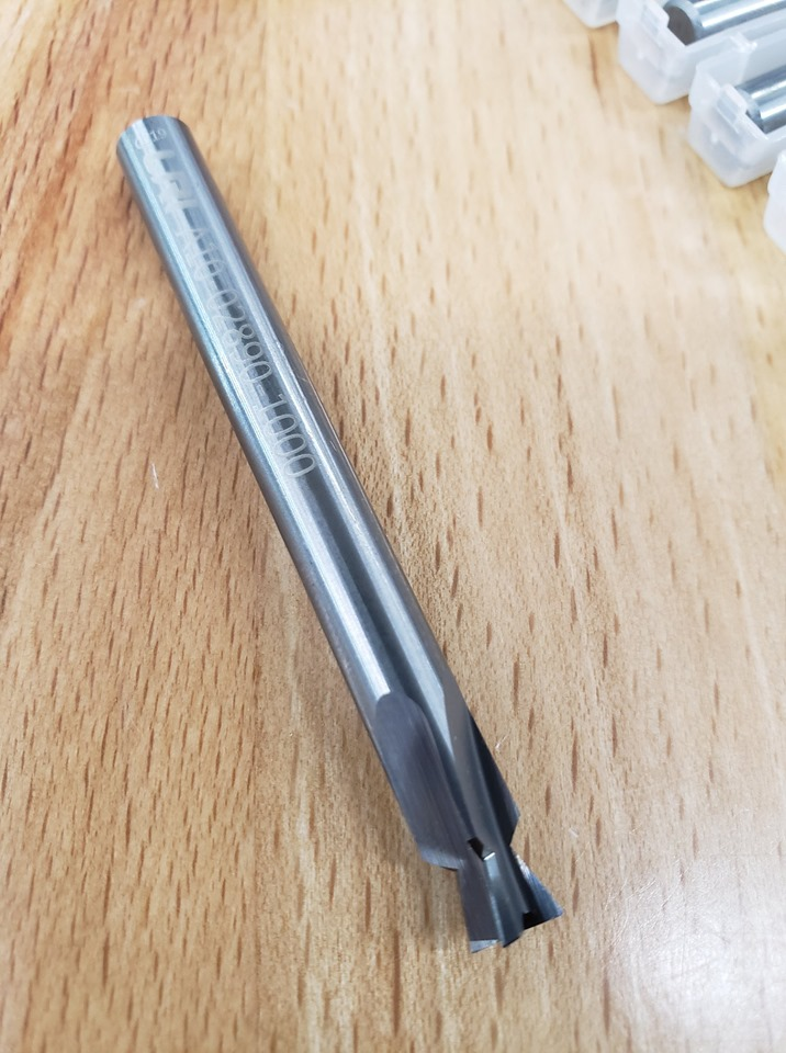

    Recently one of our dealers asked us to do some slide work on a Glock. Sourcing solid, micrograin carbide tooling for this proved difficult. -as in, no one seemed to have it. That box is now checked.
    7120226
    7120224
    LRI is now making its own tooling for barrel work and Glock sight installation. These cutters are solid, micrograin carbide and ground to 74*.
    In stock and ready to ship.
    Happy to help.

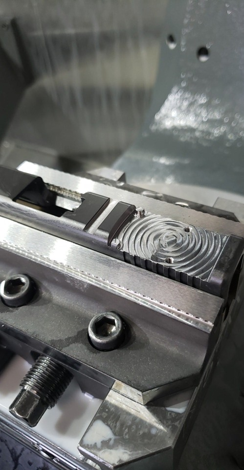

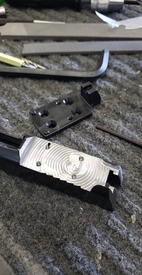

    Here's today's fiasco:

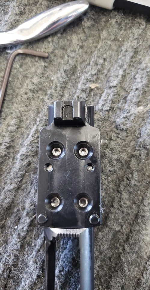

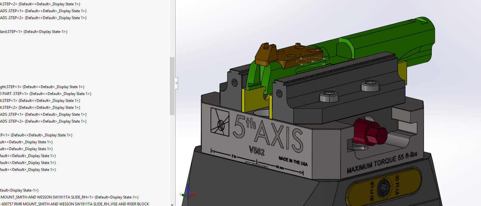

    Trijicon 1911 RMR sight adapter (PN CA4280c0600757) stuffed on top of a Smith&Wesson SW1911TA. One single setup. Fully automated now.
    Modeled the slide and the sight mount in Solid Works first. Would much rather cuss there than make the phone call of shame...lol.
    Checking the fit. Nice when the holes line up! One little thing I did here was ID bore the holes to size using a 1/16th endmill. If you look close, you can see the hole(s) are flat bottomed. Nice because it provides a little extra clearance for the thread mill and it gets the effective diameter all the way to the bottom. Helps to ensure the head of the screw does the work instead of the bottom of the screw. (which almost always results in a boogered thread that now has to be run through the entire length of the threaded hole before it comes out. -A great way to kill a part and/or strip the head out of a screw.)
    Off the machine finish. Not sure how that broken hole is going to play. The print provided by Trijicon is pretty particular about installing this plate -.102" from the bottom of the front sight dovetail. This hole appeared at around -.085". Not my first choice, but not much a guy can do about it either.
    Video clip proofing out the probe routine for setting this job up.
    Video clip threadmilling 6-40 screw holes

    I believe the broken hole is the extractor channel showing... I think that is a little deeper of a melt into the slide...
