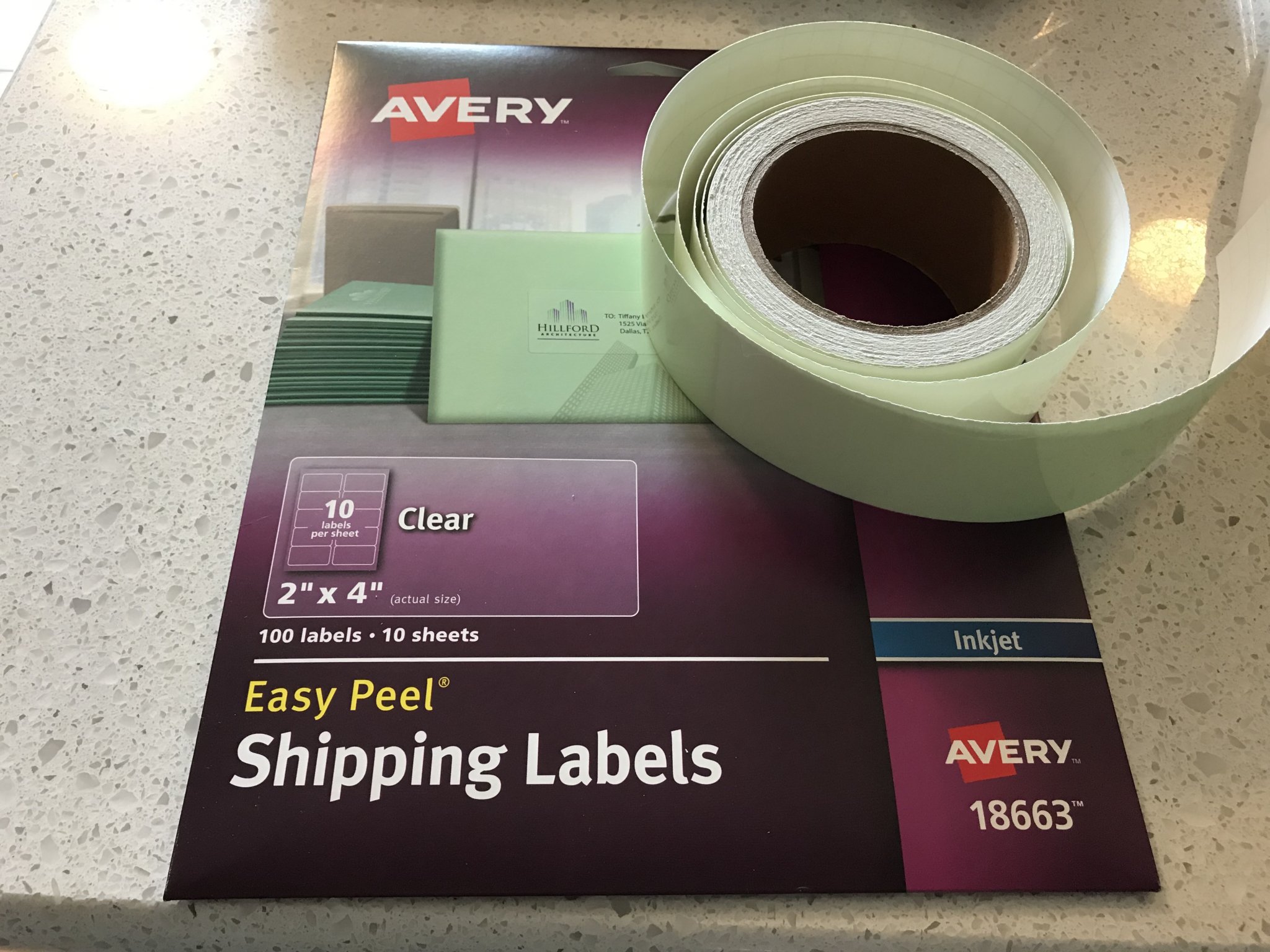

So occasionally we gotta shoot in the dark or low light and I really don't like turning on a bright flashlight to double check my book or my DOPE card. I got some glow in the dark 2" wide tape on Amazon to make Glow in the Dark DOPE cards. I printed the gridlines on Avery CLEAR 2"x4" shipping labels and applied them on top of the glow in the dark tape. I added a layer of thick cardstock and then trimmed them.

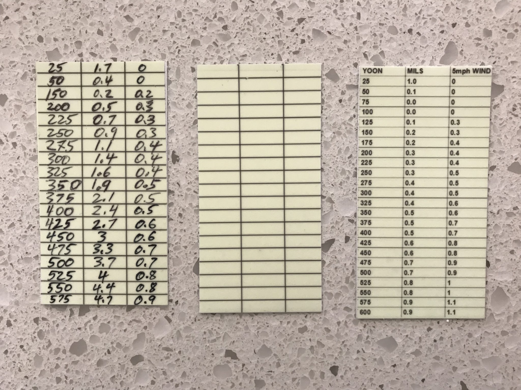

The blank cards with gridlines are 2"x4" and have 3 columns and 19 rows. You can write on them directly with ball point pen/sharpie for permanent, or they take dry erase for easily erased data. I also used excel to create some printed dope cards. I was able to get the font smaller and fit more lines to include range, drop, and wind hold.
I'm probably gonna back a few with adhesive velcro to attach my my rifles. however, they also fit in the Sidewinder dope card holders and wrist dope card holders.

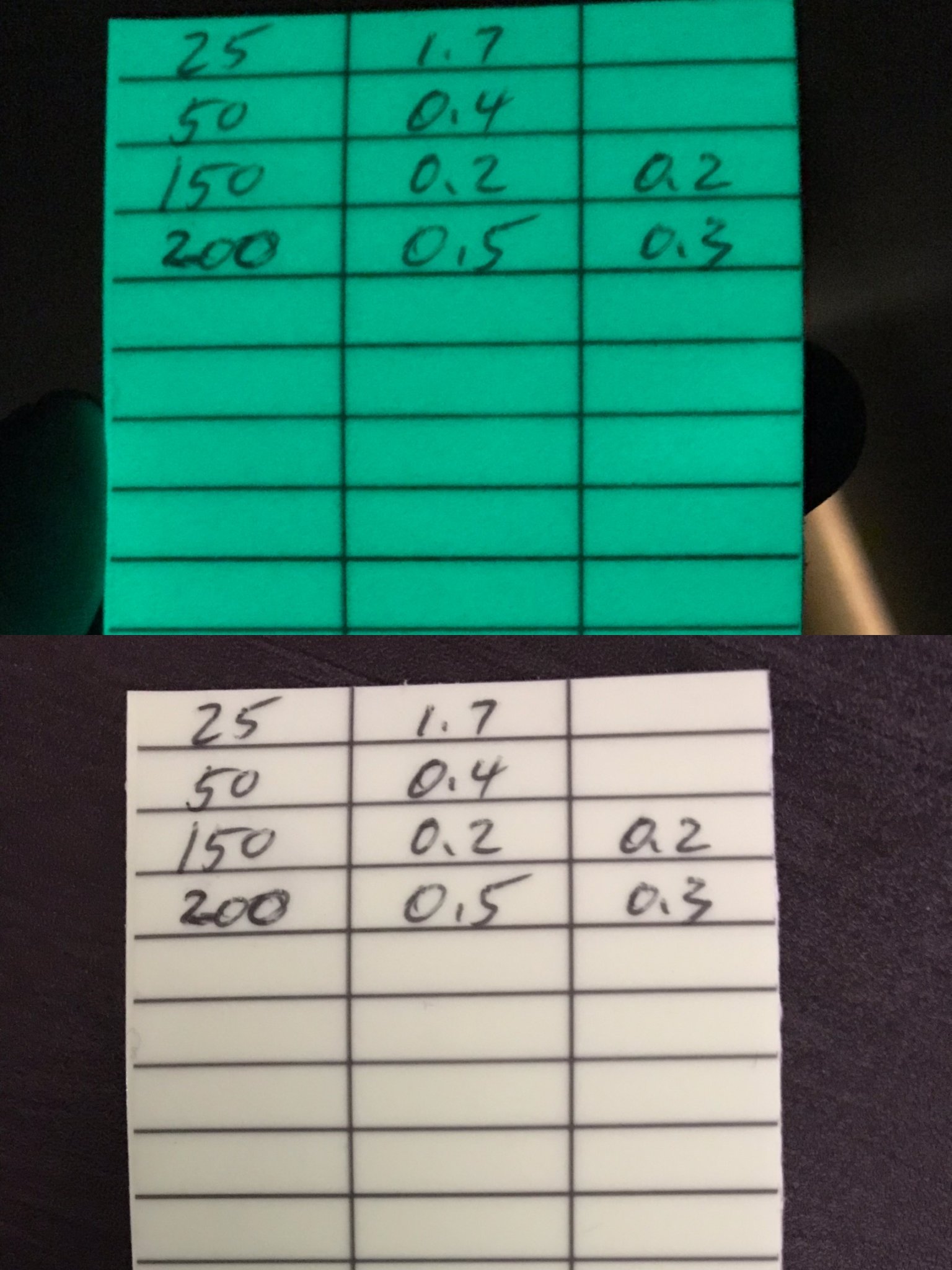

After being in ambient light for about 2 hours, the glow lasts about 30 minutes. You can also 'charge' the glow with a flashlight and it'll glow another 15 mins-30mins.

If you write directly on the printable label, there's no smudging after the ink dries. Works with both sharpie-type permanent and standard ball point pen. It just takes a few minutes to dry.
If you laminate the finished label, ink pens will smudge if you write on it. However, dry erase pens work great for temporary marks.
