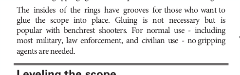

Few weeks back, i got my RPR 6.5CM.
I'm getting my Nightforce Scope tomorrow, and I got my Spuhr mount today.
Reading through the instructions, it suggests loctite on the screws and possibly gluing the gun in place.
Would you all recommend this, or is largely unnecessary?
They are cagey about it. "Some shooters..."
And they talk about loctite on the screws, gluing the scope to the rings.
May depend on the amount of recoil. I've heard of the big magnum rifles needing a little help to prevent scope slipping. There was actually just a thread on this.
7113319
Interesting. I would never do that.

I've only rarely heard of truly gluing scope to rings for securing the scope, and then only in heavy magnums. Not familiar with too many bench rest types that use those.
Most of the gluing that I'm aware of was Elmer's or rubber cement as recommended by the scope manufacturers years ago in order to protect the scope from cosmetic damage / ring marks. Elmer's will just peel right off a scope leaving a smooth surface.
In this thread from Oct 2018, Spuhr seems to confirm this, as I recall Rosin used to be the thing instead of glue for Spuhr.
Post #11:
Nope, you don't need it.
You need it for very heavy recoil, but most important is to NOT clean of the wax of the screws as that will greatly limit the torque holding the scope in the rings.
Rosin is as written above a small insurance to not get any ringmarks, now there is a minimum risk of getting ringmarks with our mounts but never know, it might happend.
I use to put rosin inside all rings.
But that is just me, thinking anything that is worth killing is certainly worth overkilling :)
Having never used Spuhr mounts, I wouldn't know if they are prone to leaving ring marks, although I wouldn't think so.
How odd that the instructions have changed so dramatically...
