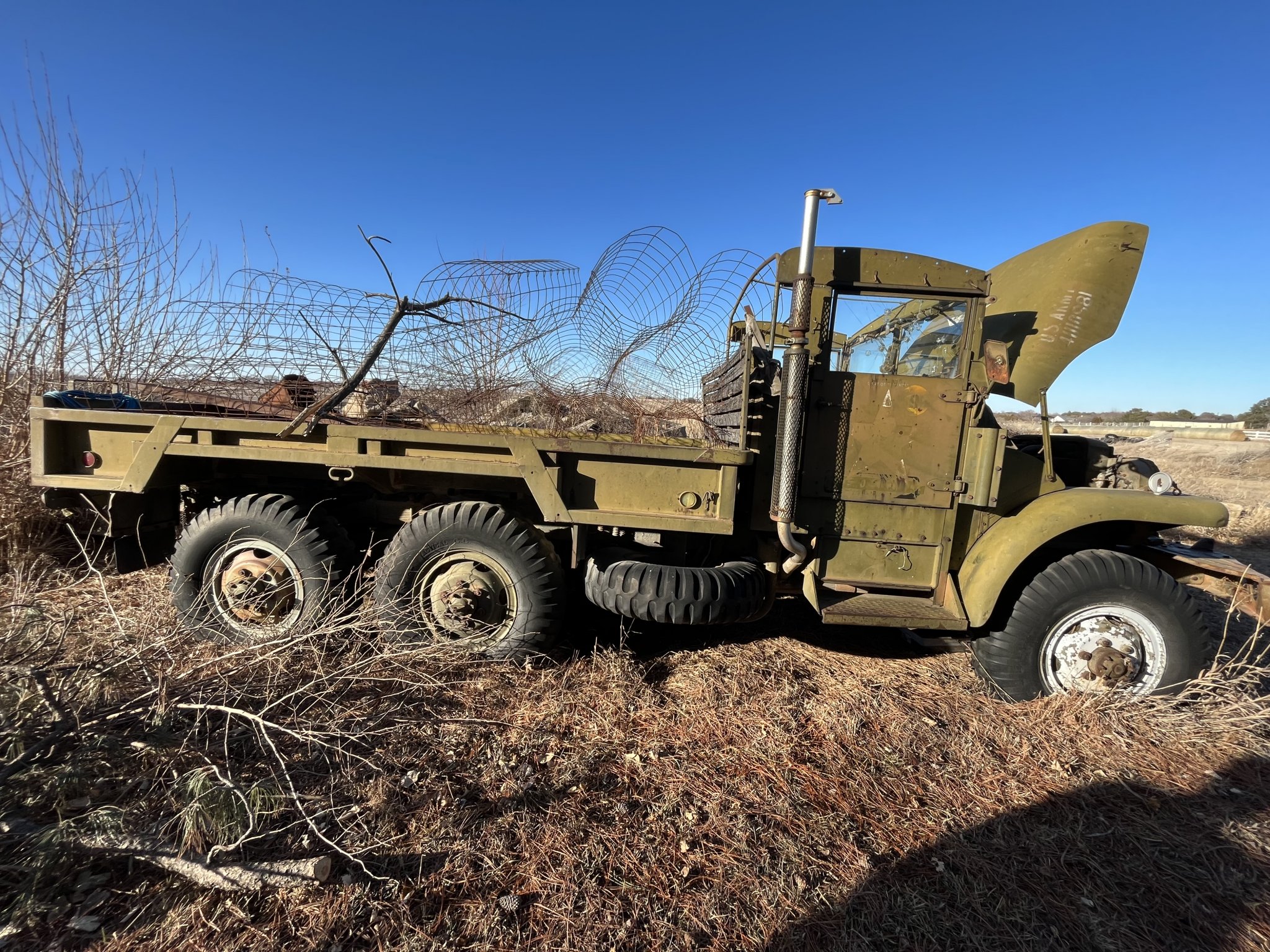

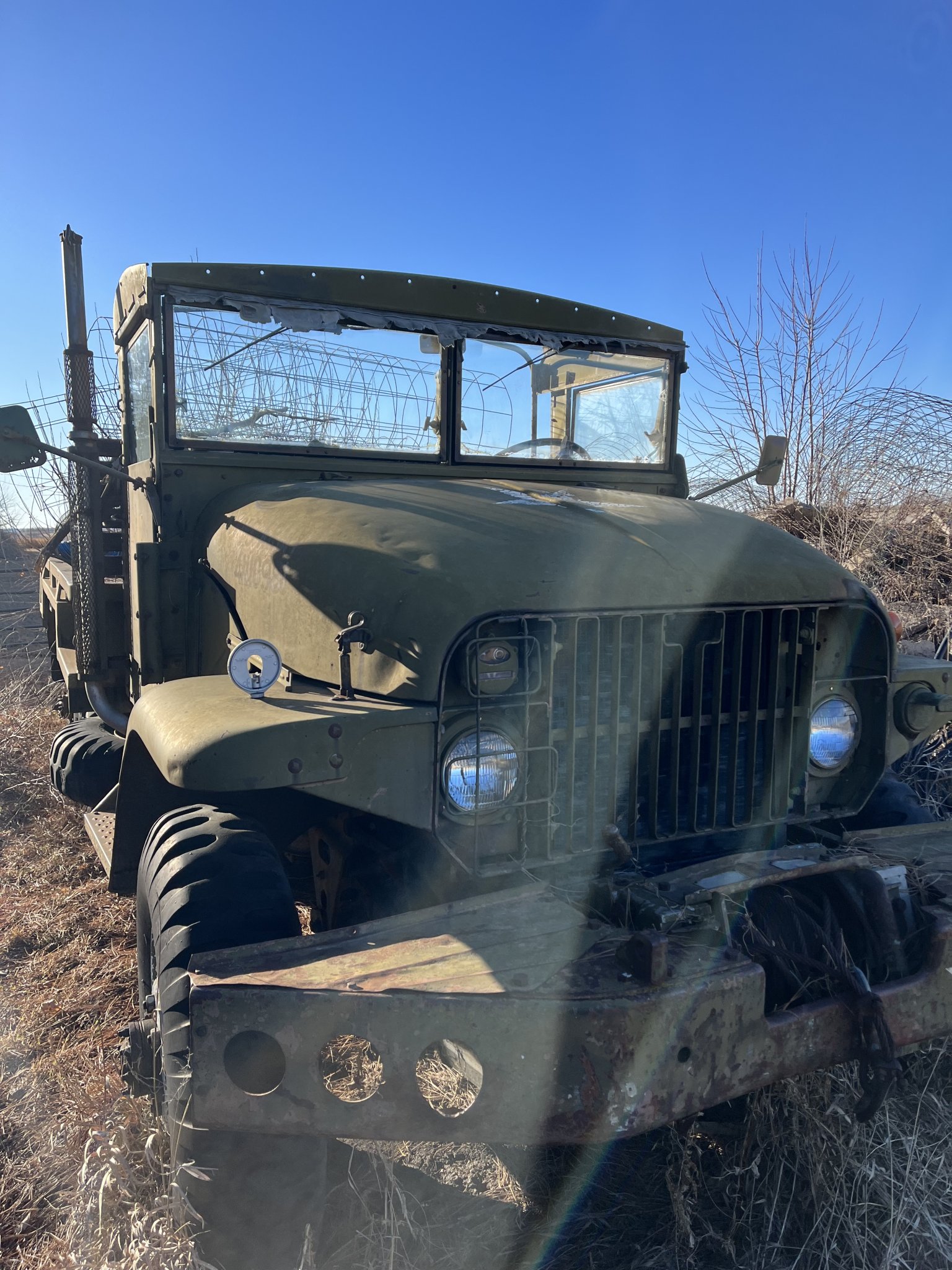

Just acquired this 1952 project. Anyone have experience with restoring or getting these back to a good bill of health? Pictures for motivation please!

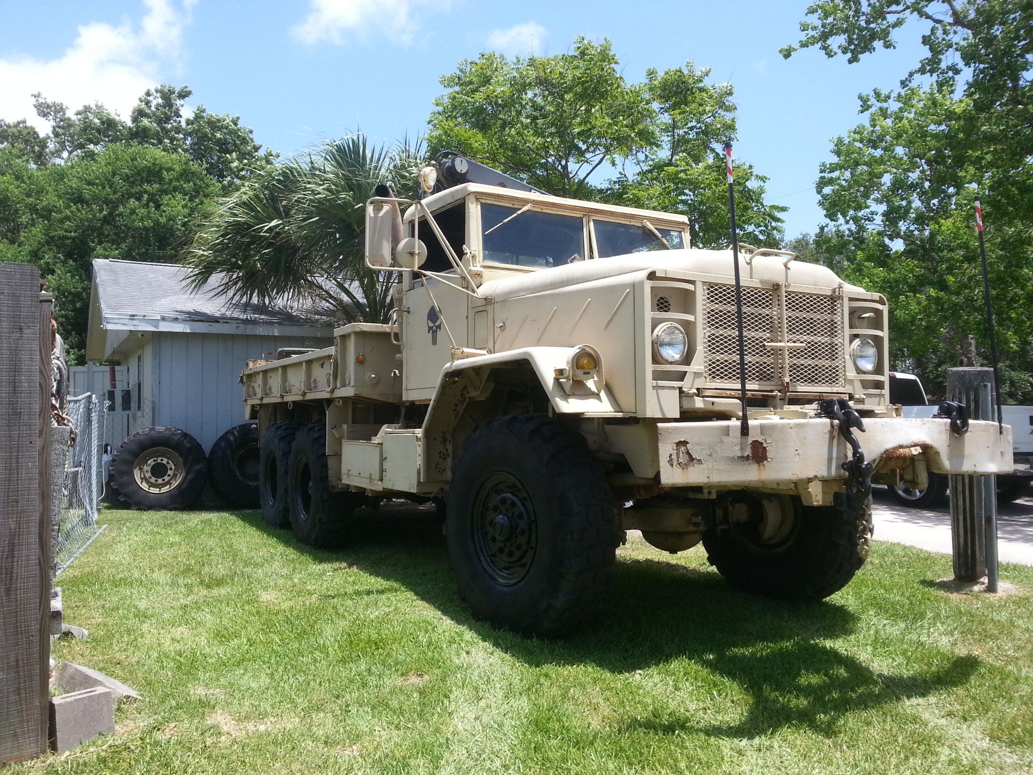

yea about the only restoration that would be harder is a fire truck.

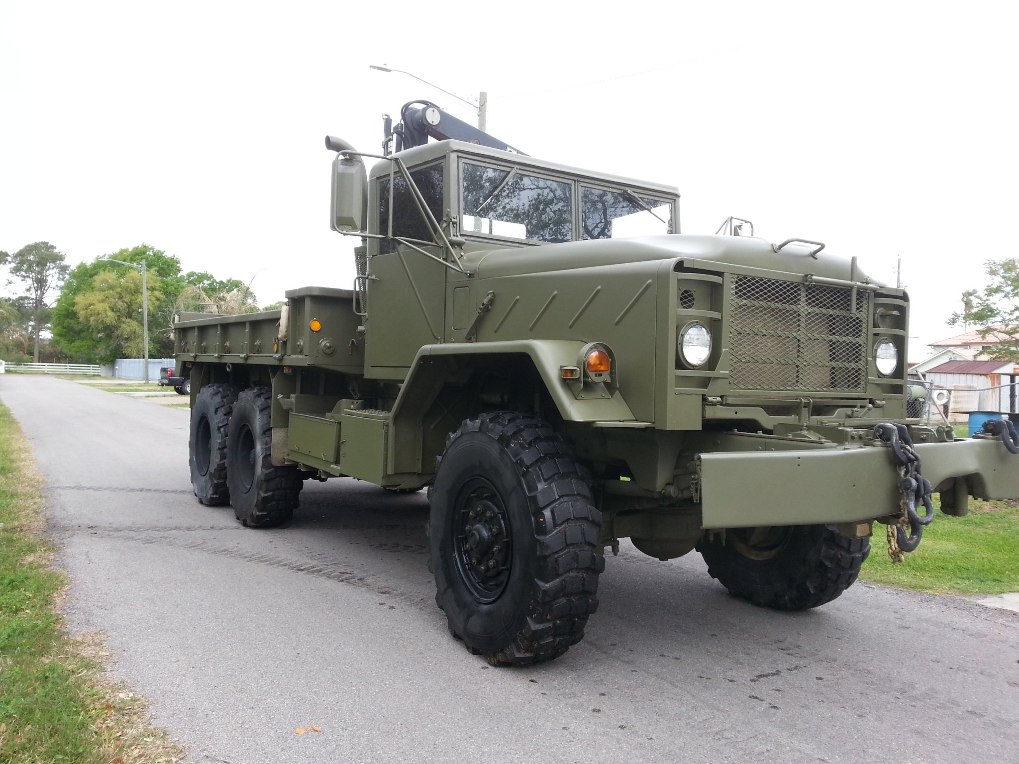

I restored a 1986 5 ton and it was mechanically mostly fine. took me a year for a cosmetic resto. with help, parts were available and cheap.
I doubt parts are that available for the older deuce but I could be wrong.
it was cheaper faster and easier to buy new loaded doors rather than rebuild them for instance.

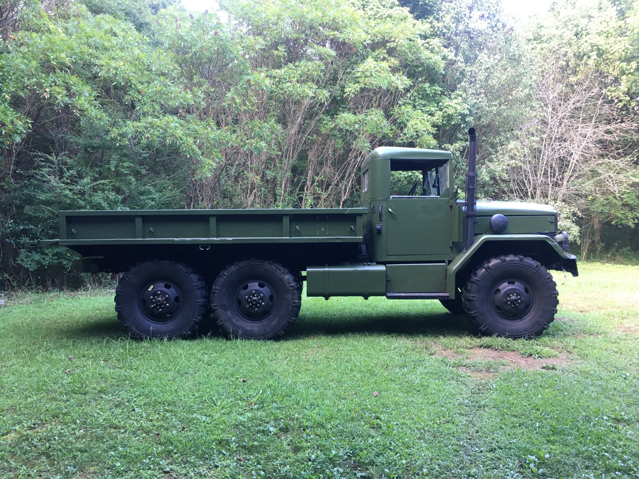

Here's my '72 when I finished it. She was a real pile of shit when I got her. Spent about 2 years, tore down to frame, built back almost to spec.
Made a ton of money on it, assuming you don't count my hours/labor that went into it.
I don't lose any sleep over not having it anymore, but it sure was fun a couple of times a month.

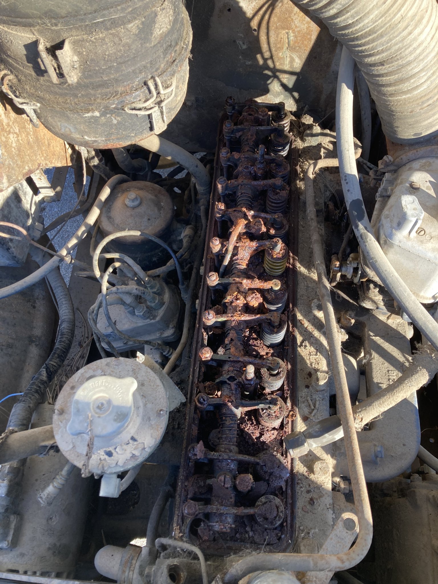

Engine is somewhat locked up and pretty rough inside. This may end up getting an engine swap soon.
Probably not going to do a full restoration on it, I'm liking the older paint and "rough" look. Already getting attention in my parking lot
Do mechanicals first. Those are simple engines. Don’t swp, just rebuild. Way simpler than messing with swaps.
Pull engine and have rebuilt. Do everything else yourself.

Even with that haggard valve assembly pic above, I'd still be willing to bet that it can be revived. Find the FM for that model/year, there are likely a few different ones; I don't think there was a single, all-encompassing volume.
The best piece of advice or rather the best phrase you can keep in mind during this project is: these trucks were designed and built to be 100% repairable in-field, by 19year olds with no formal education.

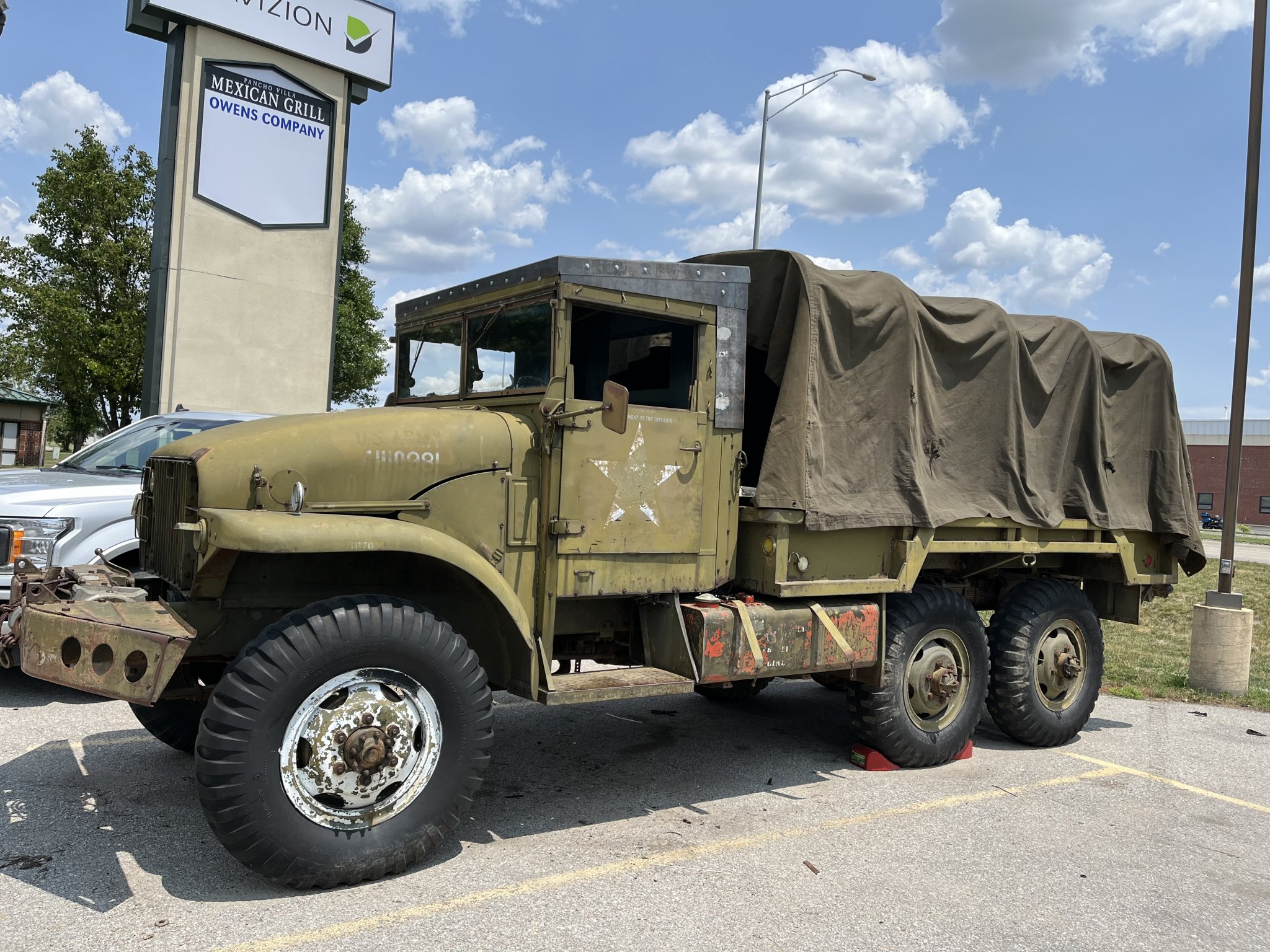

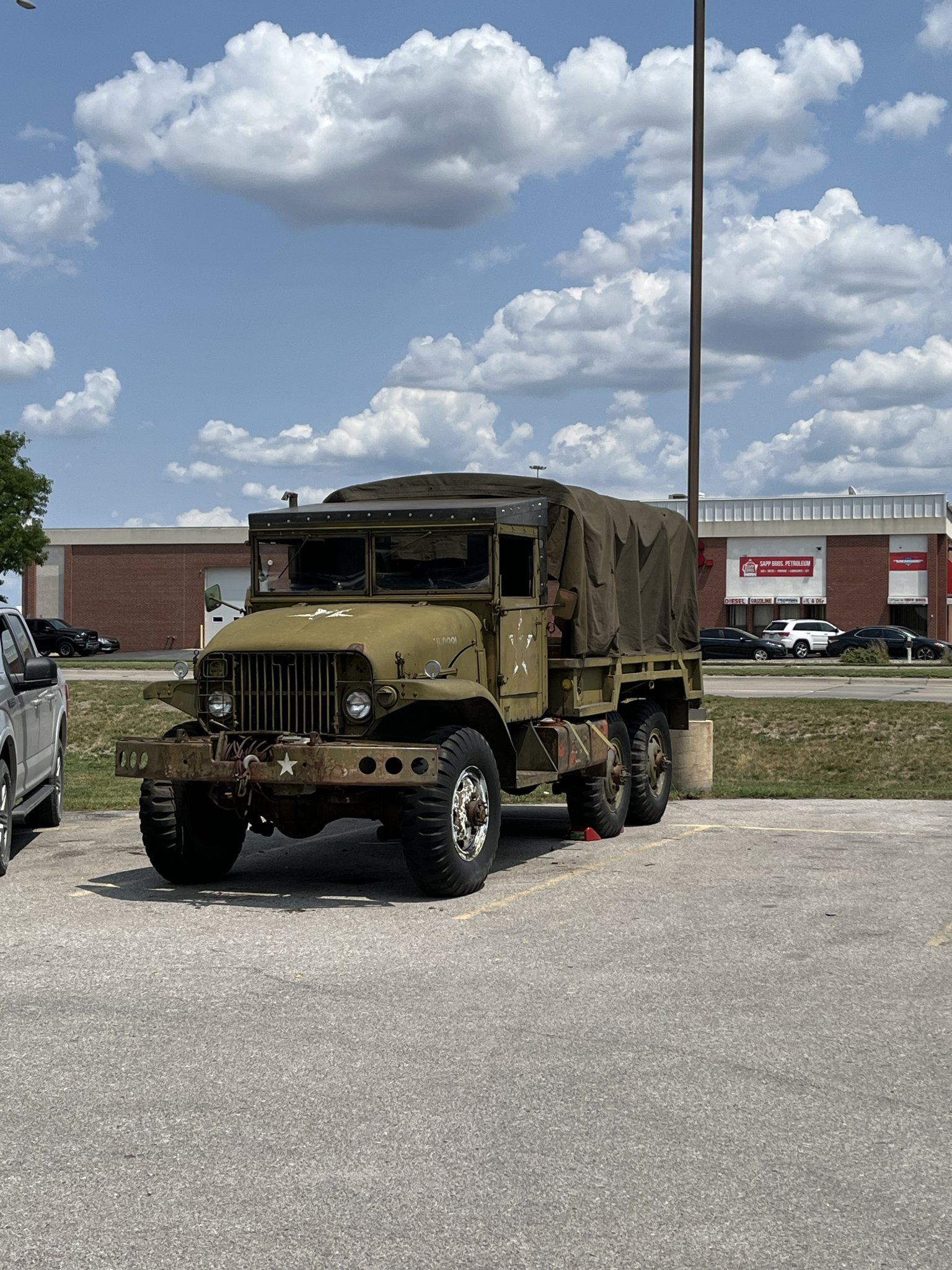

Lot has happened since I got this. Decided against a full restoration - I like the patina and age.
Engined had a couple stuck valves, but after some soak time and a gentle touch, it’s free. Engine runs nicely. Fixing brakes now, then fingers crossed the transmission is good.
Had a metal cab top and back fabricated for it. Found staves, bows, and rear canvas for it.
Next up is a power wash and to repaint the stars and lettering.
