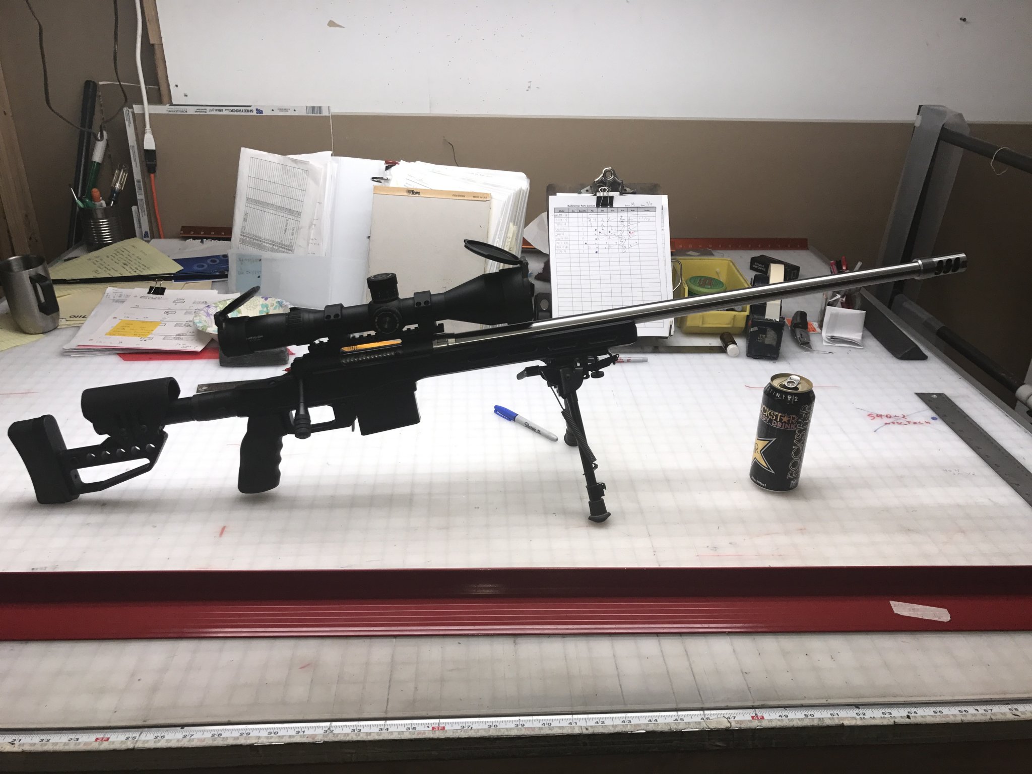

First off, I am not a true Fan Boy and ended up choosing a Savage BA Stealth Evolution in 6.5 Creedmoor by default. You begin by weighing the possibilities, your intentions, and then assess $ pain threshold. Exactly what I did, and a 6.5 C BA Stealth Evolution was the result, a choice made for a few reasons other than just dollars. The accurate floating/easy to swap bolt-head, and the easy barrel swap both come in handy to add 6.5 PRC capability (in the near future, it’s still to new). With the Creedmoor bolt head, going to a 308 is just a barrel swap.
Savage generally makes it easy to have one platform and several calibers or purposes for it. $200-300 gets you a light weight 308 shorty for the 168s or heavies for hunting. A little more dinero gets you a 6.5 PRC for some ELR fun on a budget; or maybe a screaming fast laser varmint smoker of whatever flavor you like. Yes you still need tools, but a Savage is some easy ‘no smith’ barrel switching, well after the first time anyways. To me the Savage/Drake/MDT Evolution is really the start of a modular BA rifle system. Besides the Savage BA SE giving an upgrade path and modularity, you’re in the PRS game for peanuts.
Why start with 6.5 Creedmoor? Mostly just wanted to try it out, and hey it’s a Savage, if it wasn’t all that, then a factory ‘take off’ 308 is a phone call away. Or maybe try a 6mm or 22 Creedmoor.
I know the BA SE is not the best deal. In 6.5 C both the RPR and basic BA were cheaper, but it is still a pretty good deal. Now why pick the Stealth Evolution over the GRS, or the Ashbury? Even though they aren’t chassis couldn’t they work as a modular rifle system too? Maybe, both are tempting in their own right. They can't be made to fold though, and I always intended this platform to fold eventually.
Without a custom budget, factory or semi custom rifles are the only ticket to the PRS game. Though the MDT/Drake chassis with its removable NV Bridge is right up there, it was the Evolution’s receiver that was at the very top of the plus side of the Pro/Con list for factory choices to use as a semi-custom. Savages generally have relatively accurate receivers/bolts from the factory, but the Evolution's is built more like Savage’s target receiver. For all I know it may even be one just ported for AICS magazines to make it a repeater.
What are the Cons? To be real clear, I am very happy with ours. Or more accurately, I am very happy now...
Though I am 6'1" and 210 lb.s apparently my head is too small, because even with only a 44 mm scope and medium rings I was practically using a jaw weld with the Magpul PRS topped out. I tried adding a 5/8” pad and still couldn’t quite make it work. To be completely honest it was a foreseen problem, because the LR scope picked to be first at bat was going to be a Sightron 10x50x60. Also the grip was uncomfortable for me due to an injury. The accu-trigger seemed to continually degrade once it was adjusted to ‘light enough’. So it seemed that soon ‘not to happy’ turned into very frustrated, and definitely unhappy. Clearly the Evolution needed to evolve…
The Evolution Solution:
  • Lost the Night Vision Bridge. Next, dumped the Evolution's native MDT/Drake rail. Then installed a set of (Medium) Hardcore/Extreme's Force Recon Tactical Rings mounted on their True Level 20 MOA pic rail. That allowed the Sightron to wear medium rings and clear the barrel.
  • Swapped the PRS stock for MDT's Skeleton Rifle Stock in the short version to allow the addition of their folding adapter and still keep the LOP range correct. The stock with folder is real game changer, and there is little I would change at all if I could, and it was worth every penny and it fits great in any shooting position.
  • Swapped the grip out for the more vertical Royal Arms and it is GTG for my hand/wrist.
  • Never a real fan of the Accu-Trigger conceptually; I had heard so many good reports I held out hope it would be great. In truth it wasn't really very bad, until the pull weight was light enough. Then it would randomly disengage from the sear, and it occurred ever more often. That finally got me so frustrated that I swapped it out for a Rifle Basix SAV-2. Also a super good choice BTW.
Now the rifle pretty quickly fits the whole family, (we are all kind of tall folks) in any shooting position, and the accuracy? From the bench, using Magpul's Bi-pod (screws right to the chassis) and without a rear bag, I have gone from .75 - 1.25" 3 shot groups to .75 - .25" and my average group now is less than .5" A good session averages closer to .3 than.4. using Hornady 140gr American Gunner factory tailor-mades. Someday I will break down, roll my own and see if I can do any better than Hornady does.
So how did it turn out?

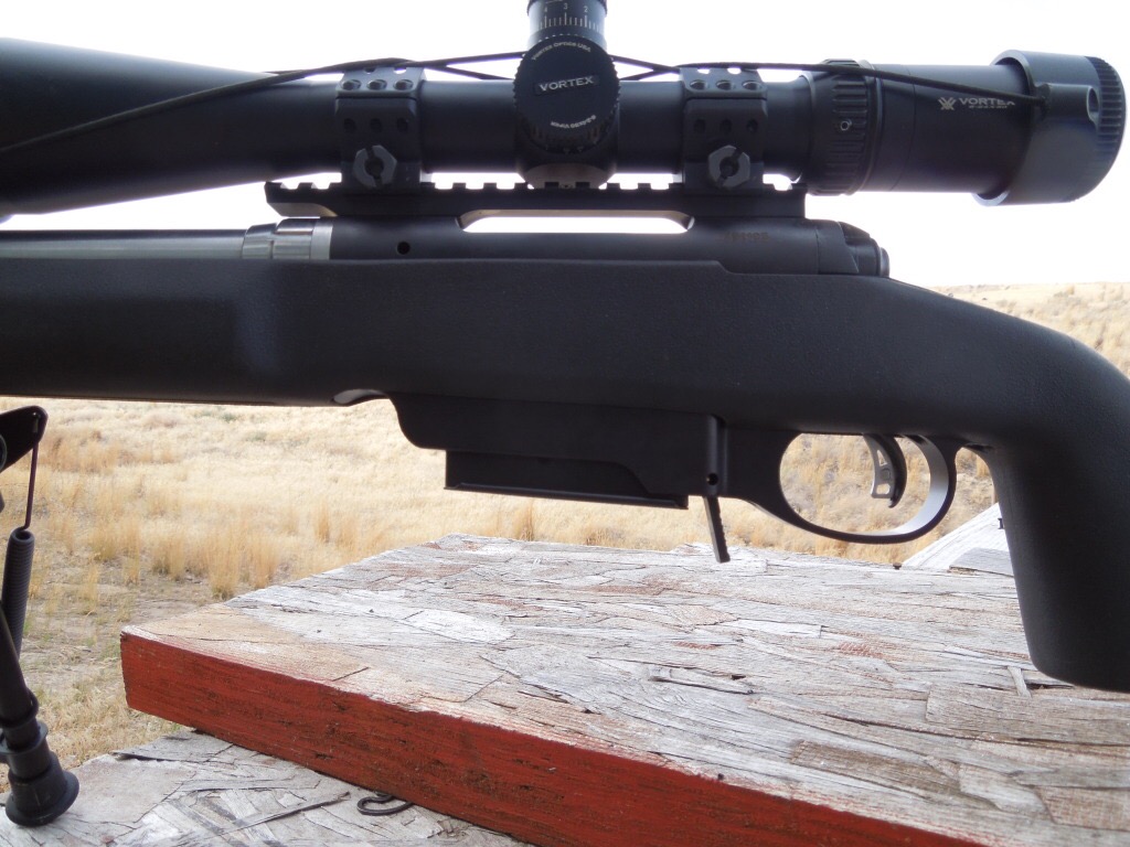

See for yourself. Because work has been so crazy, the last day I got to shoot it was a few weeks ago, and though I only shot 3 groups with it (it was the 4th, lots to do, and lots to shoot), and the time before that was back on Memorial Day, I think I still did alright. I pulled or pushed one in each of the first two groups. It seems the rifle is grouping very well everybody is ‘lights out’ with it now. So the next time out I'll zero it at 34 yards to get a 5 inch kill zone MPBR (+-2.5”) with Hornady’s 143 grain Precision Hunter. Max height (2.5”) should be around 130+ yards with a far zero of 225. At 270 yards it will still only be 3 inches low, and very easy to dope in my head to 600 yards.
Bottom Line?
When we finally buy a 338 Lapua, I am pretty sure we'll be looking for a good deal on a Savage BA Stealth Evolution to use for the magnum cases, and then I will probably "evolve" it much the same way; then add a 300 PRC swap barrel, and maybe something in 358 or 375 or…

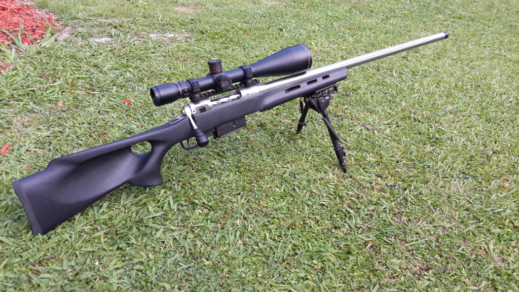

I started the precision/long distance thing with a savage model 11.
It served me well and I put about 25#-30# of powder worth of reloads through it.
Below is a few pics on the evolution of it.
7116141
7116143
7116147
Now I’m running a ARC Nucleus and loving it but I’ll always have a soft spot for savage rifles.

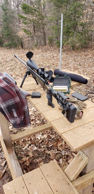

I'm a Savage Whore. Started in the Precision Rifle deal last Summer and bought a Savage 10 FCP SR in 6.5 CM and shot it and started tweaking. Every change I made added a little tighter group at 100 and I have never experienced any problems or failures. Presently concentrating on hand loading to find my perfect load but the gun is done until I need a new barrel and then I'll re barrel it in a 26" barrel and keep on shooting.
Just putting a new computer in service so I don't have the evolution pix. I'll add them later.
But the current rig wears a MDT LSS-XL Gen2 chassis with a XLR Extreme Butt Stock, an Atlas Bipod, MDT polymer magazine, Vortex rings holding an Athlon Argos BTR 10-40X 56 scope, and an Ergo Sure Grip and Area 419 Hellfire Brake. Shooting sub .5 MOA out to 600ish and maintaining sub MOA out to 1000. I have no problem with the old Savage actions and will buy another if they survive being sold and hacked.

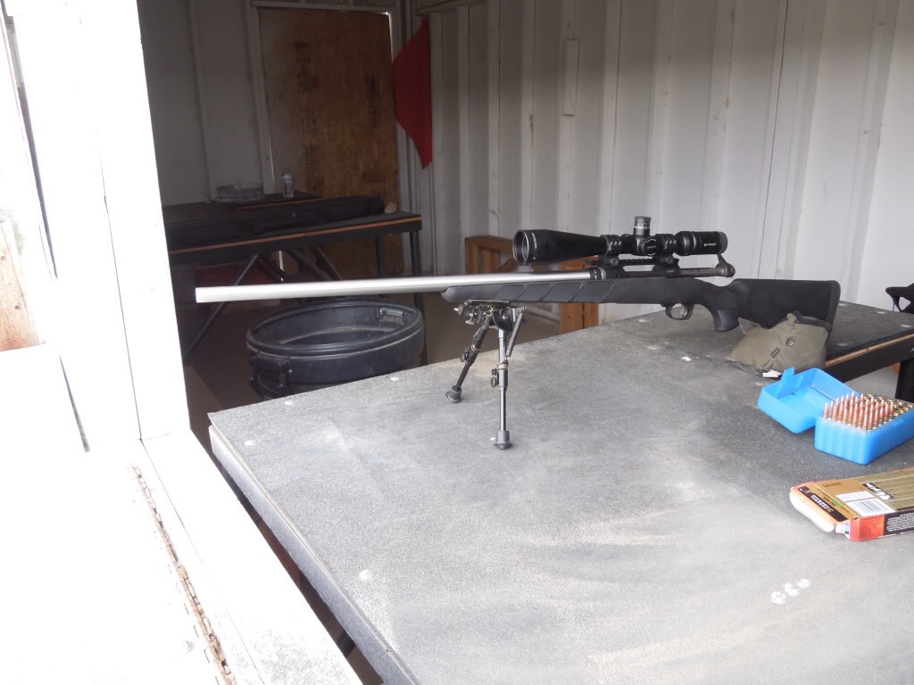

I found the Savage evolution to be a lot of fun and very addictive.
I secured a standard used model 11 in 22-250 and then ordered a few bits and bobs.
Was a very accurate wee rifle as stock but really good after a new stock, bedding and a few other bits and bobs.

I'm in complete agreement with MarinePMI. When I went for my Custom, my Factory .260 Savage 10FP (in 2001) became one of the four Snipers' Hide Ghost Dancer Rifles.
It was upgraded with a McMillan A3 Tactical stock which had a steel reinforced forend, and shortly after, factory Pillar Bedding. A Sharpshooter Supply Trigger and Ken Farrel 20MOA scope base completed the upgrades, which were largely supplied free or at cost by these noted suppliers as sponsorship for the Project, and the rifles came through LL from Savage at some discount, they being among the last left before the 260 was to be dropped as a chambering.
The name "Ghost Dancer" was no accident; it was chosen as an appeal to the heathen spirits to bring back the 260 to factory production by Savage. That worked in a spectacular manner. All the rifle/chambering really needed was some better visibility, and we amply provided that here, when Team Snipers' Hide went to the first Spirit of American Match and fired F Class (F Open) for the first time as an NRA sanctioned competition alongside the Palma shooters (which is another story in and of itself; we made history, of a sort...).
About a year later, I was able to acquire a pair of Savage Drop-in (probably among the first such) Barrels from Lothar Walther, #5171 Savage Varmint Contour, LW-50 Stainless, 28" Long, 1:8" twist, .260 Remington SAAMI Chambering (Every single one of my rifles are either SAAMI, Wylde, or 5.56x45 (and 6.5 Grendel proprietary) chambered). One was given to a friend, and the other went onto my Ghost Dancer. The rifle performed as well as its shooter could manage in a couple of (three?) seasons of 1000yd F Open at Bodines, PA, and as many have acknowledged here, the rifle is not the limiting factor with these guns.
Did mine win? No, but that was me, and not the rifle. I have used mine very sparingly, and it still performs as when acquired and outstandingly to this day.

My Savage 11 project went like this:
I bought an 11 223 to use for training, and possibly for F T/R MR-600 competition.
I added the Choate Savage 4.4" spacing Tactical Stock, adding three (3 - I am quite tall, and am most comfortable with a 16.5" LOP - Choate Stock Spacers). Also added, the Hawkeye Adjustable Tactical Cheek rest.
I have no interest in Chassis systems. The Choate stock provides a very solid aluminum bedding fixture at a very reasonable cost. I like the appearance and features available in most of the chassis systems, but I'm really doing as well as I would want to with the Choate, and my needs don't really require the many advantages such systems provide.
I also added the EGW Steel 20MOA extended base and a Clone (Uhuhu) BR height folding Bipod.
Scope is a Mueller 8-32x44 Side Parallax/Focus Target Dot scope (MilDot is also available), mounted in Vortex 30mm six screw aluminum rings, medium height (or maybe low). Currently up and riding is a Bushnell AR 223 Drop Zone BDC scope.
I then acquired another 11, 308 chambered, and did exactly the same to it, with the exception of the currently mounted Bushnell AR 308 Drop Zone BDC Scope.
Each rifle, including the Mueller optics, cost me around $900-950.
Between these two and my Ghost Dancer, my Savage rifle collection has rifles suited to all aspects of F Class; MR 600 F T/R, LR 1000 F T/R, and 1000 F Open.
The scopes provide five aiming points, one each for 100-500yd (and one for 600yd with a bit of a finagle) that align perfectly with the trajectories of my 5.56 Hornady 75gr HPBT Match handload, and the IMI 308 168gr Semi-Auto Match load. It's easily possible to get hits on steel in under one minute at 100yd, 200yd, and 300yd with either rifle.
The 223 was actually fired (as a Grand Senior) in National Comp; the 2017 Berger SW LR Nationals MR 600 stage, at Ben Avery Range AZ. But I was forced to retire due to health issues (I had my second heart attack, at age 71, two months later). The rifle did fine; I wish I had performed even half as well.
I can no longer do position shooting, but I don't mind; it's been a long life's worth of fun competing.
