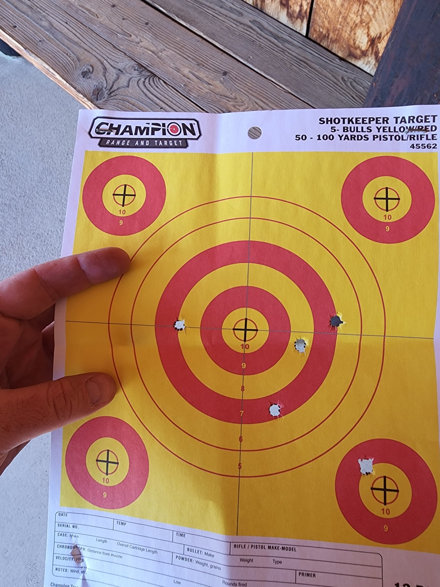

What are some goals for long range shooting. For example 100 yards 1/2moa, 500 yards 8 inch gong 2000 yard a fridge lol? I ask cause I sighted my new rifle up to 400 yards and granted it was breezy but groups were pretty bad, well I thought bad
Just analyzing your target I’d say,
5 rounds probably factory ammo or untuned loads
4 top rounds would be a decent group at 400 starting out in longer range. Decent vertical spread. Wind being a factor
Top 3 would be awesome vertical group with a crosswind. Showing vertical consistency in the ammo. Only 3 shots however
I would expect your target out of a factory savage, Tikka, Ruger, Howa etc shooting factory ammo at 400 yards for 5 round groups.
