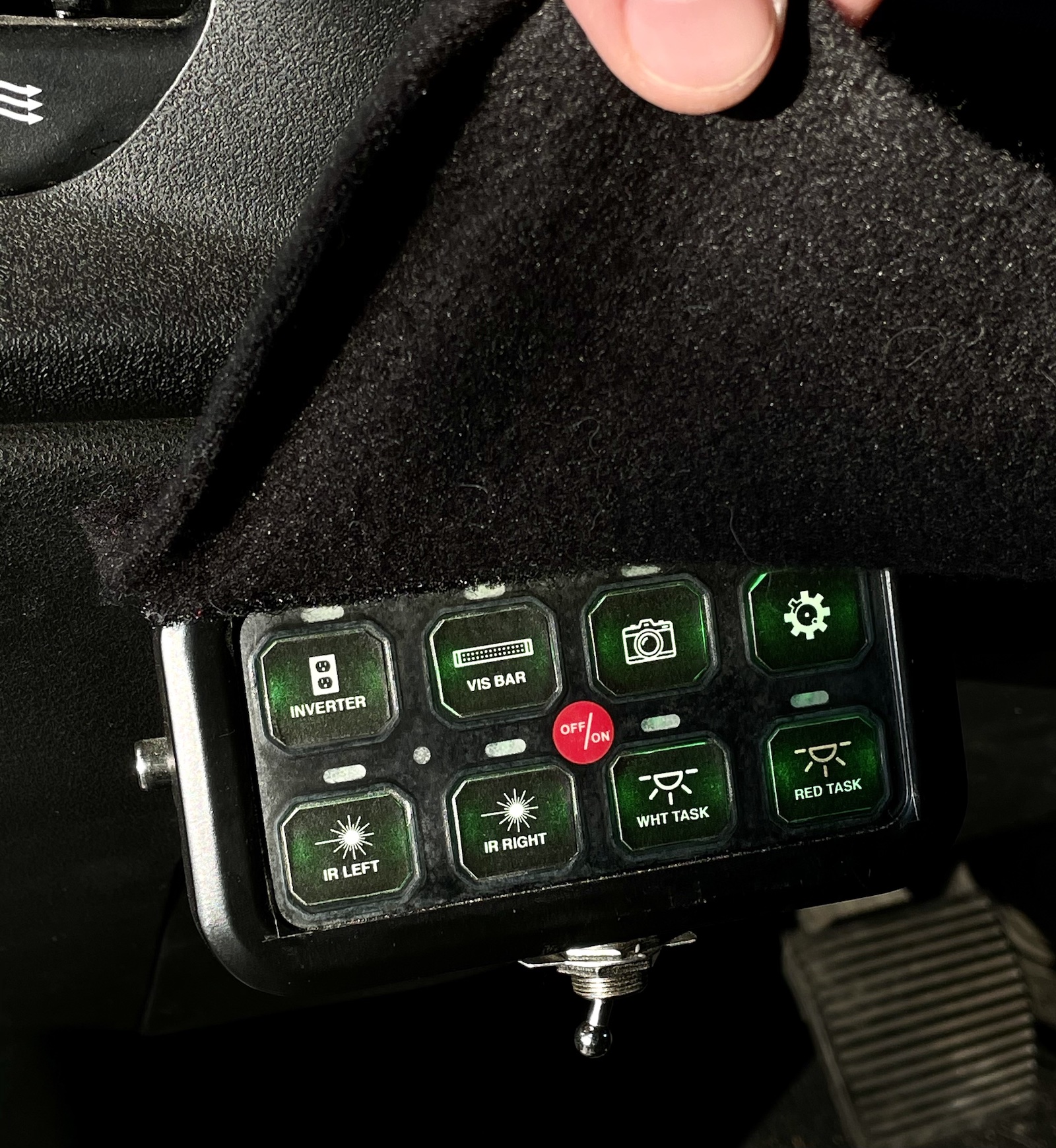

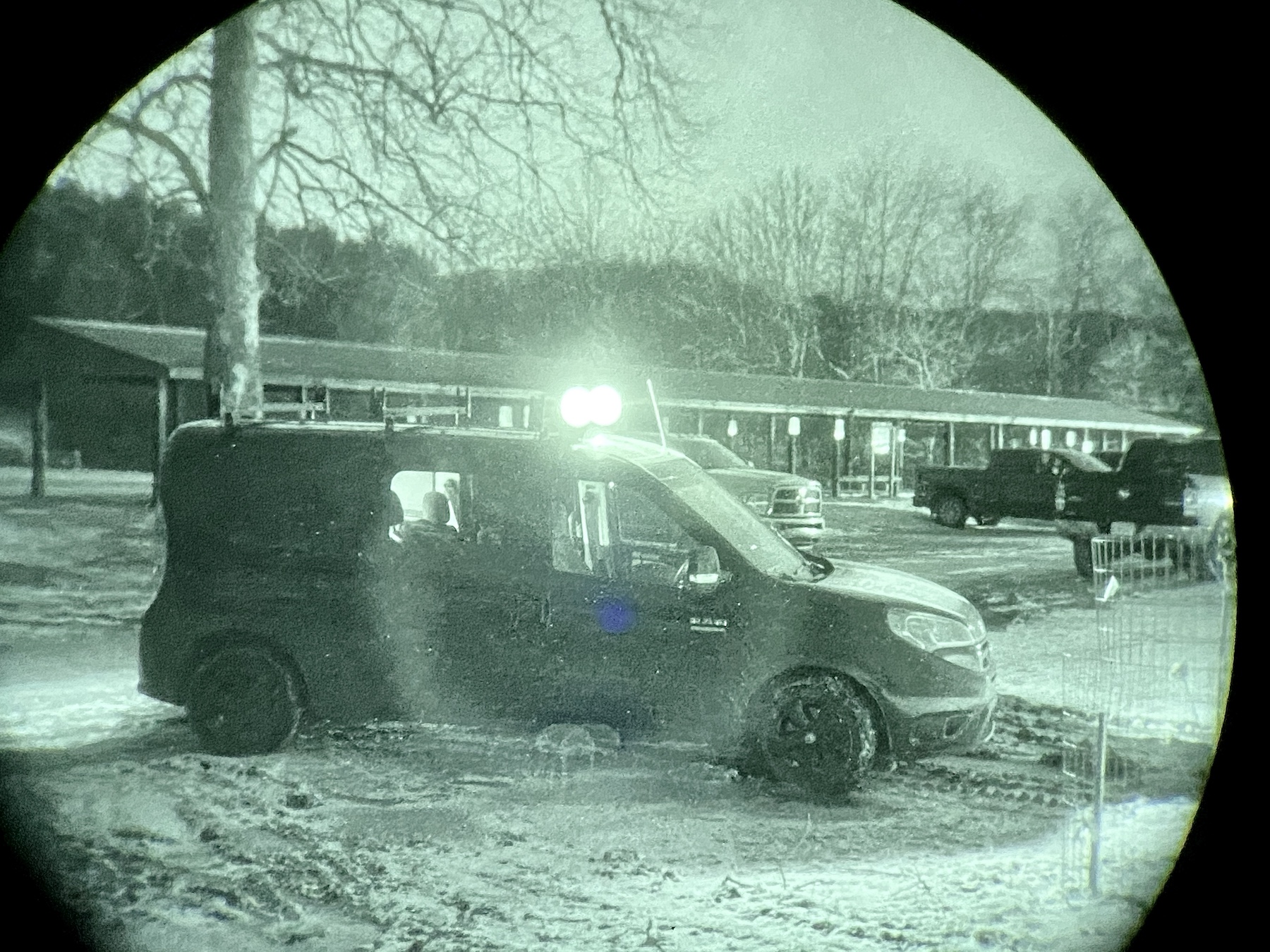

    I use one of these in my photo-van for controlling stuff, including a pair of Larson Electronics IR pods up top (2x of their 3watt 850nm spot beams that I found a killer deal on ebay) - https://www.amazon.com/gp/product/B07MVWYMM1/
    I also added a cutoff switch under it to kill juice to the system. I wired it all straight off the battery so it doesn't matter whether the car is on or off to run the lighting. Didn't want it to always sap power though, so I just turn it on when I want. Then there's a piece of black fleece I velcroed to the top - got a large one that spreads over the whole dash too.

    I would like to find a deadman switch to kill all internal dashboard lights when the headlights are off. Otherwise we will just rig up a towel or blackout curtain cut to the shape of the dash to velcro on.
