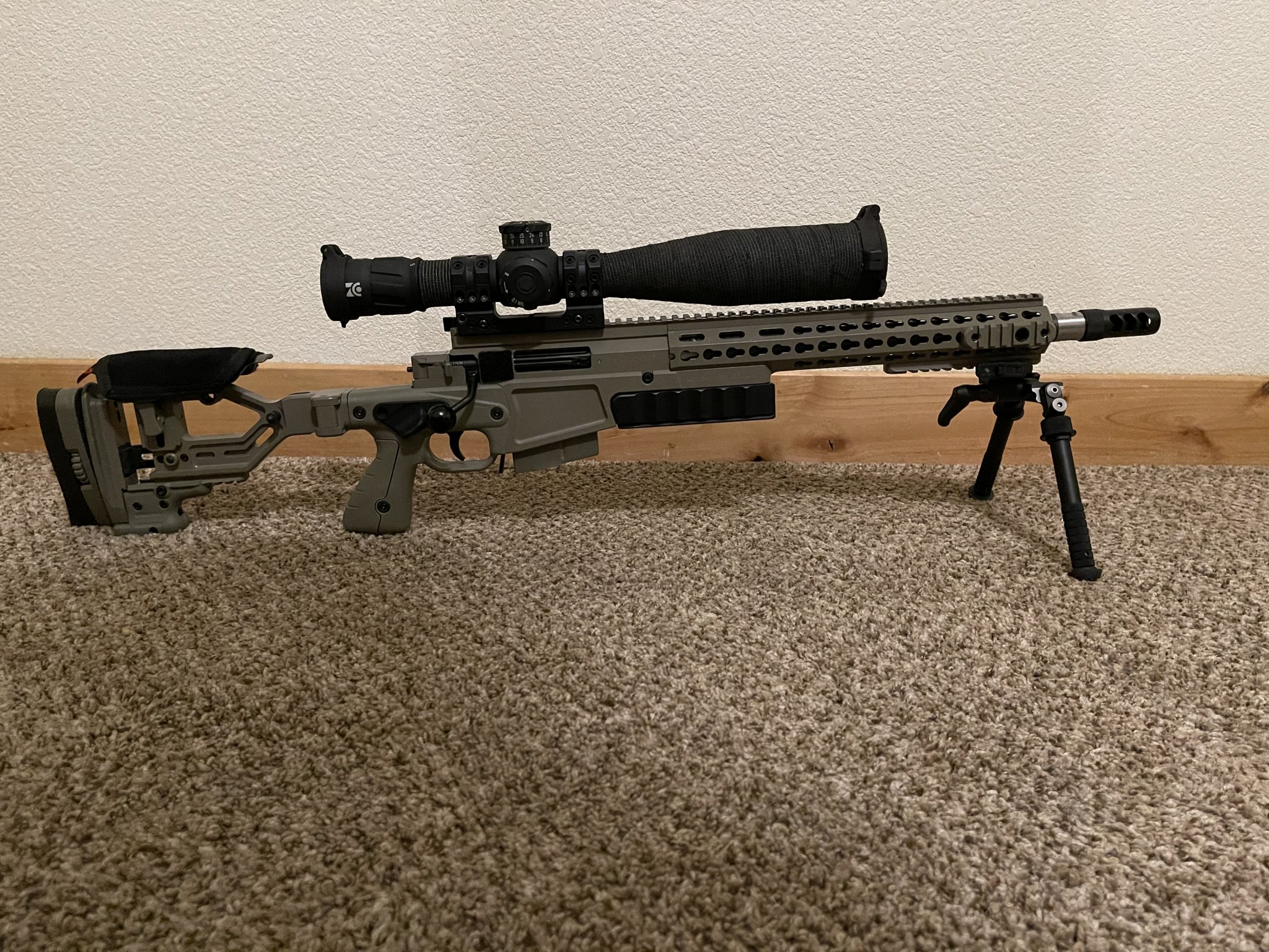

As pictured with a 16.5” Proof Carbon Fiber sendero 308 barrel, I want to say mine came in around 14.5-15.5lbs. If I was going with another carbon barrel though it would be the M24 Bartlein carbon wrapped barrel.

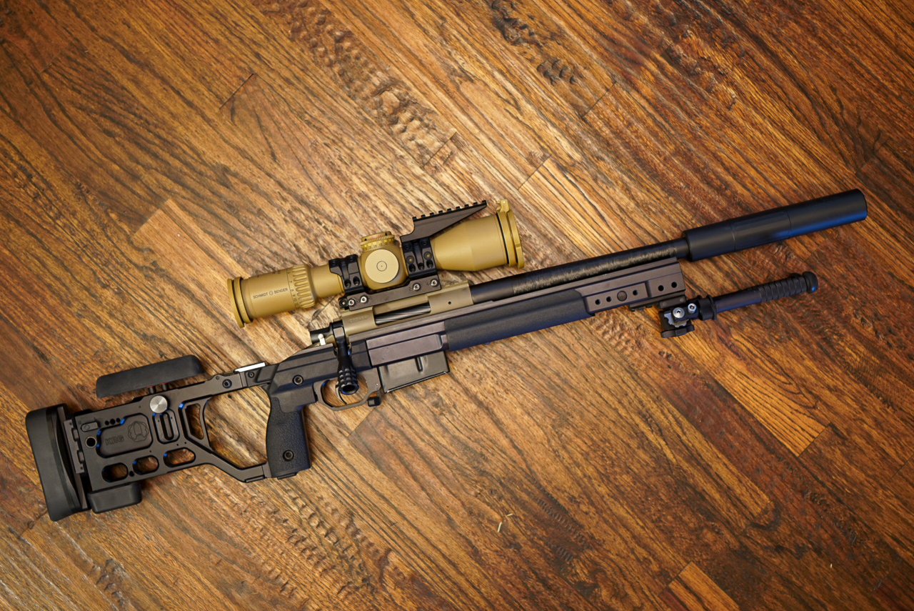

Probably adds 1/4” to your dick but about zero handling/performance improvement. Weight comparable and your rig already weighs 13 lbs without a barrel.
My thought is that you still want to keep some weight out front just for balance and stability. You’re working with a Chassis that s you even described as a pig. Getting rid of weight is only part of equation. Personally I’d rather have something with some extra weight that balances well than light and off balance.
please tell me that's a 308?
Oh yes, very much so.
I had a Bartlein 11" barrel on her originally. Switch over to this carbon barrel for no other reason but to try it out.
Original barrel got 2700+ FPS with 135g SMKs, but I prefer to shoot them around 2650fps. Subs in the original barrel literally stacked themselves, which I did not expect. Hoping this barrel does too.
My 100 yard zero with supers gives me a 3.5mil low zero when I switch to subs. Super easy to remember.

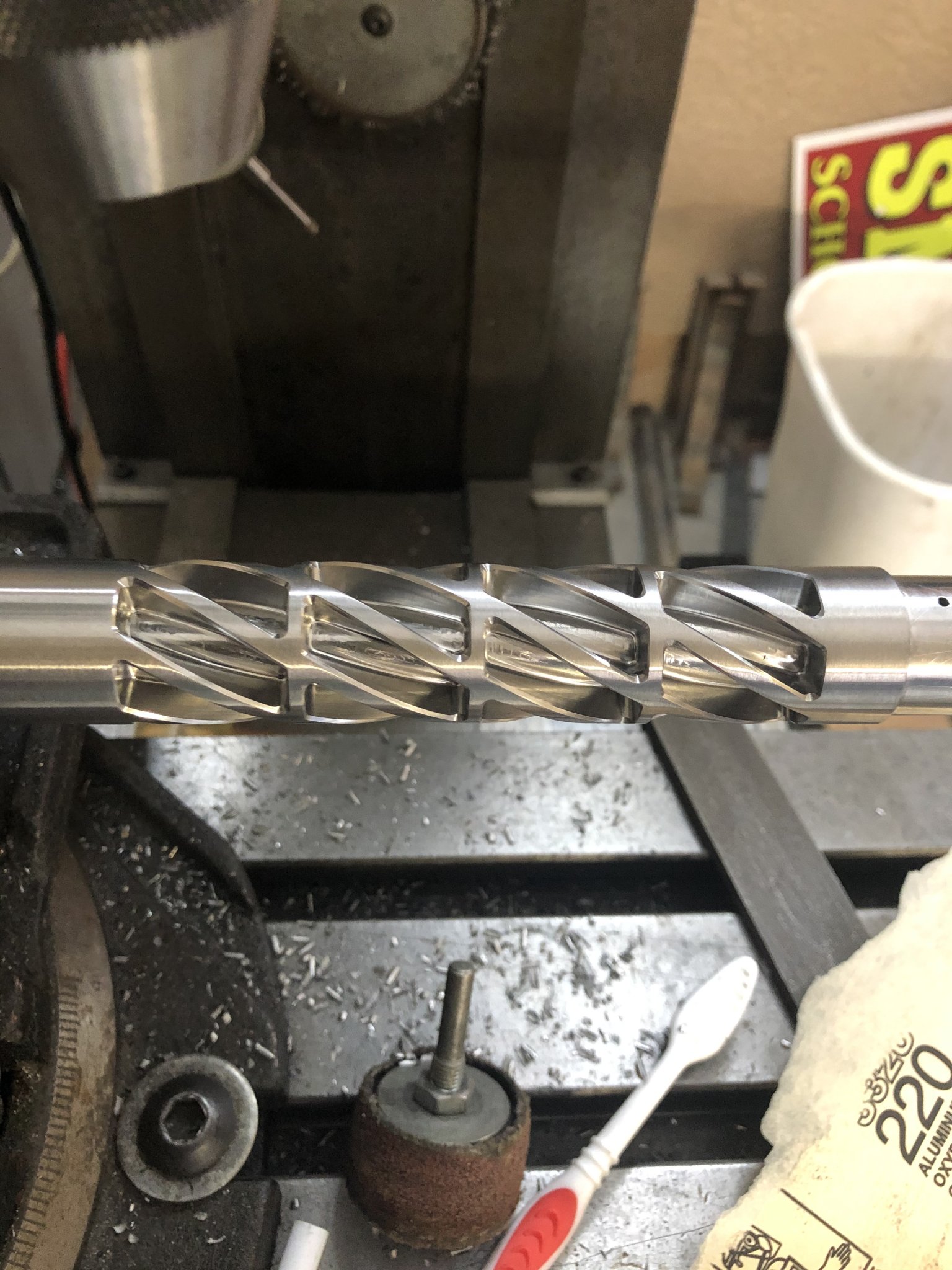

LRI did some of the x pattern fluting on this AR barrel where they could to drop some of the weight for me. It had already been profiled here for my OTB reflex style can.

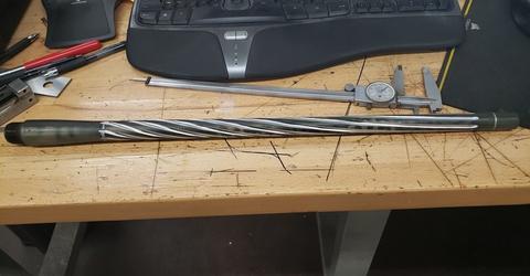

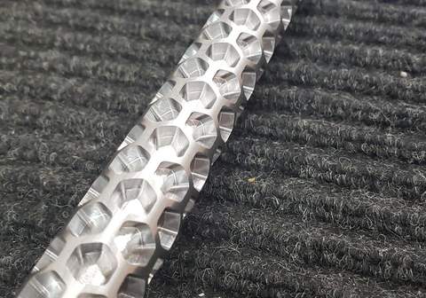

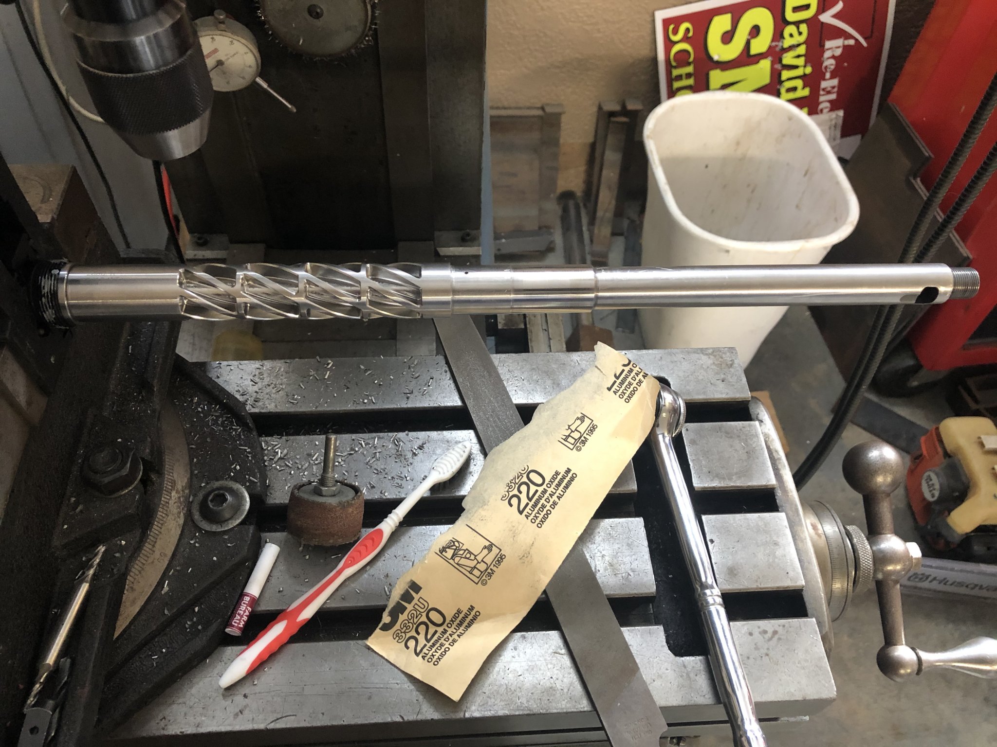

Thanks for the kind words gents. I can tell you all this:
If your wanting a "large" (lets say Rem Varmint or bigger) contour barrel and don't want the weight associated with hanging a tractor axle off the end of your receiver, we can help.
Our "Pattern X" can put stuff on a diet. The case study we did involved a 16" Proof Research Sendero contour carbon wrapped barrel. We used this as our baseline. The first test piece in PX we ever ran was a 19" long Sendero made by K/P. One thing to note is that I order these blanks with an extra inch of cylinder on them because the same blank gets turned into our RPR barrels. It just simplifies the inventory for us.
(Make it a point to keep track of the numbers with what I'm about to say below.)
We fluted the K/P and it weighed in 3 oz heavier than the Proof. Now, keep in mind that we were 3 inches longer in overall length and the cylinder portion of the K/P barrel is a good inch or more longer than the PR piece.
In closing the point here is we can flute a barrel and match/beat the weight of the carbon piece.
The usual suspect line of questions that follows is the "H" word and heating/cooling characteristics. Harmonic's definition to me probably means something radically different from most others. I have no conclusive data to support anything other than the scale that I used to weigh stuff on. Heat, cold, etc... is outside of what I can comment on.
Hope this helps.
