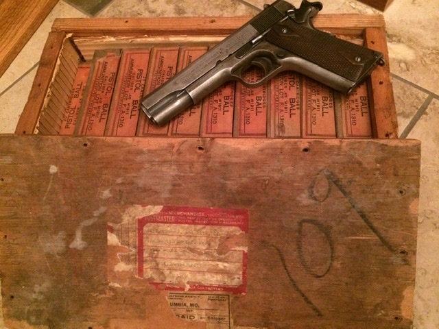

    This 1917 mfg 1911 still has some of the d loop mags but they are not inserted in this picture. They do cause pain if inserted with a slap. Ammo is 1917 mfg as well.
