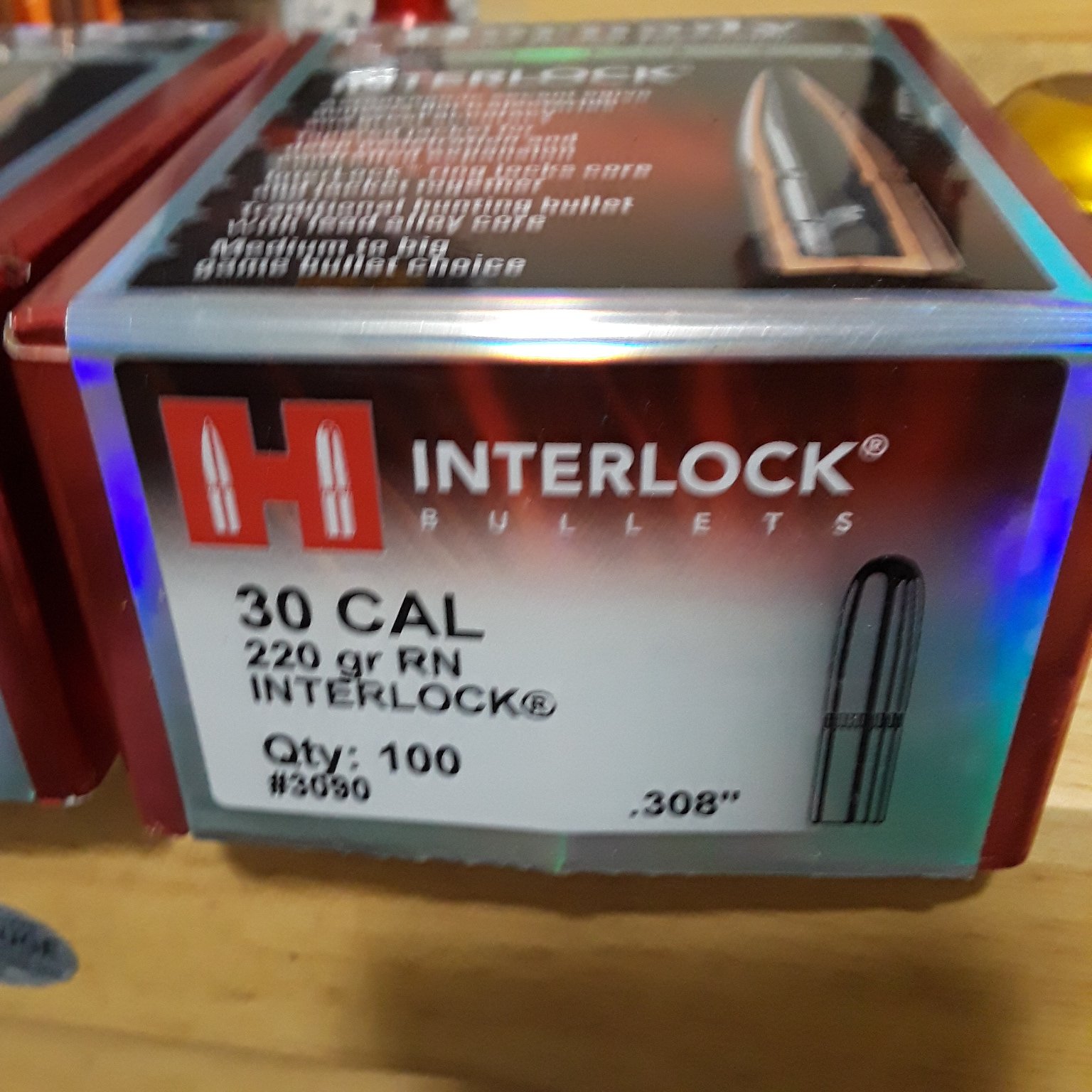

My favorite 300 blk load is round nose flat base 220g hornadys ran over 12.1 grains of cfeblk. That runs 1015fps on cold weather and does not go sonic on 95 degree days.
It has been more accurate than anything I have tried.
My 1/7 twist sbr and 16inch bolt gun like them.
That will not stabilize in a 1/10 twist 308 and not suitable for runnng fast as I understand.

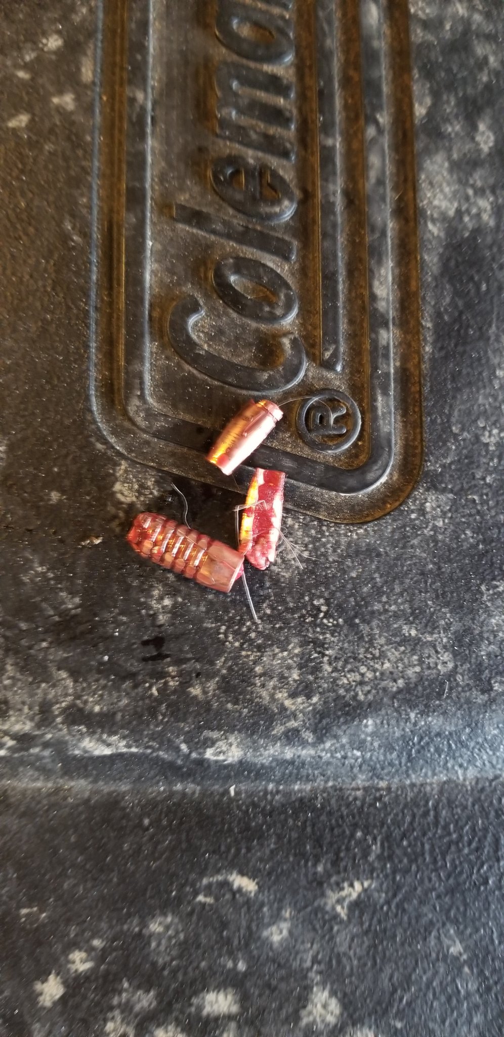

Well 3 years later I'm back trying to get the sub-x 190 flying. Lol
I went for about 2 years and could not get any sub-x 190's. They disappeared from retailers and only resellers had them at prices I was not going to support thier cocaine and whore habit.
Prices back to reality and vendors stocked. And hopefully the resellers I see tring to unload thier stash choke on them. That is the ones not dead of drugs and disease allready.
The family finds ourselves this fall in need of suppressed expanding rounds on a new location.
Hodgdon shows 190 sub-x over 12.3g of cfeblk at 2.050 coal.
This sounds right to me since my old load was 12.1 with 220g rnfb at 2.100 coal. I want it setting down lightly on top of the powder I think as a friend said my old load worked better slightly shorter.
