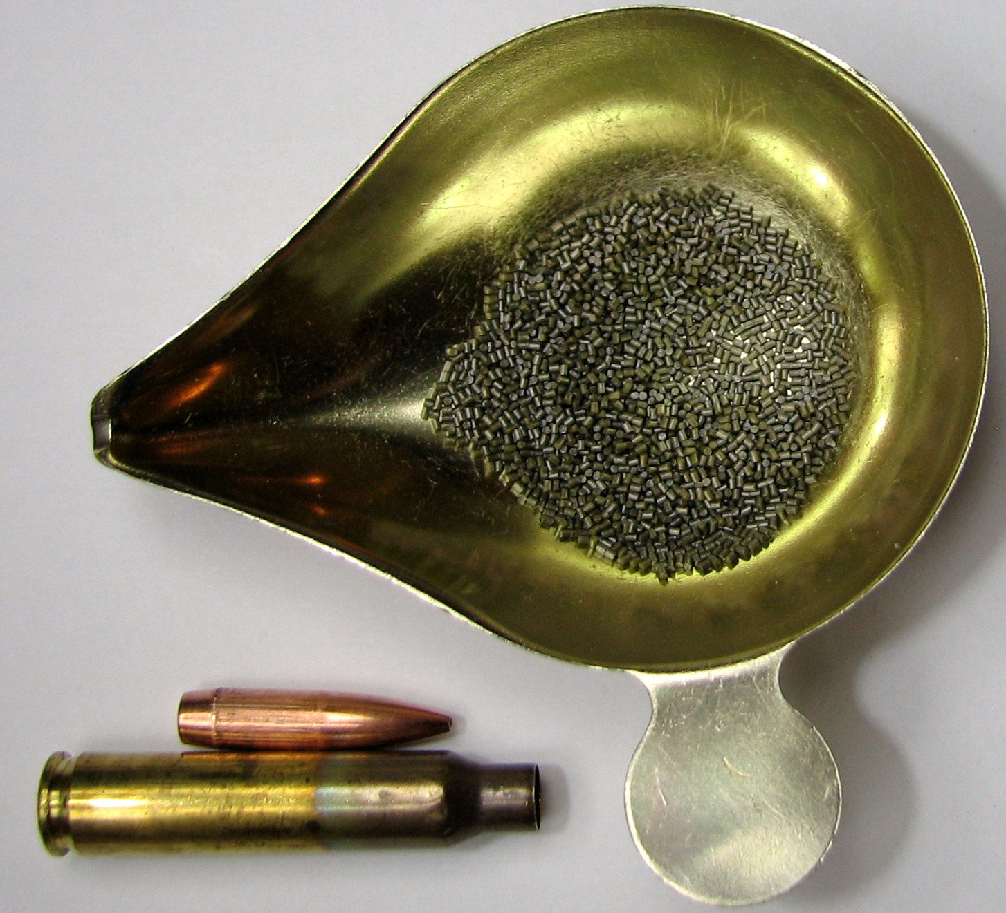

IMR 8208 XBR produces good MV with low ES/SD along with a very high level of thermal stability. It is the propellant I use for my best LR 5.56MM accuracy loads. SWA produced an outstanding 5.56MM pressure 77GR. SMK OTM load over 23.8GR. IMR 8208 XBR in new LC brass. A 5.56MM 77GR. SMK over 23.8GR of IMR 8208 XBR handload is approx 80 FPS slower than the MAX published 5.56MM NATO TAC load. But it is a couple 0.1s more acccurate. Interestingly, the MV of the SWA load was within just a few FPS of the outstanding 5.56MM BHA AMU 77GR. SMK load (approx. 2744 FPS from 18" SPR with M4 can attached at 80F).

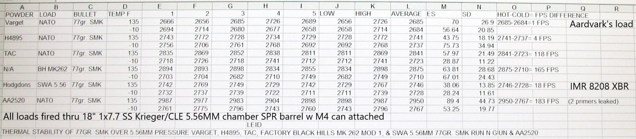

For thermal stability, I use IMR 8208 XBR in 5.56MM. MAX 5.56MM NATO IMR 8208 XBR rounds cooled to -10F were only 18 FPS slower than rounds heated to +135F. MAX 5.56MM NATO TAC rounds varied by 118 FPS from -10F -+135F.

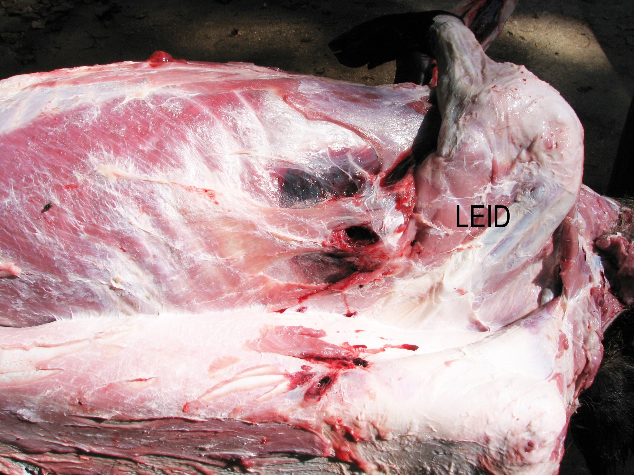

OP,
Just want to put the bug in your ear about the 77GR. TMK bullet's terminal performance at 5.56MM velocity. It kills hogs/whitetail VERY well even when fired from a little 10" M4 (exit wound on 175lb. razorback below). Since it is a longer bullet, I have to reduce the propellant charge a bit under what I normally use under a 77GR. SMK bullet to keep pressure under control. The 77GR. SMK is a yaw dependent/non-expanding/fragmenting bullet which requires approx. 2200 FPS impact velocity to fragment. The 77GR. TMK is a non yaw-dependent/expanding/fragmenting bullet that requires approx. 1900 FPS impact velocity to over-expand/fragment. Bottom line for me: I use SMKs to shoot paper/steel targets but I use TMKs to shoot flesh & bone targets. And I have also seen some very nice 5.56MM terminal performance with 5.56MM 70GR. TSX, 5.56MM 75GR. Gold Dot, and 5.56MM 62GR. Lehigh CCCu loads. HTH

That's great info, thank you.
I had always thought the terminal performance of 77smk mushroomed and not yawed.
There are some gel videos on youtube and one by AR15.com showing it expands fairly well even at low velocities. They tested out of an SBR IIRC.

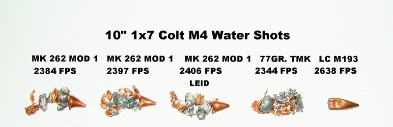

The 77GR. SMK OTM based BHA MK 262 MOD 0/1 cartridge was designed to be a Hague compliant accurized 5.56MM round. In other words, the bullet can not expand so as to cause undue trauma on the battlefield. The U.S. did not sign the Hague Treaty but we abide by it under organized warfare conditions. The 77GR. SMK OTM bullets must penetrate then yaw at sufficient impact velocity to cause the bullet to rupture into small sub-projectiles (fragmentation). Below is a direct comparison of the 77GR. SMK with the 77GR. TMK both fired at 5.56MM velocity from the same 10" M4 with M4 can. I fired an M193 round just to prove that they do not normally fragment from a 10" class barrel such as was used in early Vietnam in the CAR-15. Note the lack of expansion in the small open tip of all (3) SMK OTM bullets. The TMK does not need to penetrate then yaw to over-expand then fragment. It starts destroying tissue virtually on contact with flesh & bone which is referred to as having little to no neck on the wound. HTH
The 77GR. SMK OTM based BHA MK 262 MOD 0/1 cartridge was designed to be a Hague compliant accurized 5.56MM round. In other words, the bullet can not expand so as to cause undue trauma on the battlefield. The U.S. did not sign the Hague Treaty but we abide by it under organized warfare conditions. The 77GR. SMK OTM bullets must penetrate then yaw at sufficient impact velocity to cause the bullet to rupture into small sub-projectiles (fragmentation). Below is a direct comparison of the 77GR. SMK with the 77GR. TMK both fired at 5.56MM velocity from the same 10" M4 with M4 can. I fired an M193 round just to prove that they do not normally fragment from a 10" class barrel such as was used in early Vietnam in the CAR-15. Note the lack of expansion in the small open tip of all (3) SMK OTM bullets. The TMK does not need to penetrate then yaw to over-expand then fragment. It starts destroying tissue virtually on contact with flesh & bone which is referred to at having little to no neck on the wound. HTH
