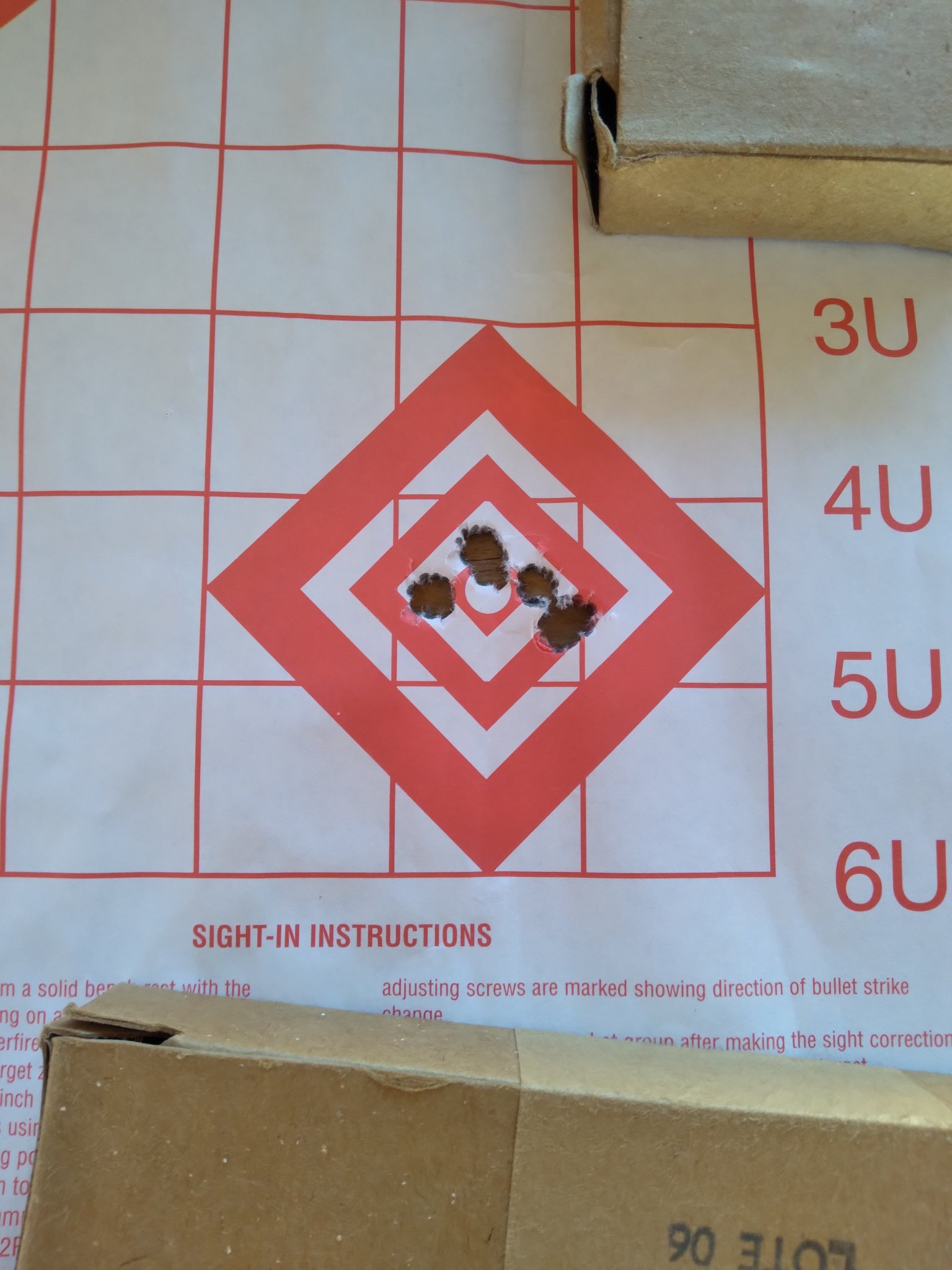

    The good:
    Shot my Mossberg MPS LR in 6.5 Creedmoor for group the first time today. Did quite well for my first time, target at the bottom. Hornady 140 grain at 100 yds with a 8-10 mph gusting intermittent full cross wind, 6 shots. Then I ran out of the Hornady and switched to S&B and it opened up to about 1.5-2 moa on the next target. Love that Hornady
    The not so good:
    Also sighted in a Remington 700 24 inch barrel in 223. Using some Lake City 55 grain lead tipped 5.56. Shot pretty well got it to about 1.5-2 moa. Then I switched to some ' IMG Fabrica di Munitiones del Ejercito' group opened up to about 3 inches. So I think, lets quit fooling around and get down to the good stuff, some 62 grain green tip. Fuck me sideways, I couldnt get it on the paper. Tried a lot of elevation up and down and couldnt find the paper. Got so disgusted I put the rifle away before I wrapped it around a pipe and moved to the pistol range.
    What was likely the problem? My AR's shoot the 62 grain like champs, they like it best and feed it best. Bolt gun not worth a damn. When money/prices allow I want to get some 77 grain match. Will that likely make a difference?

    How old is that 700? The 24" guns had 1-12 twist up until mid 90's. I had one that loved 52 gr. Matchkings on top of 26.2 gr. of AA2230. Currently have a 1-9 rifle that doesn't shoot anything better than moa.
    A couple of years old. Varmint barrel. Ill have to check on the twist. If its 1-12 what would you recommend? 1-9?
    A quick Google search says ya'll are right its likely a 1-12. I reckon I need to get some match grade 55 grain (or lower) for this rifle and save the green tips for the AR. Thanks for the insight.
    From Chuck Hawkes:
    Another peculiar rifling twist story involves the .223 Remington, called the 5.56mm NATO by the military. This cartridge was designed specifically for use with 55 grain spitzer bullets and its twist rate was originally specified as 1:14". This was later tightened to 1:12" for long range shooting, which works very well with bullets weighing 40-60 grains, the usual .22 centerfire bullet weight range.
    Years later, the military decided they needed more penetration, so they increased the normal service cartridge bullet weight to 62 grains and some military cartridges use bullets at heavy as 77 grains. Meanwhile, some hunters could not resist trying their .223 rifles on small deer and they also used heavier bullets, up to about 70 grains.
    The standard 1:12" twist could not properly stabilize these heavy bullets, so the military went to a 1:7" twist, designed to stabilize bullets weighing 62-77 grains. Most manufacturers of AR-15 type civilian rifles followed suit.
    Unfortunately, 1:7" is too fast for frangible varmint bullets, so now we have two "standard" twist rates for .223 rifles: 1:12" for varmint rifles and 1:7" for military type rifles. The latter are often, but not always, stamped "5.56mm."
    From Chuck Hawkes:

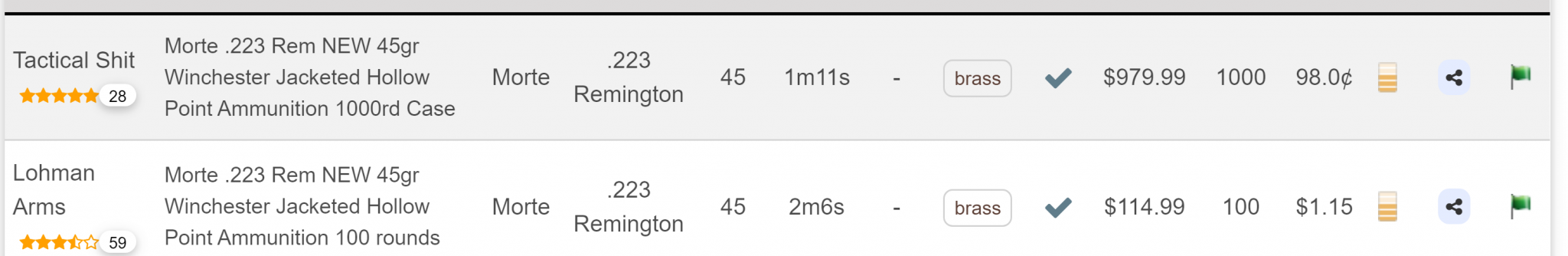

    Green tip is NOT known for accuracy and very few would consider it "the good stuff" even in a properly twisted barrel. If you don't reload, find yourself some white box winchester 45 grain varmint ammo. In normal times it is well priced and very accurate.
    I reckon by 'good stuff' I meant that it has the penetrator and shoots really well in 1-7 twist AR.
    Its definitely not 'normal times' though..crap, a buck around. Ill buy a few to try but have to wait before stocking up.

    Doubt if you'll find any but Black Hills 52 gr. blue box does well in the 12 twist barrels. Don't think anything shoots well out of the 1-9, definitely wouldn't go below 55 gr. Mil. came up with that to handle 55 gr. tracers.
    Like you discovered, it is probably a 1:12 twist. Not the best for long range but I've slayed a lot of prairie poodles with the 45 grain Vmax out of mine. It should stabilize the 53 Vmax as well which has a decent BC for what it is, and rivals a 22-250 if you push it hard.
    Green tip and Good stuff are not typically used in the same sentence. Unless 2 moa is good stuff to you (and that's okay if it is :)).
    I guess you could use it in the same sentence, now that I think about it, "I bought green tip, because I couldn't find any good stuff."

    Thanks to all who commented, Im lookning for some light grain 223. Unfortunately, at the moment, it seems to be made out of unaffordabletanium.
