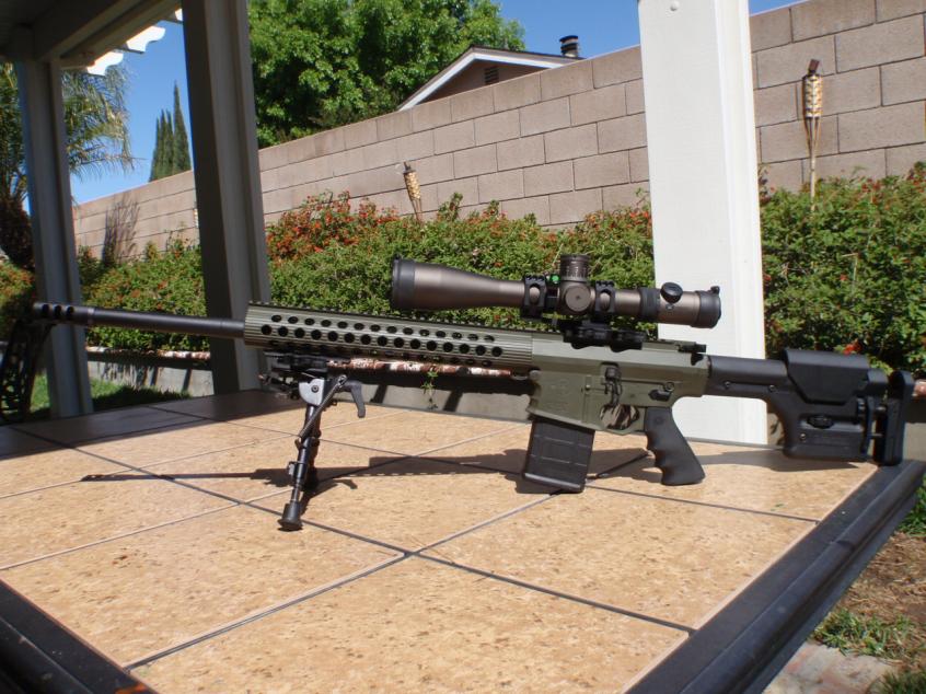

Im not sure if your saying that your opposed to a vertically split ring mount, but my American Defense Manufacturing 1 piece ring mount system is fantastic in QD. Im very happy.
