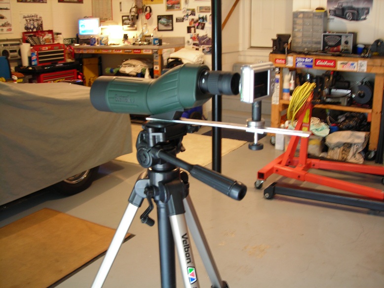

All I did was took the roll bar go pro mount with a few extra attachments that are normally in the kit to get the distance and level right. I have the older hero2 with the wife pac so I can watch it on my cell or tablet. I've only tried it at the house but it seems to work well. I'm assuming there will be a short delay for the wifi streaming. This is on a bushnell flp so very similar to the mark 4..

It's mounted on the portion of the bushnell behind (closer to your eye) the focus ring that doesn't move. Setting should be normal not wide/fisheye or whatever that setting is for wide screen that semi distorts the image.

This is how I mounted mine. I will say its a pain in the ass to get the go pro to lineup to get the sight picture since I'm semi limited in the direction I need the gopro to go in since the lense is offset. If I had a flexible mount of something it would make it a little easier. I'll try to record some at the range next time I'm out but I can't get the who camera screen to full up with the picture due to the widescreen of the camera. Another camera may do better to be honest..

Here you can see in it this vid. I used steel, aluminum will bend. Very simple, just need to make the rod the correct distance to the eye piece. Then I just spaced it out so the height was correct. Probably could have made something nicer on my lathe but it works. The I have a threaded rod w/ a jam nut to tighten.
