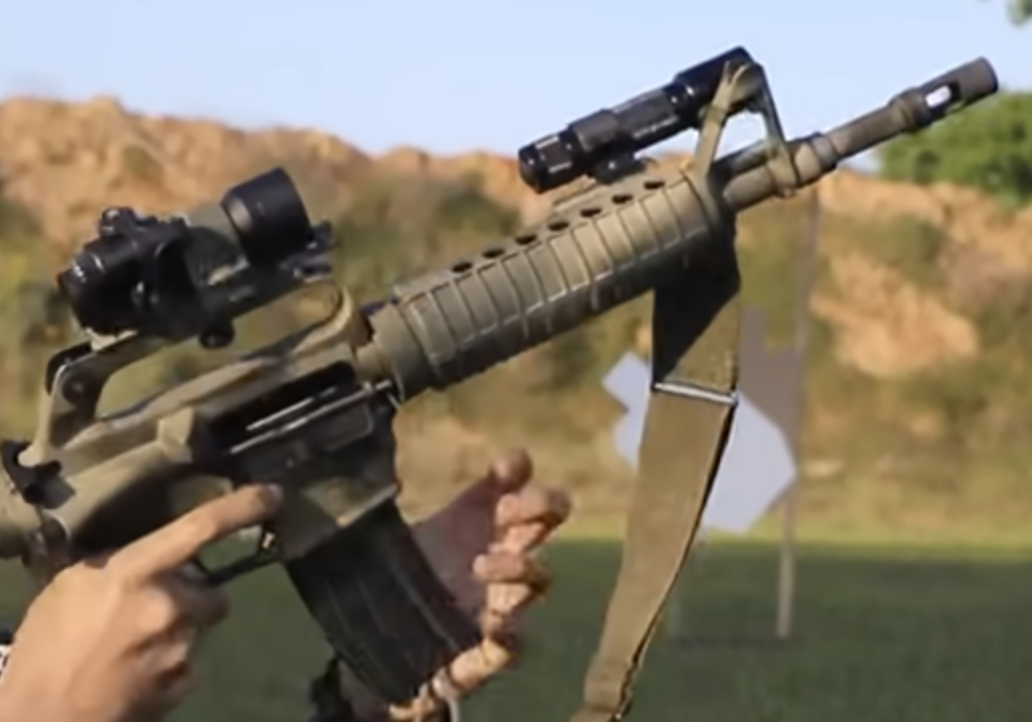

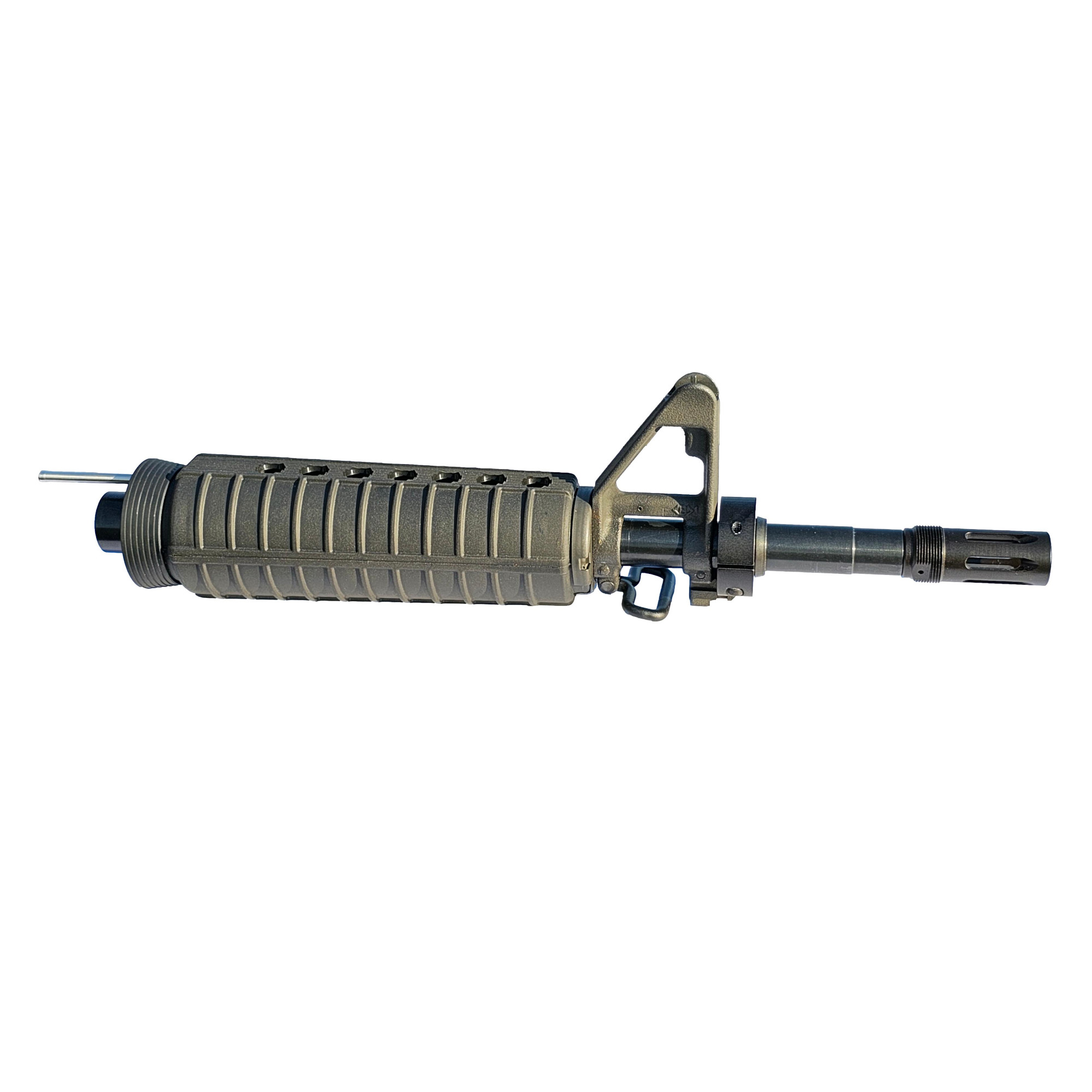

I want it to be setup like the 9-hole Reviews Gordon vs clone correct with the 3 piece collar... and even though I'm using the lightweight OCM5, I'm not sensitive to barrel weight and prefer a more rigid, heavier barrel for anything that gets a suppressor on the end.
I think the collar requires .750, and the Criterion has that at the gas block... but it steps down slightly- is this a NO GO?
TIA for anyone who can help steer me in the right direction!
That barrel won't work. The step down indexes inside the collar. You'd need an SPR profile barrel to be made for the ops collar to work.
Like Trigger Monkey said above, the OTB or Collar from Otter Creek is the best bet.
Ah, OK. Thanks!
I love the Criterion CORE series, but If I bought that one and it didn't work for this Gordon, it would have turned into another weapon!
Have AEM make it,or buy the blank version and have a gunsmith fit it. There is also a 3 piece collar out there that fits regular barrels, I’ve seen them
Man I would really consider the 3 piece collar, the spr or m4 one will leave you with a gap between the back of the can and the fsb and you know it's all about aesthetics. Black ankle sells turnkey barrels but I think they are all gov profile
If you insist on a not retarded barrel profile I believe centurion mid weights have the gov profile after the gas journal that you could use a 3 piece or m4 collar on.
