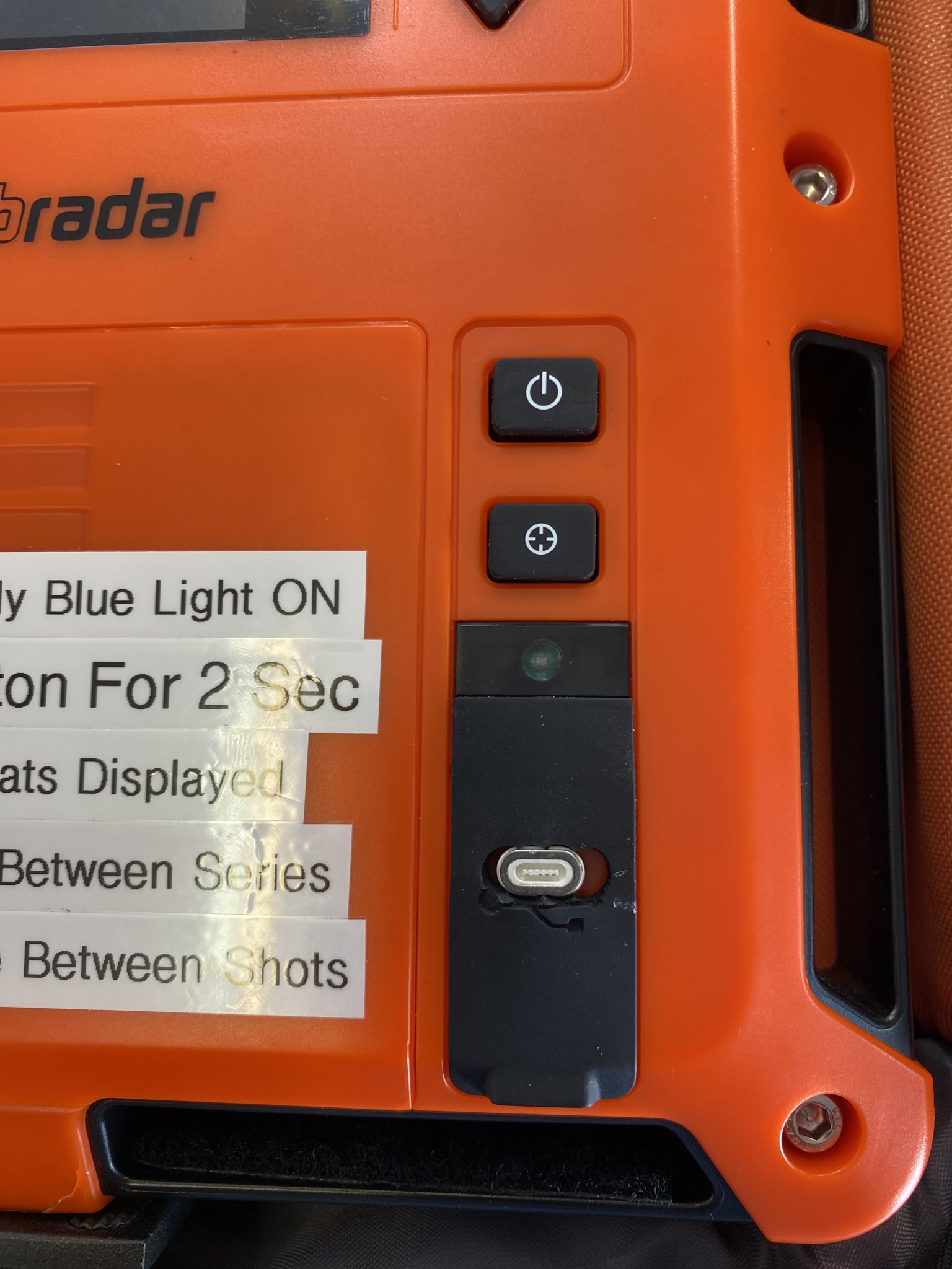

This will save your connector
NetDot Gen10 Magnetic Micro USB to Micro USB Adapter Converter(2 Pack Black) https://a.co/d/3Tk1GFZ
I've had great luck in general with nightcore batteries. They have a bunch of electronic protection built-in and they are rain resistant
Lightweight carbon fiber energy brick

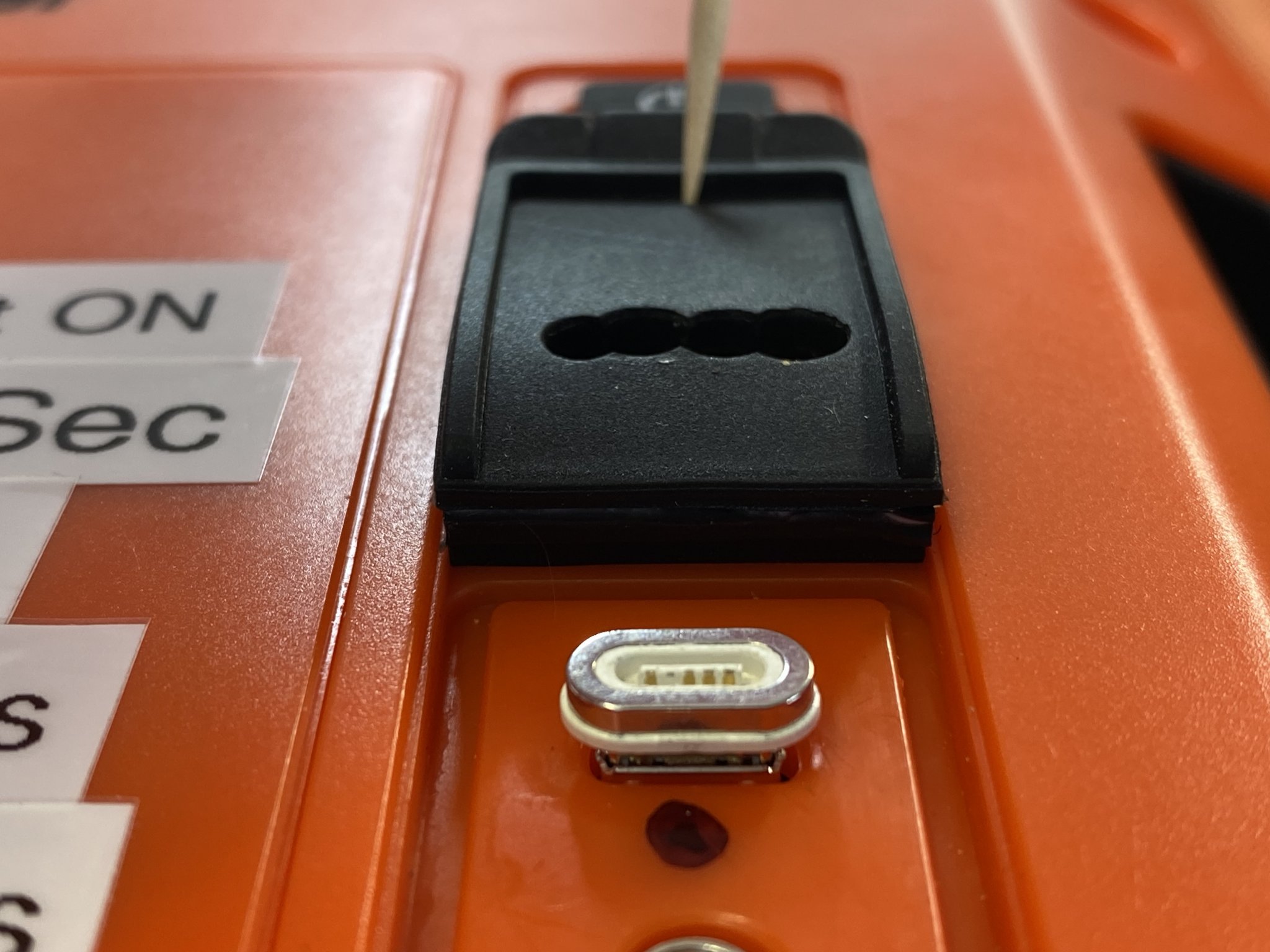

Good call. I bought one and it works like a charm. Only negative is the adapter that goes into the Labadar sticks out enough that the rubber boot doesn't sit flush.
I just provided a relief for the cover to close. More interested in protecting the trigger port than the magnetic connector that are only a few $$ each.
