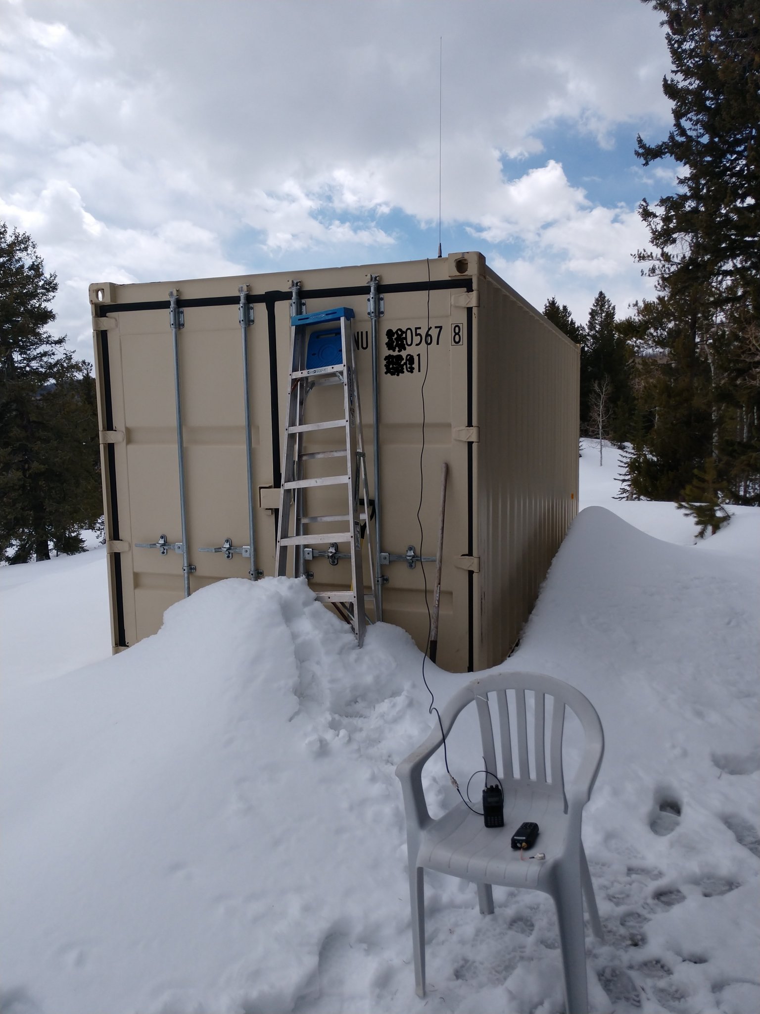

If you don't want a permanently mounted outdoor antenna, a quick and easy antenna set up is get a magnetic mount base, and put a 5/8 wave element on it. Stick it on top of something like a old road sign, etc. for a ground plane. Works great. Then you have the option to move it to a vehicle, or use it outside.
Pictured is some testing using the magnetic mount on a shipping container, using my FT-60. Easily able to hit a repeater ~ 35-miles away, and have a QSO with radio set to medium power.
Note: don't have direct LOS with the repeater as there's a ridgeline between my location and the repeater. With any HT at full power (5W) with factory antenna, keying the repeater from this location is hit or miss.
