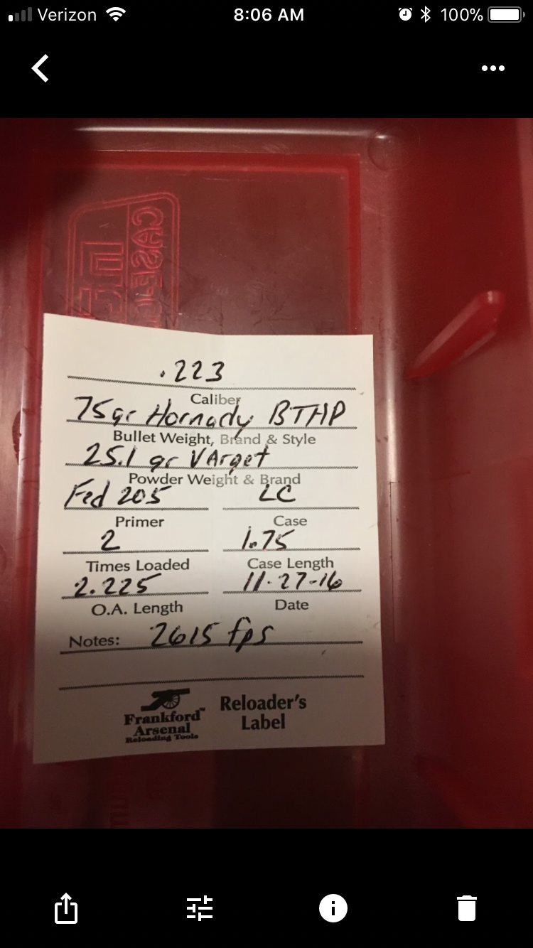

All LC brass, work your way up. I do use 75 amax and Varget on bolt rifle 223 loads so that’s a good combo though. I’d check your mag length and start there, might not get much more than 2.25” coal

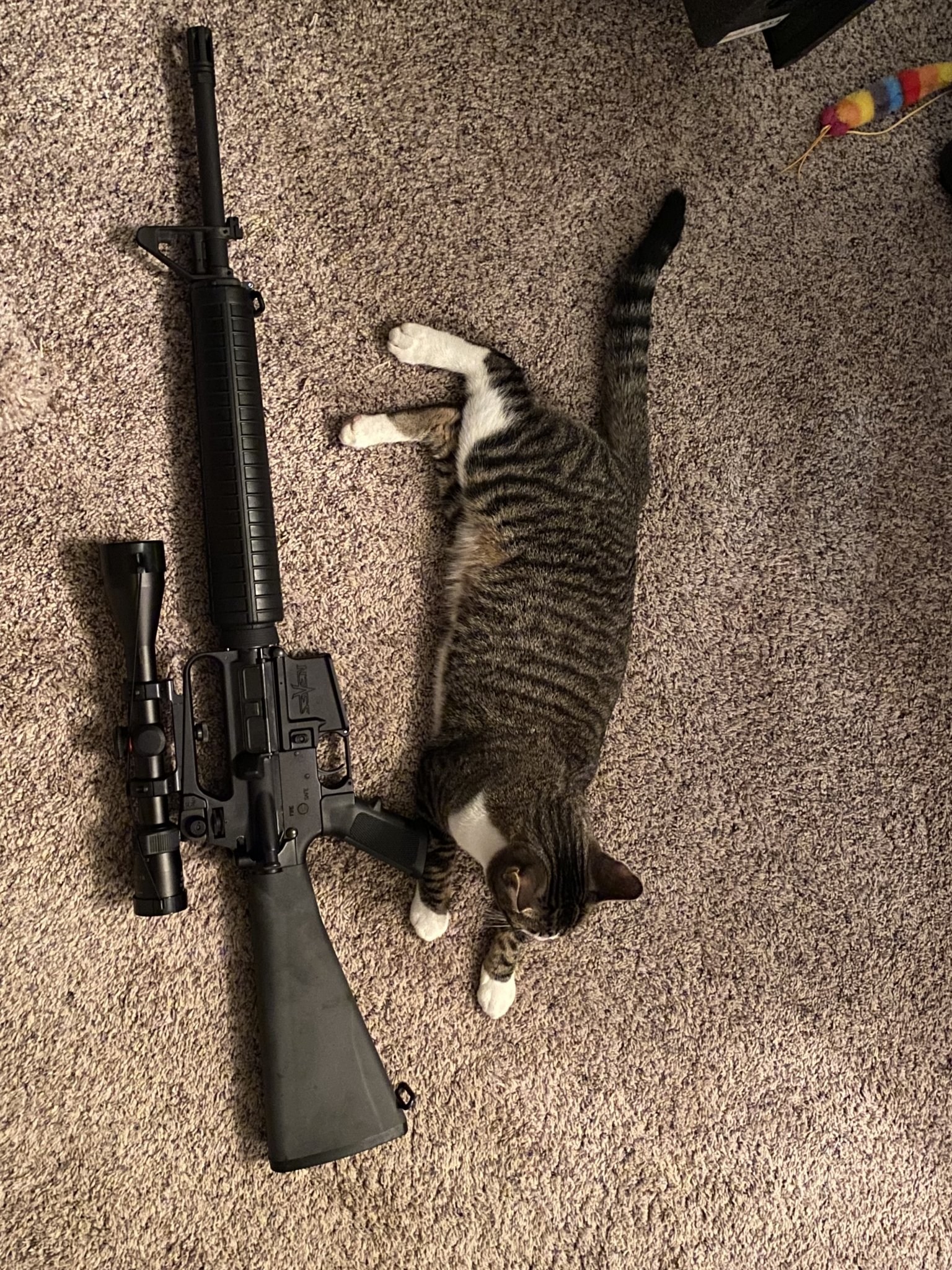

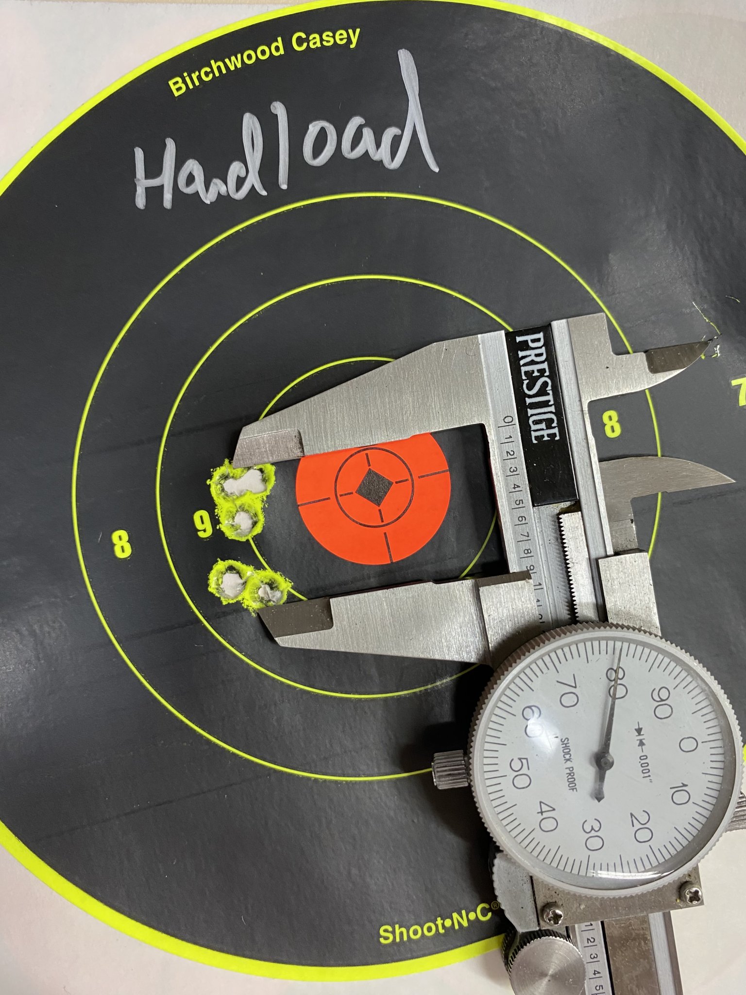

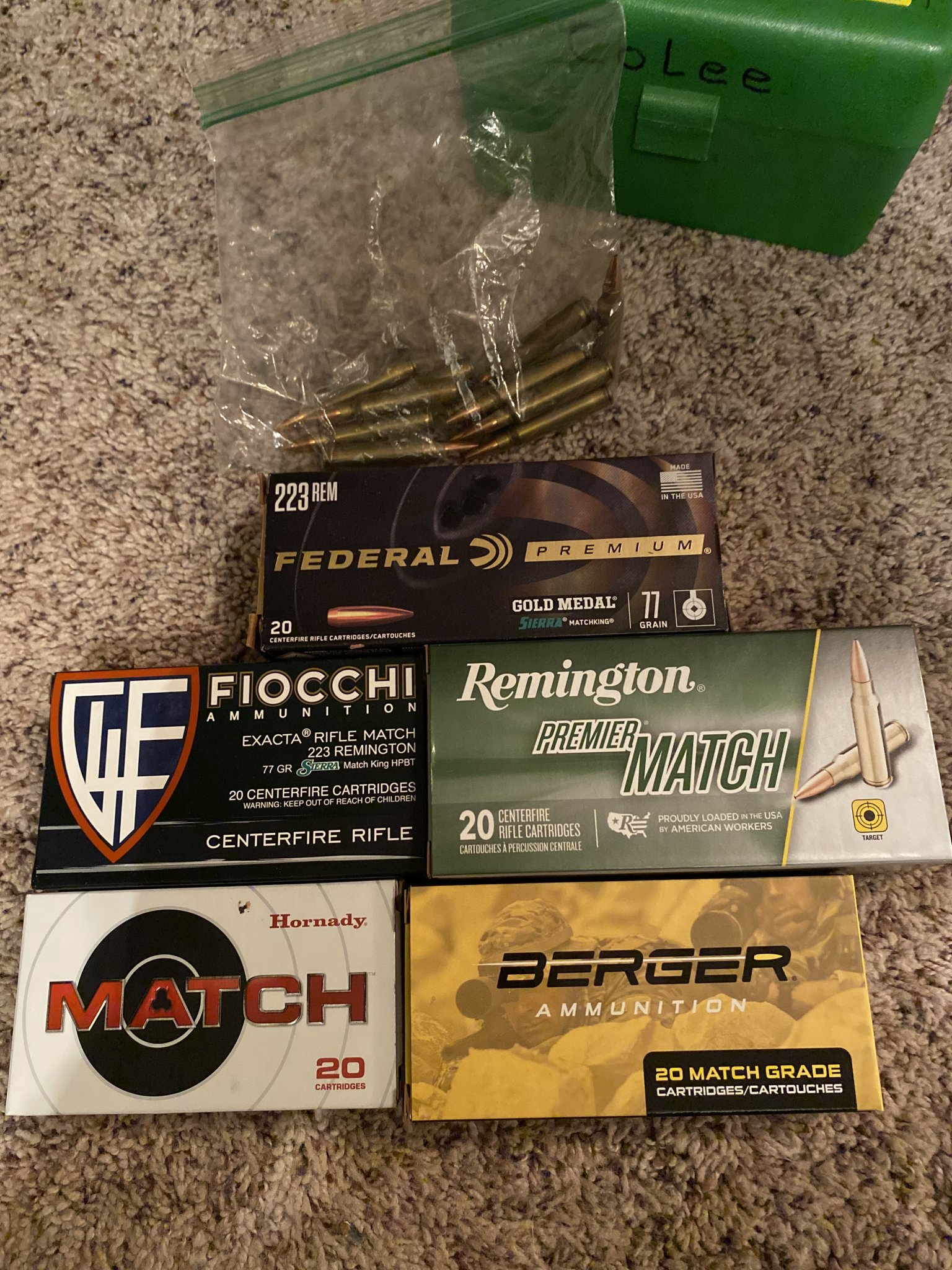

Old thread but I’ll throw in my recipe: 20” H-bar Douglas 1-7.7 twist barrel with a Compass Lake chamber. I tried 23grs of Varget with 75gr HPBT at magazine length with random lake city brass full length resized with a small base Redding competition die with a .246 bushing(SAC ones are the best). Then I seat them with a Wilson arbor press die. The stem It came with fits the contour of the bullet pretty well I think. With Remington 7 1/2 primers It’s about a 5/8” 5-shots and right at 3/4” max for 10 shots at 100yrds every time load. Feeding from a magazine like I would shooting high power rapid the rounds walk up then down a bit as they feed from side to side in the mag each round I shoot. The load could be a bit better with more tuning even I’m sure, I can’t hold open sights with a sling well enough to see a difference. The 3-9x Simmons scope with a carry handle scope mount is less than stellar for ultimate accuracy testing. Still yet this simple load runs great and has out shot every match 69-77gr ammo I could find even the big boys black hills, Berger, FGMM, Hornady, Sig ect they all came in around an inch usually. Cheers 🍻
