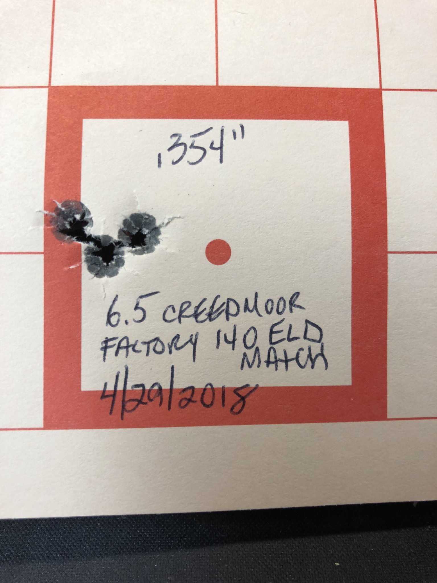

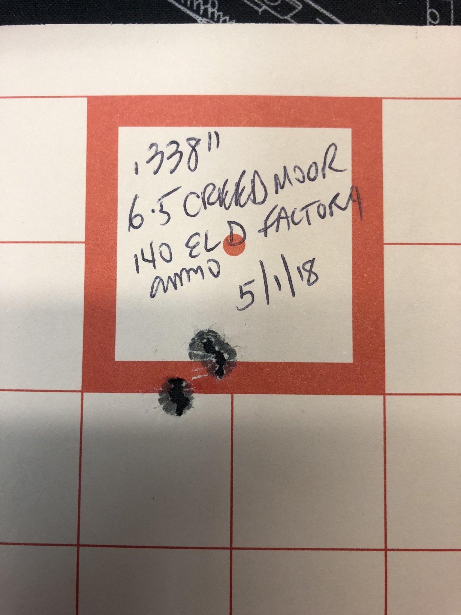

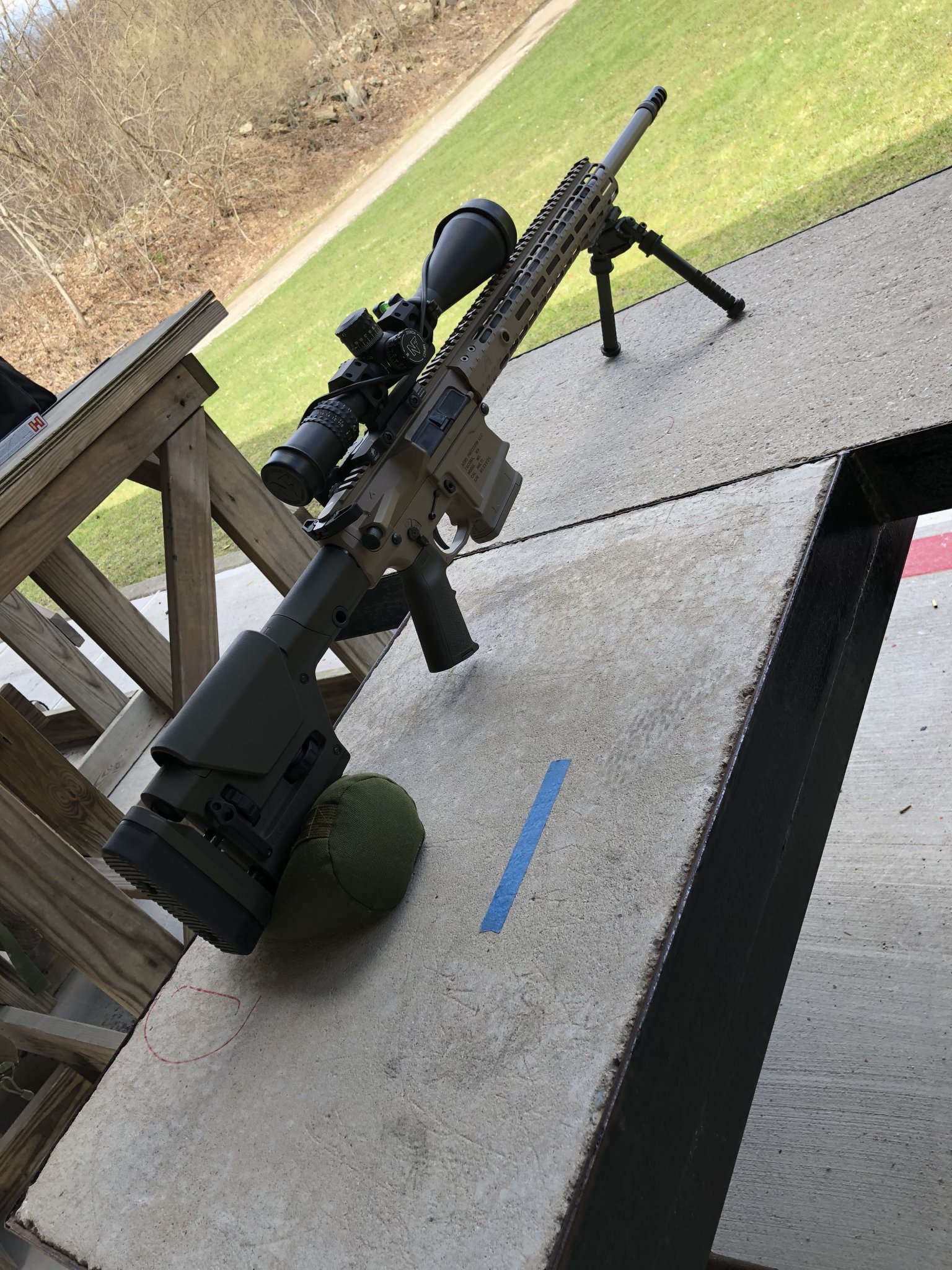

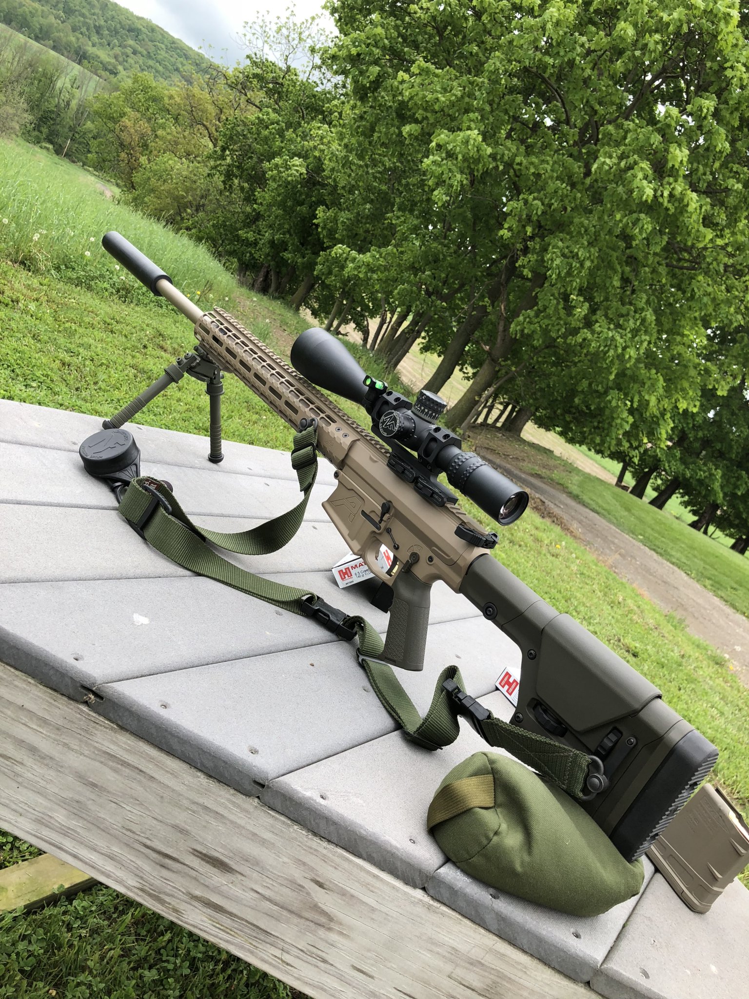

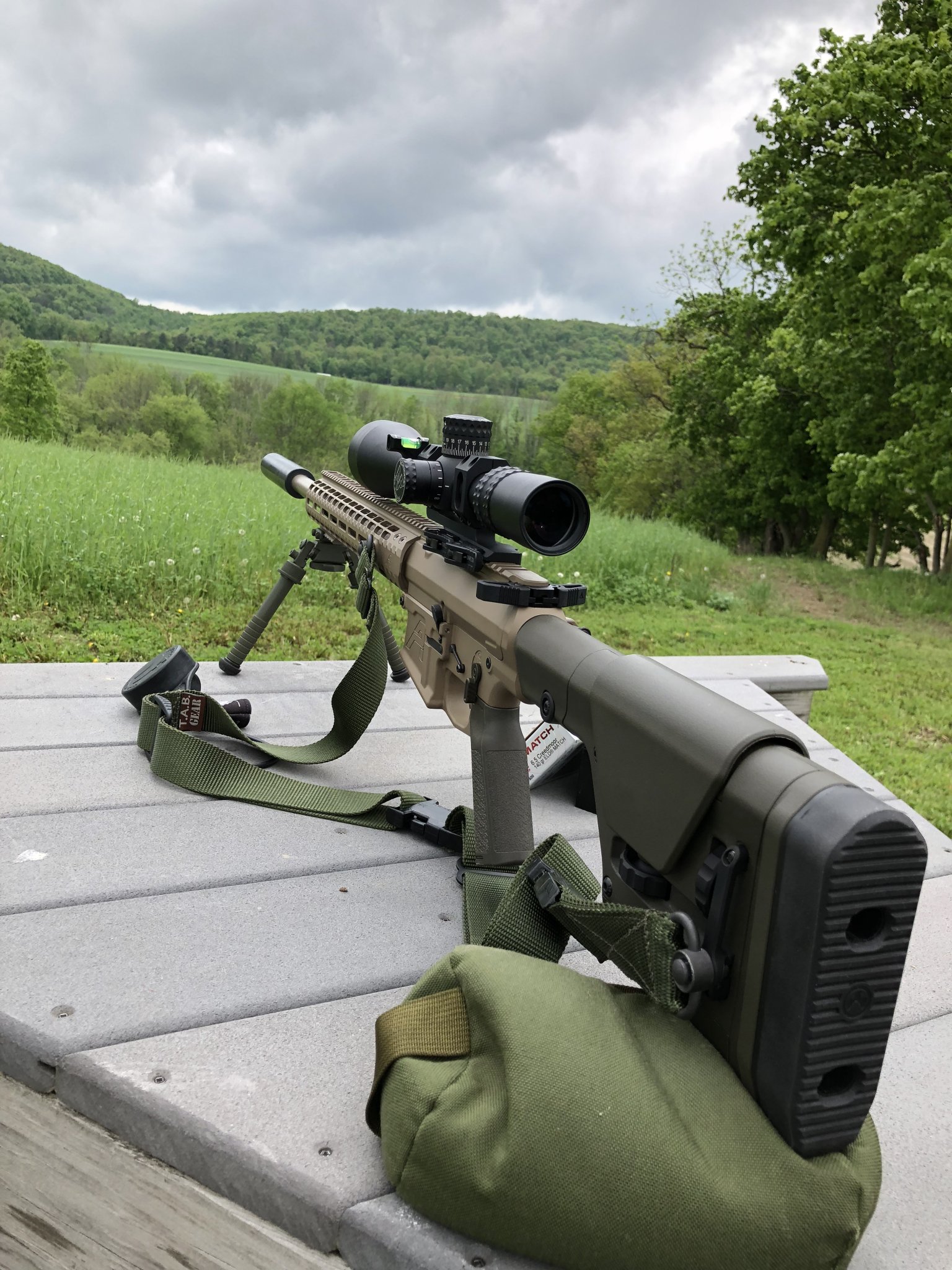

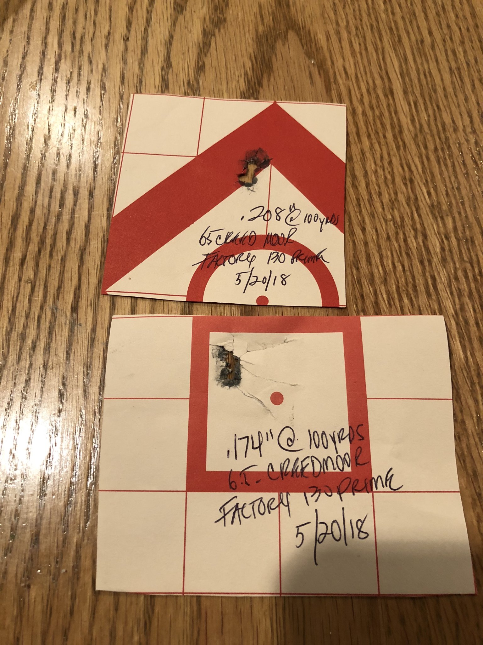

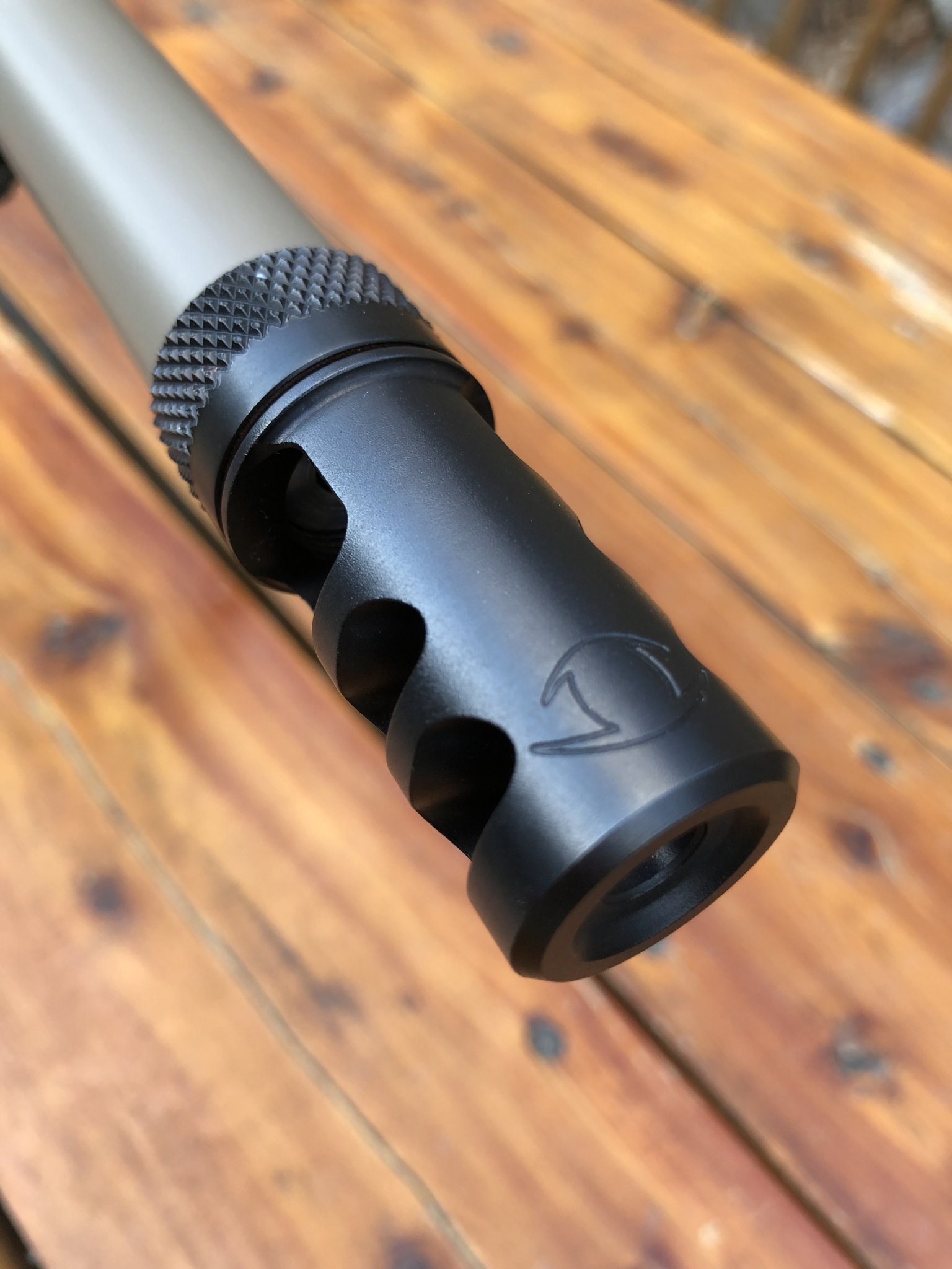

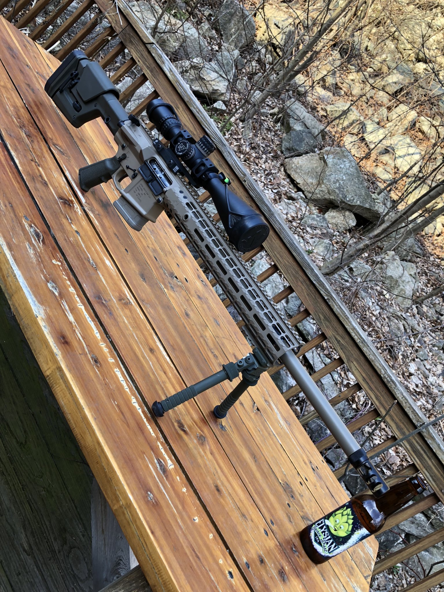

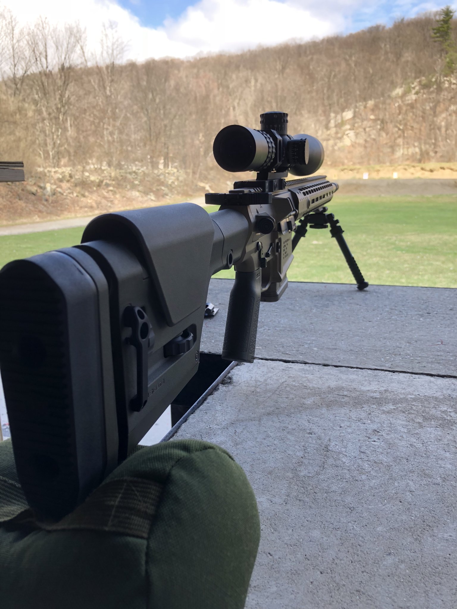

The legendary bolt rifle man, Robert Gradous, has ventured in the gasser world... I’m awaiting dies but in the mean time I tried Hornady 140 eld factory match ammo. I’m looking forward to seeing what it’ll do once broken in & a load development has been completed. More reports to come!! Thank you again Mr. Gradous!!! HUGE props to Insite Arms!! Their brakes are TOP OF THE LINE!!!! Thank you Harley!!

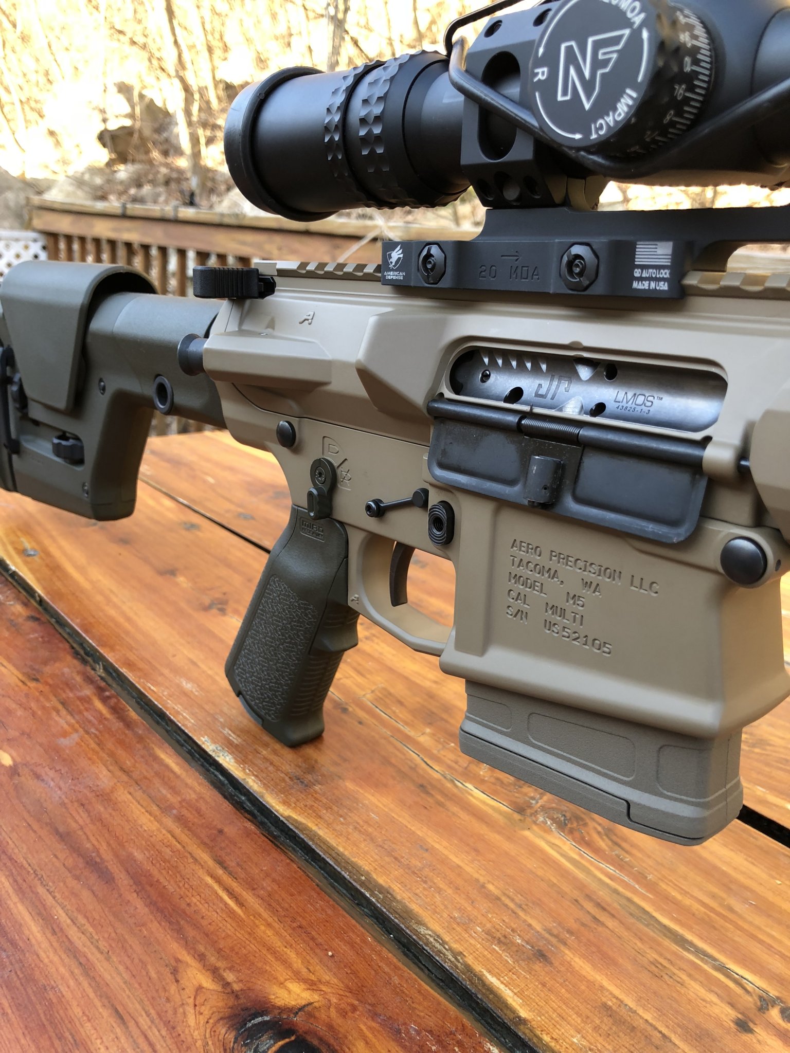

Specs on the upper
Aero precision M5E1 upper receiver in flat dark earth
Aero precision 15" MLOK handguard in flat dark earth
JP low mass bolt carrier group
JP high pressure bolt .062" firing pin
Raptor charging handle
CMMG stainless steel rifle length gas tube
SLR RIFLE WORKS .936 adjustable gas block
Krieger 1:8 4 groove chambered 6.5 creedmoor 22” & threaded 5/8" x 24 tpi
By Mr. Gradous.

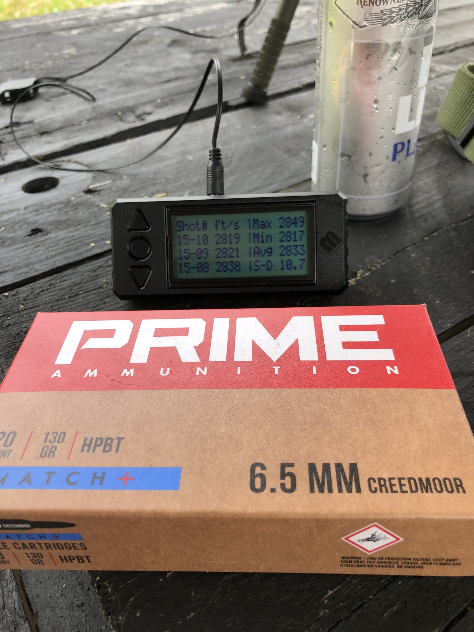

Chrono: magneto speed v3 (5 shots averaged 2665fps * 39es).
I’m sure it’ll come to once broken in.
