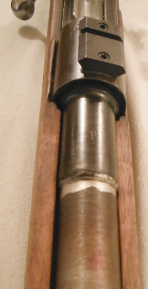

I got a 16" twist roughly tapered 22LR barrel off Ebay for $33 with a narrow shank.
I had a 1903 8x57mm Turkish Mauser from Century for $45.
I cut the rear off the Mauser barrel and bored it out.
I Silver Silver solder 22LR barrel on Turk Mauser 223 chamber 3-25-2014.jpgsoldered on the stub to the 22 barrel.
I reamed the chamber to .223.
I went to the range and took it along 11-30-2007
I temporarily loaned the rifle a 40X Leupold scope
33 gr Vmax .223 mixed brass 15gr Blue Dot, 2.170" OAL.
.75" 3 shot at 50y
.95" 5 shot at 100 y
1.125" 5 shot at 100 y
1.1" 5 shot at 100 y
It is ~~ a 1" gun without an extractor. I used a cleaning rod to extract.
I could have used Loctite just as well.
