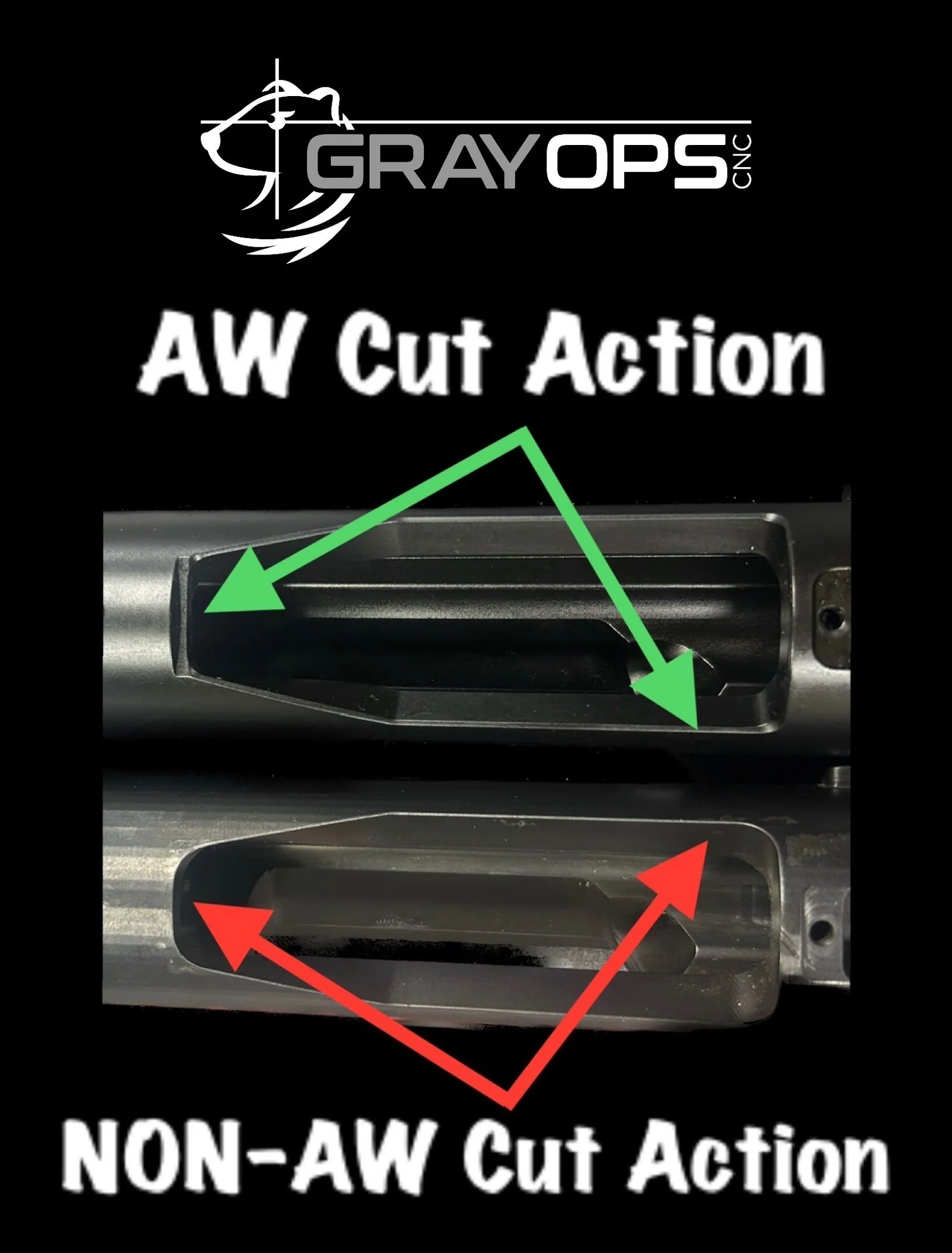

I do not really see the difference below.
I purchased an Impact 737R back in February of 2023, but it was not direct from Impact. It was purchased from Altus, so who knows when they purchased it and whether it is AW cut, or not.
So I am looking at the picture below and trying to figure out the differences.
They look like mirror images
The arrows are even pointing to opposite sides.
AW has a milled step at the front that’s the easiest way to tell. Compare the bit on the left ahead of the actual opening in the action.

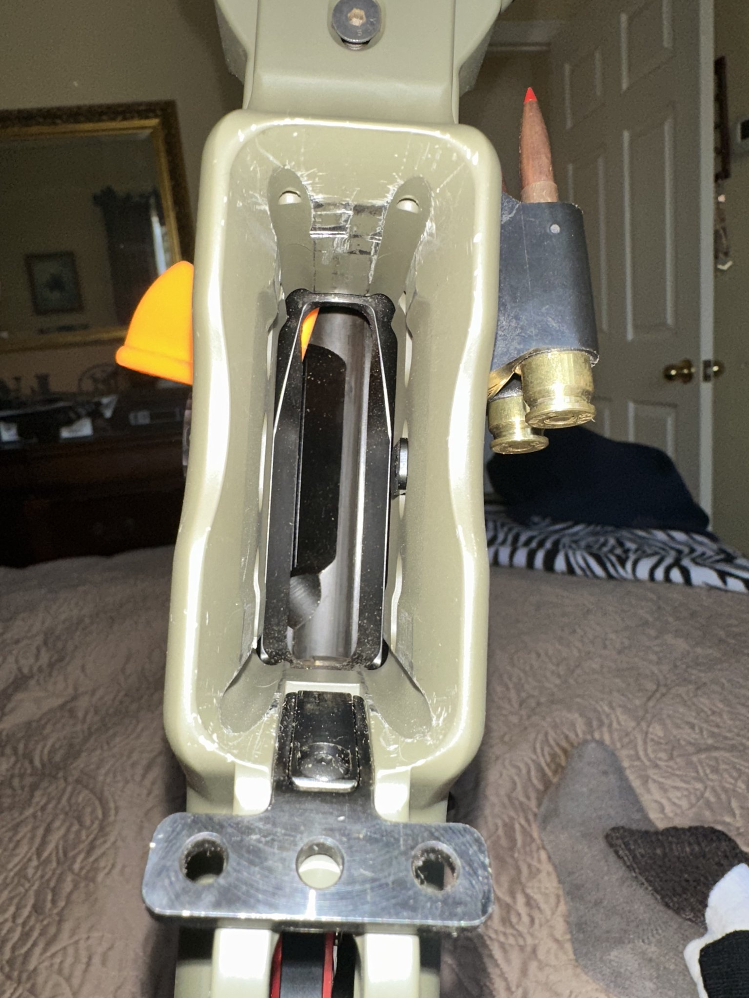

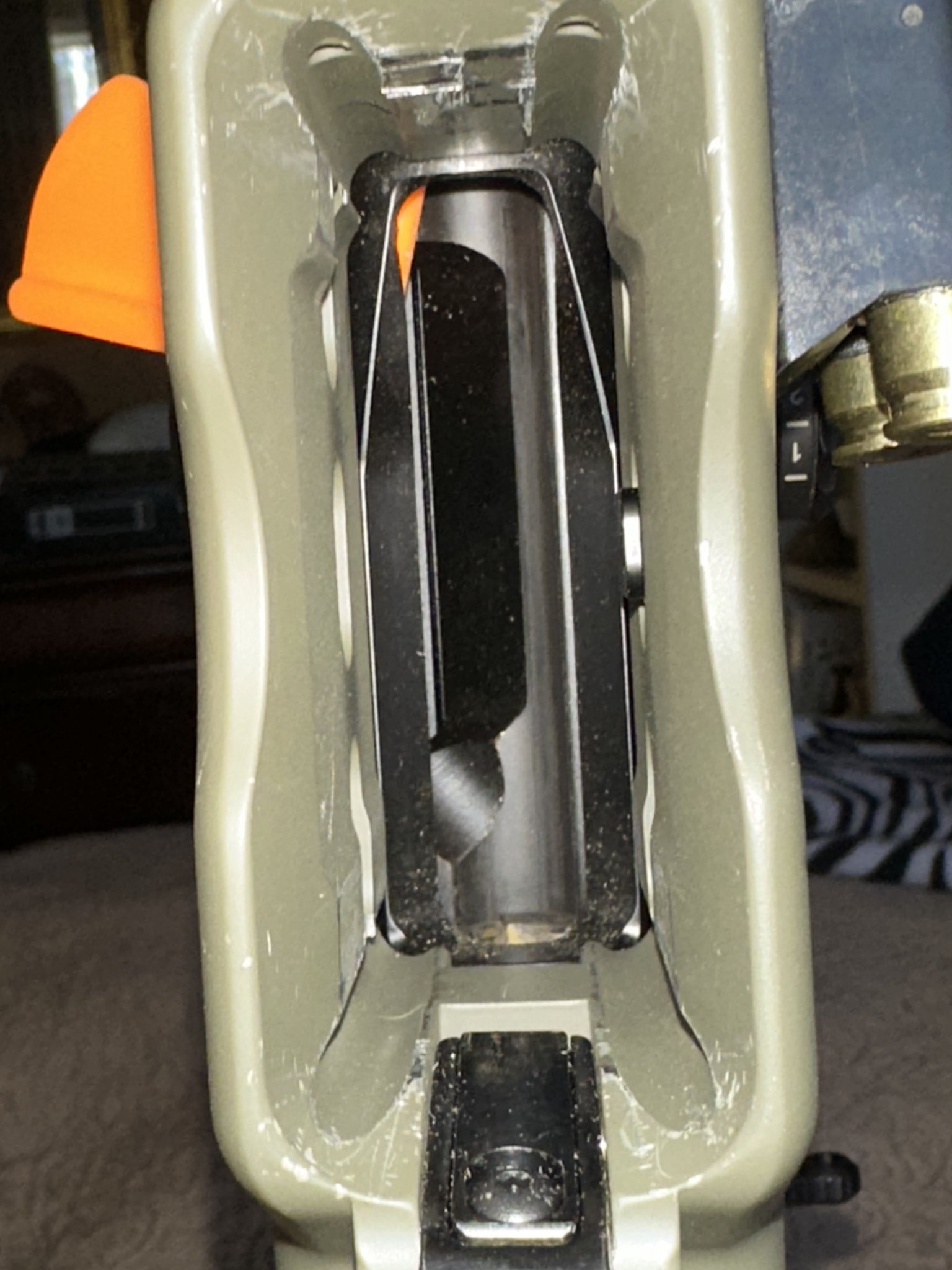

Hey I had this sort of issue in my Vision Pro too. I had to adjust the latch to seat higher and relieve some pressure from the front of the adjustable part of the magwell.
adjust back latch to lock in tight, back out pressure from front of magwell
I have an email out to them for tips or tricks. The issue is, especially in cottage industries like this one, returning anything you’ve used is either impossible or not worth it. I expect to be able to return both my tested (read: can’t be sold as new) and untested one magazines if there’s an unsat answer because this is a design issue.
If that’s an ARC,
the mag needs to be as flush as possible up against the part I circled.
The latch is adjusted to seat the mag as high as possible while still locking in, the front of the magwell is as wide as open as it comes from the factory so there shouldn’t be any pressure on the front of the mag. The feed lip not engaging the whole case is causing the case presentation issue.

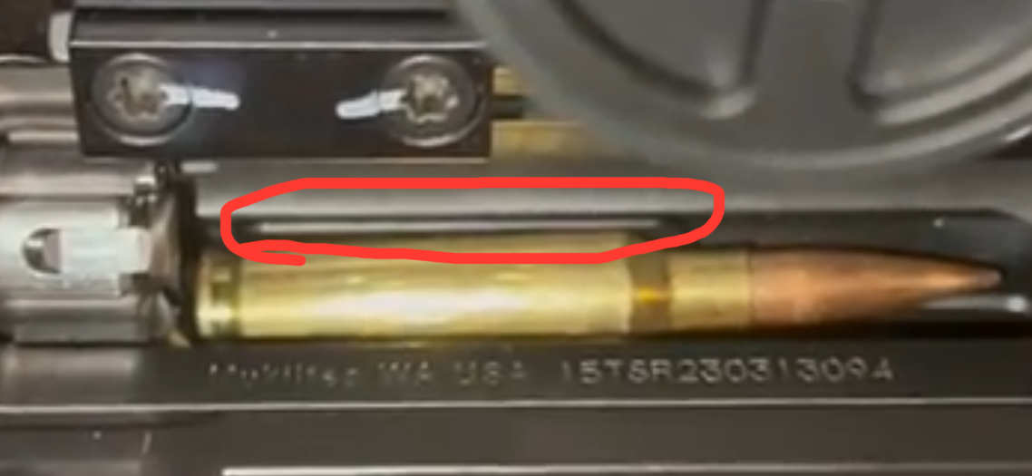

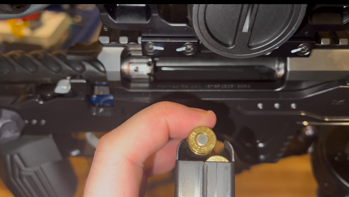

I couldn't get the 6GT mags to work reliably in my Impact 737R in an ACC Elite. Regular AW's work better but not well enough to trust. The bullet tip always catches on the breech face, plus plenty of times I have to back off on the bolt to get the round to pop in place. No thanks, I'll pass.
The milled step plus the inlet for the mag is slightly different. I sent my NonAW cut ones back to Tate and he cut them for me.
So this is peering up my magwell.
