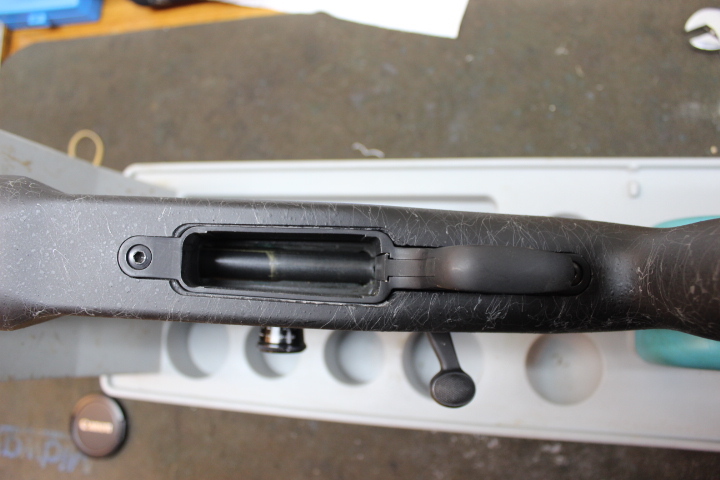

It was delivered about 10 days later and after unboxing it, I found the familiar feel of the McMillan A5 (which I have used before), and I have to say that the Grayboe, beeing made of a composite material has a "warmer" feel to it, rather than the cold hard surface of the McMillan stocks. To me, it actually feels a bit more like a good quality wooden stock. There are aluminium pillars installed from the factory and the composite material is tough as nails.

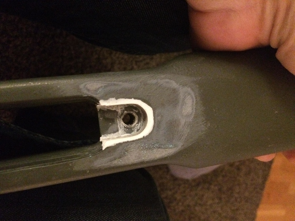

The finish of the stock was good, but not great. The fit of the inlet was ok, not great and not completely without issue. Let me elaborate; While it was possible to just bolt your action to the stock and go shoot, much like any info, instruction video or review online says. The bolt did not bind and the barrel channel was decently centered in the stock, the barrel was free floated. However, the bottom metal was a tight enough fit in the stock to make the paint chip along the sides. And around the front part of the bottom metal, where the front action bolt runs through, there was roughly a 2mm gap all around. I am using the factory Remington 700 bottom metal, and I have to say that this looked a bit sloppy and even the H-S Precision stock it replaced had a much better fit than this. There was also small chipps of composite material missing around the aluminum pillars that are factory installed in the stock, both front and rear, top and bottom.
So, I figured that something had to be done.
For a while I even thought about sending it back to Brownells for a refund. But then again, it was a black friday deal, so I did not have that much money in it. So I figured that this is as good a time as any to learn how to bed the stock myself and also make some alterations to it, to make it fit better for prone position shooting. I did some research and bought some epoxy and other things that I figured would come to use.
Step one, glass bedding:
And since it turned out as good as I could possibly have hoped for, I went ahead and did some work to the fit around the bottom metal too.

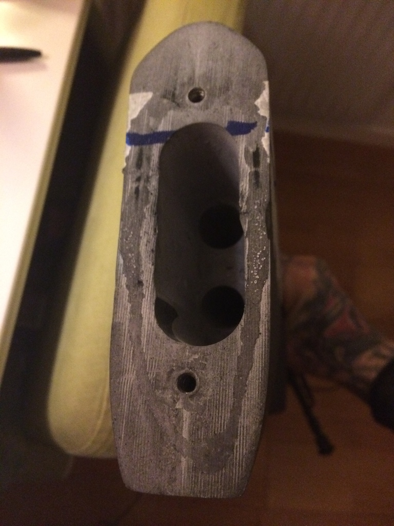

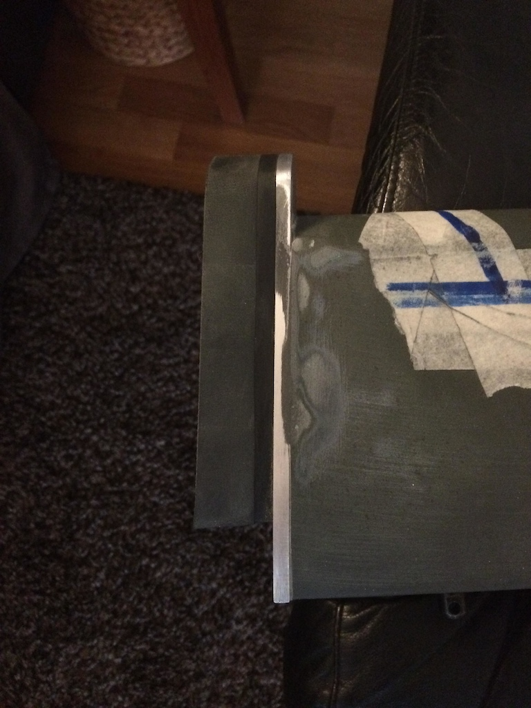

I knew I needed to move the recoil pad up, and using my A3-5 as a guide I figured I needed it to come up 20mm. And the easiest way to do that was to make a spacer. So I removed the original recoil pad, which was a bit of a pain in the neck. As it turns out, it was both bolted and glued on to the stock. Nothing a good knife cant fix, but I still cant figure out why it was glued. Anyhow, it also turns out that the stock was hollowed out, with a big drill and a mill by the looks of things:
Which also made me rethink the plans I had for the adjustable comb. Since if I had used a hacksaw to cut into it, I would have cut into the void in the stock and then I would have to fill it out with something, in order to fit anything there. More on that later.
I wont bore you with the details, but I made a spacer plate from 6060-T6 alloy, and with all things said and done, it looked like this from the side:
Its none adjustable, but on the other hand, it puts the recoil pad right were it needs to be. And I am happy about that.

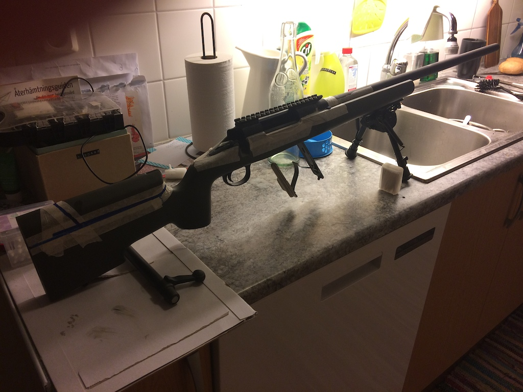

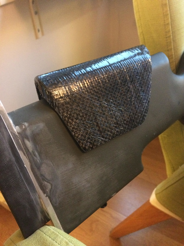

Next up was the comb riser, which is needed to get a good cheek weld so that I can look through my Schmidt & Bender 5-25x56 PM2. The comb riser it self could probably fit in a thread on its own but I will keep it short and sweet. I figured I would do a "saddle style" cheek riser, and I wanted to mould it. So I started out with laminating epoxy and jeans fabric to get a feel for it. It was pretty easy and if it did not look right the first time, a new try was made in the matter of 10 minutes, and then cured in a few hours. It was a pretty fun process, so I started thinking that maybe, just maybe, I should get some carbon fiber cloth and try making a combriser from that material.
So I ordered some cloth from an online retailer and went to work. I wont go into details, and the comb itself wound not compete with factory made carbon fiber products. But it gets the job done for me, and I made it at home. With cling film, tape, laminating epoxy, carbon fiber cloth and lots of trial and error. I still have to sand it smooth. But like I said. It gets the job done.
Here it is. Its now mounted to the stock with dubble sided tape, which seems to work.

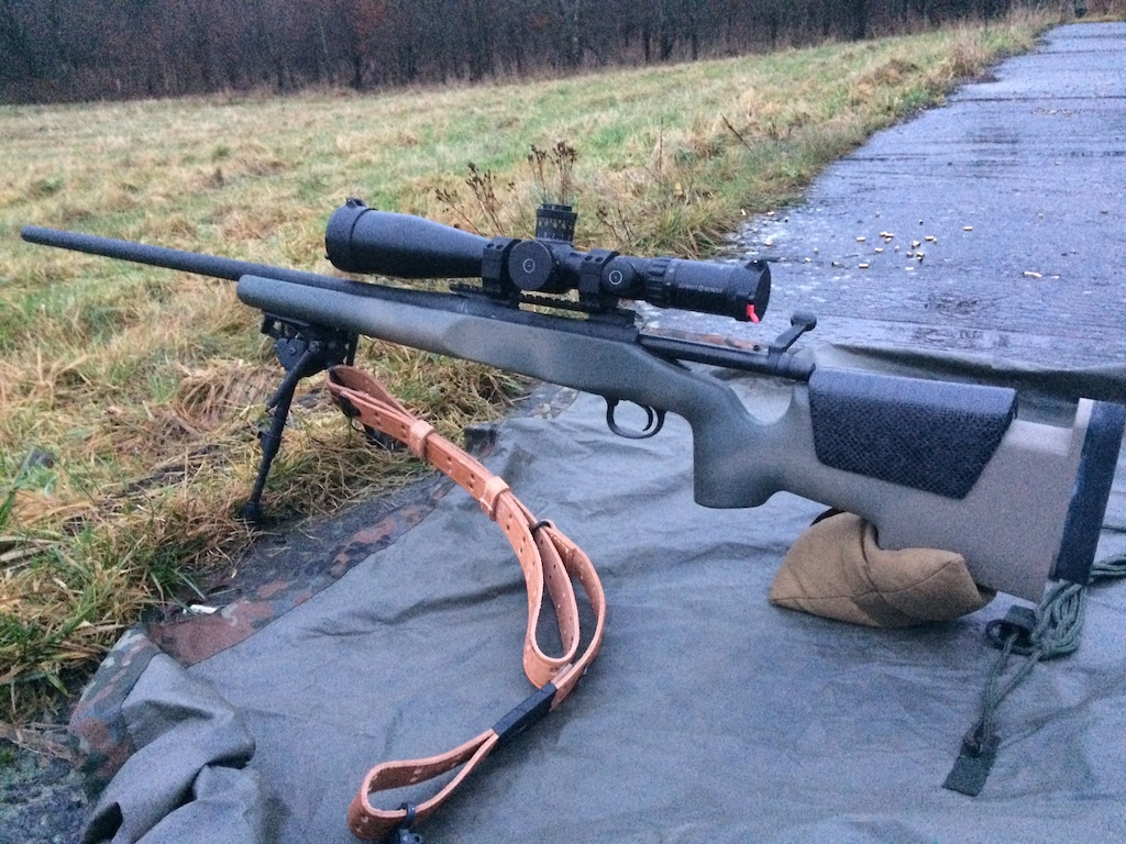

And finally. A range picture from today. From a windy, rainy and cold Southern Sweden.
This is the best that it has ever shot, during load development with the superb Hornady ELD-X 212 grain bullets and NORMA brass.
I know, only 3 rounds. But it was load development. come on guys. Shot at 100 meters.

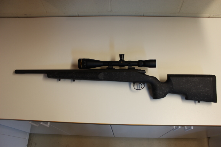

I recently restocked my Remington LTR with a Grayboe Renegade. I bought the BDL version but used my old style H-S Precision DBM bottom metal. Light filing required to fit it and had to shorten the front action bolt .050". Shot two 5/16" 3 shot groups during sight in. IMG_0863.JPGIMG_0866.JPGIMG_0864.JPG

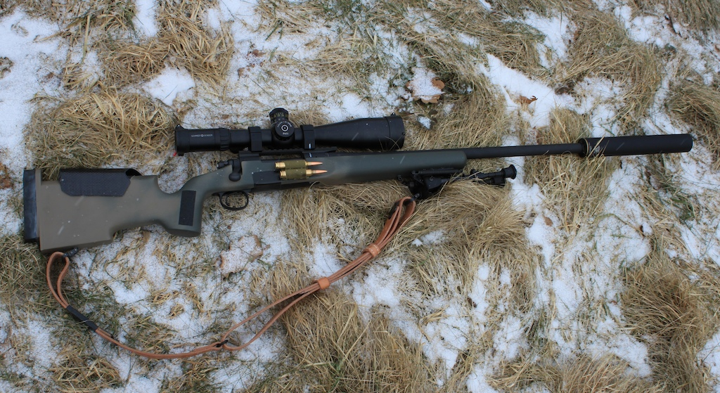

Time for an update.
Things has been going slow this winter, I have been waiting for the paperwork on another suppressor, then I had to get the barrel threaded, but fast forward to just the other day, and the gun smith called and said it was all done.
So this is the result. I have done some more work to the comb riser, I cut it down a bit, and now I can remove the bolt without it interfering with the comb. The suppressor is a Swedish made Stalon Victor L, its not optimized for the win mag, but it is strong enough for it and it does a pretty good job. I am very happy with it. I shot 26 shots today, most of them from the 300 meter line.
The Grayboe Renegade performs well, even in the blistering cold Swedish winter.

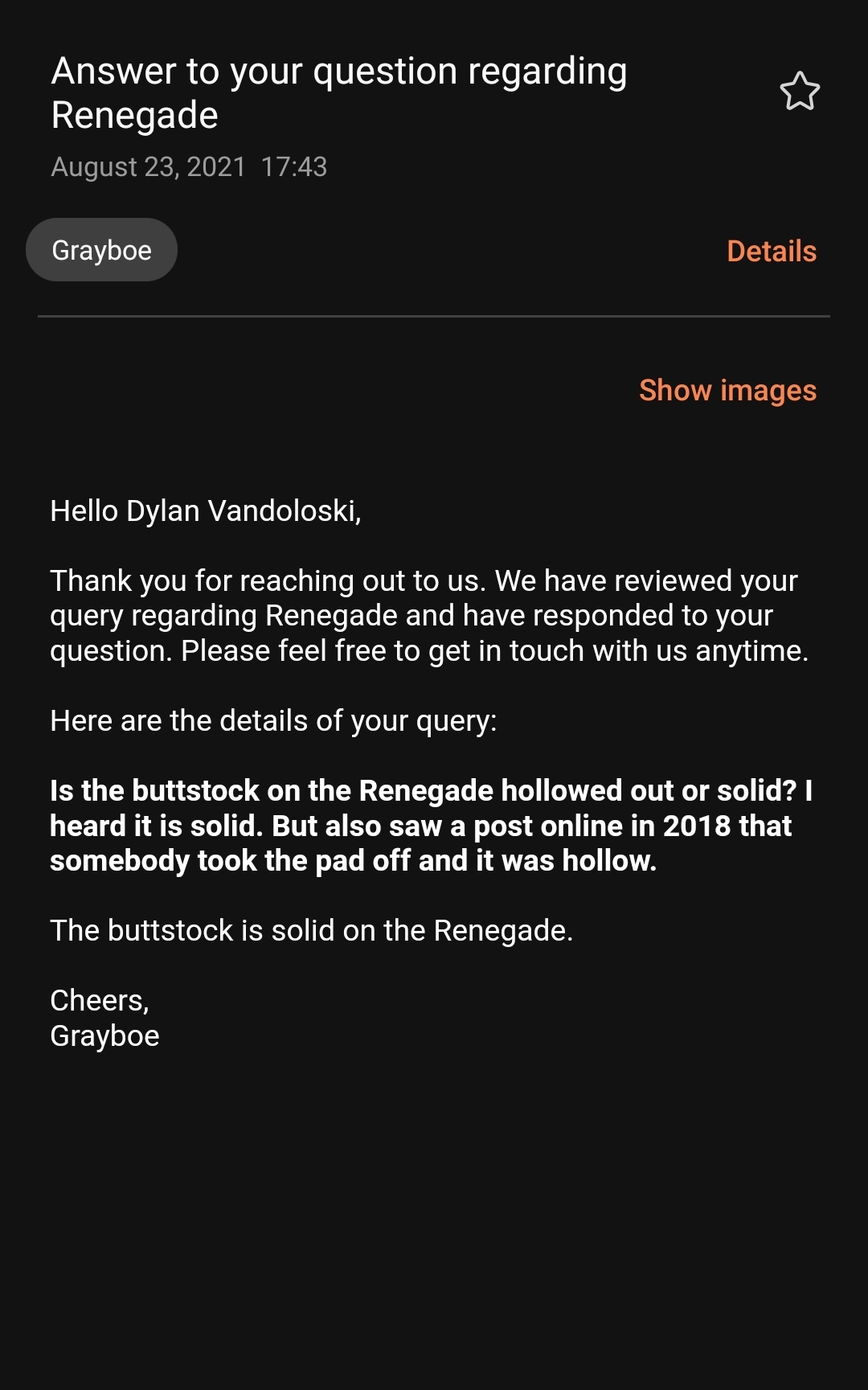

That is kind of odd due to I messaged Grayboe and they said the butt stock of the renegade is supposed to be solid and only the Terrain and Outlander are hollowed out. Maybe they changed the design since this thread?
They might very well have changed it since my review. Its been some time.
